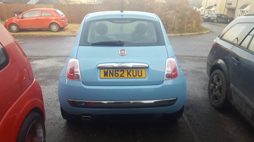

Well mudflaps are on.. Don't have pics to hand, maybe post some later.
