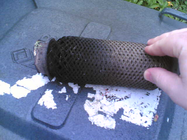

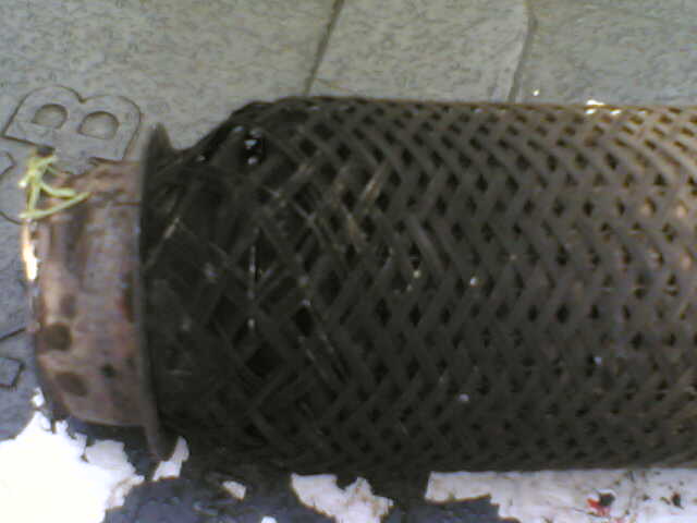

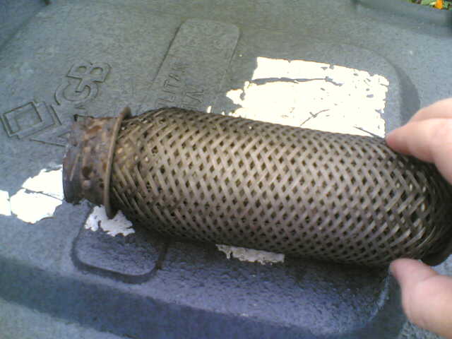

I finally got that bloody exhuast sorted! Runs quiet as now, and along with a set of bridgestone tyres, the MPG has shot up to!
Cost me £30 in the end to get it sorted, rather that than fiats £120 or kwik fit and budgets £160/£150!
Basically, my cousins husband did it. He cut off the flexi pipe on the existing one and then trimed the fittings of it, welded them onto new part, welded to existing pipe then hey presto, just under an hour, perfect exhaust.
Should pass its MOT now!
Got some pics below, They are all the original part, the first one is it turned eound to show what it should look like, the secon is what it actually looked like, and the third is a failed close up till i can get my hands the digital camera rather than my nokia.

do you reckon that would have failed its MOT with that one on?

You havn't showed us a pic of the new flexy but if its gas tight and its doing the job it should pass the dredded MOT as well as the job its there for to (y)
