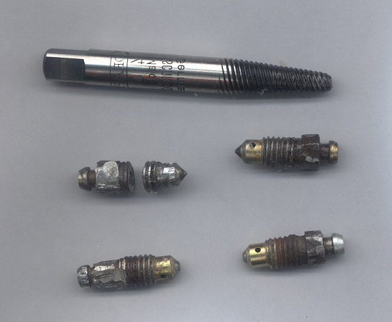

The mole grips (Degreased) and a file eventually freed my little (degreased) bleeders (below with flat tip to left).
The replacements were wire brushed, treated with rust remedy (locktite), rinsed in clean brake fluid, swapped and bled with a 1-way valve till fluid clear (with top ups). No leakage and no more sponginess. (However)...

It dawned on me it the scrap yard yesterday where the problem started. I tried a different scrappy’ who remove all road wheels and bleed screw rubber caps (amongst other things). Automatically I used The Spanner’s Ring End with no problem. Before I used the open end like the Haynes’ manual diagram (anticipating bleeding brakes with one-way valve ready in place). Then I had tried an 8MM socket but it was too shallow to fit on tightly (I later realised).

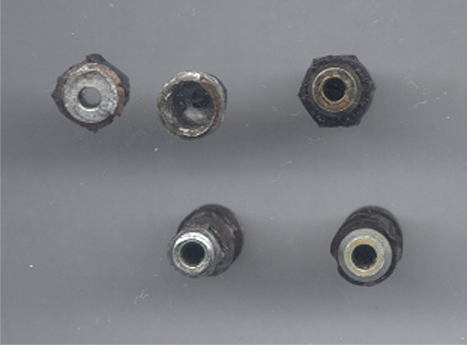

Some people learn the hard way! It was too late for all except the last one (one rounded last time). I had to drill and extract that one as it sheered off in Mole grips this morning (mid left). A lot of patients, Progressively larger drill bits and a No 4 screw extractor did it (just). My step dad told me about screw extractors (top), they are now less than 10 quid for a set (without a tap wrench).
Also in picture (mid right), the last one shifted with ring end no bother, although the soak in WD40 will have helped matters. Lucky I did not have to replace the cylinders, callipers and probably all the piping through following Haynes’ diagrams and not thinking about the age and condition first.
On my 1993 1.0 IE the front and back Uno bleed screws are same except the cylinder ones have a flat tip inside (bottom 2) where callipers ones are pointed (upper 2). Like the TIPO and PUNTO my UNO now has pointed cylinder bleed screws. No leaks and all new 4 dot. What difference can the ½MM point make? I think ill get flat tipped ones for the back next weekend.
