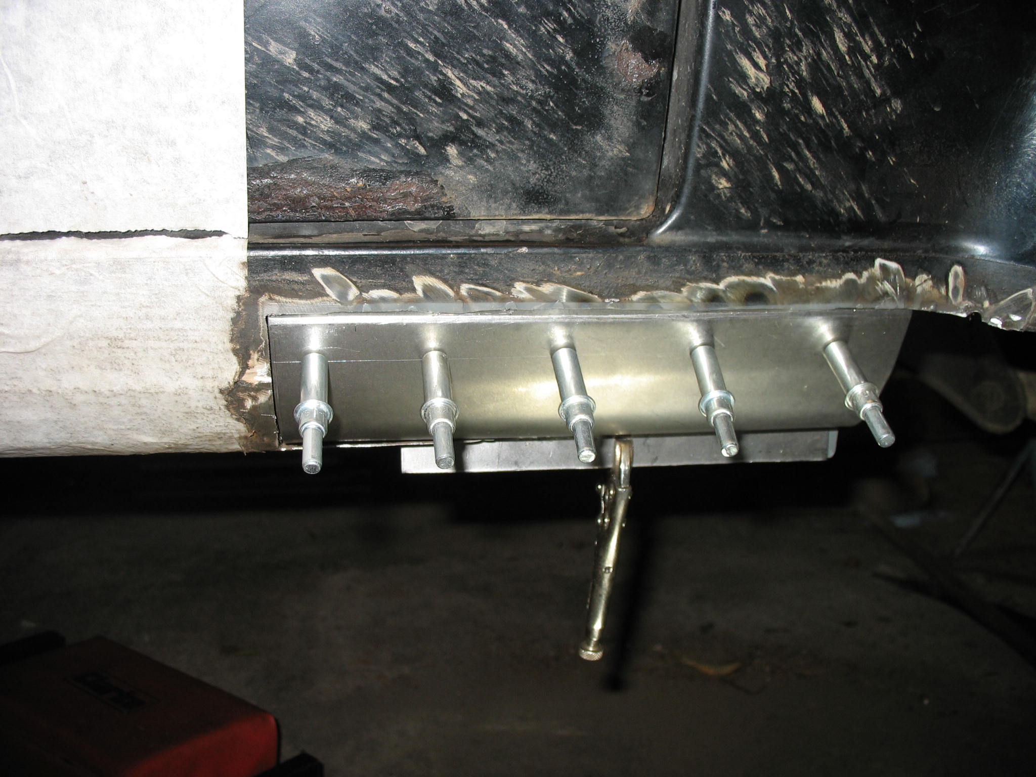

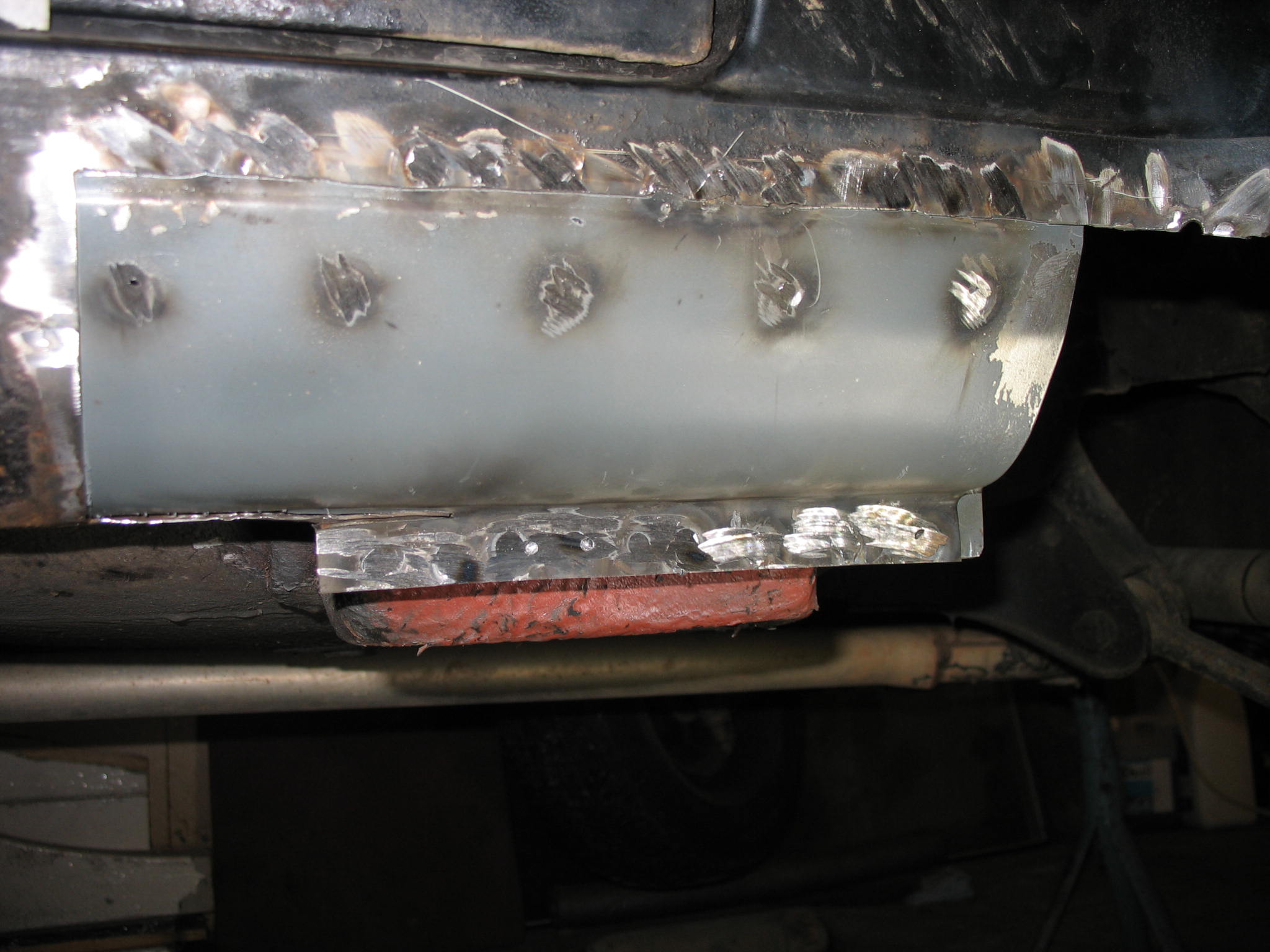

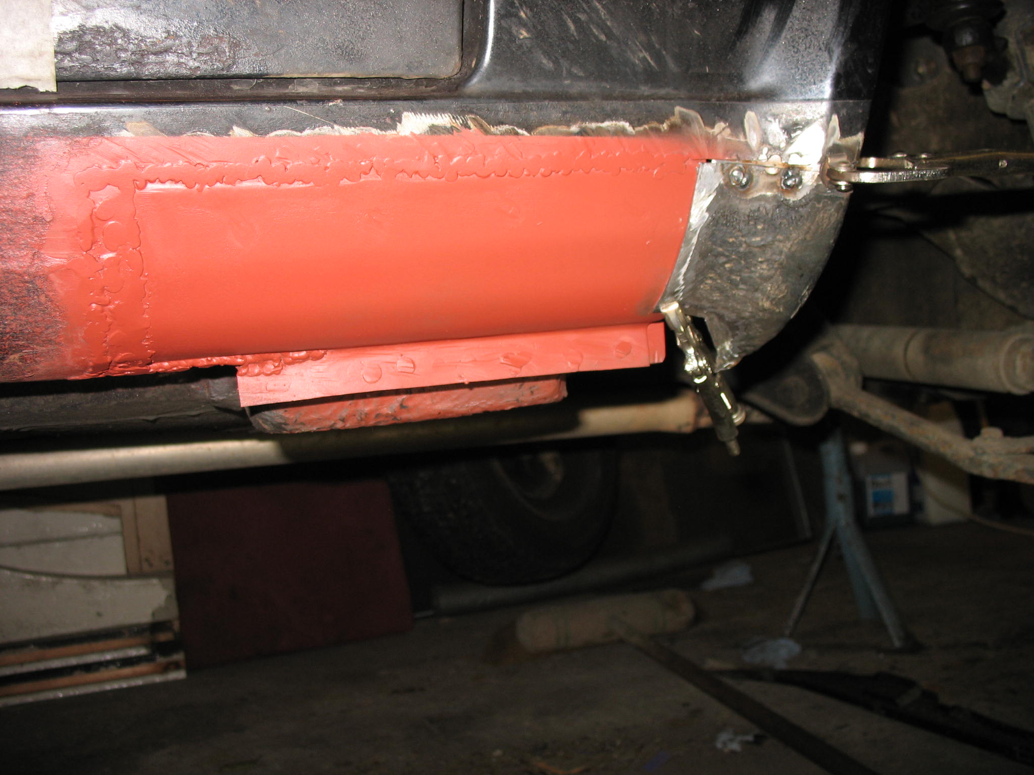

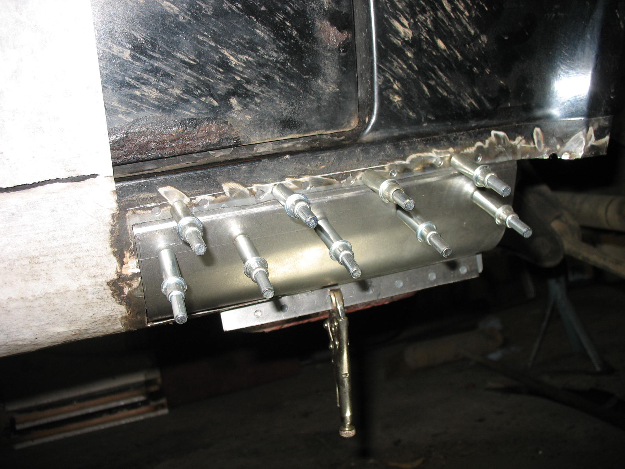

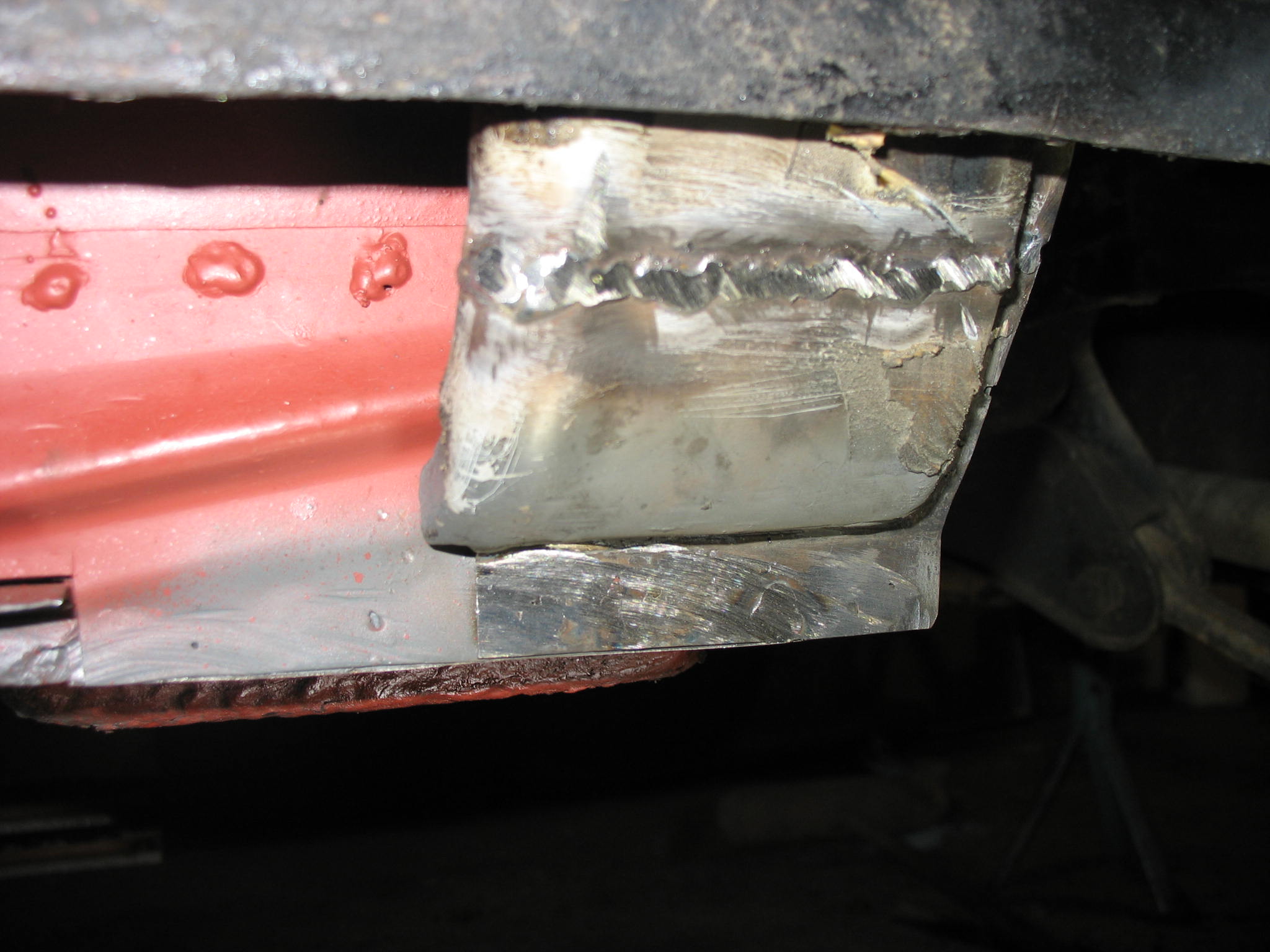

Couple photos of the front sill corner job. I did not done my best as full outer sill replacement part would be required. Next time it is a must as rear sill end requires some attention.
I do recomend Cleco temporary rivets, pricey but rally handy.
I don't know what was wrong - but the top edge welding was a total disaster

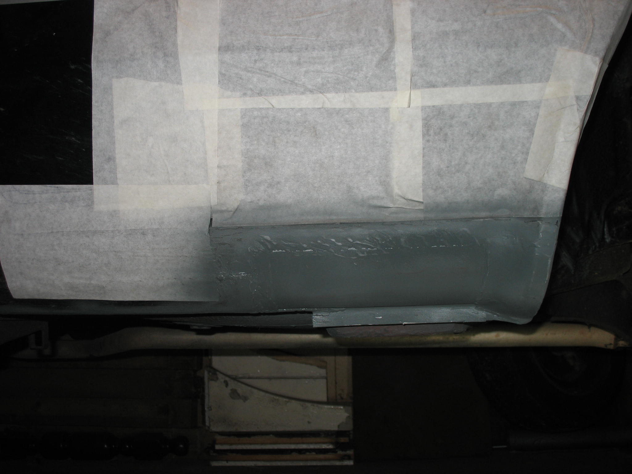

And finished product before paiting etc.

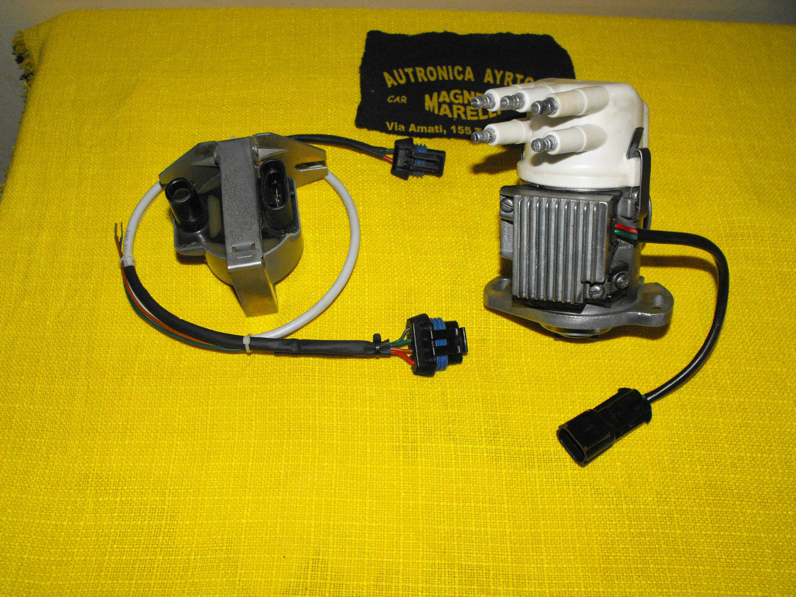

During this week I did noticed that panda still does some hesitation during acceleration in high gear and increased rattle noise from dizzy assembly - so as a cure i've bought set of these:
Reconditioned distributor - contact less one, coil, all harneses - all for only £62 inc P&P.
Shame the coil is the later type as it is not compatible with my current 4x4 stock of coils.
if someone is interested
