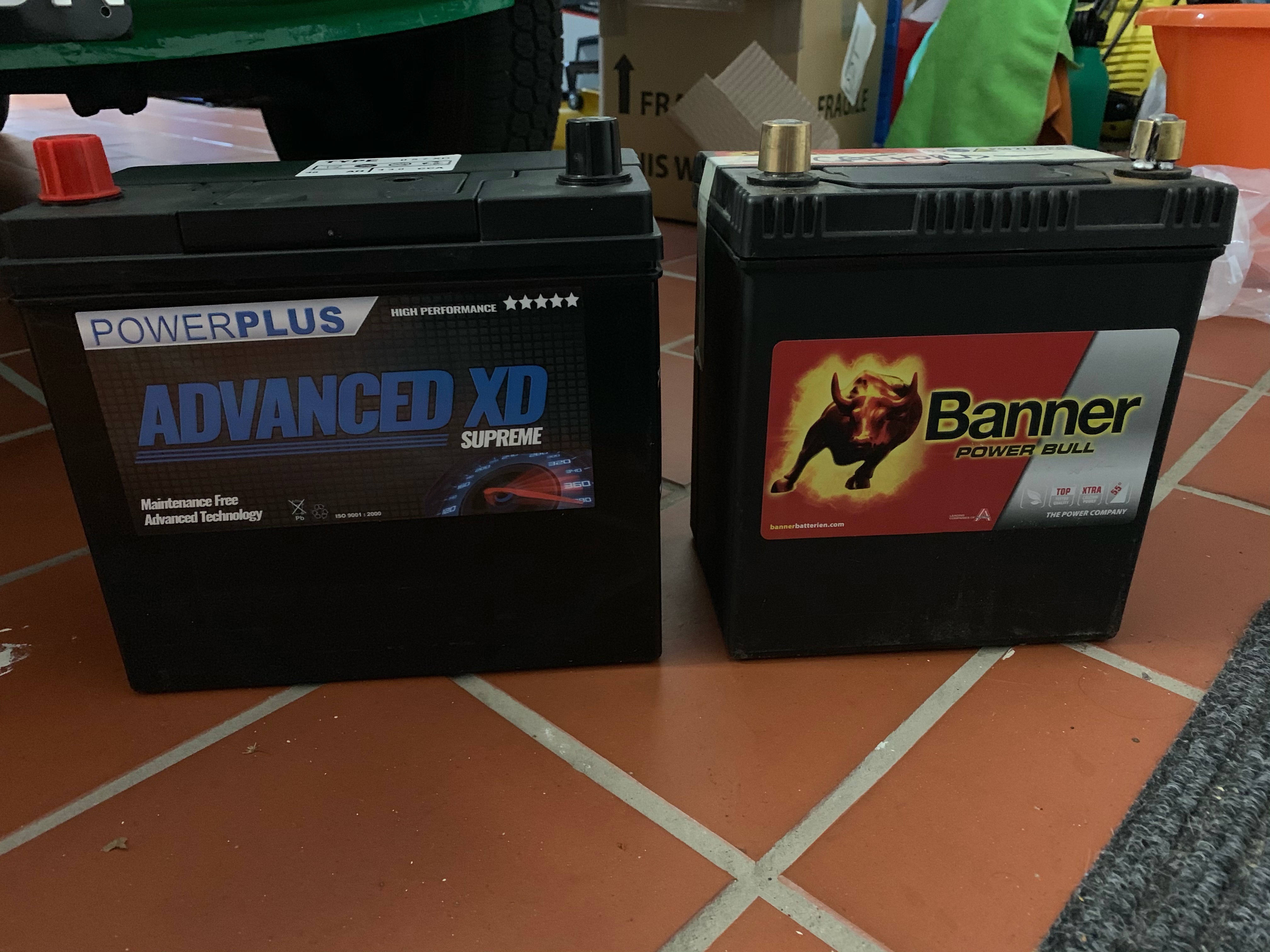

Just ordered the 057 battery. I have a 038 at the moment. So 100 more on CCA and + 8 AH is money well spent imo. Especially considering how important the component is for starting the car. Ordered from the same website as others have used. 55 notes and due tomorrow (y)
Rob
New 057 battery fitted this morning. 48AH and 430CCA. Very reassuring that the size is much bigger than what was currently fitted, a 027 model, 40AH and 330CCA. Good to have the extra capacity and starting capability. Cheap and easy mod, even I could fit it (y)
Thanks to this thread and the people that posted their advice and findings.
R
