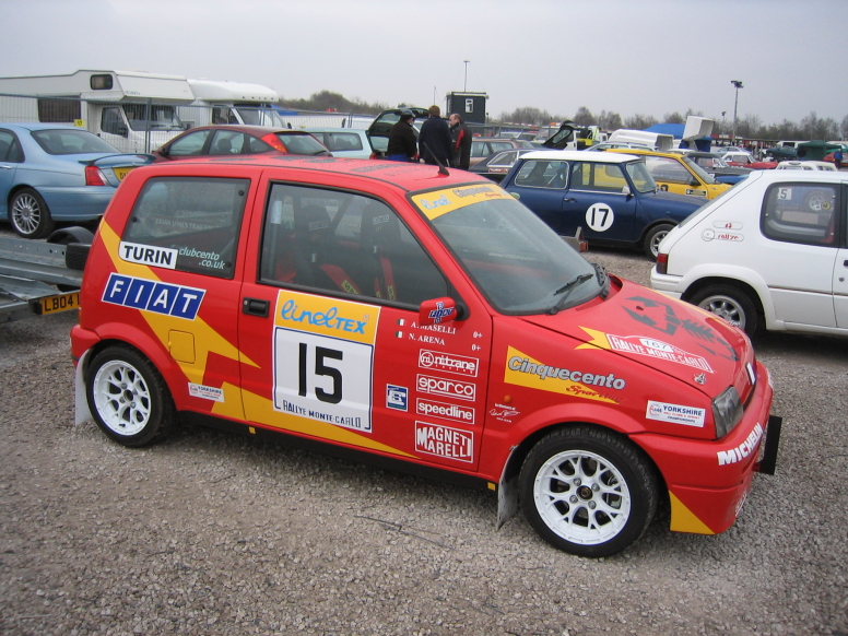

Hi all,
Dragged the car out of the garage today for a run out ahead of 3 Sisters on Sunday. I'm determined to complete a full lap this time around, so thought i'd give it a quick shake down. After a beautiful run across the moors to work all seems fine. :)
Its actually quite funny parking it up in the work car park. I'd forgotten how small it is! It was next to a new focus which is about 2ft longer at the front, and 3ft at the back.
All I need to do is throw it on the trailer and i'm ready. Just need the weather to be good :rolleyes:
Cheers, John
Quick report.... it was a pretty cold damp start and for those of you that know 3S its bloody lethal when wet thanks to the 2stroke karts that run their the majority of the time.
My first run was pure comedy, wrong gear in EVERY corner, plus fuel starvation. The new diff was taking a bit of getitng used to. 2nd practice run much better, 3rd gear for most corners, although still damp and slippery. First timed run and is was starting to dry out a bit, and I felt I could start to push. A quick look at Kevin's footage showed me far too circumspect around Cowards Leap so i knew I coluld push more there. Final run was dry and the first time I felt I'd really pushed, found another 3 seconds and tied down 3rd in class out of 8 - this included a poor start and a mistake at the second hairpin.
All in all a great first run out for the season, and a decent result. The winter changes have more than halved the gap to the front running pugs, and i'm clearly ahead of the rest (more pugs and minis).
Car performance faultlessly, the new diff is just awesome both in terms of gearing and traction. It takes a lot of getting used to, feeding the power in coming out of a corner actually tightens the line, which is the opposite of what you get used to in FWD. Front end turn in is much improved and the whole chassis now feels really well sorted.
Next stop Olivers Mount (Scarborough) in two weeks for a bank holiday weekend triple header :D Now where did I put those extra 30 horses... :rolleyes:
