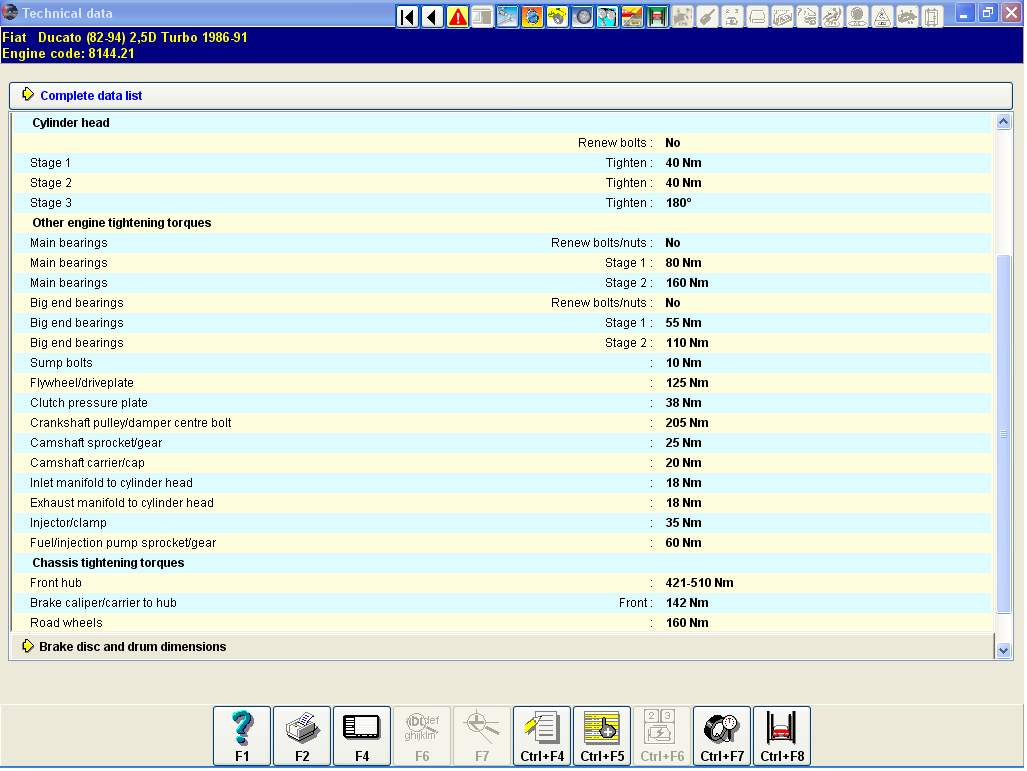

hi guys any one have the torque settings Big end torque settings for 1990 fiat ducato 2.5 td
