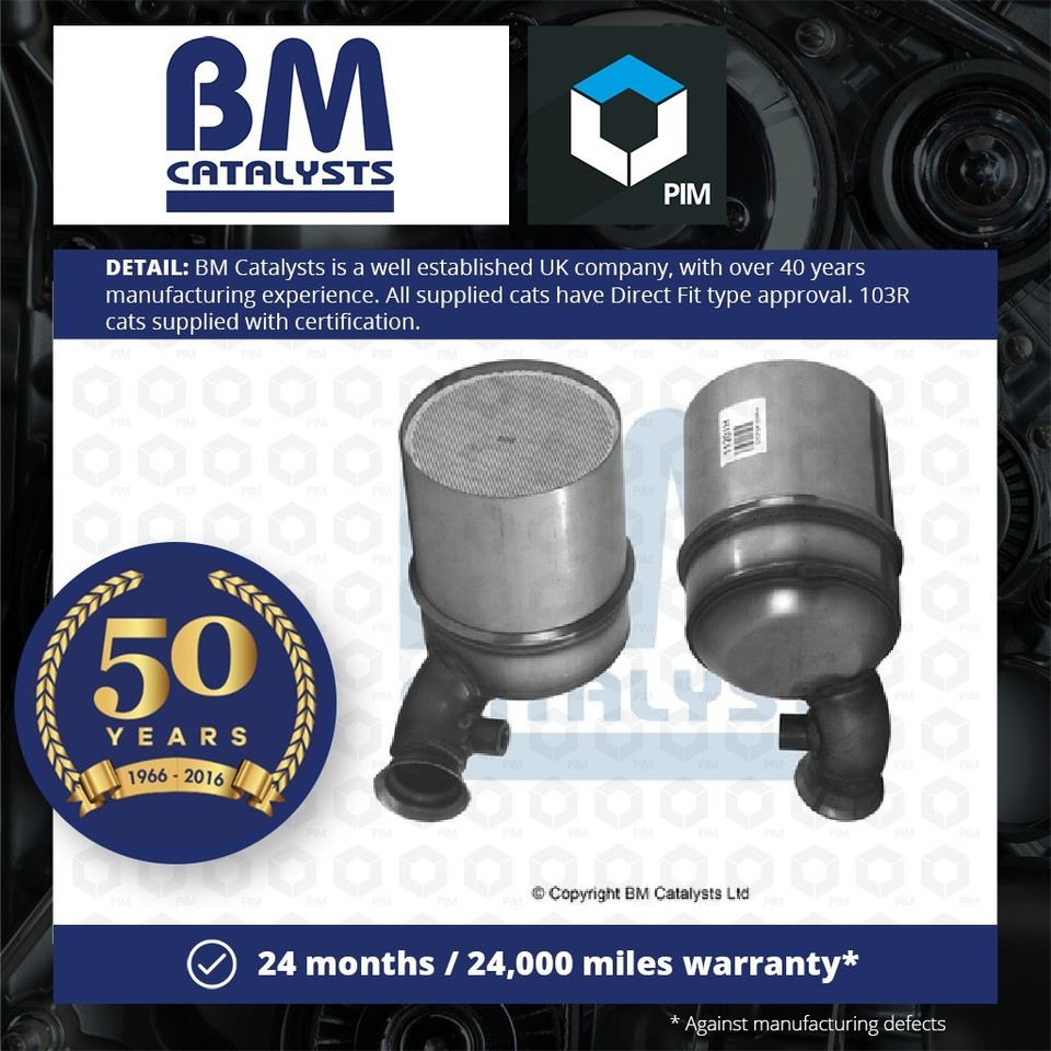

If your DPF looks like this photo below which some 1.6 Scudos do look like, then it is simple a case of undoing the pressure sensor pipes, the clamping band at top and a few mounting brackets to get it of to clean.
Note the internals are fragile so do not poke them to clear , just use the chemicals and high pressure steam cleaning worked for me and lasted another 4 years!
