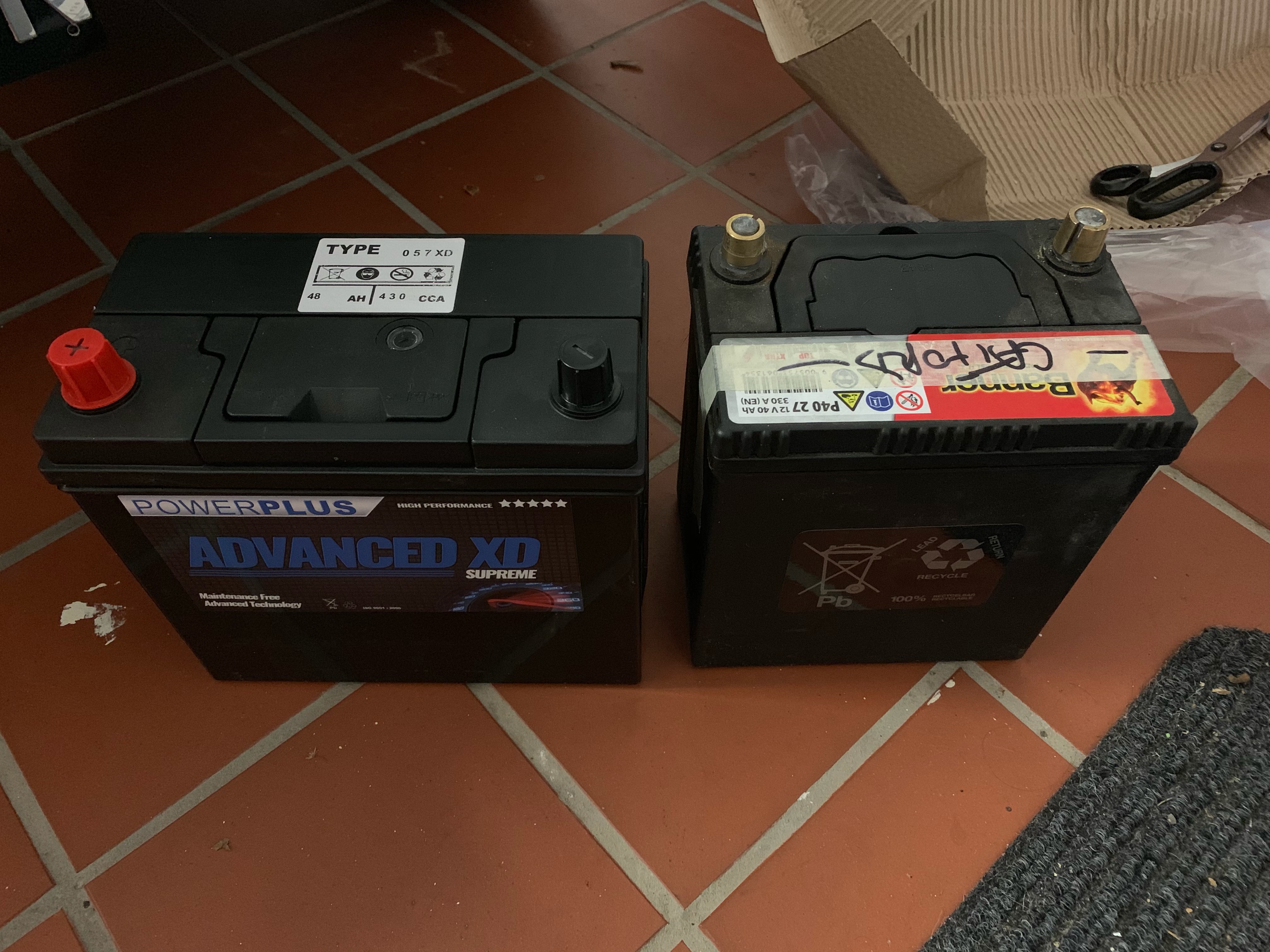

Went to start the 500 a couple of days ago and dead as a dodo. Tried plugging my battery charger in and it blew the fuse on it. Fitted another fuse, same again.
Thinking my battery charger was kaput I went an borrowed my neighbours who has a big industrial one like they use on car forecourts and can give a boost charge to start it straightaway but I thought I’d just leave it on normal charge for a few hours, so went and did some gardening.
Once I finished the gardening I was a bit hot and sweaty so thought I have a shower. Thinking to myself shall I just check the battery first or take a shower. Decided to check it first.
When I went back in the garage, I thought there’s a funny smell in here. Switched my inspection light on and there was smoke beginning to come out of the battery and it was red hot. It was still in the car at the time. So disconnected it very quickly and pulled it out of the car. Acid had started to seep out and down the sides but fortunately not enough to damage the car at all.
If I had left it and gone to have a shower I am pretty sure it would have probably gone up in flames because it was so hot. I had to pull it out the car with gloves on, so all in all a lucky escape to say the least. All I can think is that it must have gone short circuit inside.
Anyway ordered a new battery at 4pm yesterday from the guys in this thread, advanced battery supplies, second time I have used them. There service is superb to say the least, new battery turned up at just before 4pm today!
There is a guy on Facebook that takes away old batteries around here, I haven’t a clue what he does with them. Contacted him, left it out in the porch and he took it away at 5am this morning.
So back to square one now just £55 lighter! But mightily impressed with their service.
