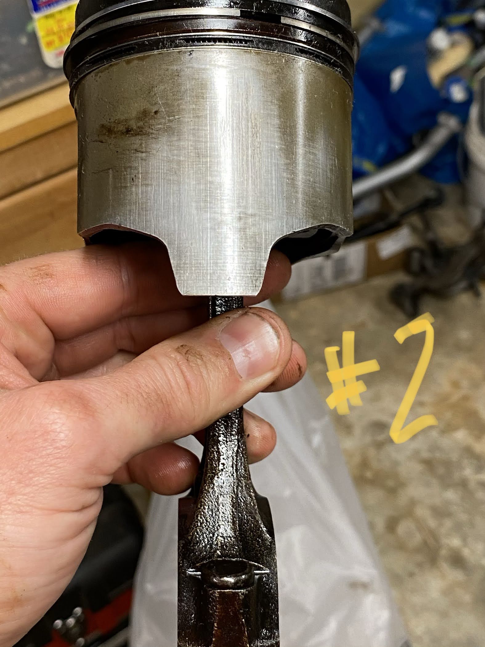

As a winter COVID project, I'm tearing into my spare 500R motor with plans to rebuild it as a mildly-sporty 595 mill. With advice from thehobbler, I'm going to have the head skimmed and 34mm intake valves fitted and a 75/35 cam. I was hoping/planning to leave the barrels and bottom end alone, but tearing into it, I discovered some mild scoring wear. Pics are attached showing the worst barrel and both pistons. Is this normal wear on these? None of the barrel scoring is significant enough to catch a dental pick and I think it could easily be honed out.
With a little honing, do you think these pistons would suffice? Possibly some 73.9mm rings? I'm trying to avoid a money pit motor, but still gaining/keeping power and reliability.
Thoughts? Thanks in advance.

If these engines are relatively well looked after the bottom will go on for a good mileage. Depending on use it is the top end may wear first although I know of one 594cc engine that went over 100,000miles with only following a normal servicing schedule. Scoring of the bores tends to be axial rather than radial. If you remove one of the piston rings and set it in one of the bores you can check the ring gap to test for wear with a feeler gauge. The tolerances are shown in the workshop manual. If worn then I would go for a light hone and new rings.if within tolerances a light hone and reassemble.

Like Dave, I don't think those marks are from the pistons or rings, but maybe from someone previous to you who manually tried to create some rudimentary honing? It's amazing how long the original honing marks will stay on a cylinder wall.
I've used pistons with similar scoring on them as long as they measured-up OK. Accurate measurements are the key thing to ensure that you have a good rebuild which leaves you without slight misgivings. That's not always possible for everyone, but I have only ever had a rebore when it was obvious that an old engine had seized and then corroded.

I would be tempted to give the bores a good clean and a light hone---give the pistons a good clean and then measure both the bore and the pistons in order to ascertain what the piston/bore clearance is. On the '595'engine it should be:--between 2.8thou and 3.5thou (0.070mm to 0.090mm)---this is measured 2-1/2ins (57.15mm) down from crown of piston. On post 1974 engines,the clearance went up to between 3.1thou and 3.9thou (0.08mm to 0.100mm). If the piston/bore clearance is within those tolerances put it all back together with new piston-rings.

The pistons, from what I can see, look pretty good. I would be giving everything a really good clean up - so the rings need to come off and any deposits in the bottom of the grooves cleaned out. You can use an abrasive paper on the piston crowns and, if you're careful, on the lands between the ring grooves but absolutely not on the piston skirts. This is because some grit from the abrasive is likely to become embedded in the aluminium of the piston and the skirt is in direct contact with the cylinder wall! The piston diameter where the lands are is usually just slightly smaller in diameter, by just a few thou, than the skirt so won't contact the bore wall.
With everything nice and clean check all the dimensions and clearances. First try the pistons in the bores, without rings fitted, gently just by hand, and see if they move full stroke easily without any sign of binding. stop immediately if they bind anywhere to avoid scoring. Then, as suggested above, check with your feelers for skirt to bore clearance as if that checks out OK you don't need to start looking at whether it's pistons or bores which have the wear. Ring gaps need to be checked well down the bore (maybe 3/4 towards the bottom of the bore - never near the top where bore wear will be greatest. - for the same reason the piston skirt to bore clearance should always be checked well down the bore too) also the ring must be absolutely square on to the bore or the gap will not be able to be correctly measured. To achieve this put the ring in the bore and then insert a clean piston upside down - so crown first - into the bore and use this to chase the ring down. This, of course, only works with a piston which had a flat crown! If that all comes out OK then check ring to groove clearances with your feelers.

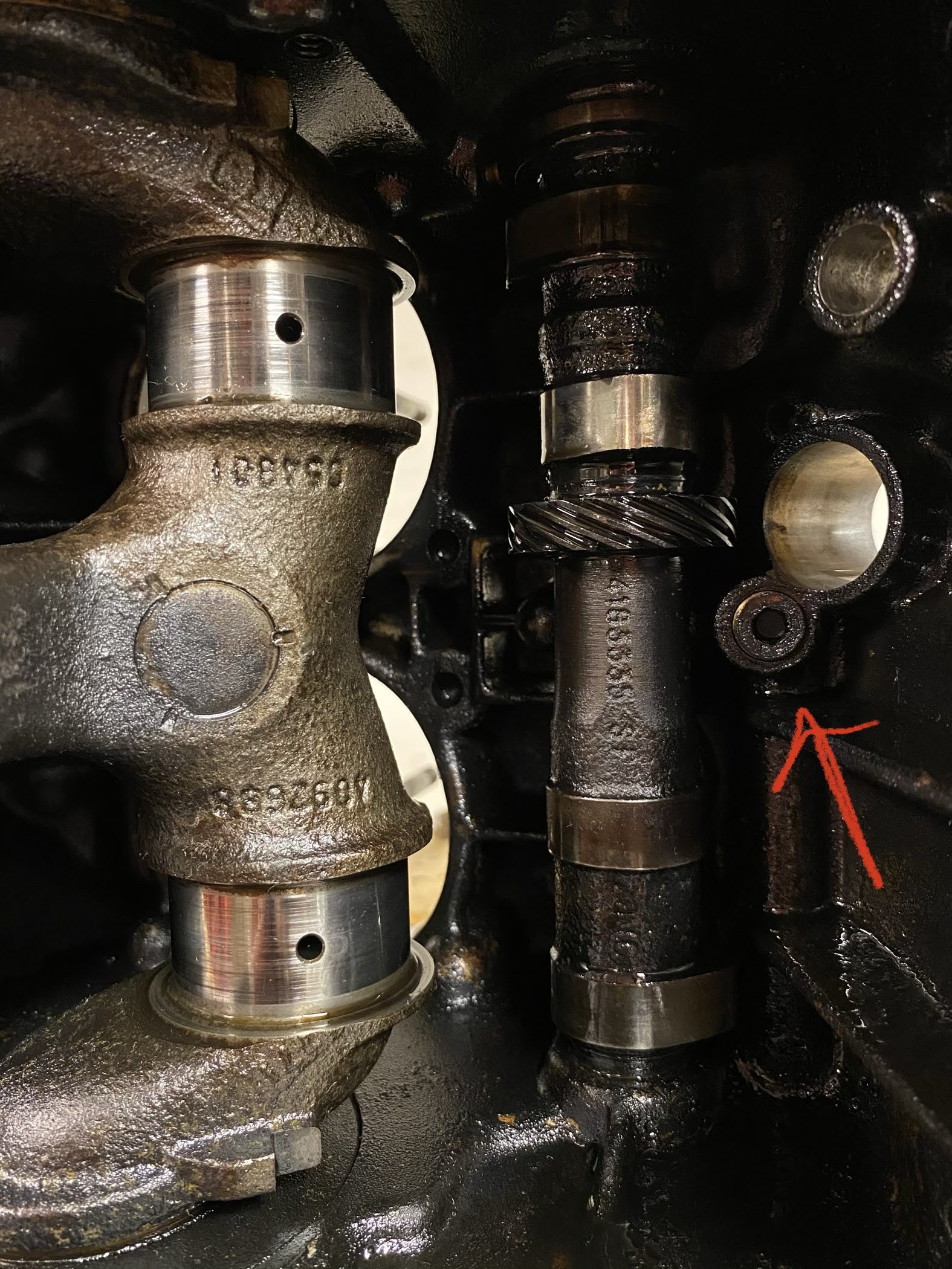

Ok... here are some teardown pics. So far, everything is looking good, and some initial measurements seem well in the box. I'm waiting on a honing tool on order to hone the barrels, then recheck the measurements, but pre-hone, everything looks nice and tight, so I'm hopeful for the short block. I plan on doing a little head work regardless. Once I get a 32mm socket, I'll pull the rest of it apart so I can hot-tank clean it and start putting it back together.

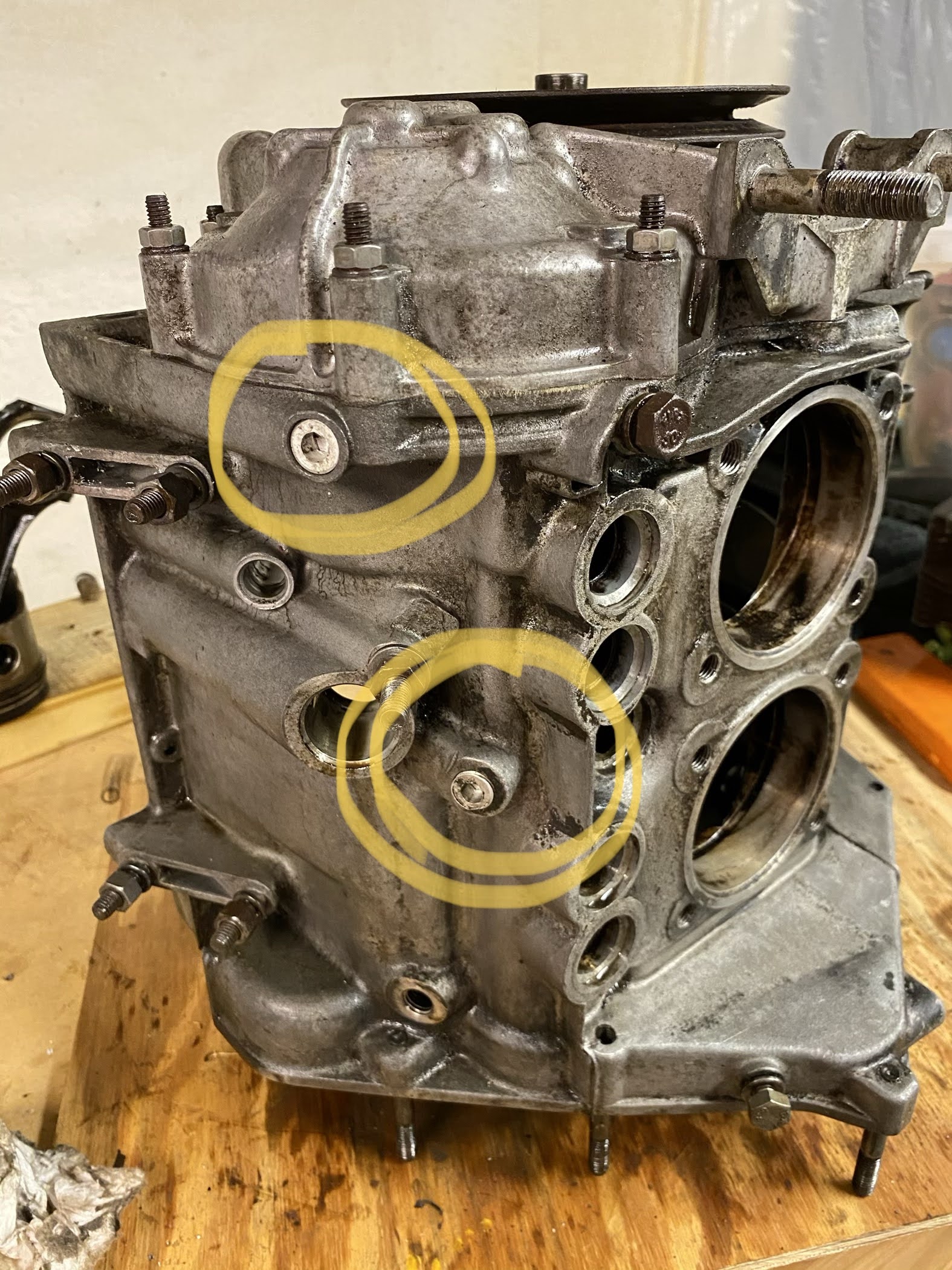

Couple questions... what are the allen-keyed plugs in the block? There seem to be 3 around the timing housing/oil pump and 2-3 more on the sides of the block/inside by the cam. Most are highlighted in the pics, but all but one are rounded out, so if I want to pull them, I'll need to extract them and get new ones. Is that necessary or what?

Everything seems to be pretty well OK. Phew! The aluminium plugs are (I think) casting plugs---they are screwed in. The trick is to (gently) hammer in the nearest, next size up, 'imperial' allen key as they easily deform. I would not take them out until you have their replacements! I tend to leave them in.
I believe those plugs are there to cover the holes needed in the manufacturing process / drilling then plugged and not intended to be removable which is why they are so tight. The thread is M12 x 1.5. You can get small sump plugs in this size if you get yours out.

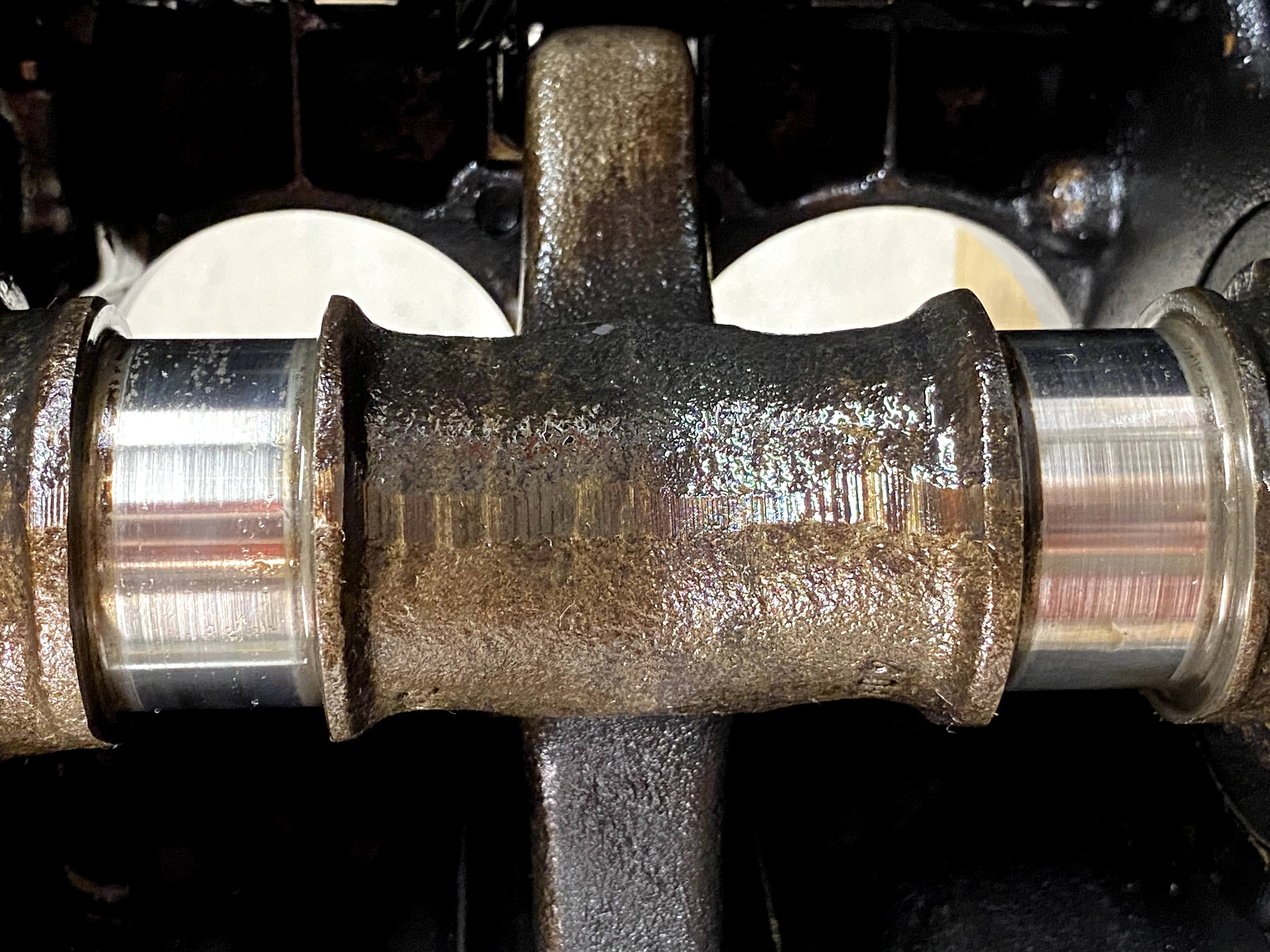

I was just thinking that even if all your journal sizes check out AOK it might benefit you to find an engine specialist who could do a polish job on them. I don't know how Browns did the polishing but I suspect, having polished journals myself using very fine grade emery, that they used something considerably more sophisticated and precise. The Ambassador ran faultlessly for many years and later, when I traded it in for a Mk2 1.8 SRI Astra Estate, saw duty as a taxi!

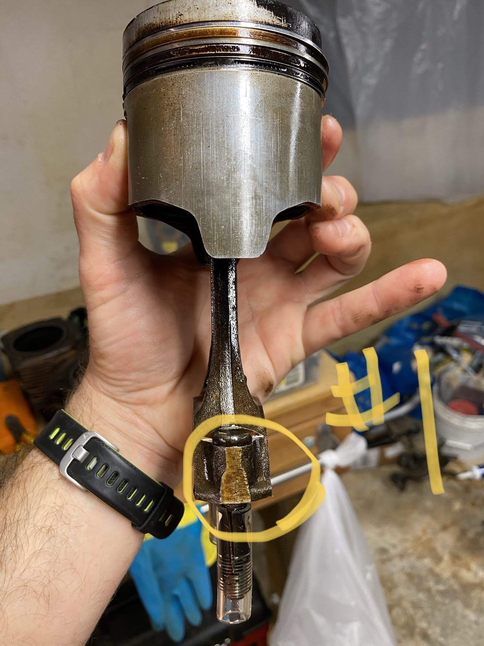

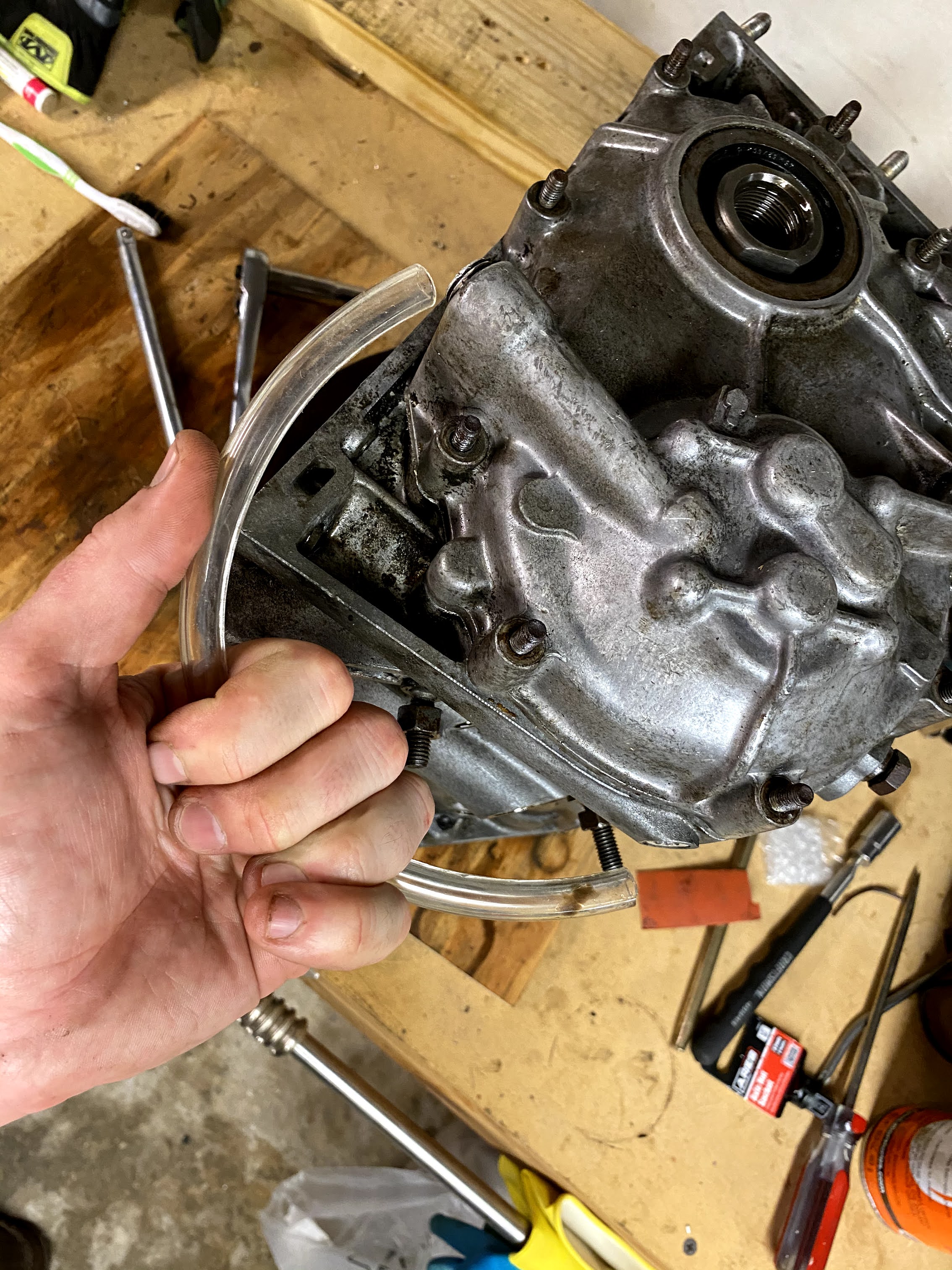

1) The teardown continues and everything looks good thus far. Only the crank is left to remove. So... what have you guys used to remove those phillips screws on the front main bearing holder? I don't have any screwdrivers close to large enough and fear those will easily round out if I try something else. Since I can't easily bring the whole motor to the hardware store to test the fit, is there a specific # that fit them?

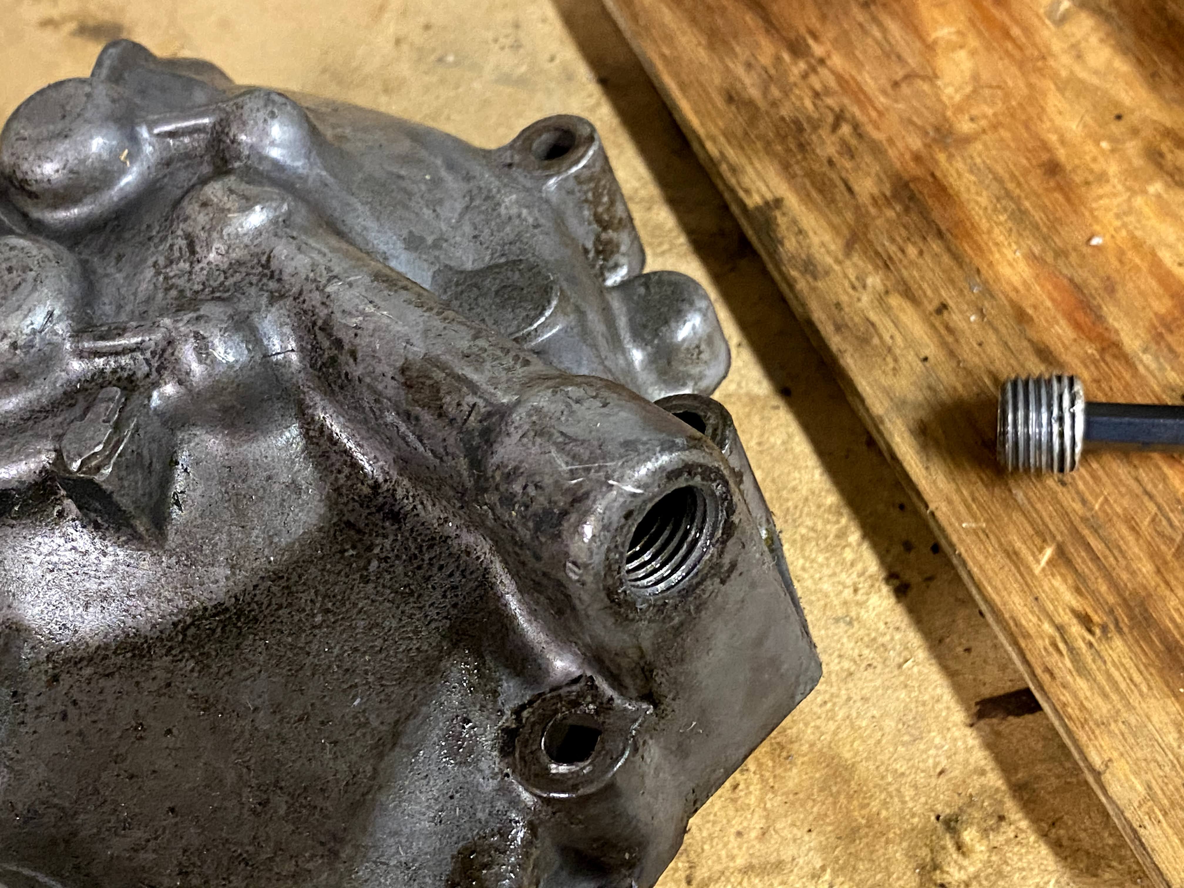

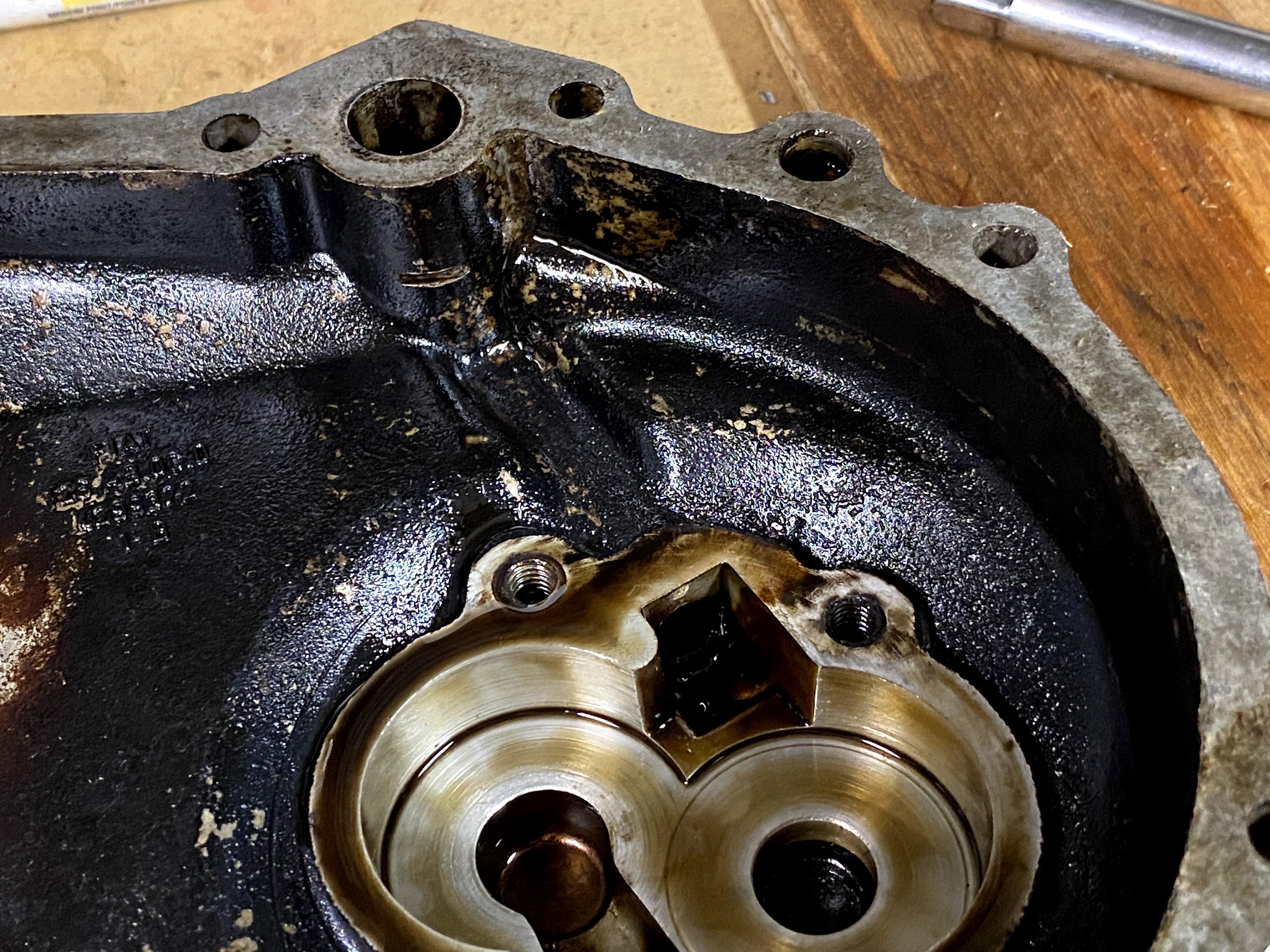

2) So two of those plugs I asked about earlier - one in the timing cover, the other in the block, are obvious oil passages, one in the feed to the oil pump - it tees at the pump input with the sump pickup - and the other comes off the front camshaft oil feed. Can those be used to tap into for a remote, conventional oil filter? All the kits I see have other hookups on the timing cover, but can you not use those two lines? Something like patching in a filter between where I'm holding that piece of clear hose in the pics. I can't find an oil feed diagram anywhere online to validate this.
3) Since I was at an impasse, waiting on a honing tool and lacking the proper phillips head, I decided to try a little old-school hot-rodding style on the spare tin work. With the new motor, I plan to fit a conical filter directly to the carb intake neck, so no need for the original air filter housing, so I cut it off and cut out the bottom half of the top cover. I'll grind it clean, get a circular patch welded on, clean it up, and see what it looks like. A lot cheaper than some of the fancy cast aluminum ones. What do you think? Feel free to chuck spears. lol.
