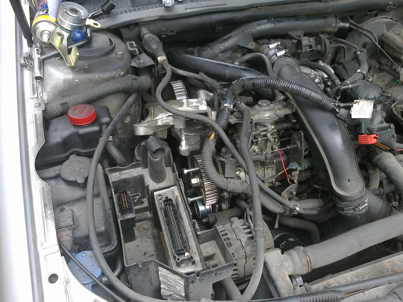

Got a T-Belt kit and attempted to fit it on... (lack of cameraphone is annoying :bang:)
11mm bolt on the rear cover was a real c-unit to get at! But I got it :slayer:
All was going well untill I got to the pulley bolt. Jumped 4 teeth back :cry:
No valve contact though :)
I'll get it off... ;)
And its all back together :)

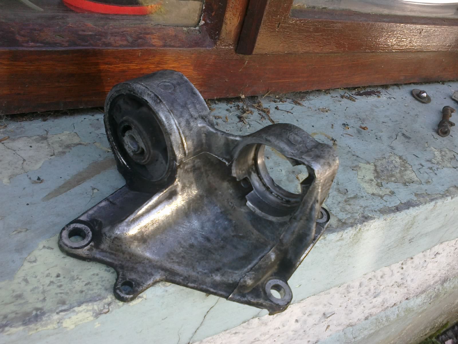

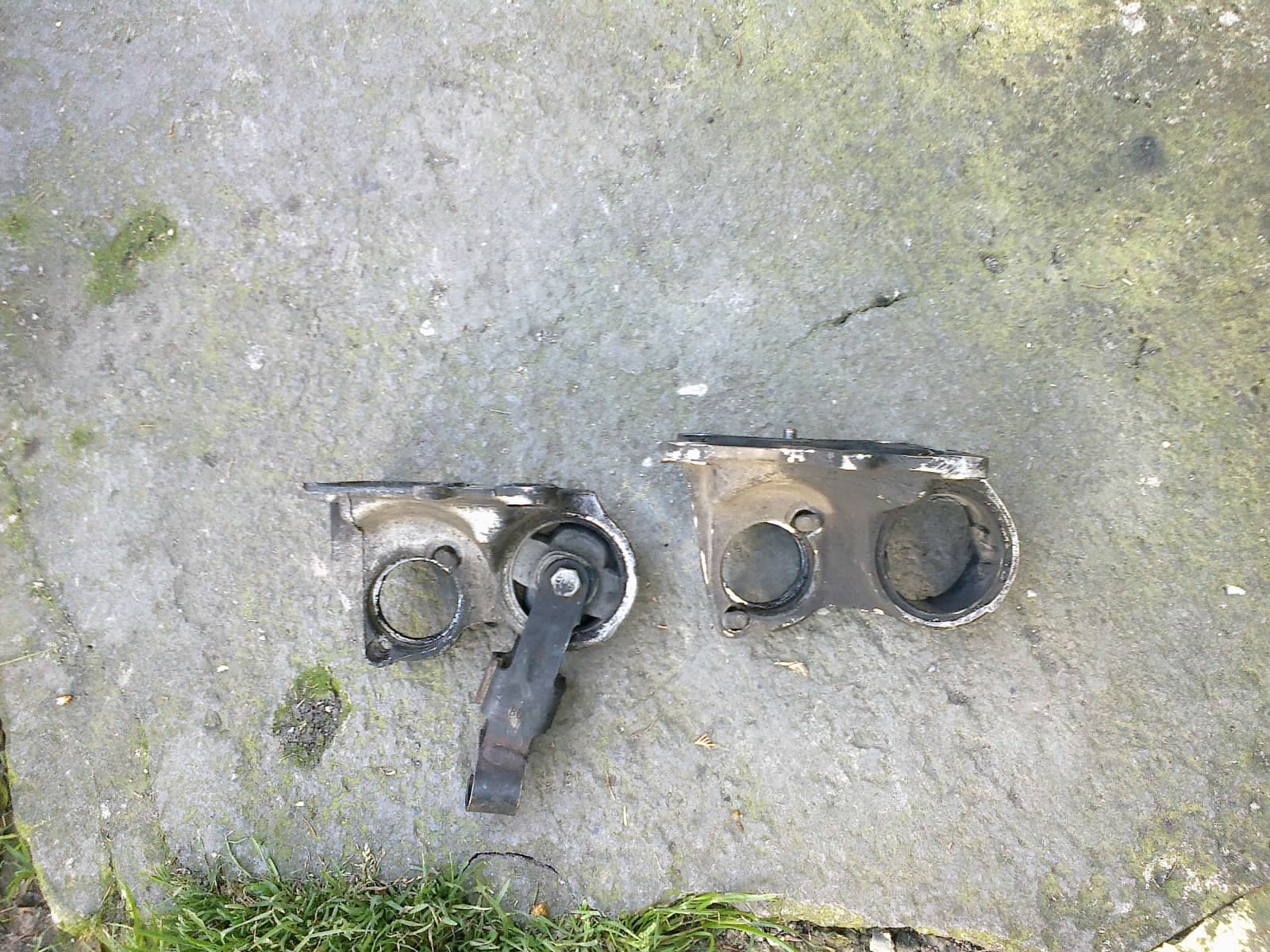

Time to sort the wonkey engine!
A straight foreward job... Became a pig of a job :bang: Everything seized! :mad:
But I got it out :slayer:
So why was my engine wonkey? Here's the old and the older side by side
Yep, no centre :eek:
Cleaned up the new old piece
Fitted and much better :cool:

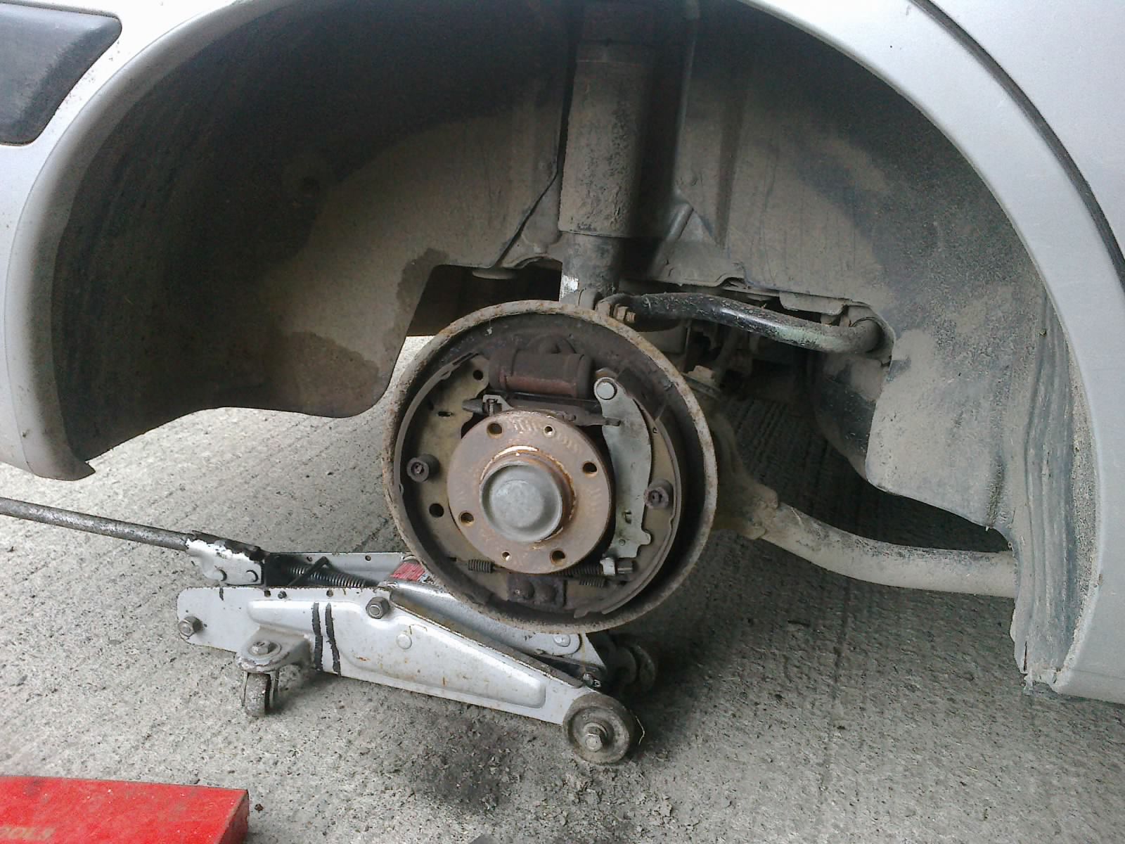

This evenings job was to sort the crappy handbrake. So off with...
Drums were then cleaned and painted :)
When all adjusted up, I put them back on
Kinda works, looks better with the wheel on (y)

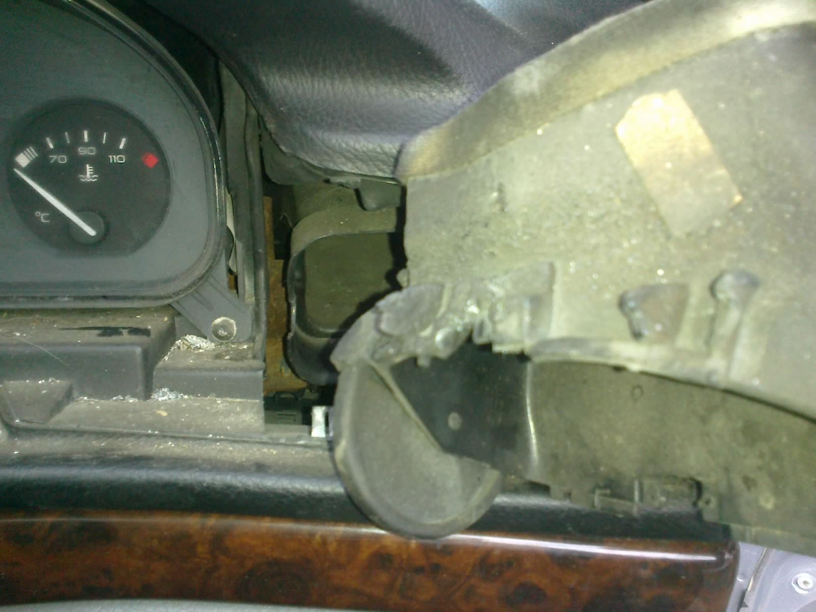

Off with the trim... This doesn't look right!
I was right, changed clocks at some stage :rolleyes:

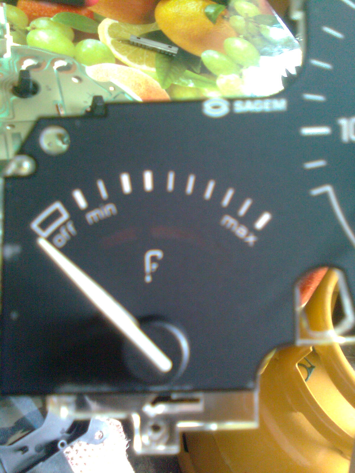

I cracked on, changed my bulb...
Then after cleaning the speedo we have miles again :D

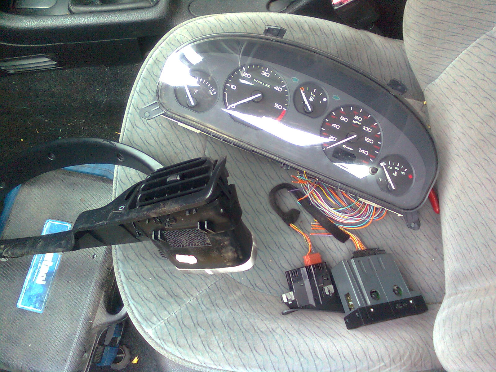

The speedo that came with it annoyed the crap out of me!!!
So back to the local scrappies and I got more toys (including a climate display and clock :))
OUT!!!
Change some blown bulbs...
Then put it in (y)
Note I have now lost 35k miles :bang: I'll put that right someday (y)

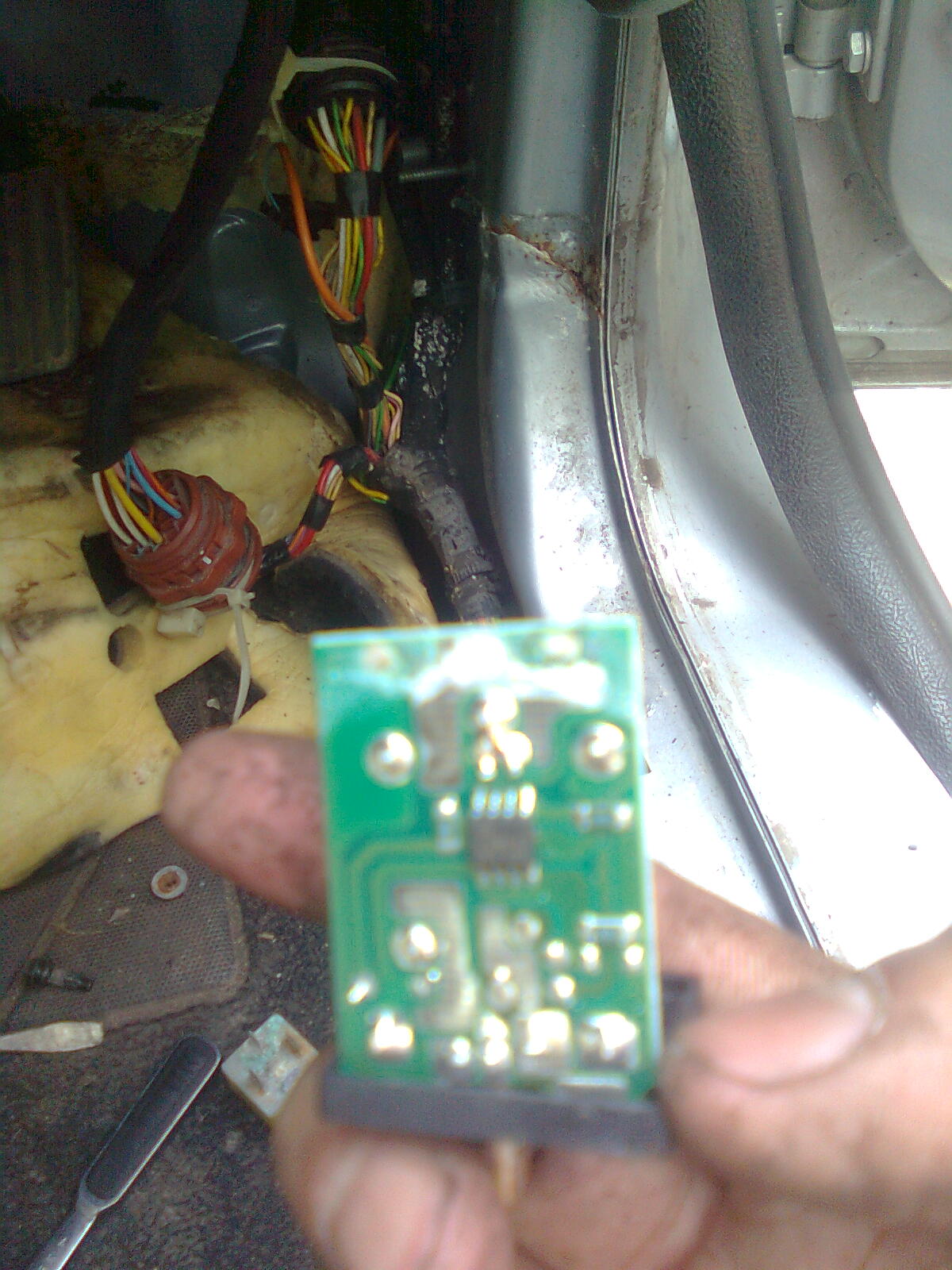

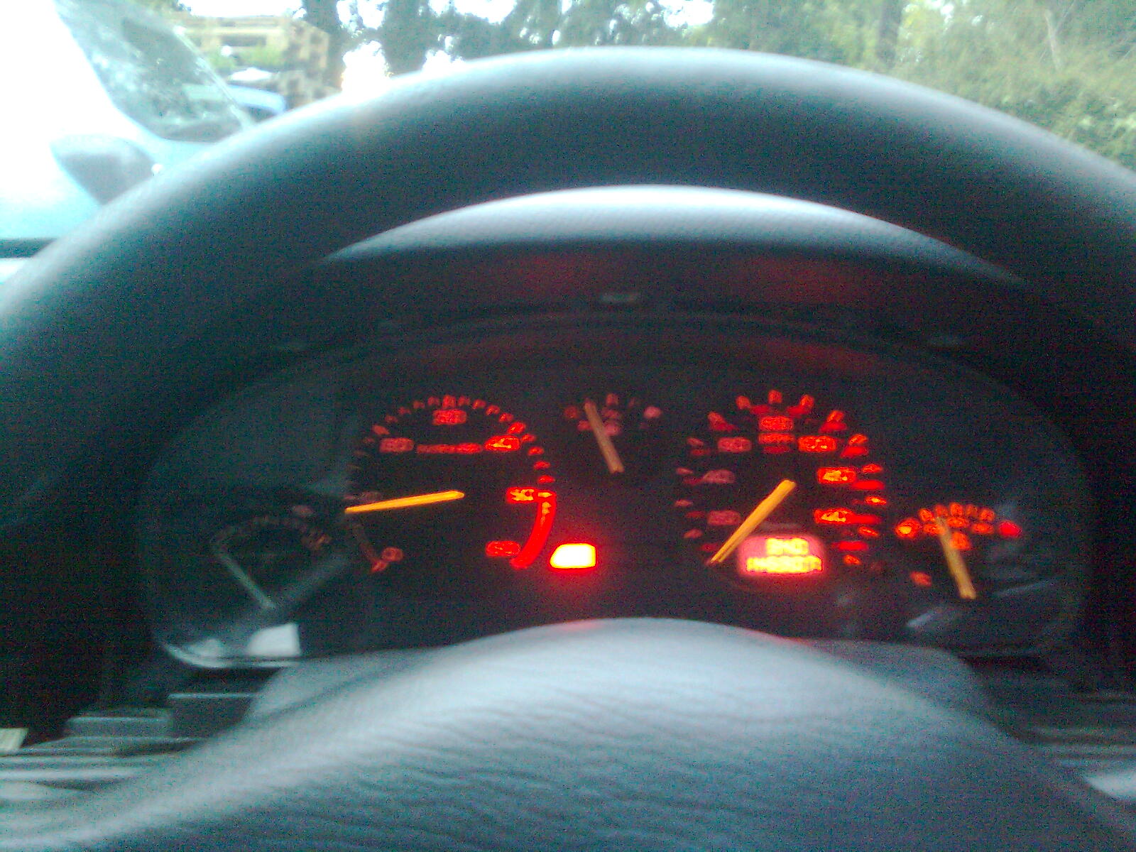

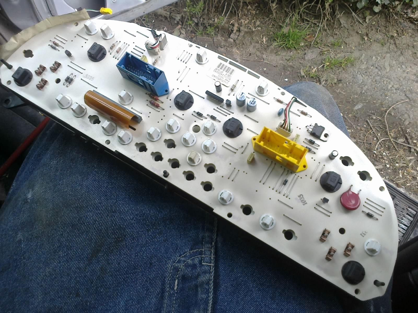

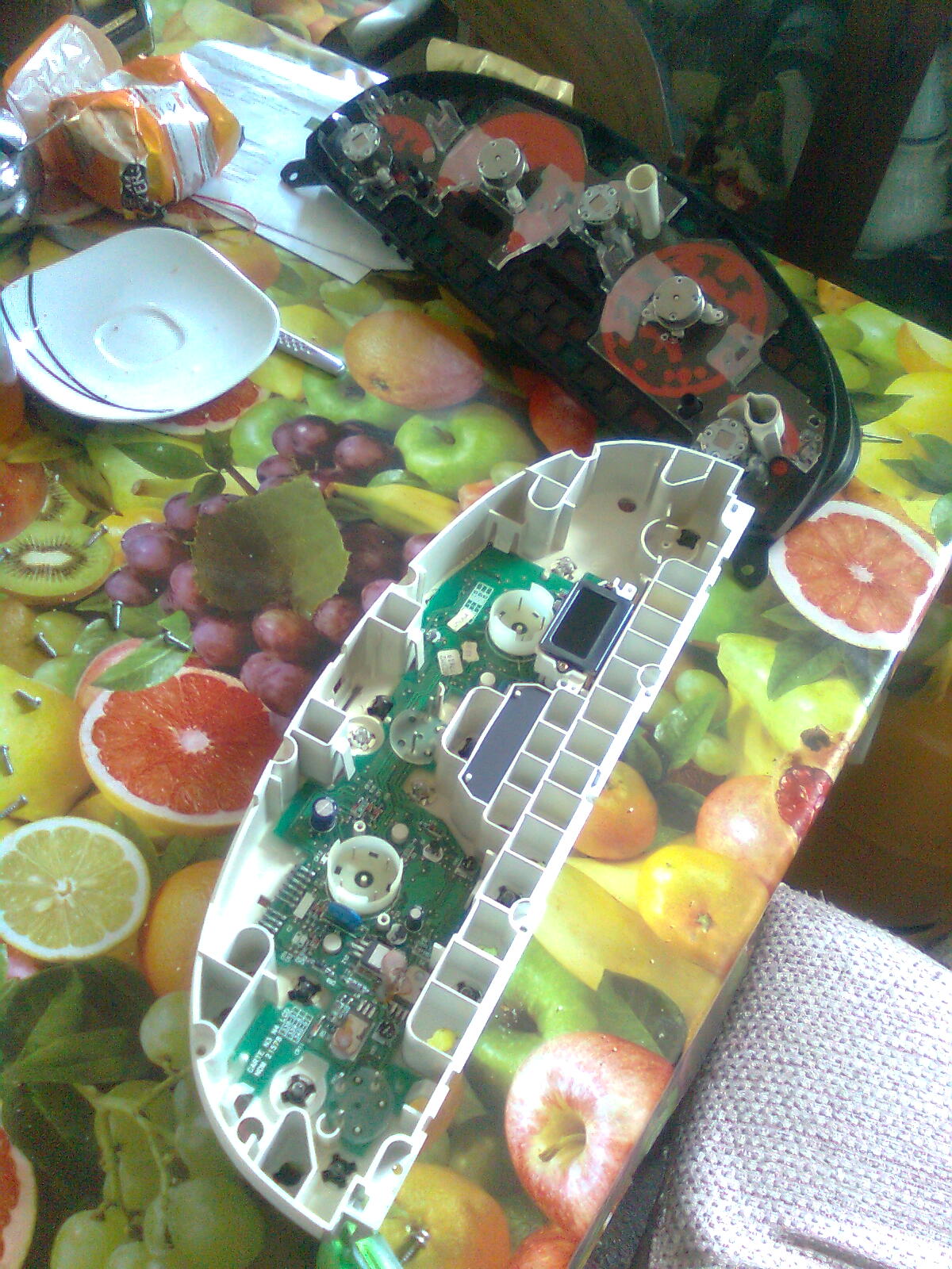

But a ha! Nothing is that simple with a French car now is it! Went for a test drive, speedo reads wrong :rolleyes: indicated 30mph is actually 70mph :eek:
So back out...
Dismantle more...
Oil level indicator :cool:
More inspecting...
Then I saw it...

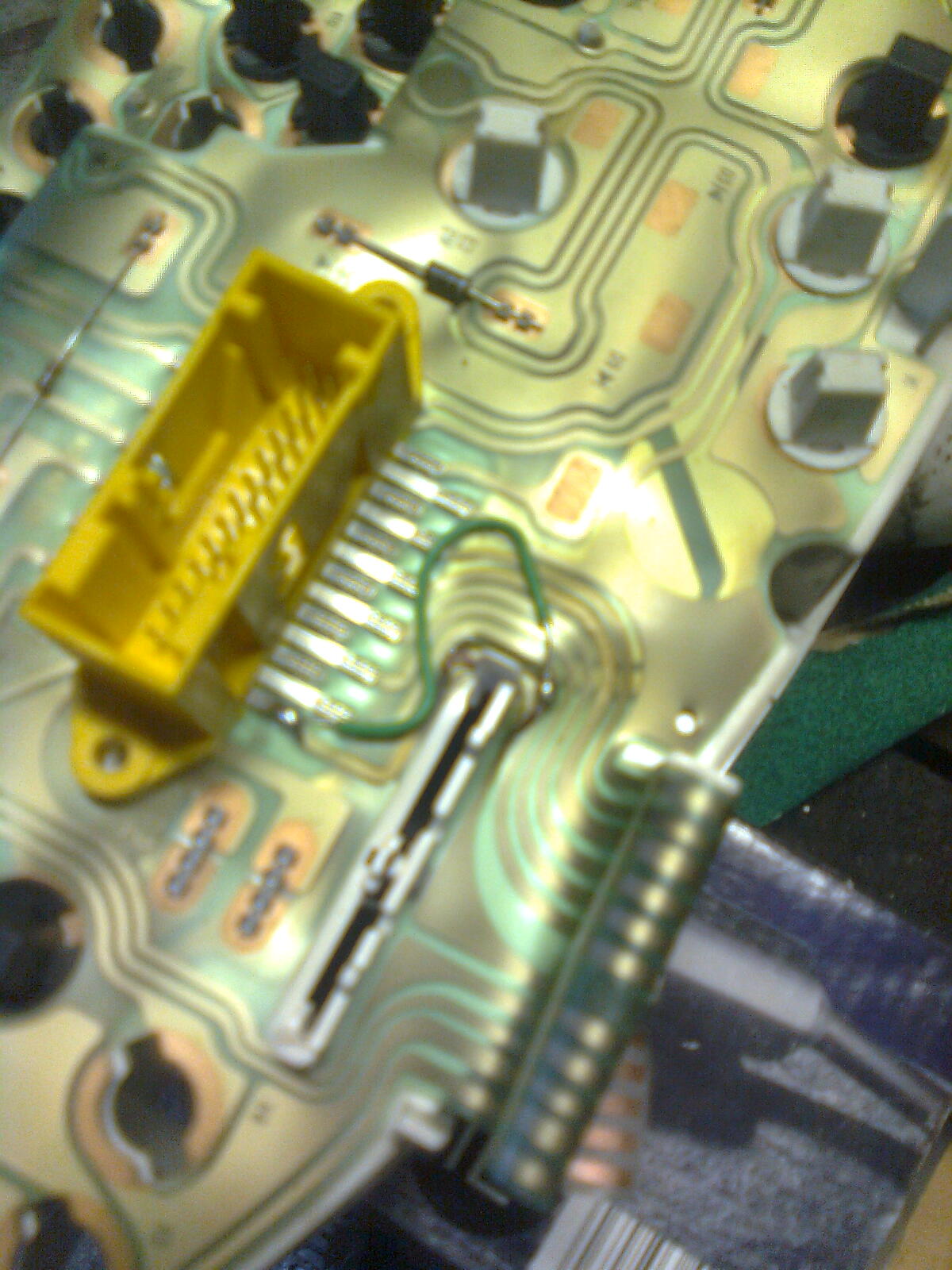

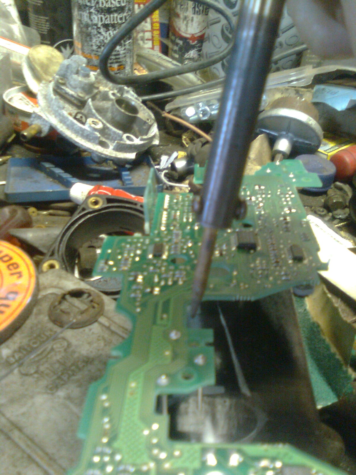

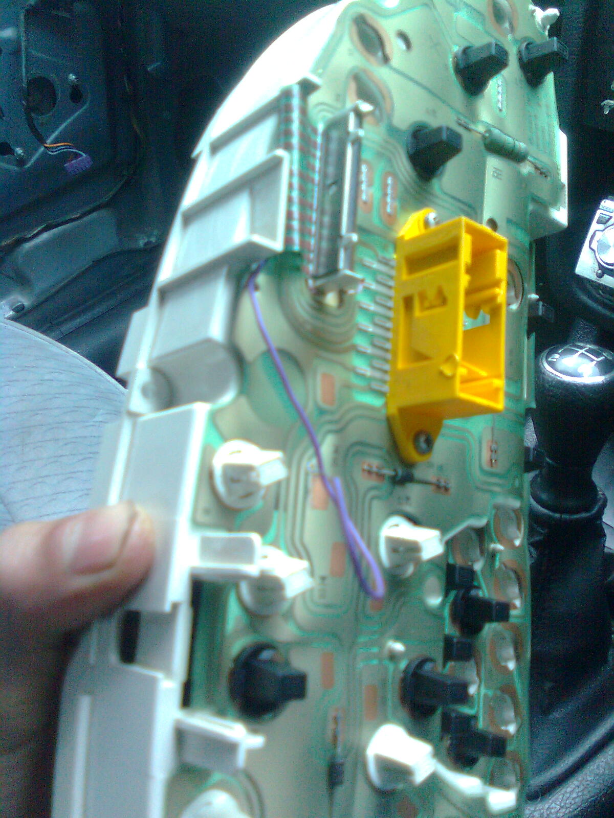

Broken track :bang:
To the garage! First, a vain attempt to solder a wire to the track....
Didn't work!
Next, solder a wire to the pcb direct...
Then using another set of plugs as a guide...
Find the correct wire
Then splice and add another wire (y)
Connect...
Didn't work!
Back to the Alfa Romeo office :D
Manually adjust the needle using the small wheel....
After a few drives with a sat nav, I got it as right as I want it to be (y)

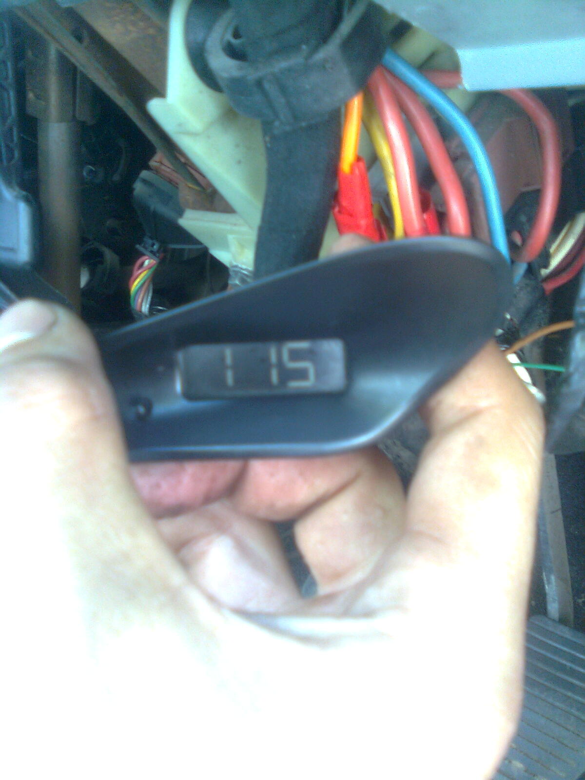

Firstly, we get miserable "paddy spec" cars over here. The most basic, crappy, bog standard things no one wants :mad:
This car didn't even come with the digital clock! :bang:

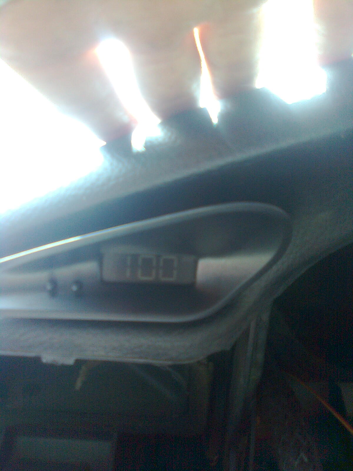

And trying to find the plug... I finally found it (y)
Clock now works :D
Now to get the plug up through the dash... A pig of a job! But I manoeuvred the plug and got it all in situ
Much better :D

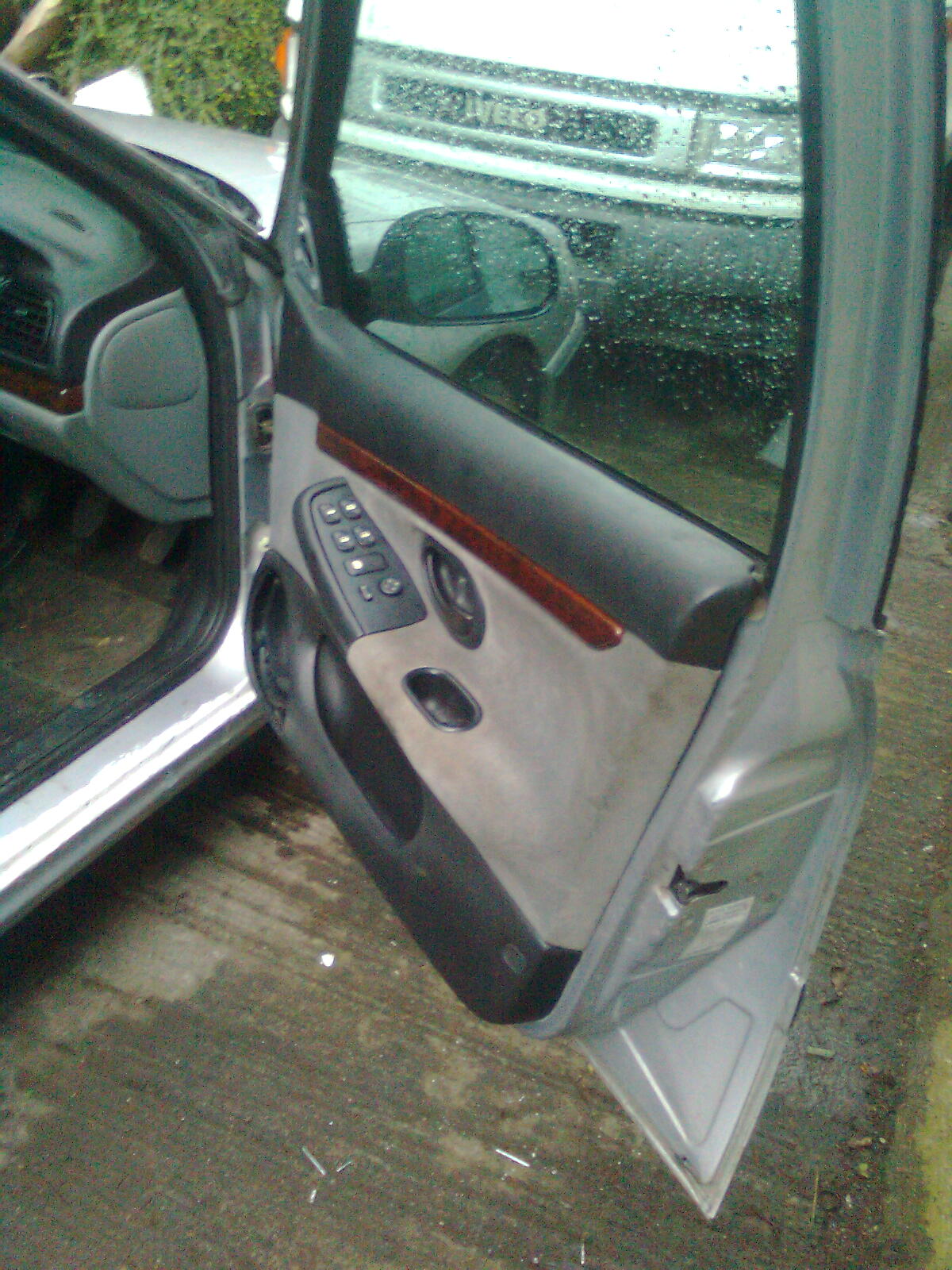

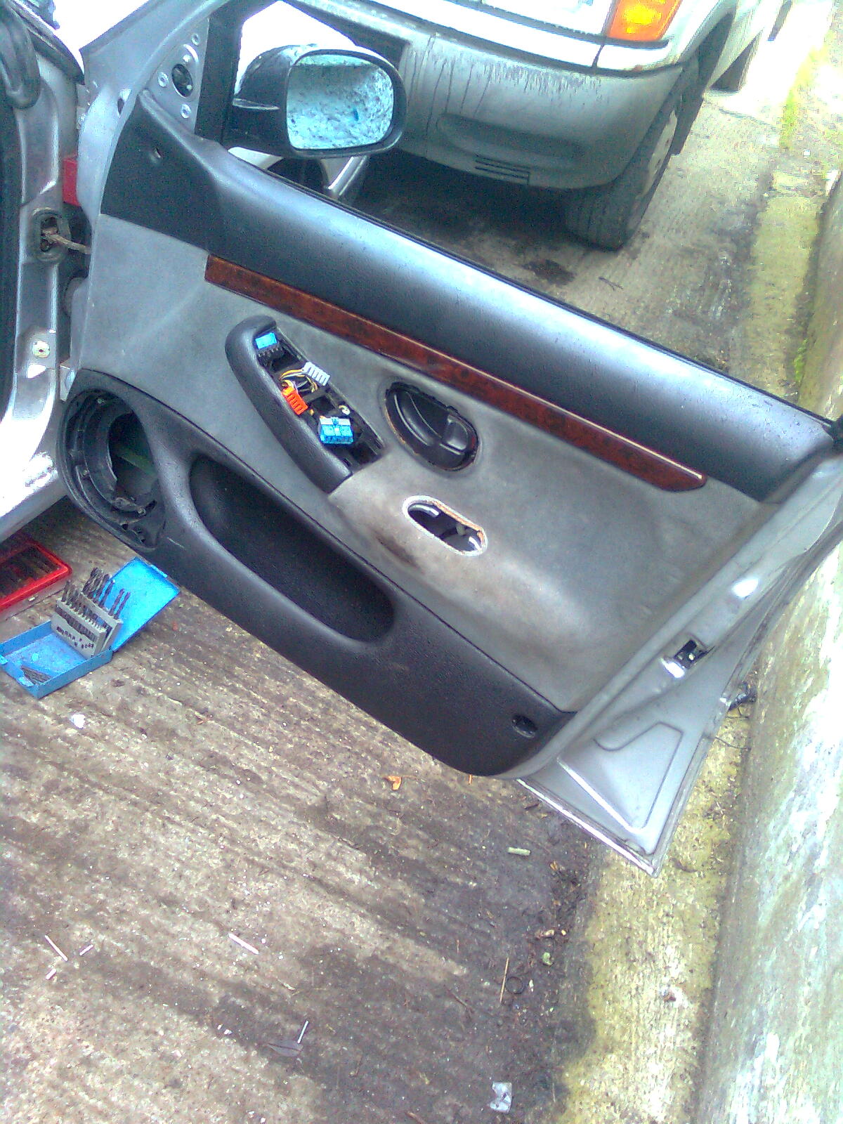

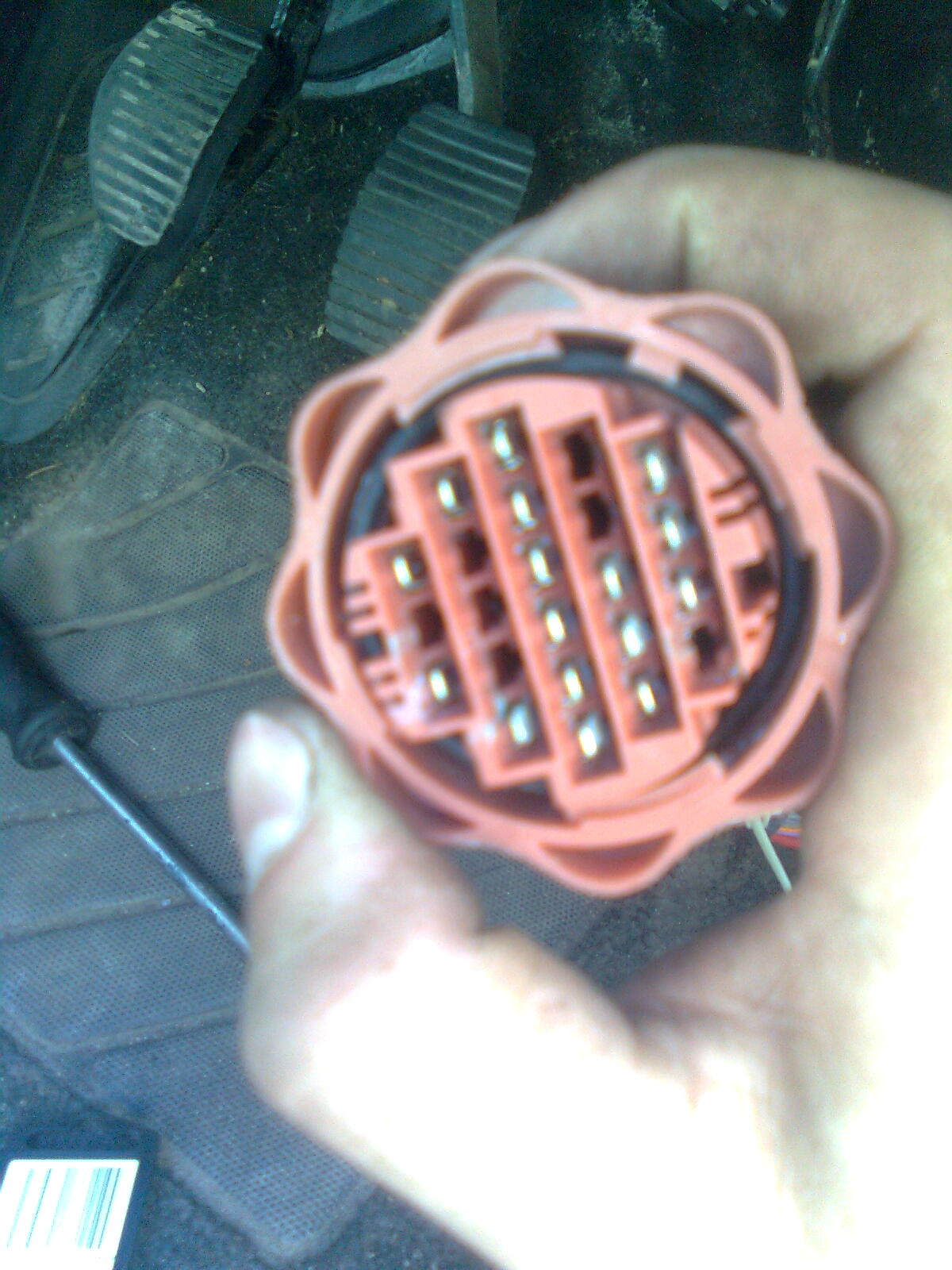

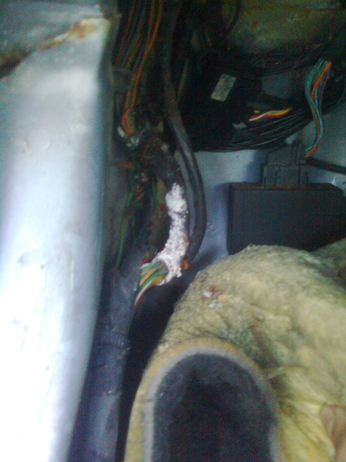

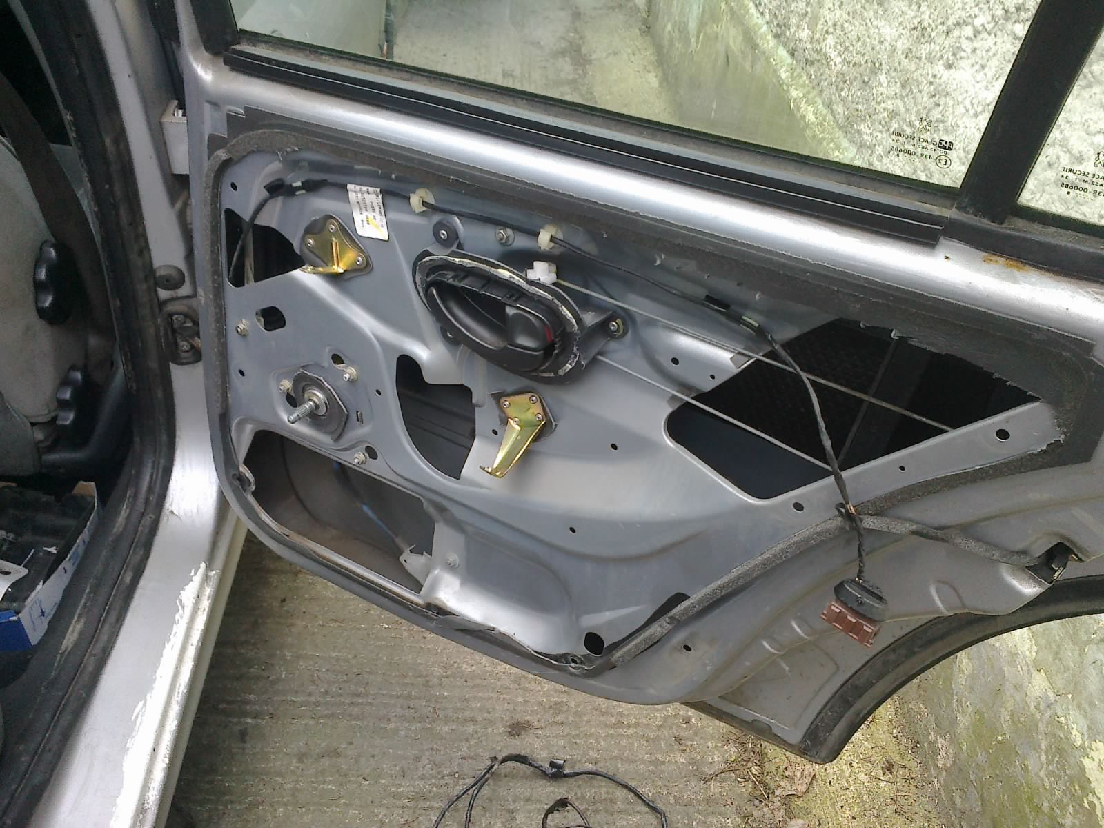

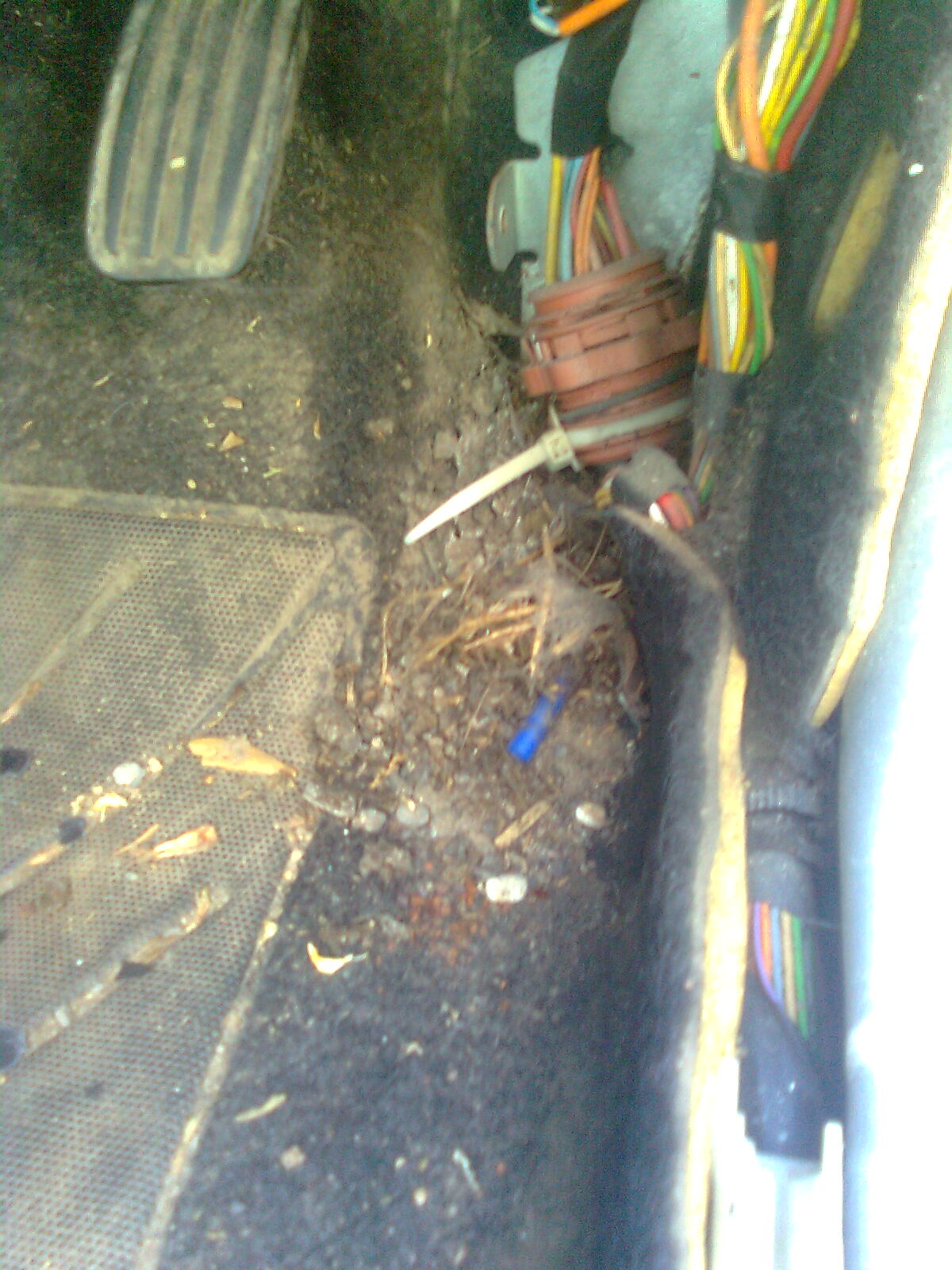

Now onto my next problem: My passenger window didn't work after new switches and a motor. Off with the trim...
DISGUSTING :shakehead:
As you can see, here is what gives French electrics a bad name
Poor design leading to damp build up and corrosion. That was just the start!
This was fun to do, contact by contact, each side and the matching plug
It got messy very quickly

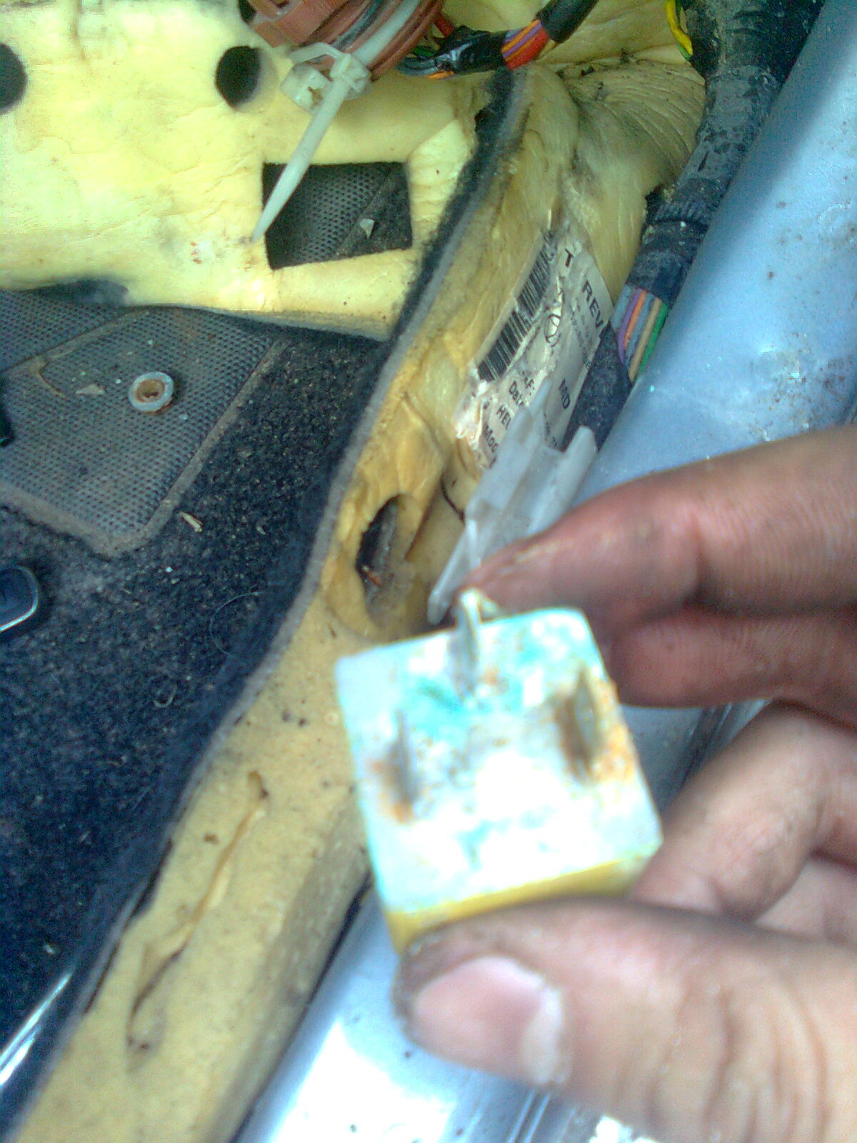

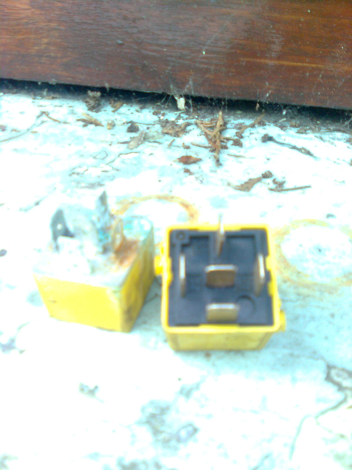

While I had the space I said I'd whip out the relays for the crack. Just as well I did! :eek:
A substitute was duly found
Courtesy of BMW ;) take that French electrics! :slayer:
Another relay was also corroded... On the inside too!
And after all that, put everything back together...
It works once more (y)

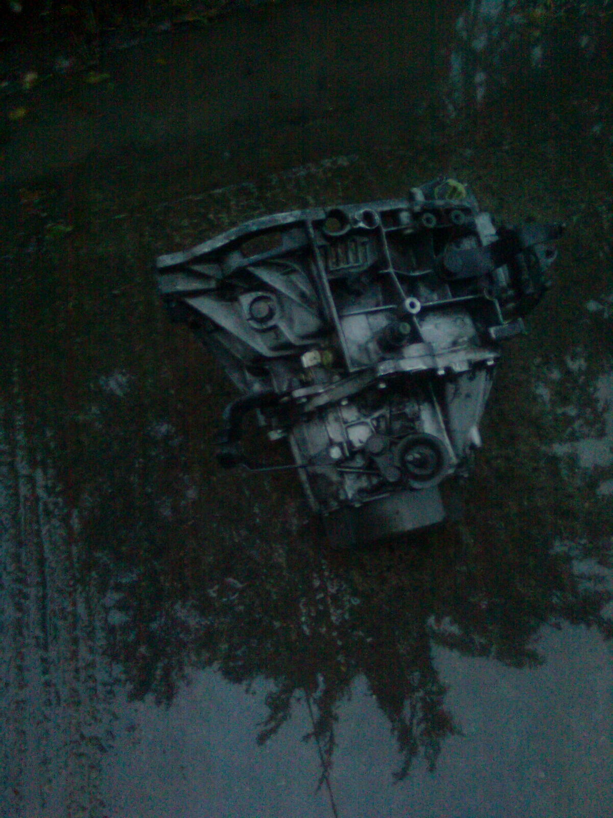

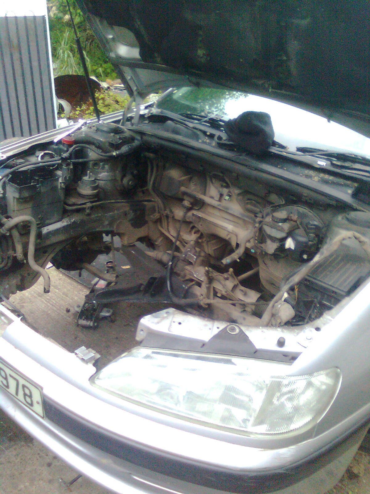

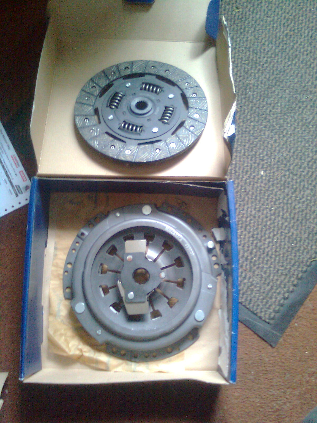

Bought this on Saturday (y)
Typical French. It's a... Pull clutch :bang:
So today... Time to take my time as I haven't worked on one before :)

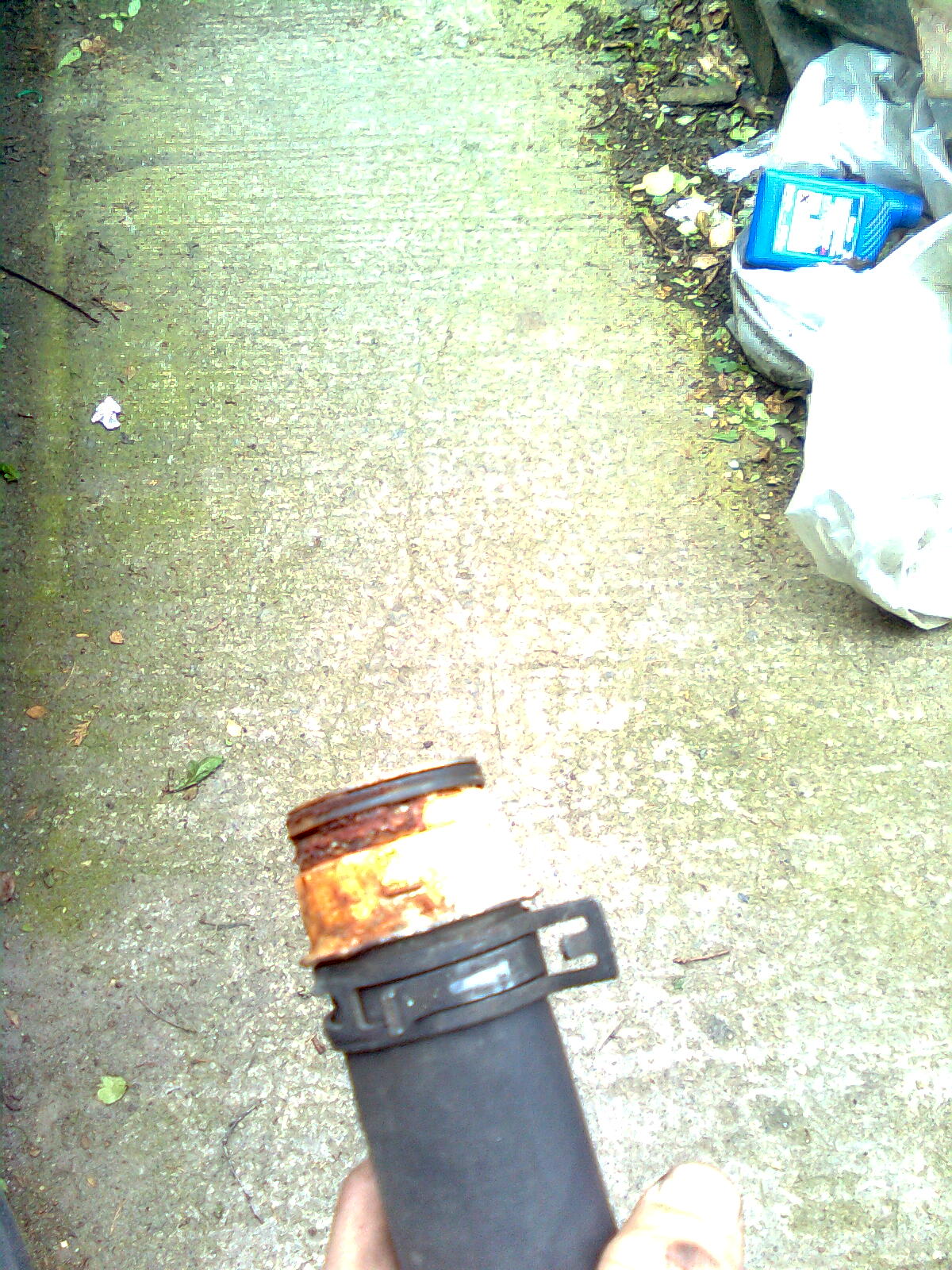

These were a nightmare to take out due to being seized in place! They're for rad hoses
See? :eek:
I don't think coolant should be this colour...
What idiote designed this??!
Eventually
Signs of a rough farm life :(
Dog rough (it stank of dog!!!)
Plenty more room :)
My old friend...
Lastly before the mounts, remove the grille
For a clean bay (y)

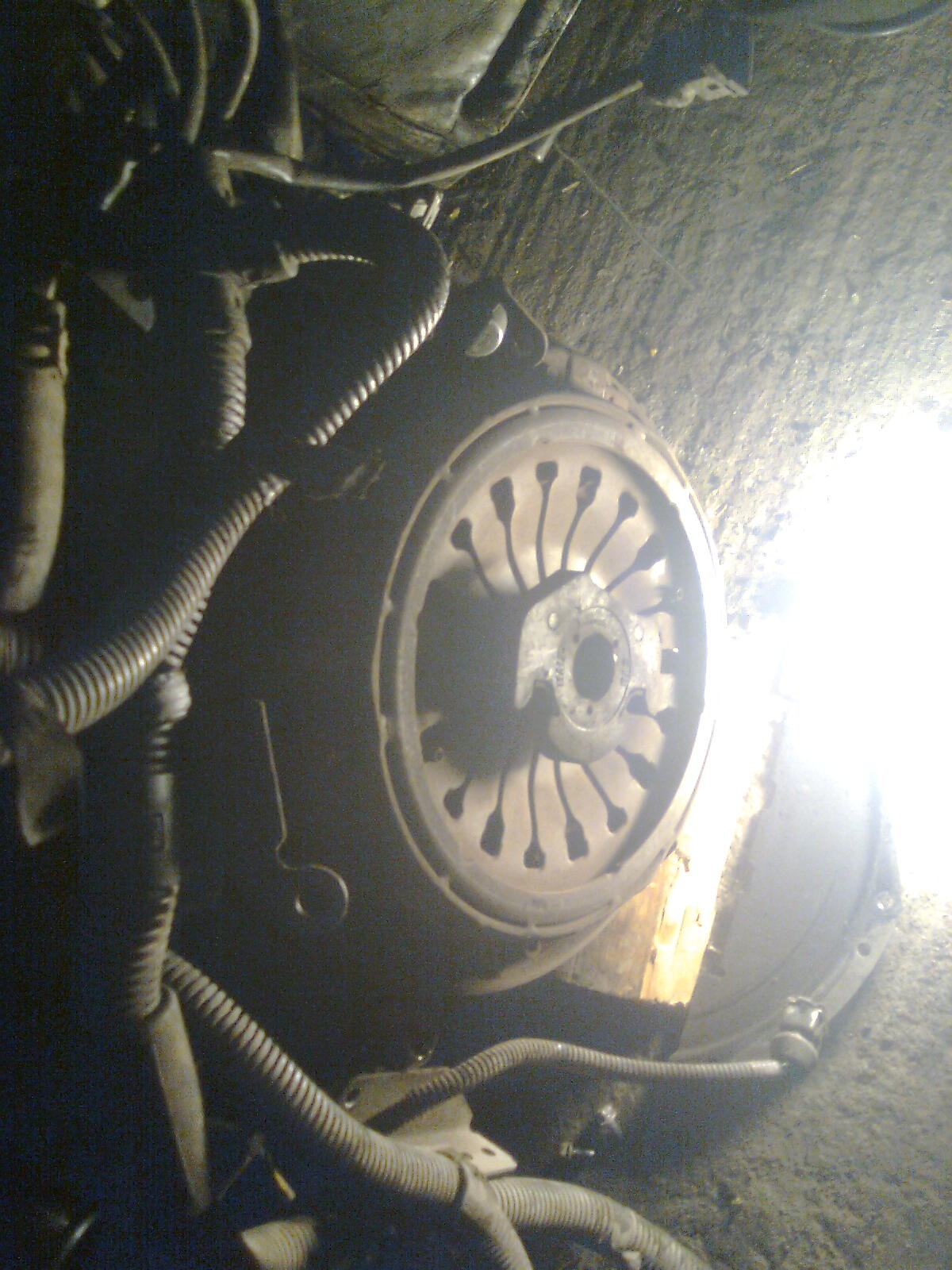

This was fun to get to this stage!

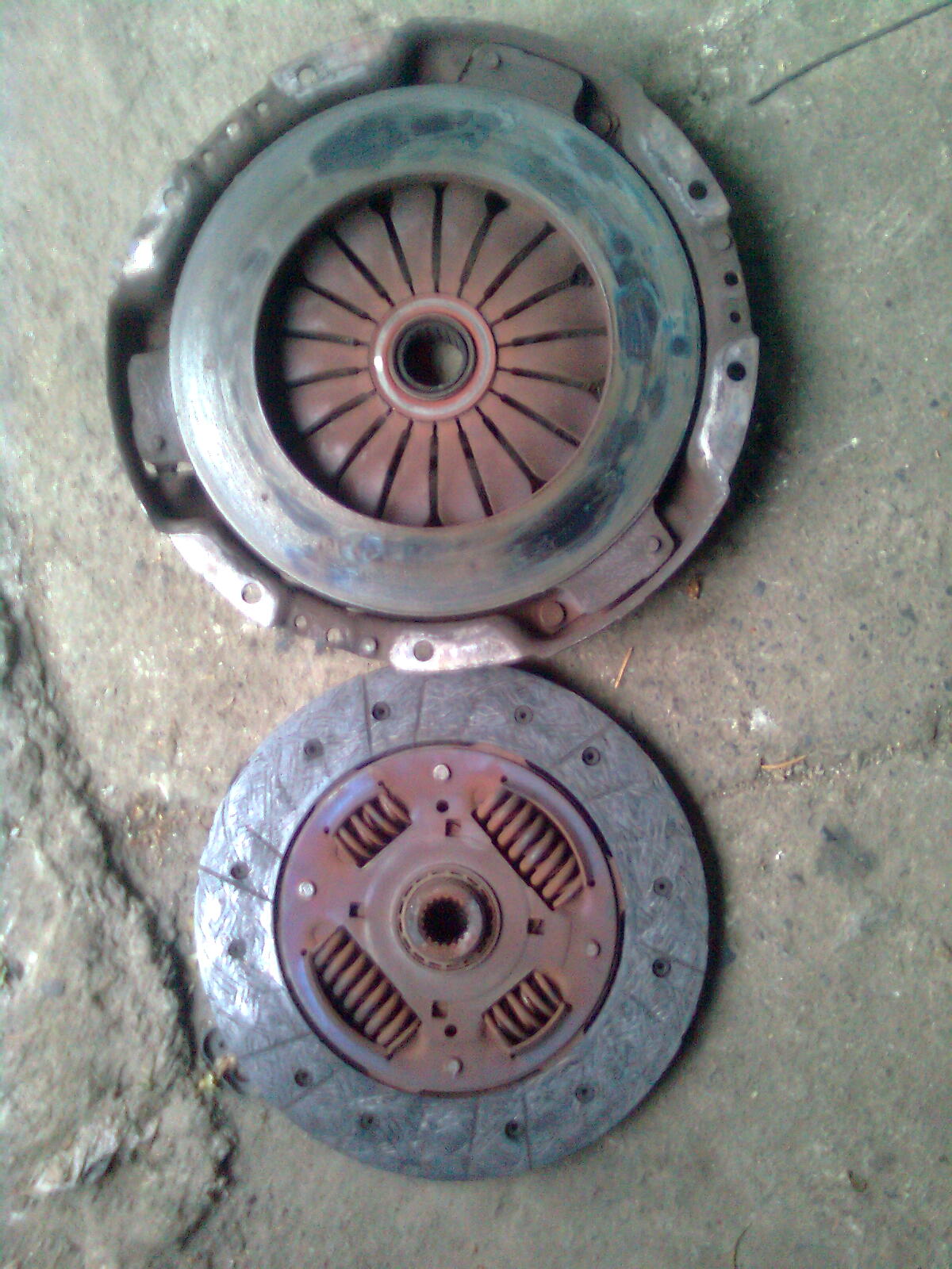

But alas, have to wait to see what the clutch was like... ;)
I should spell the badge backwards for the laugh :ROFLMAO:
Aaaaaanyways...
Note the blue
Not much life left! Also, more blue
Blue= heat :(

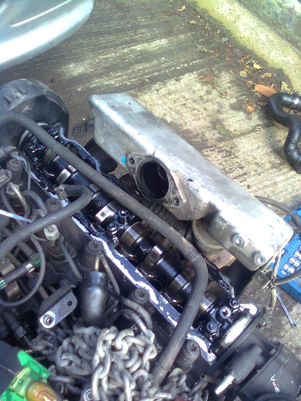

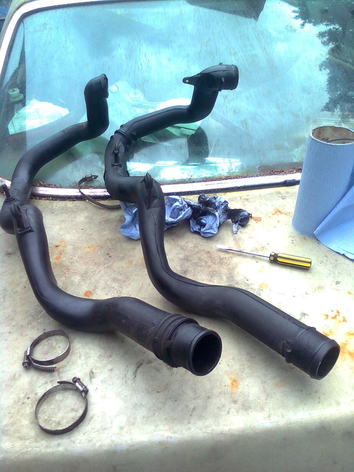

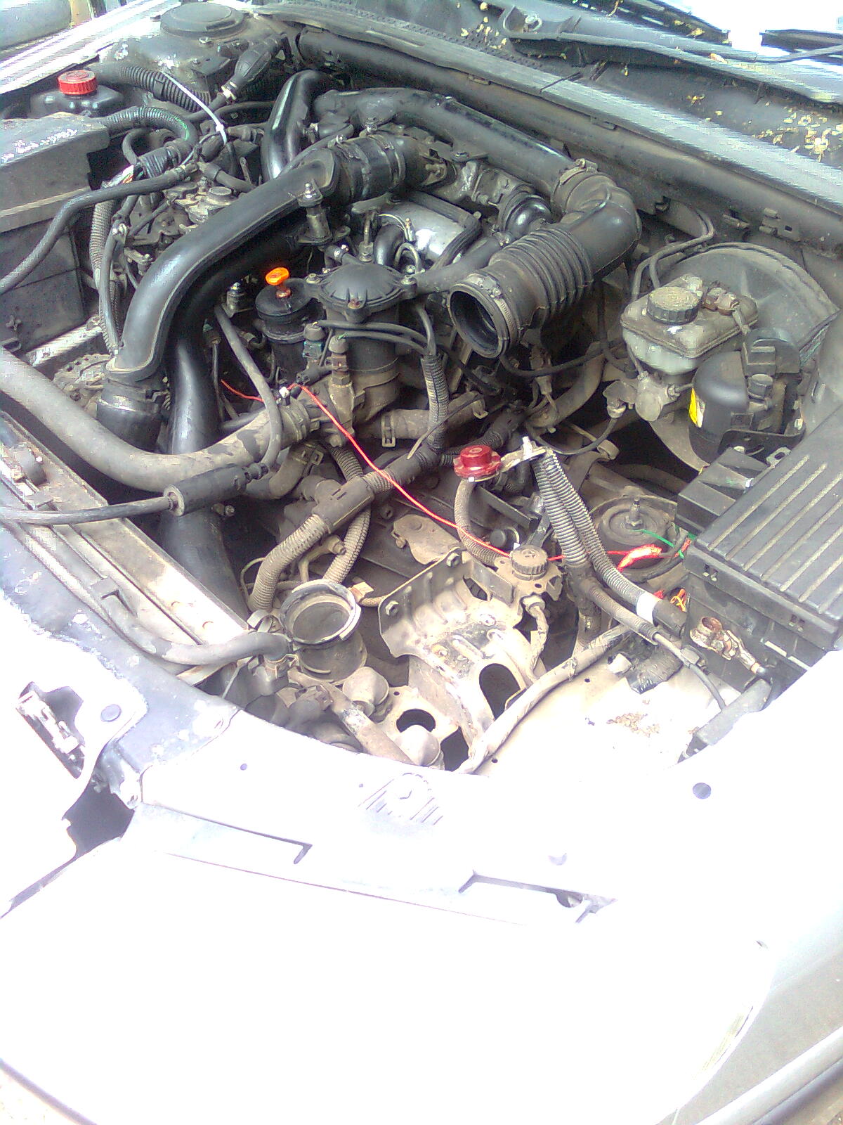

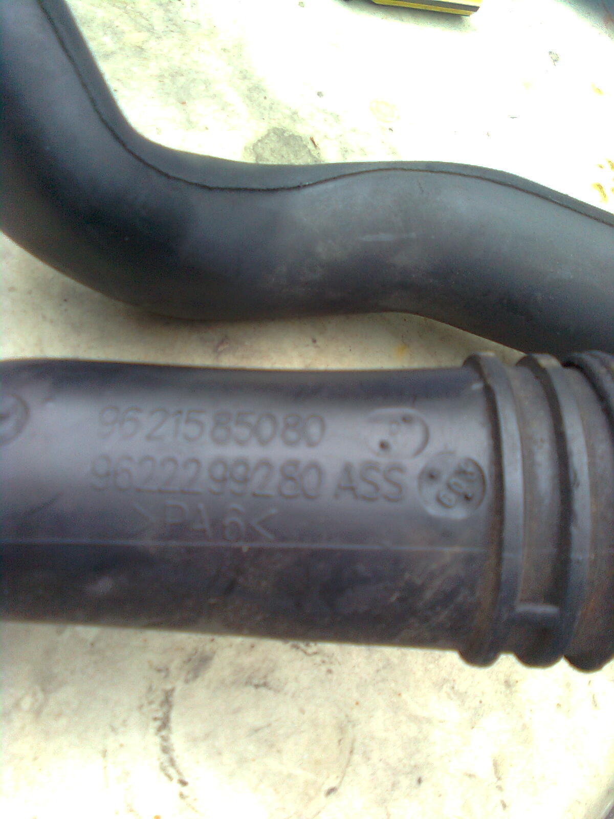

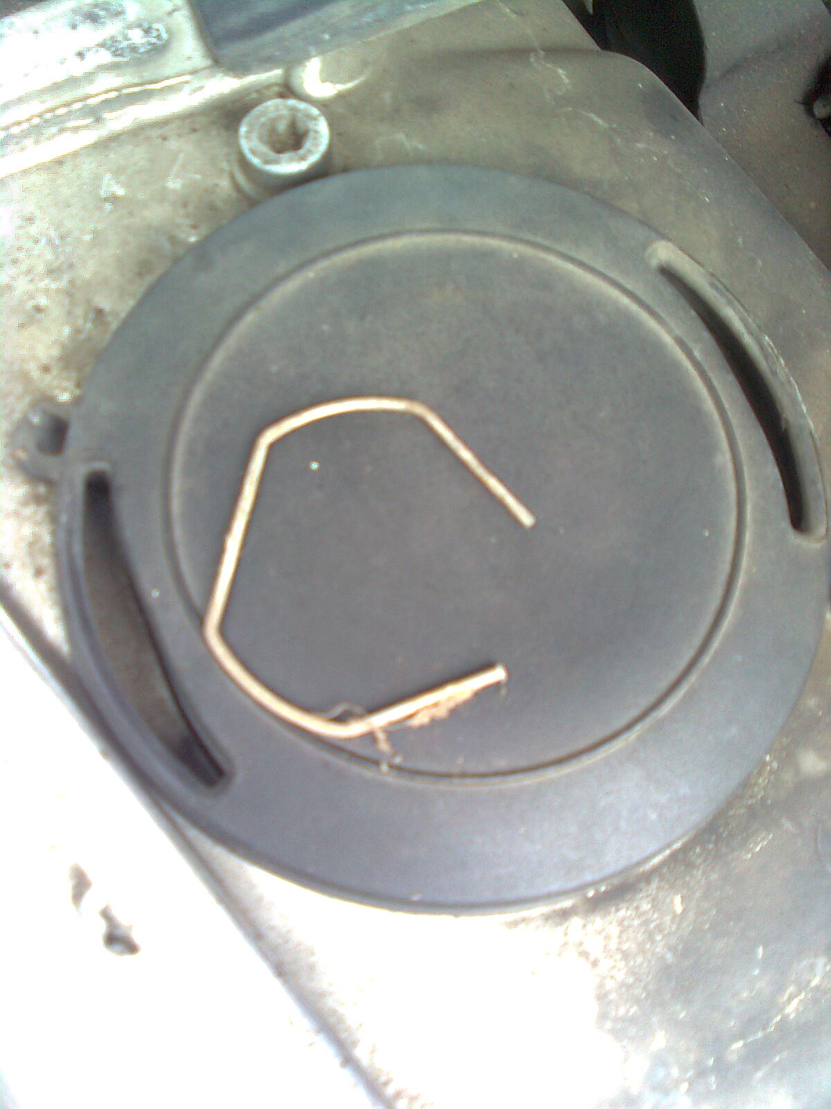

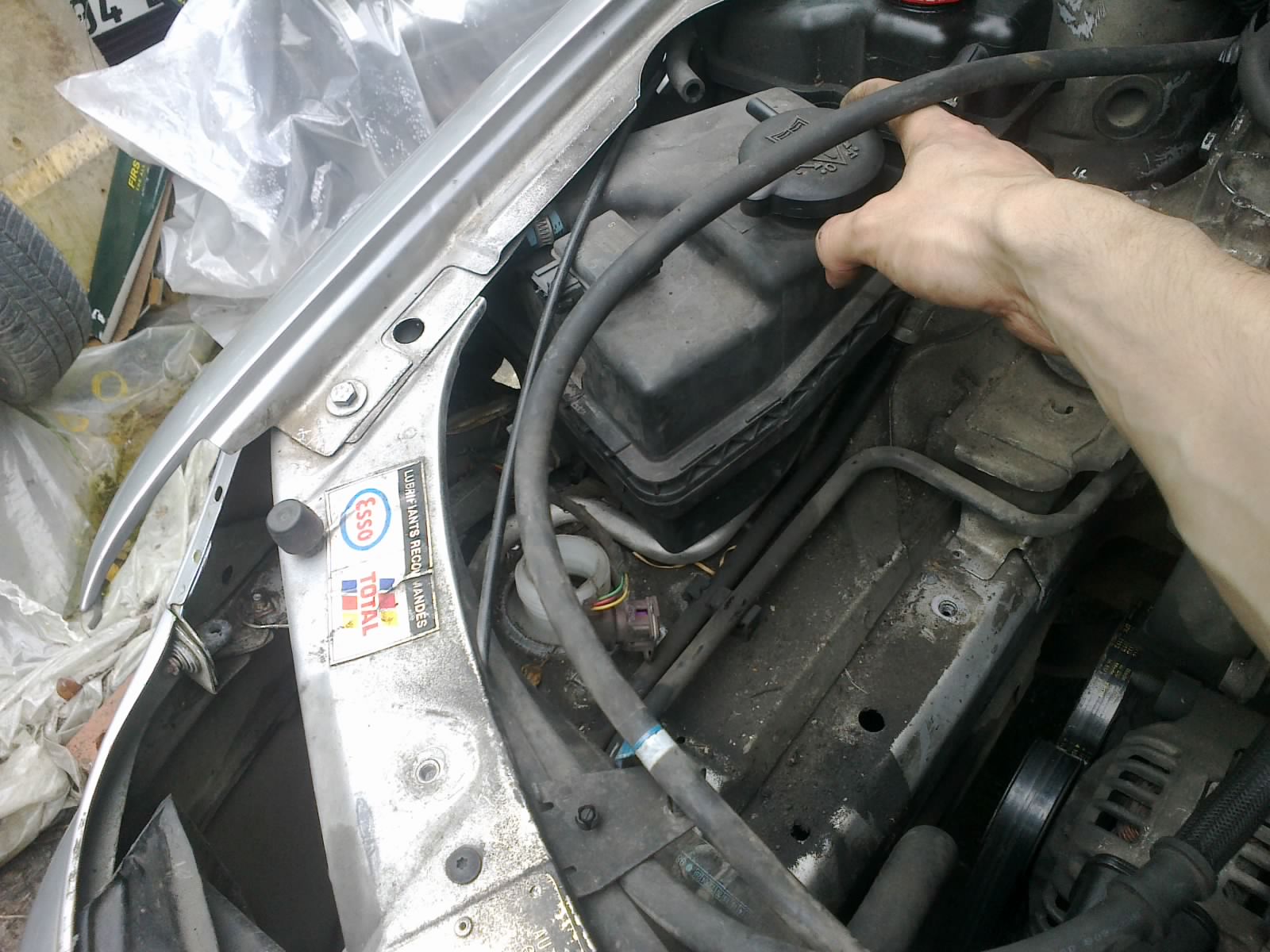

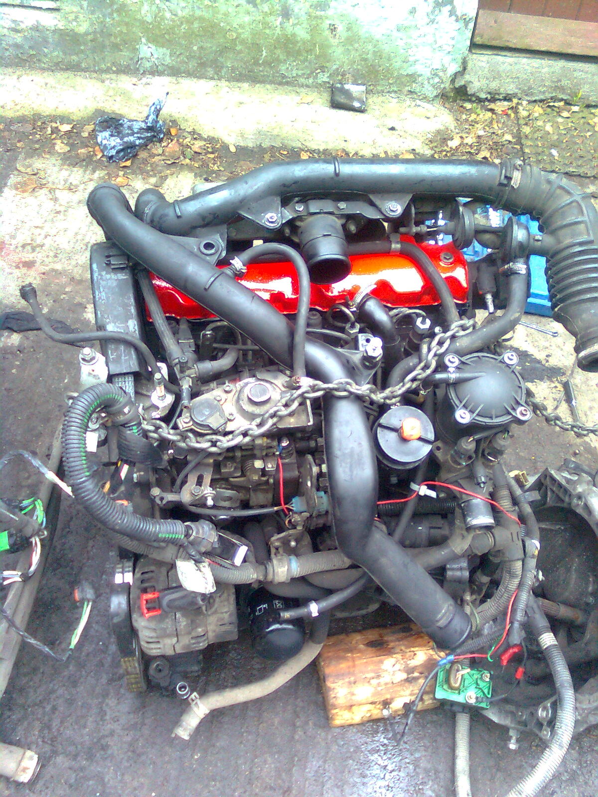

I also decided to get a new turbo pipe
Because the old one was a load of...
How convenient eh?! :ROFLMAO:
Part of the old pipe, broke and still bolted to the manifold :rolleyes:
I decided, while its out, I'll clean some of the oil out
There too
And decided to clean the rocker cover
Much better :)

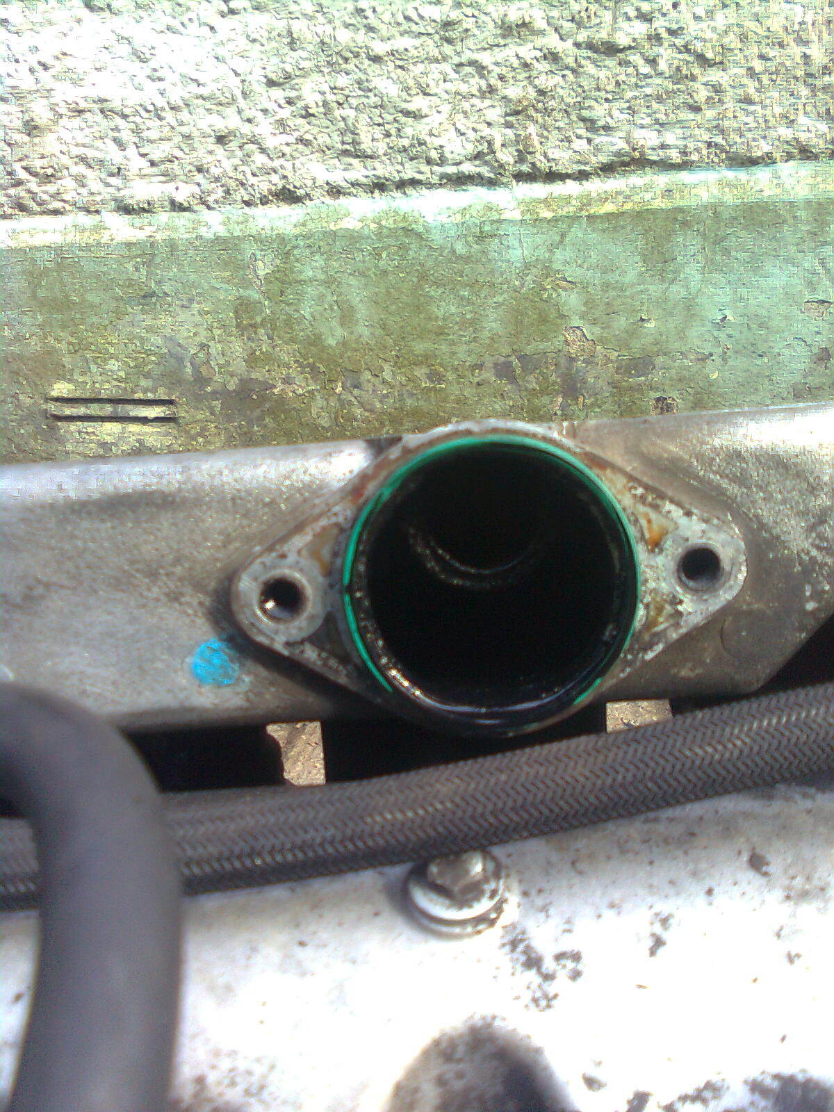

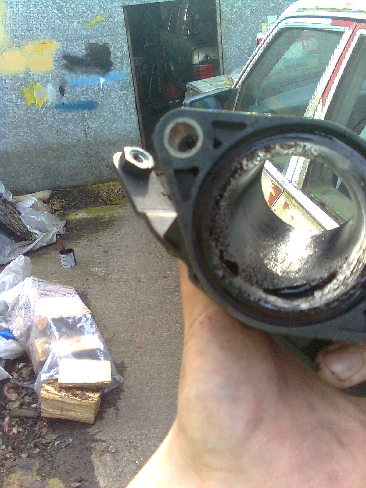

Next, the thermostat
New one :)
Eventually...
A short while later...
And installing it
Just needs plumbing up (y)

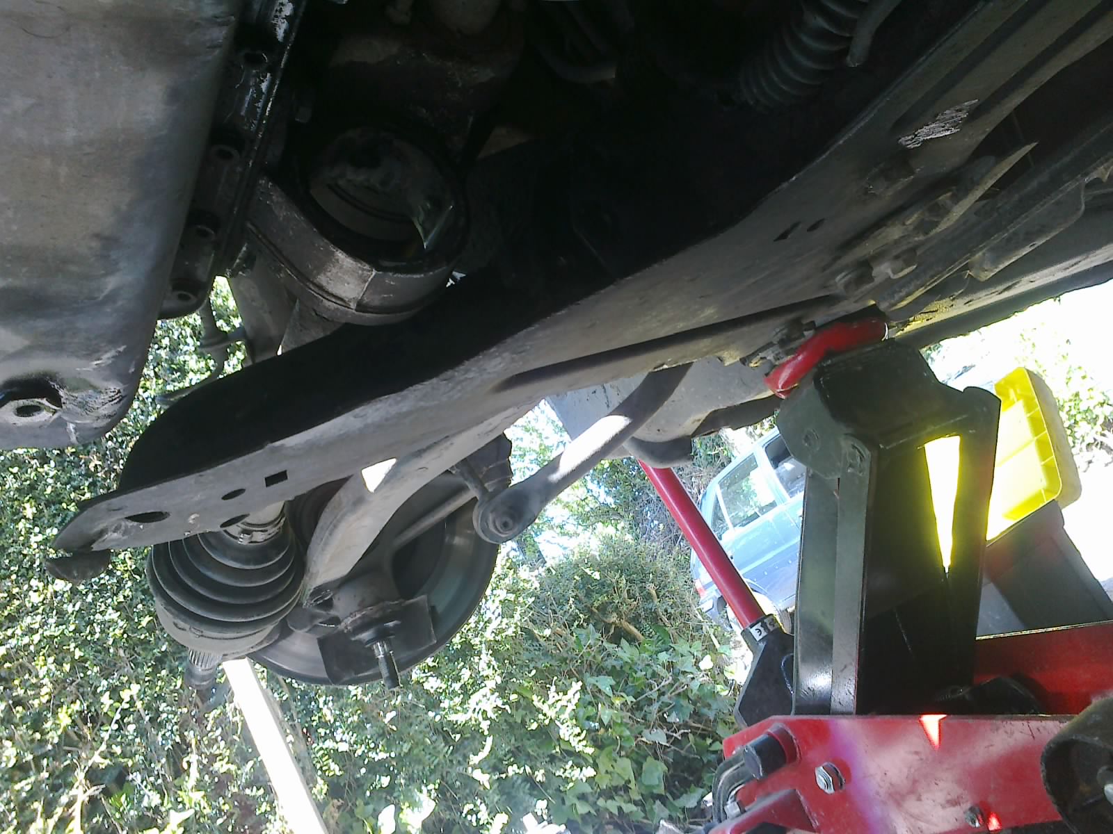

So the other day, I decided to get the car driving again :)

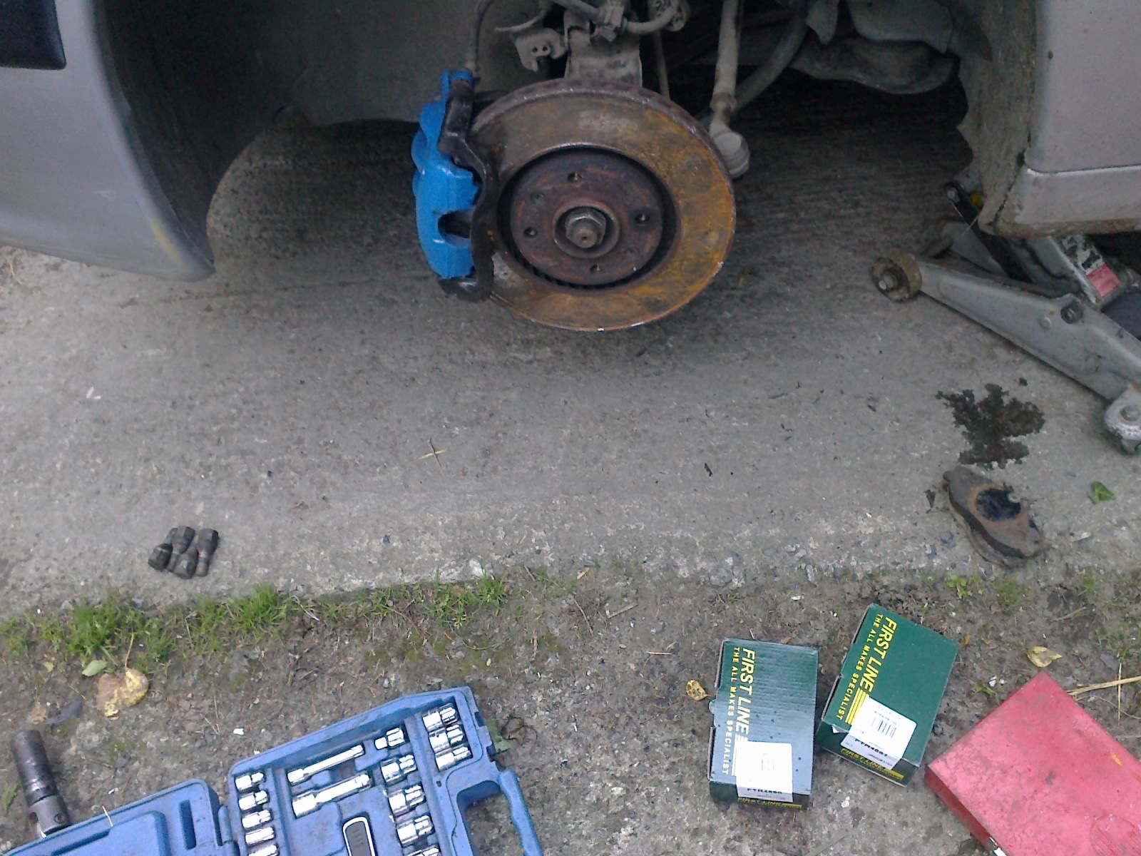

Balljoints... A pig to get out!
But worth it
Just an example of what year of muck and water do to the calliper sliders with no rubber covers...

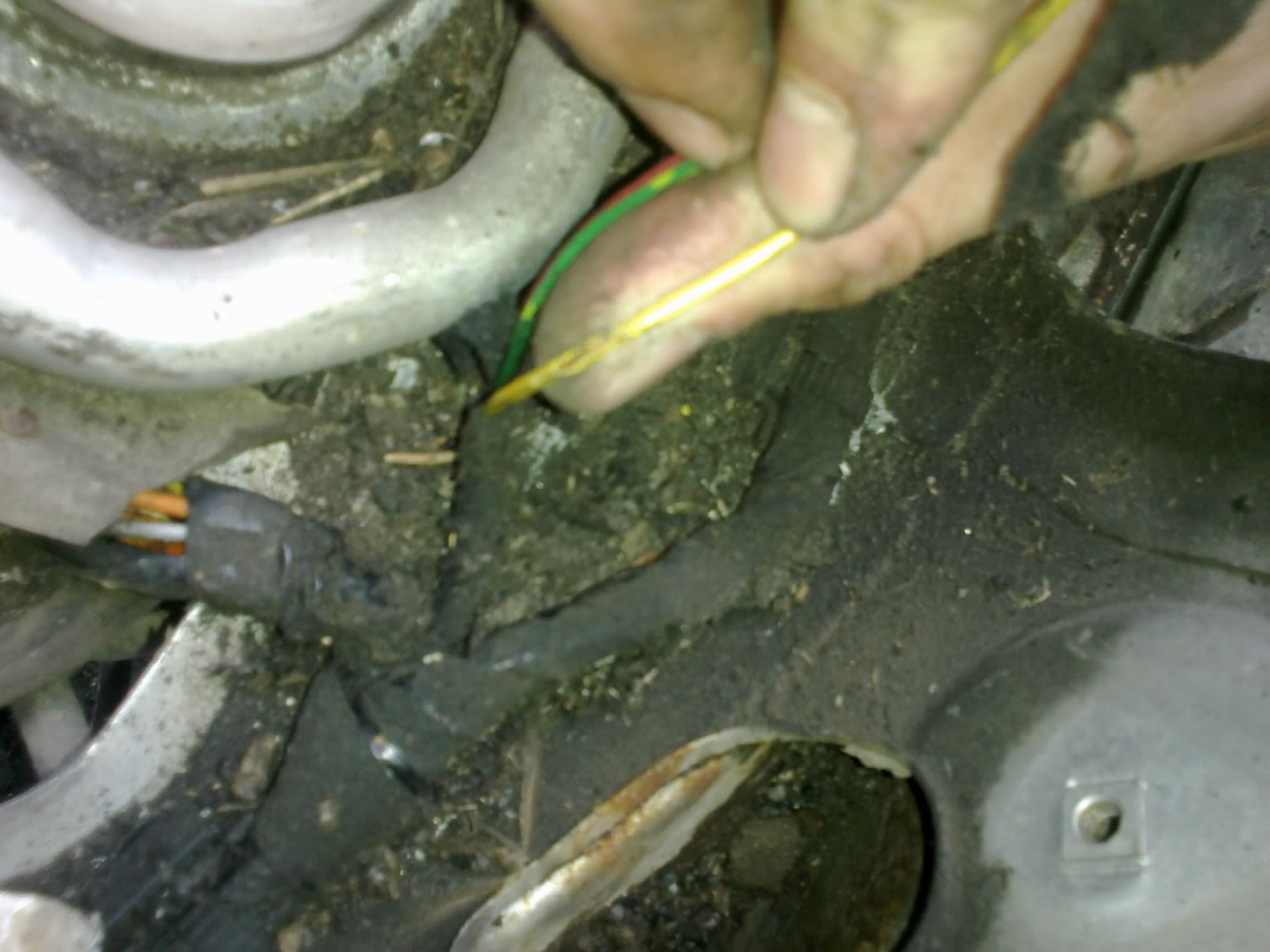

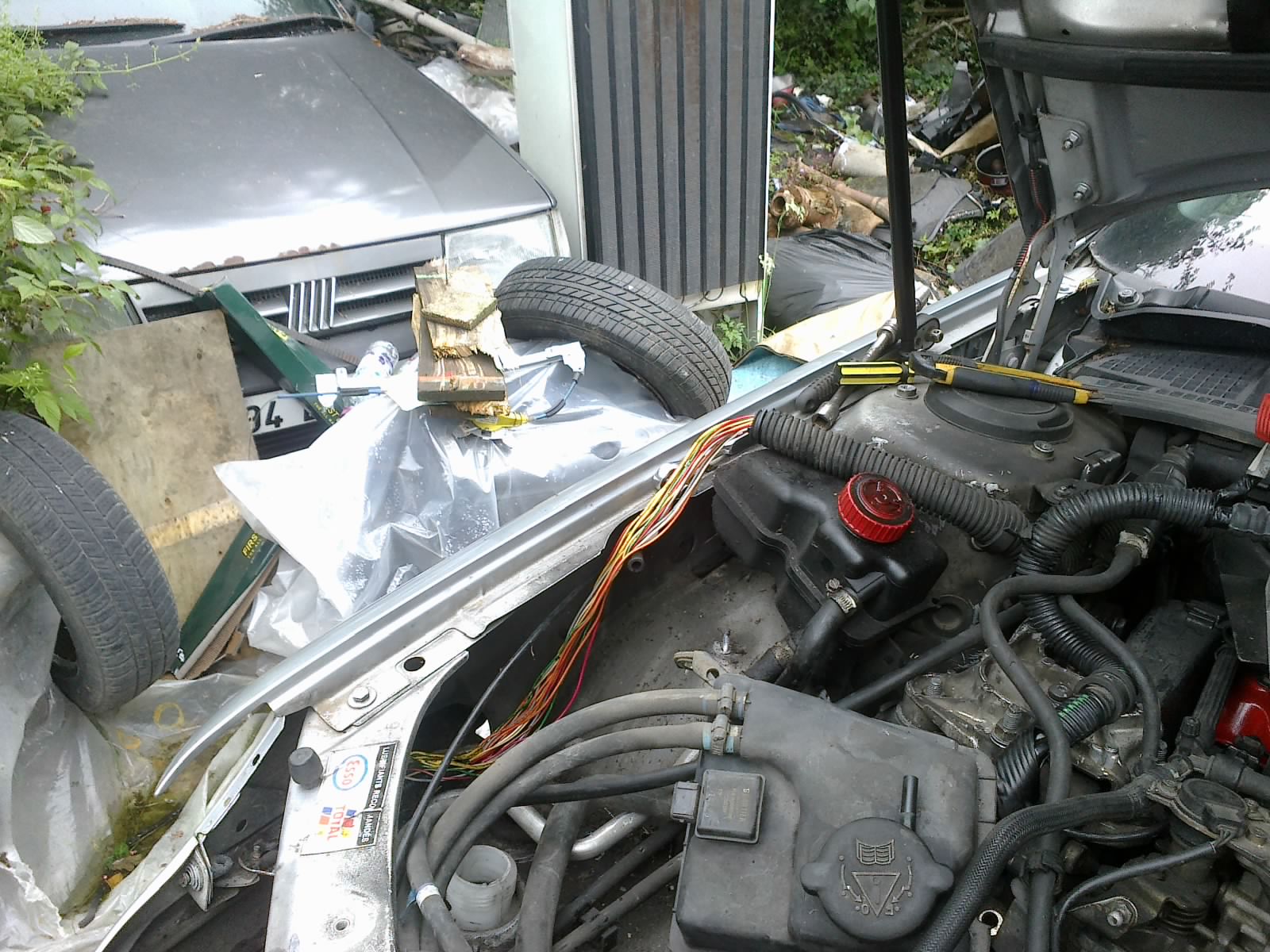

Now for a hair pulling sight... Ahhhh
To sort 1 wire!!!!! :bang::bang::bang:
At least my windows work beautifully now :D
French electrics post!!!! Ahhhh

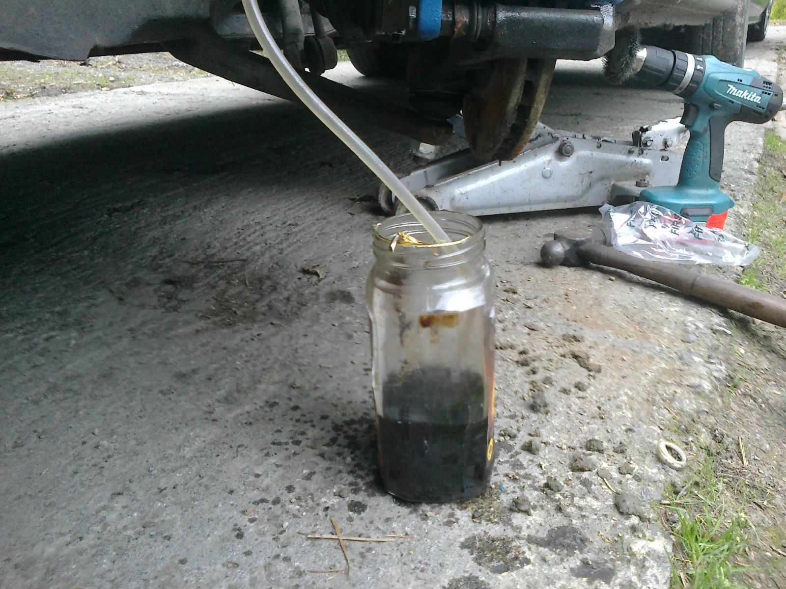

Next a brake fluid change...
There's why :mad:

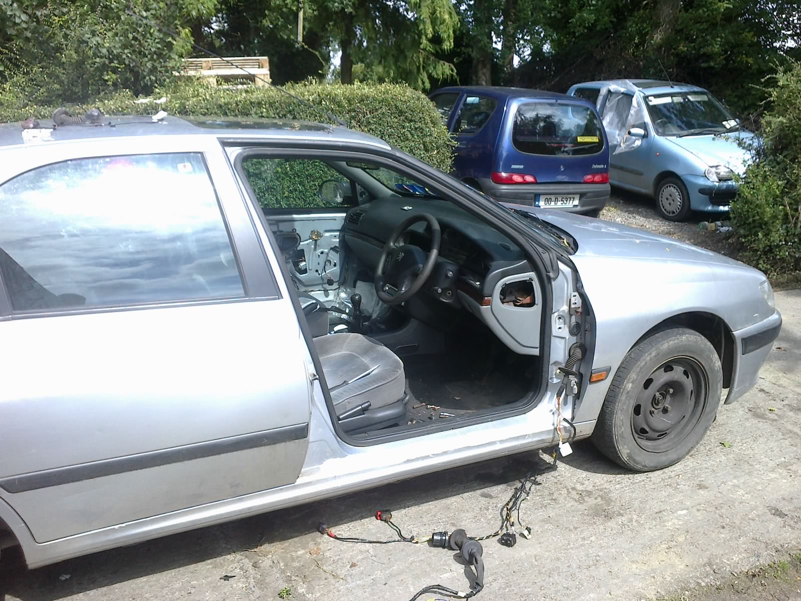

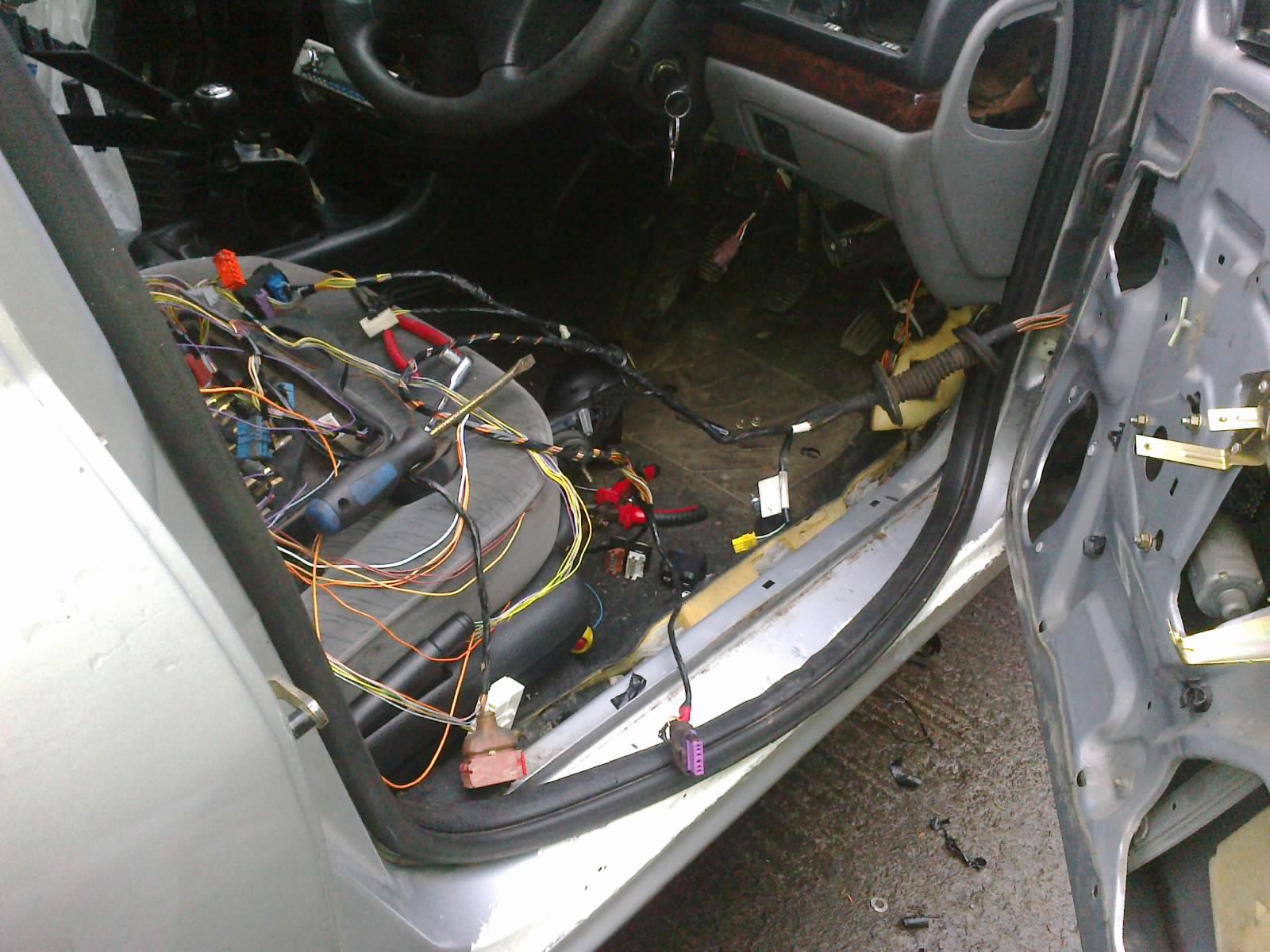

Next, a bootful of crap :spin:
Not wasting any time...

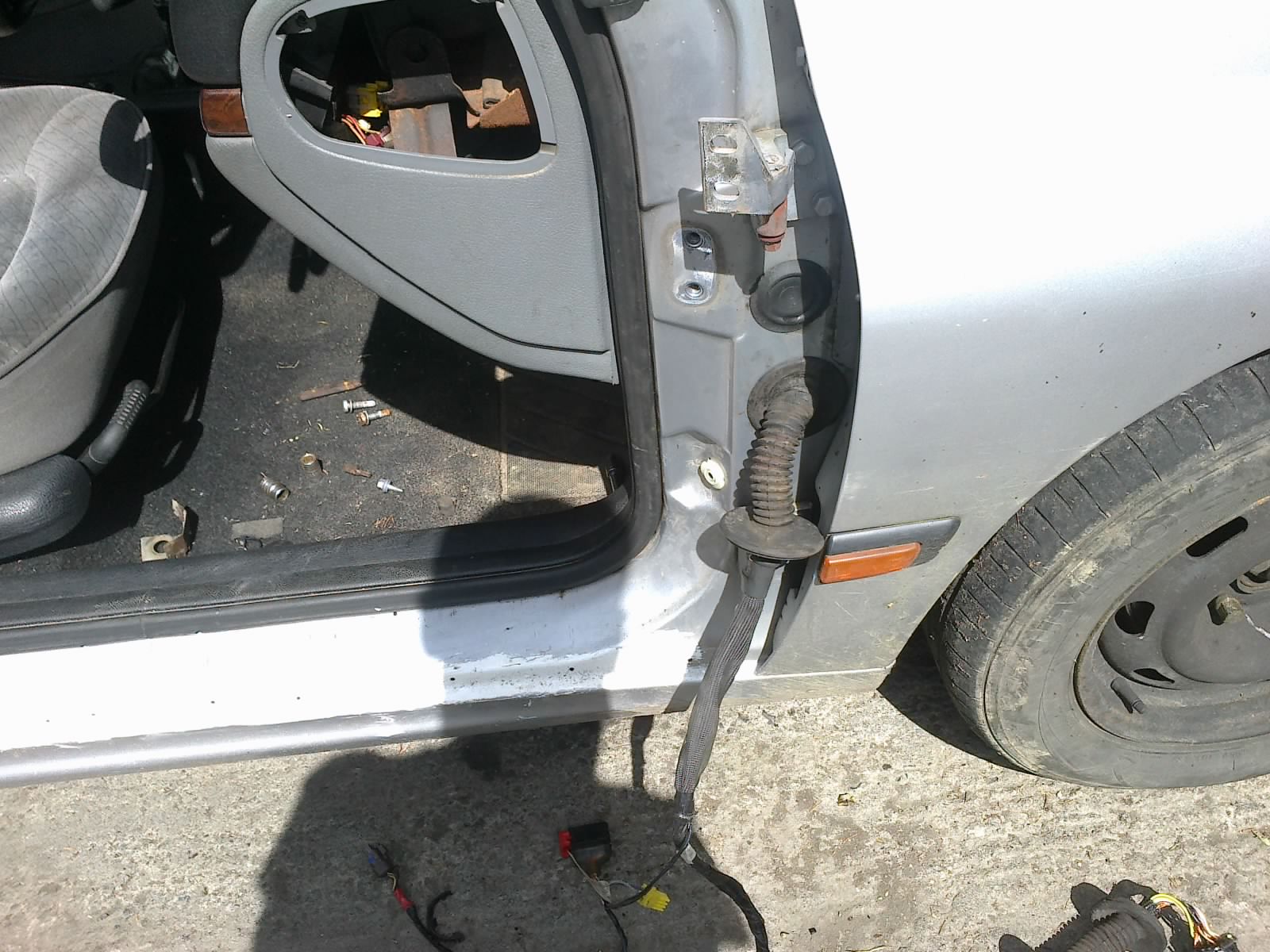

Out!
And the loom too
Handy to clip in (y)

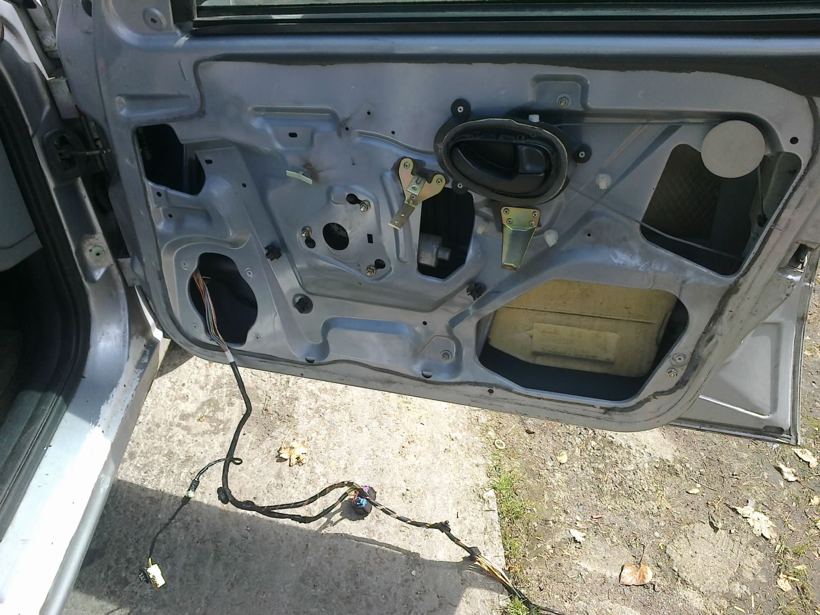

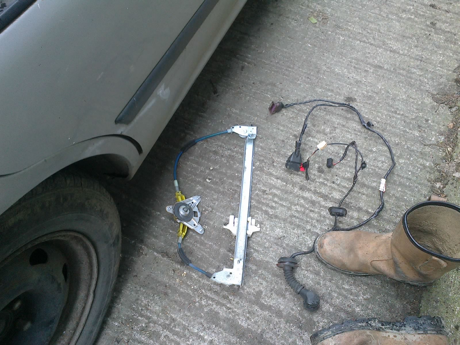

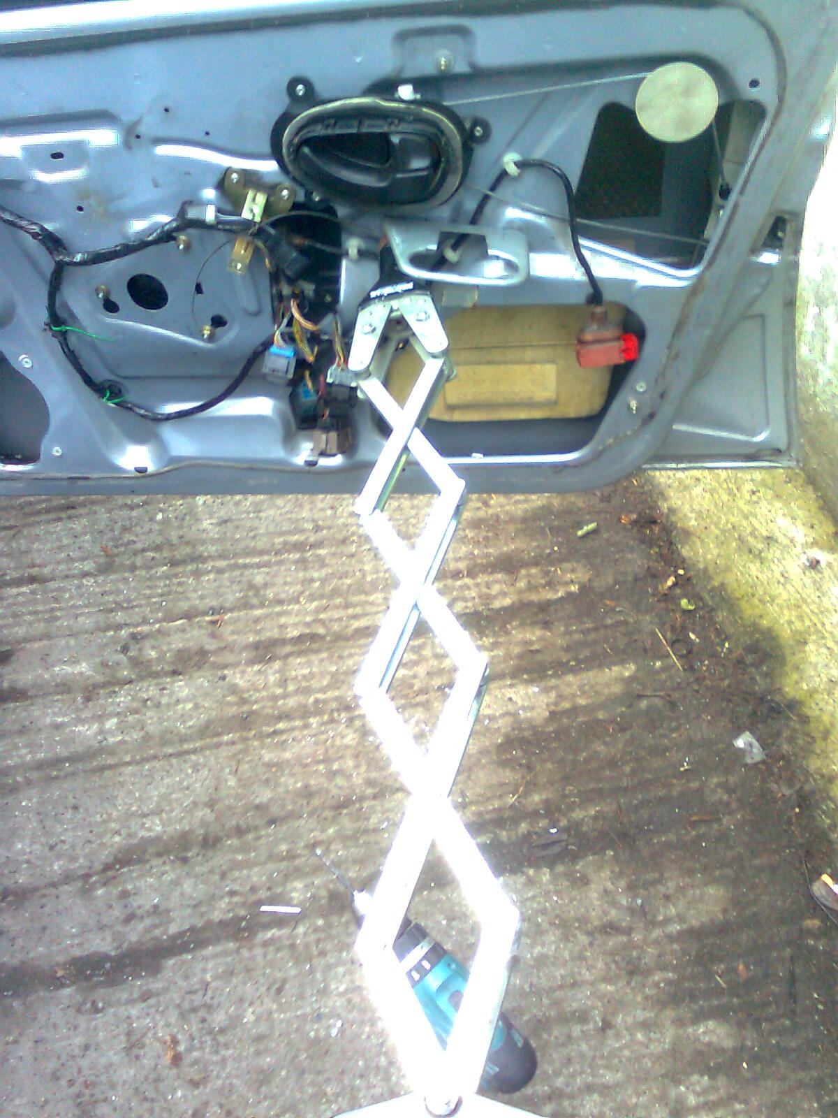

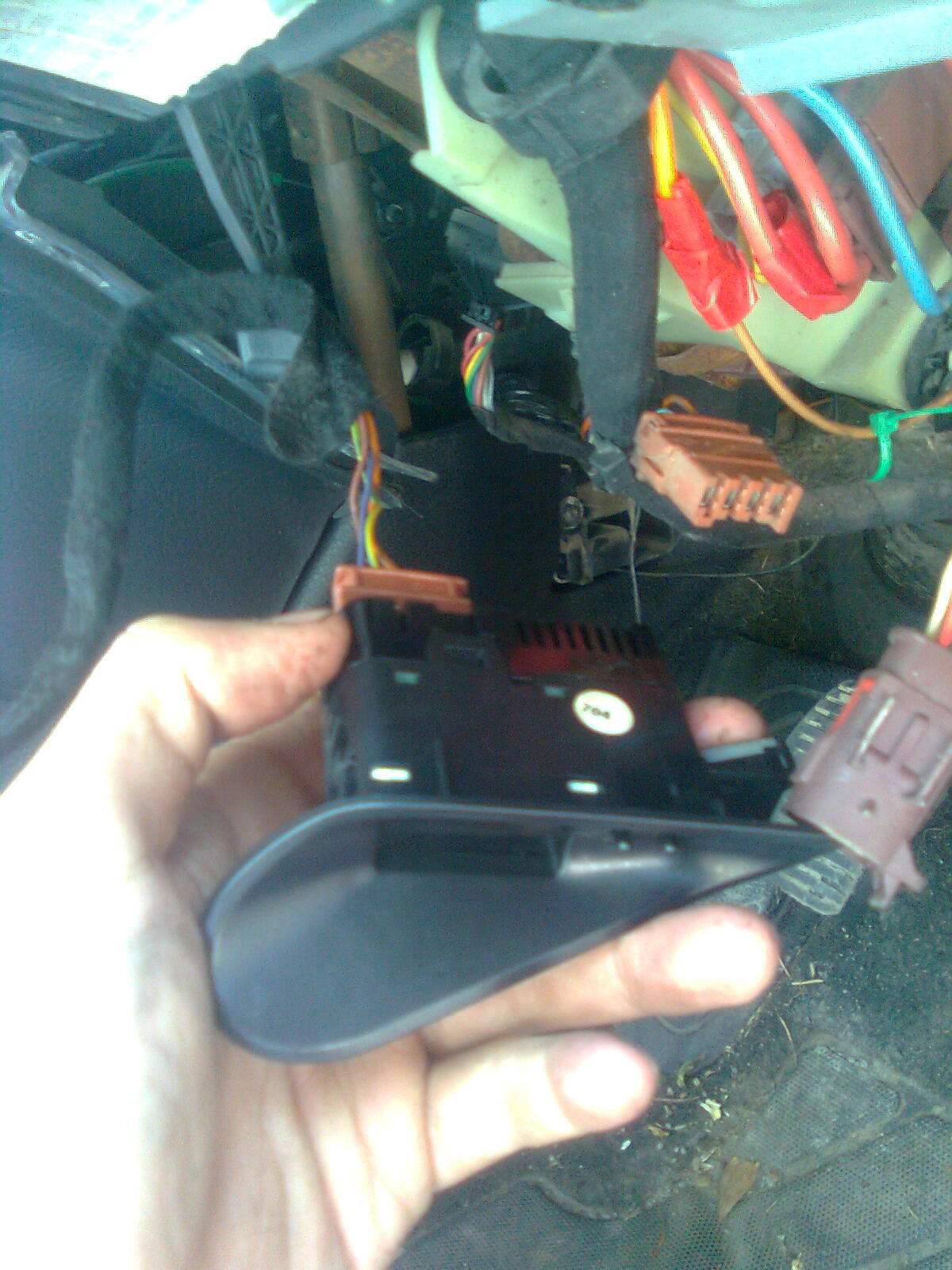

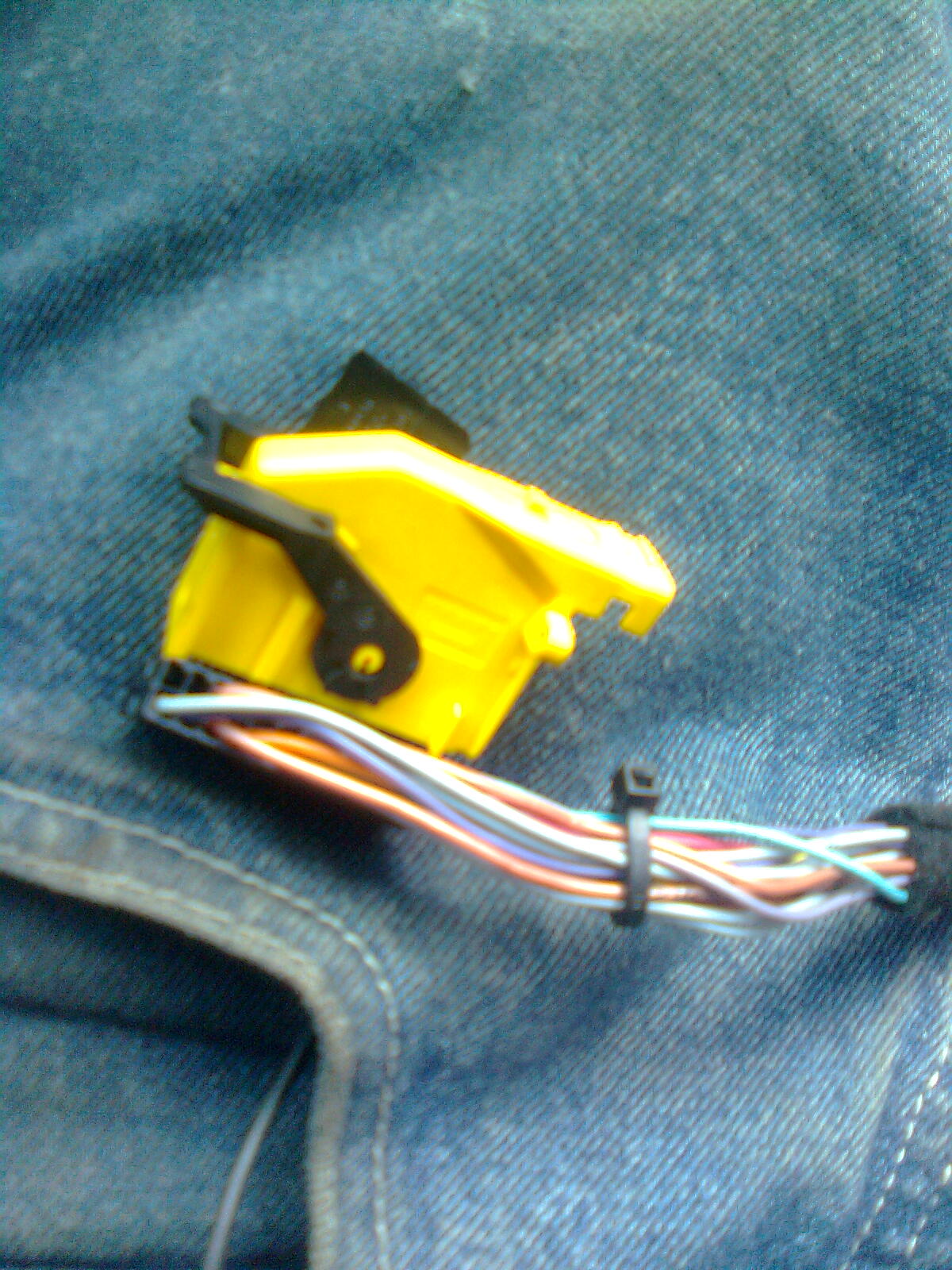

Wiring up the window reg loom :p
Now the front...

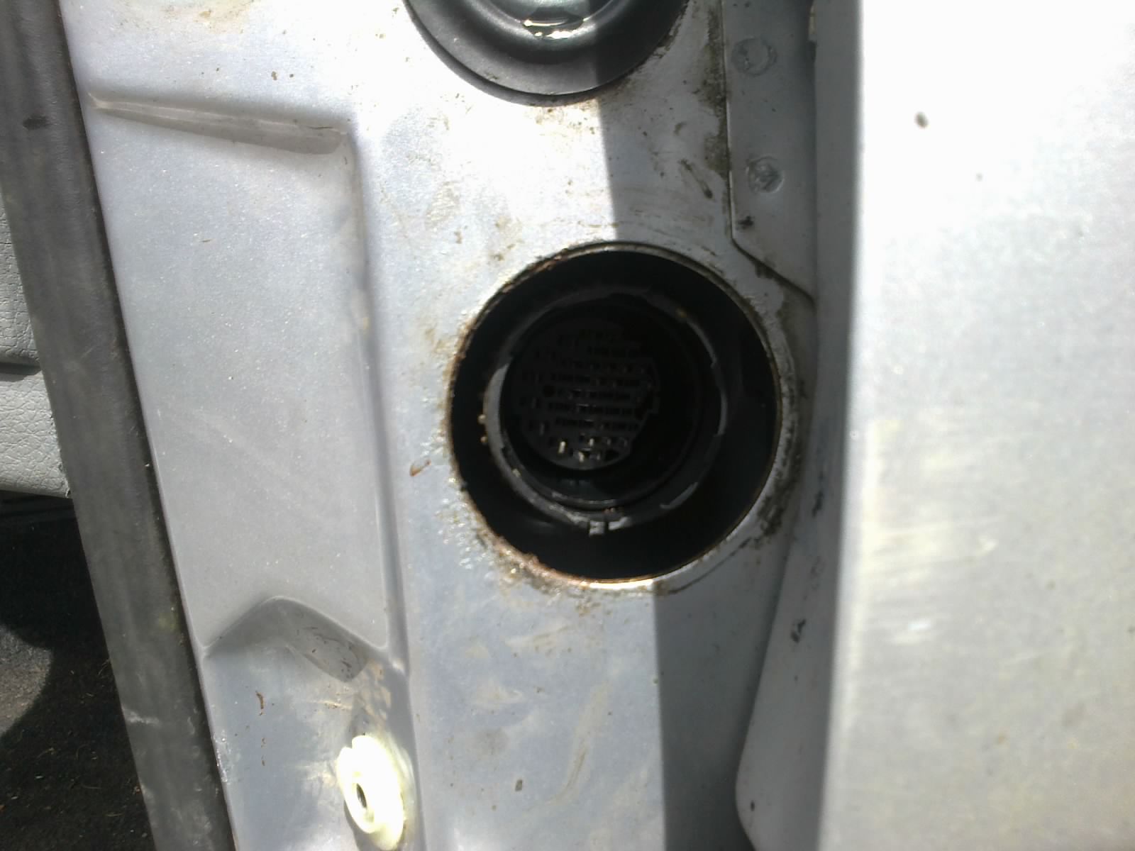

Out with the old...
...when the door is off :bang:
Spot the replacement Seicento... ;)
Not a nice twisty multiplug either :mad:
But fitted...

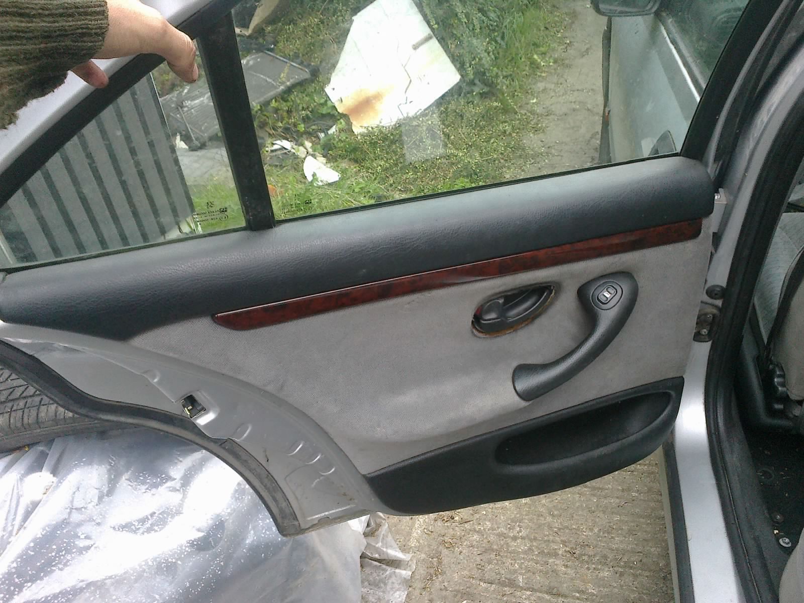

Also fitted rear door cards
Elec mirrors
Both of which don't work!!! :mad::mad::mad:

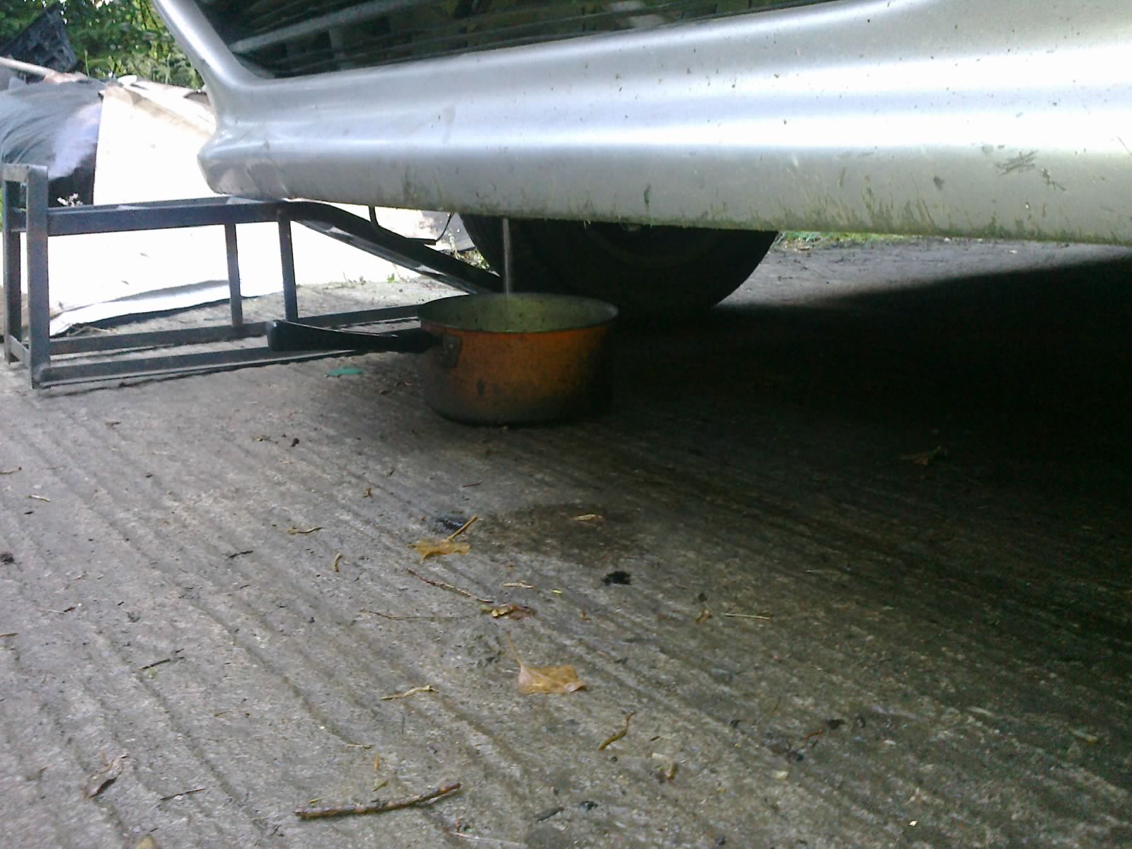

Needed a coolant change.... So out with the saucepan :p
And in with the new antifreeze :)

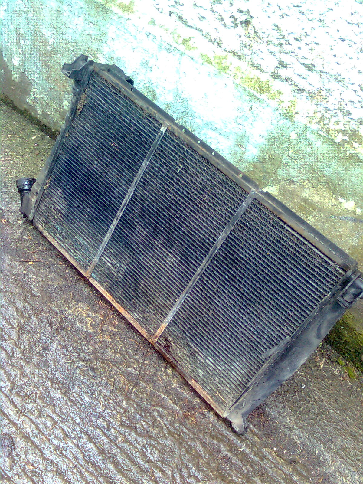

Only to find my radiator has shat itself :bang: £94 + vat for a new one :mad: but that's for another day...

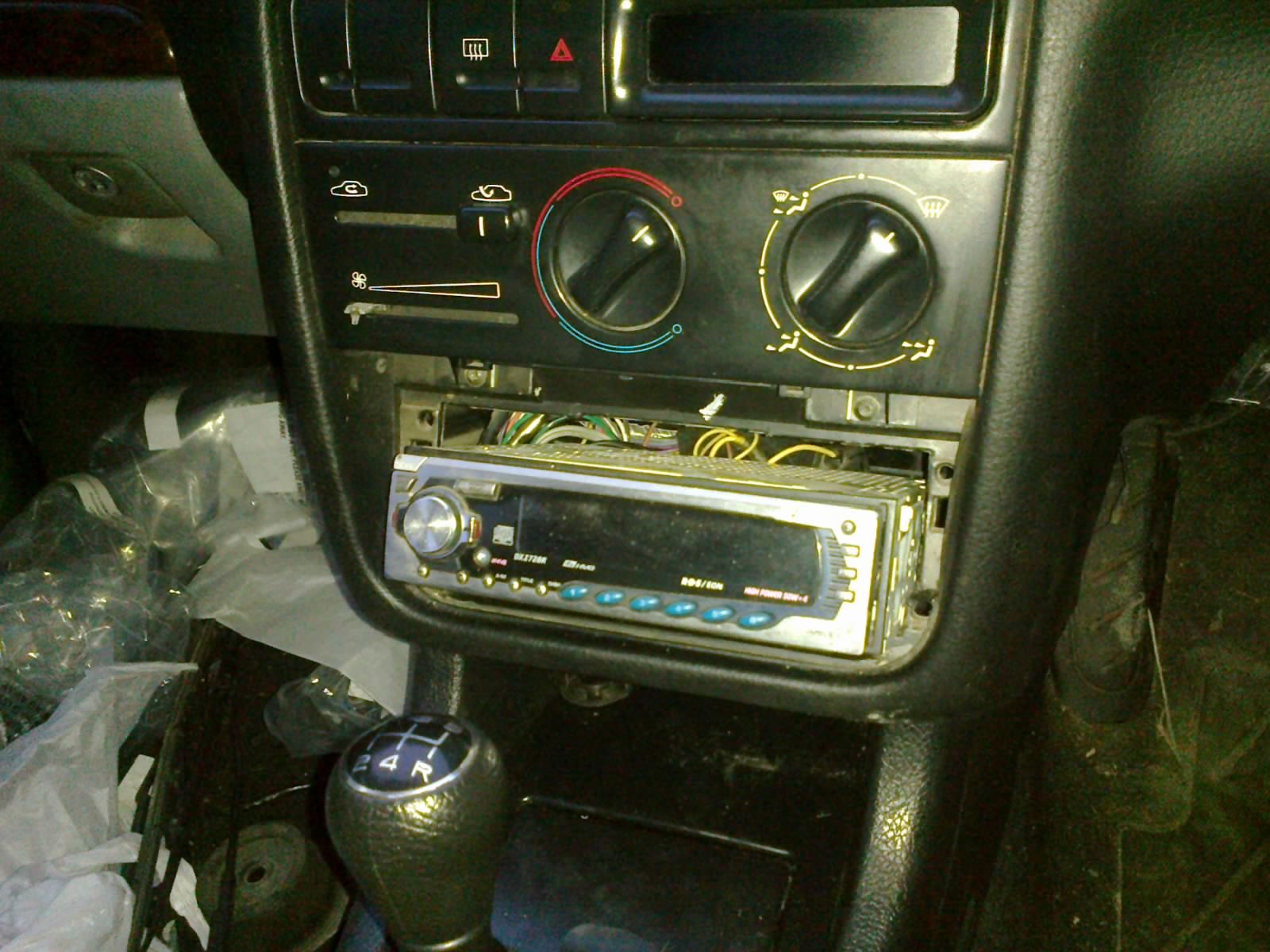

Decided to pillage a radio out of another car :p
Out!
Don't leave me...
In!!!
Better :)

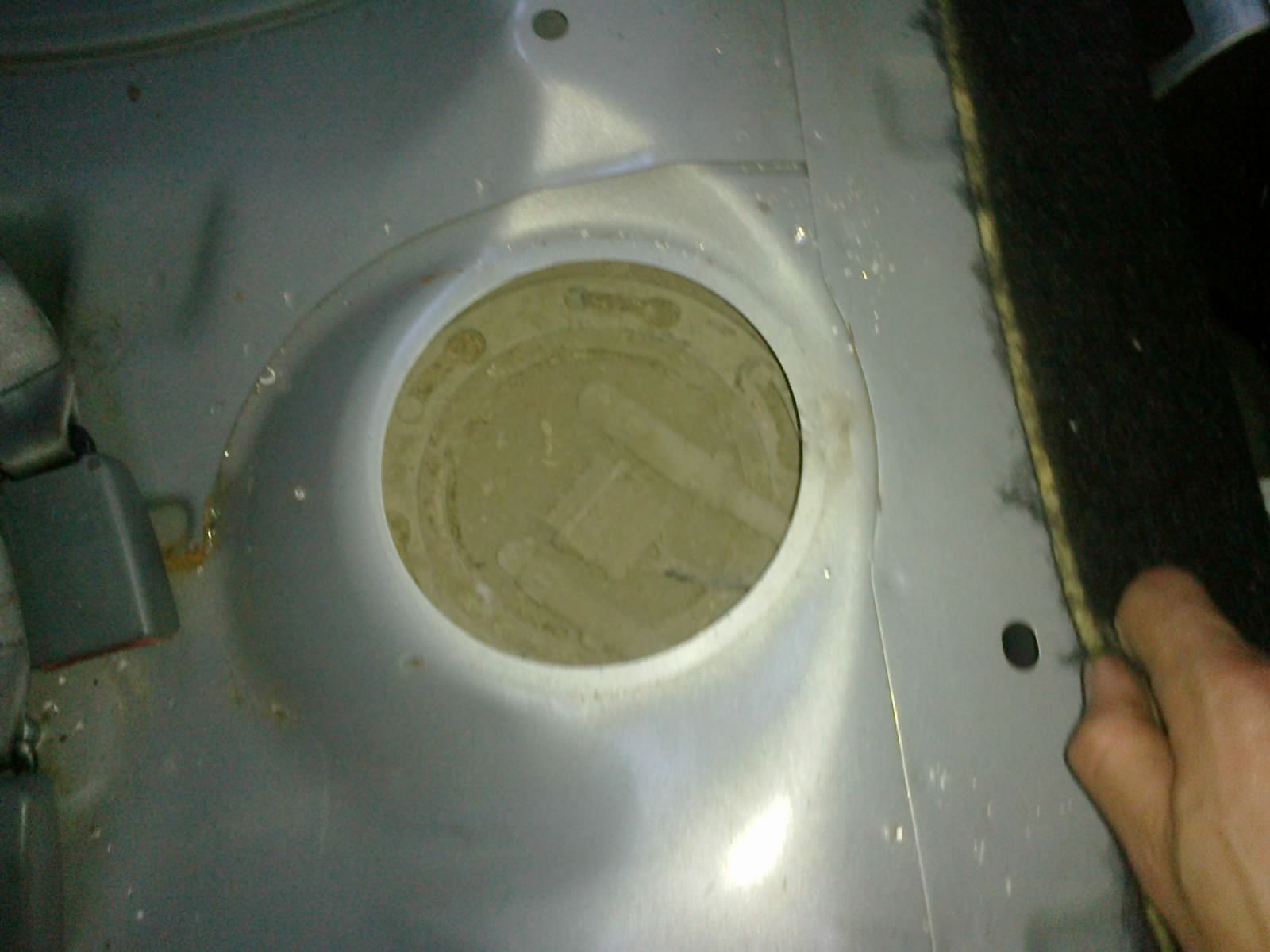

Fuelling was the problem.
Decided to start at the back and work my way foreward. Started at the sender.
Bench out again...
Yep, pop riveted :bang:
Drilled out and plastic cover off...
Like something from an archaeological dig :ROFLMAO:
After a lot of swearing and hammering...
Yep, blocked :) cleaned up and ran perfect :D

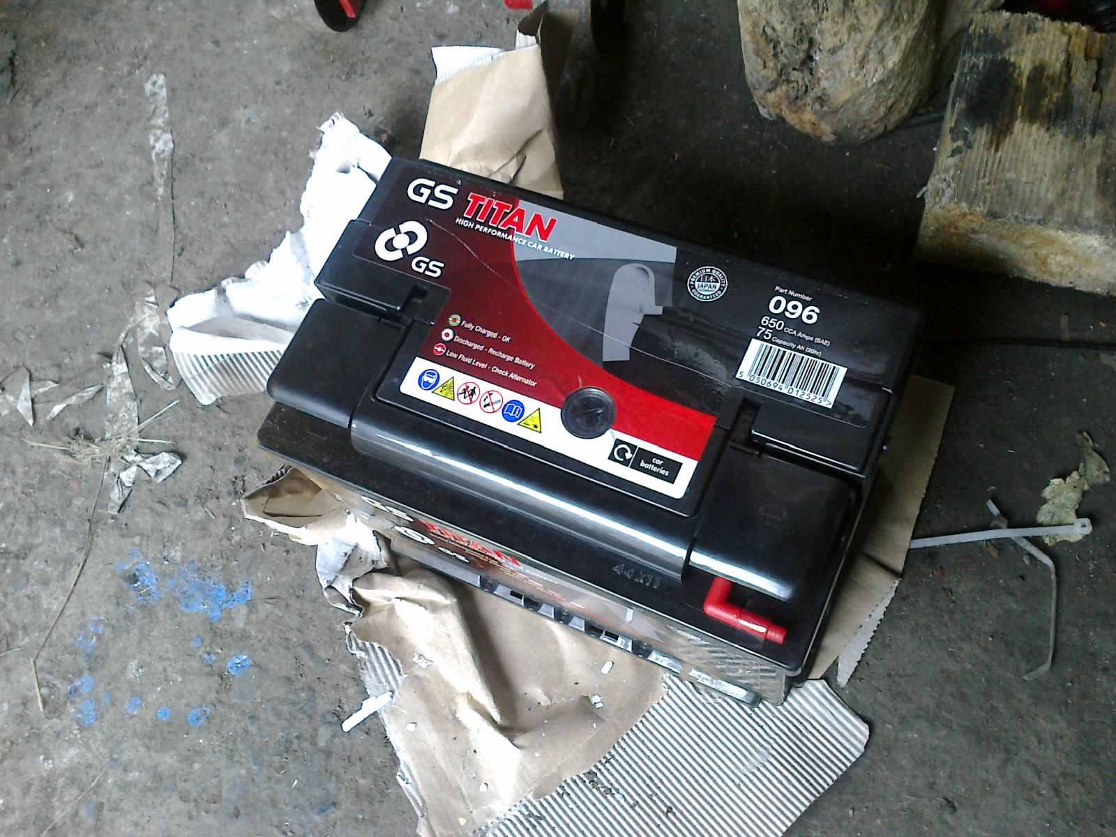

Lastly the car needed a new battery
Starts on the button now (y)

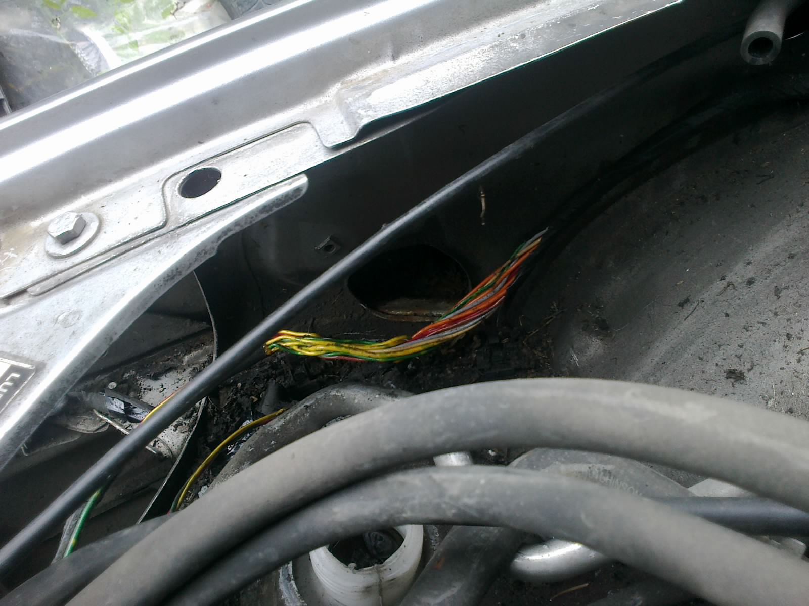

Lighting issue: No right full beam
Need to find the wires
Found the offender and we have light once more :)

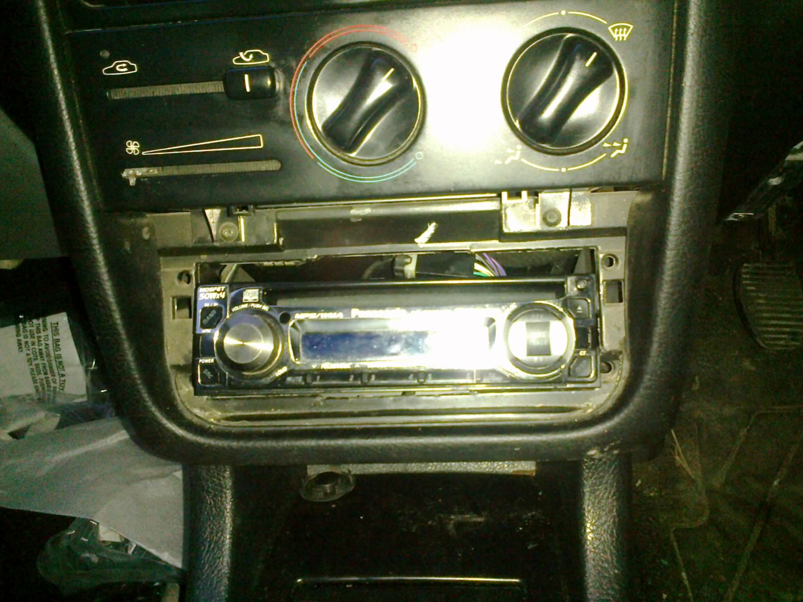

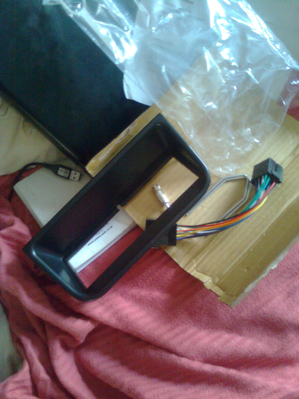

My radio fascia arrived
Binning that radio...

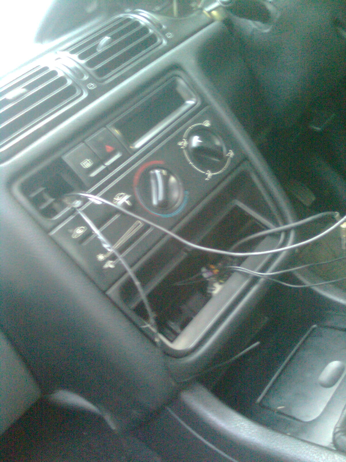

Tried to wire up a horn...
FAIL!!!

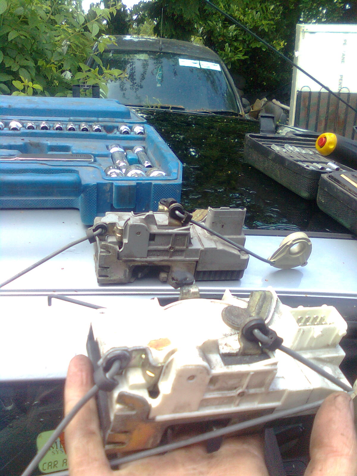

Next, door lock
The old one refused to work right. It got the bin!

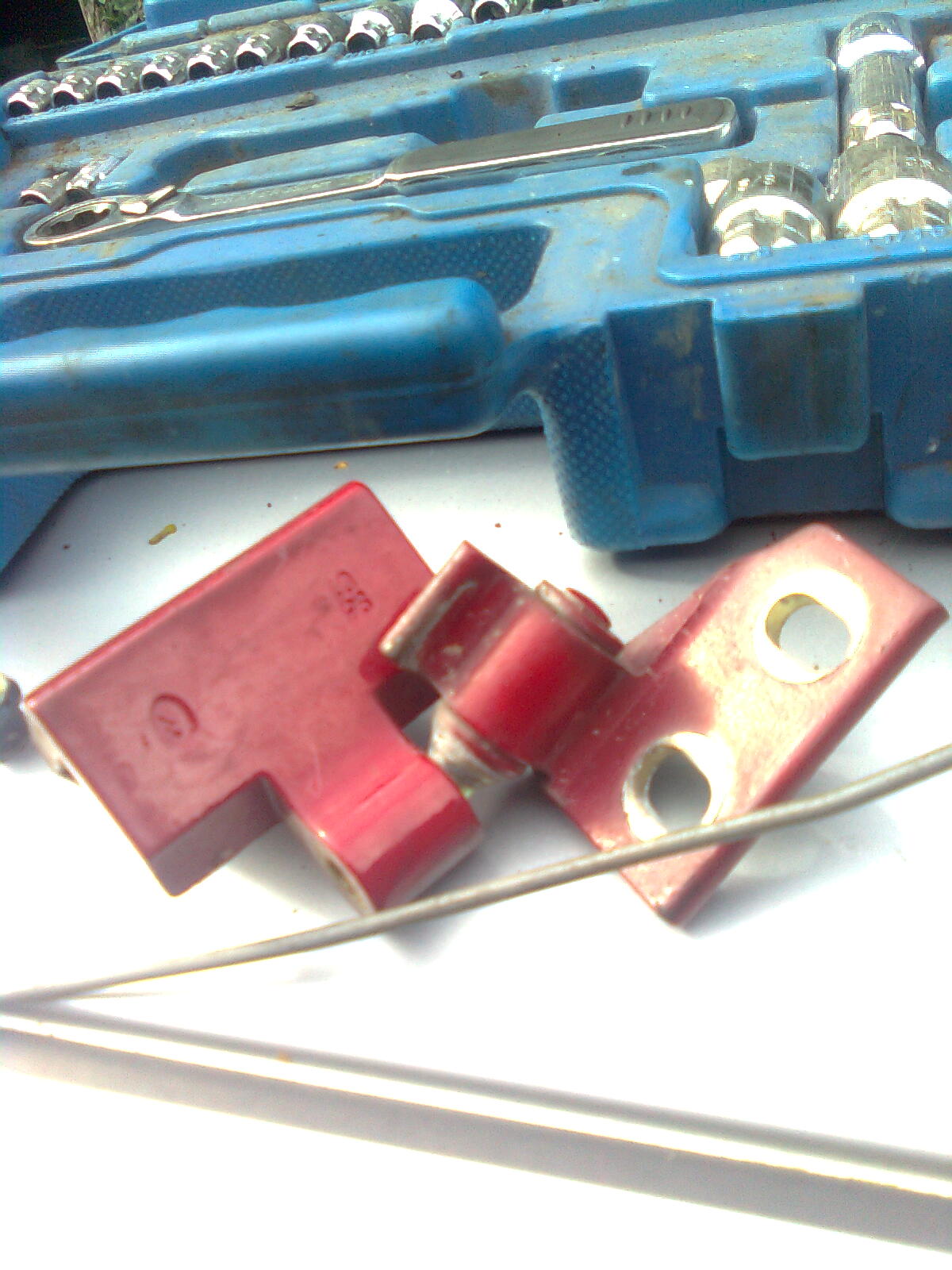

Replaced the door hinge
With a red un!

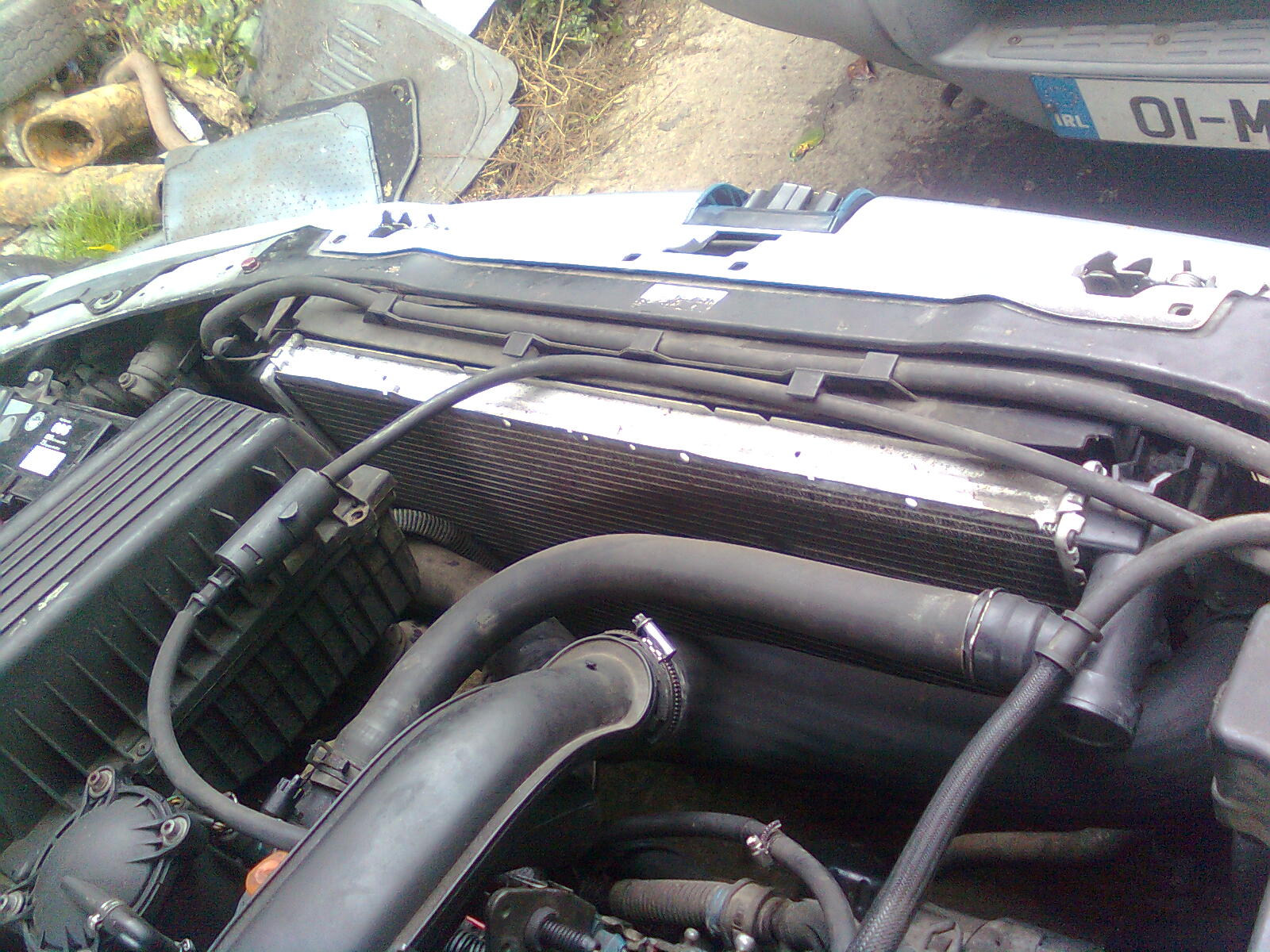

Then, new radiator and top hose
The old one was.... Beyond its sell by date
Better :)

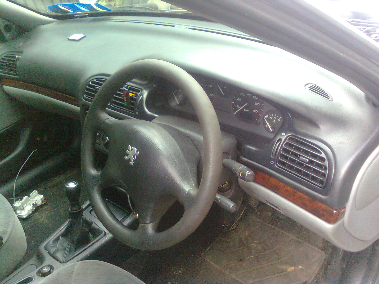

Dash trim
Drivers door trim
And scarily, that's the interior almost done....
Just a clean needed and some speakers :eek:
