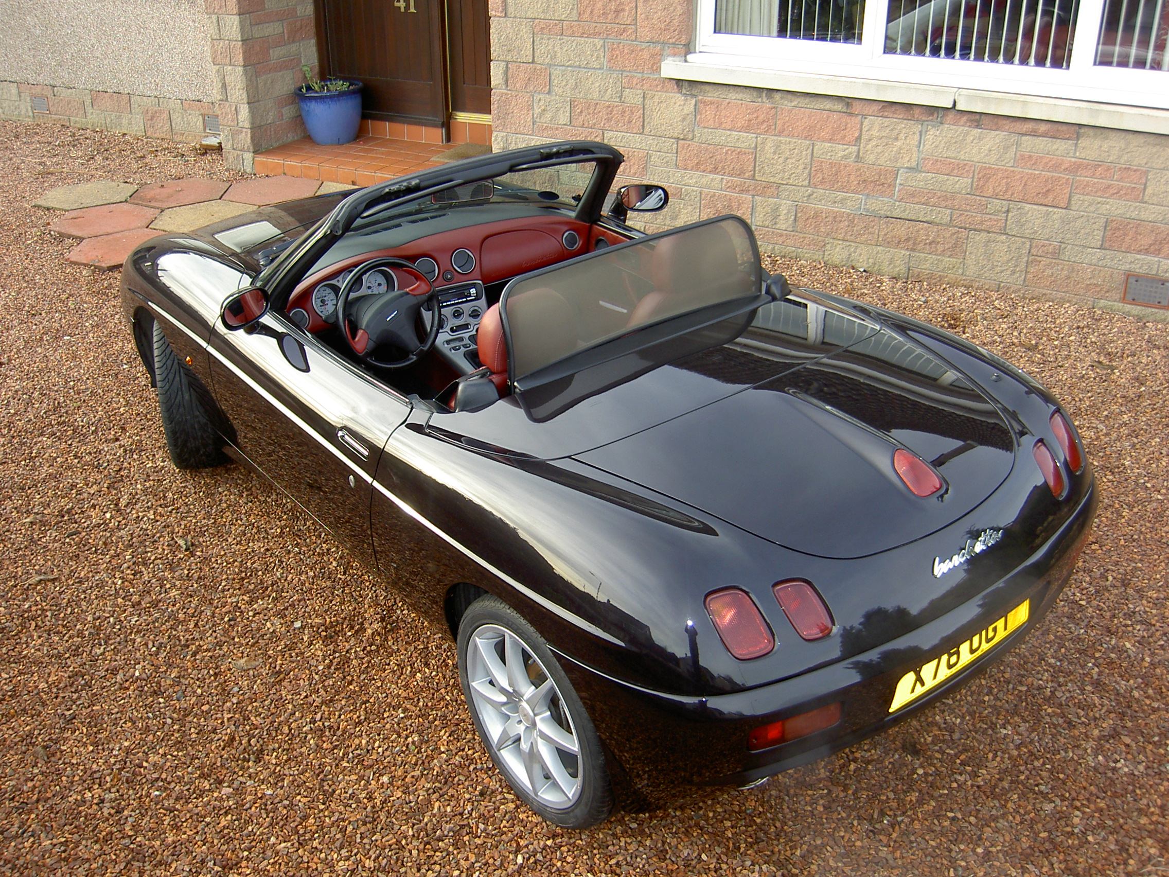

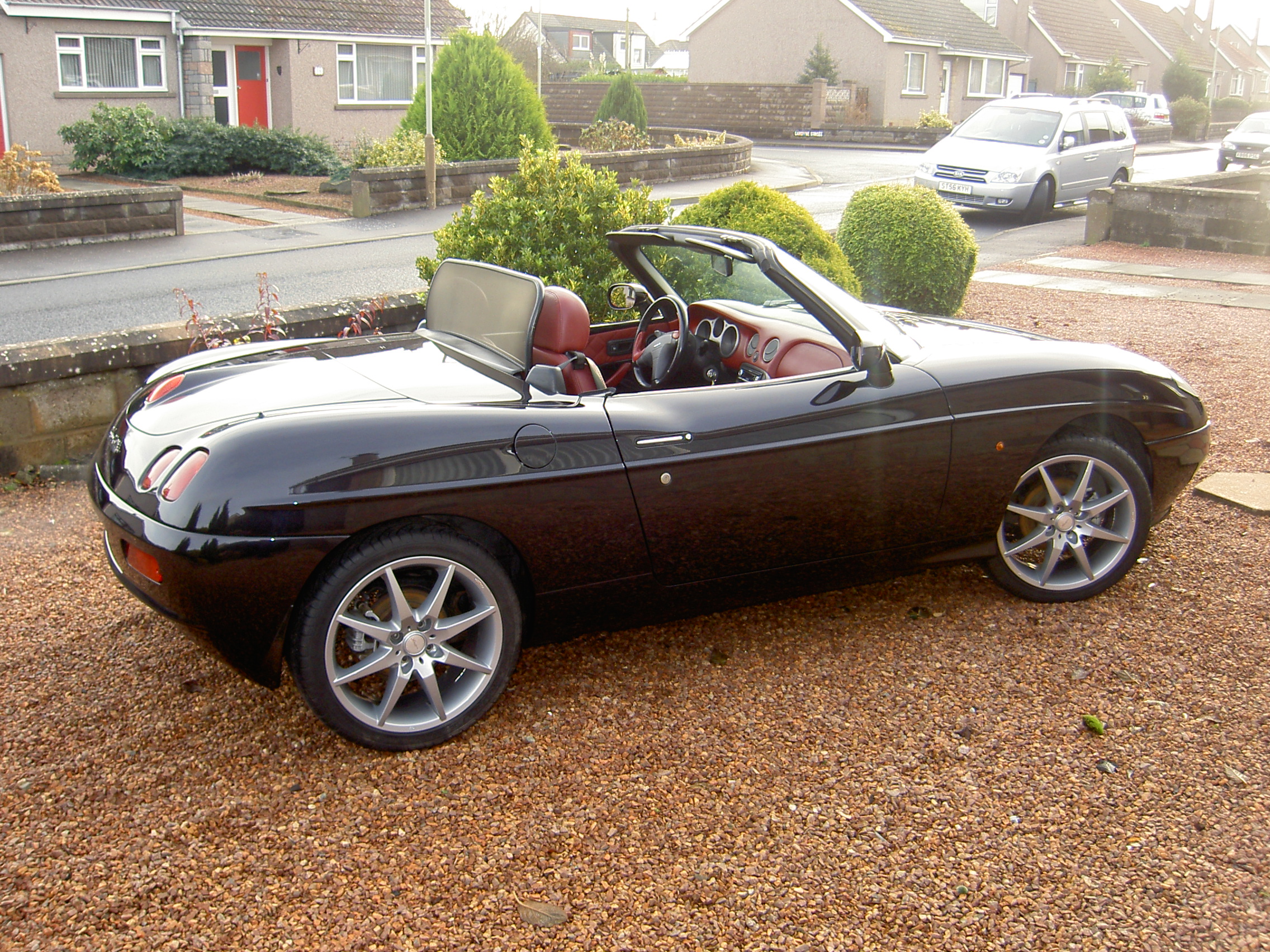

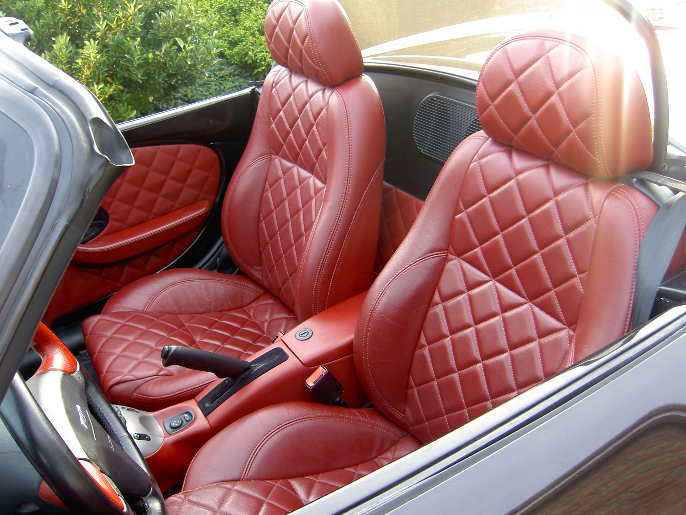

Hi,
Can someone advise? Is the speaker behind the seats merely a bass woofer or is it blown? The manual doesn't really explain.
(Also thought you'd all like to see some up to date photos of my lovely new beauty!)

Woofer fitted as standard or an option? My X reg LBB has the cheapest / nastiest speakers outside a '90's Skoda and no box on the back bulkhead.

The tweeters in the door are a std fit on all b's, the sub-woofer box is quite hard to come by, Stu's suggestion of replacing all of the speakers with Infinity 6010 CS reference units is a good one, I have them in mine and the difference is like night and day over the FIAT speakers....
