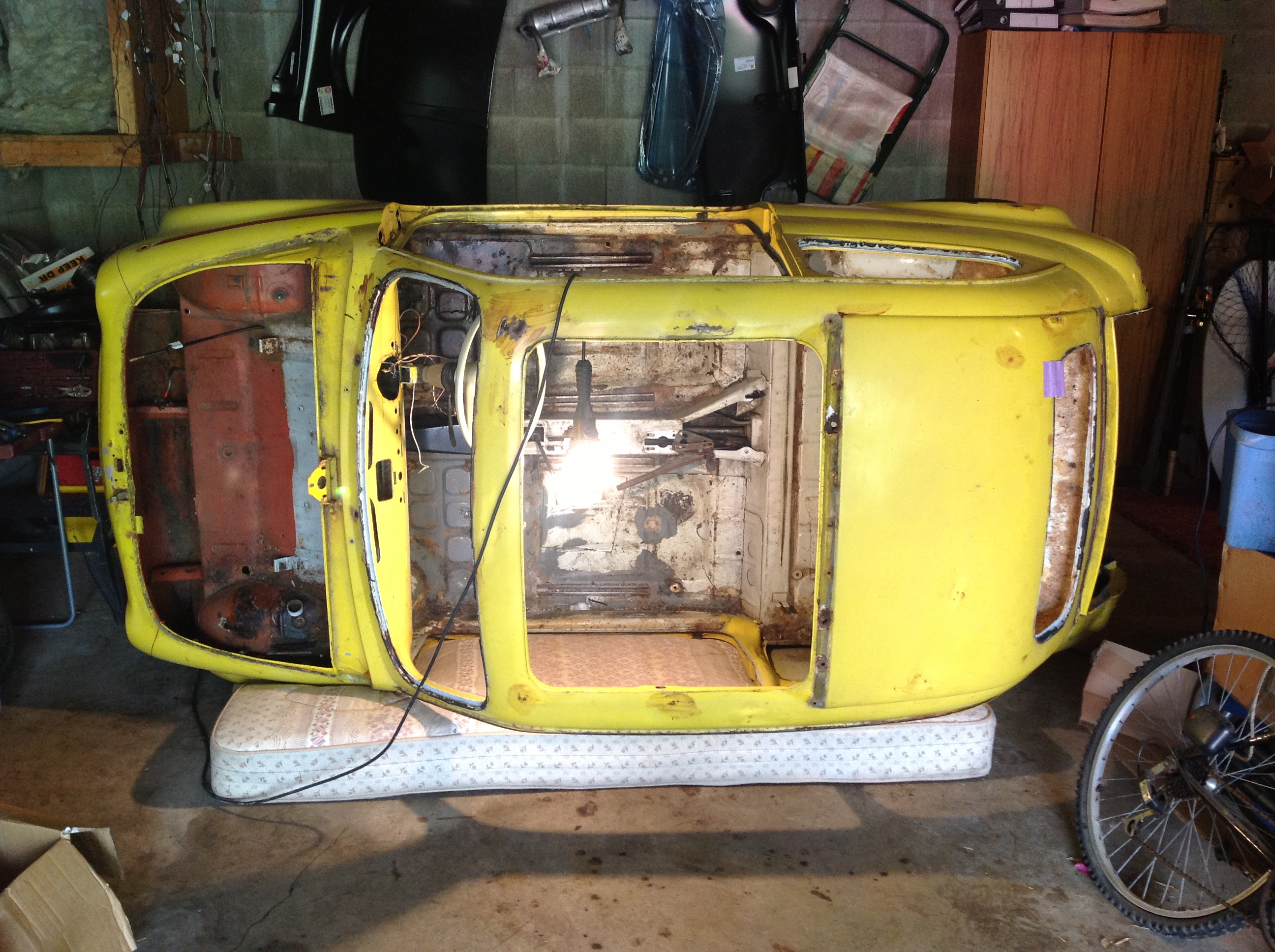

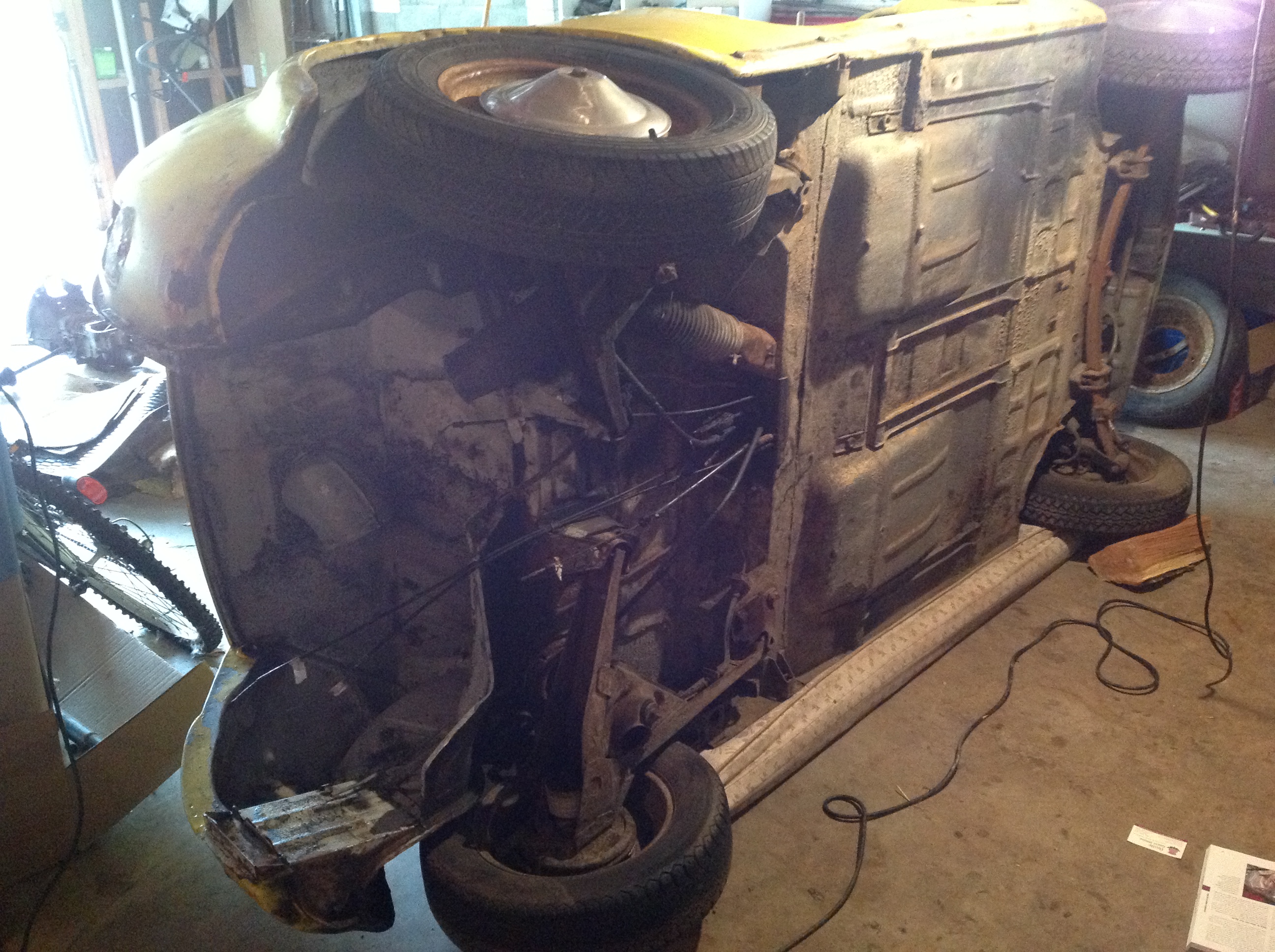

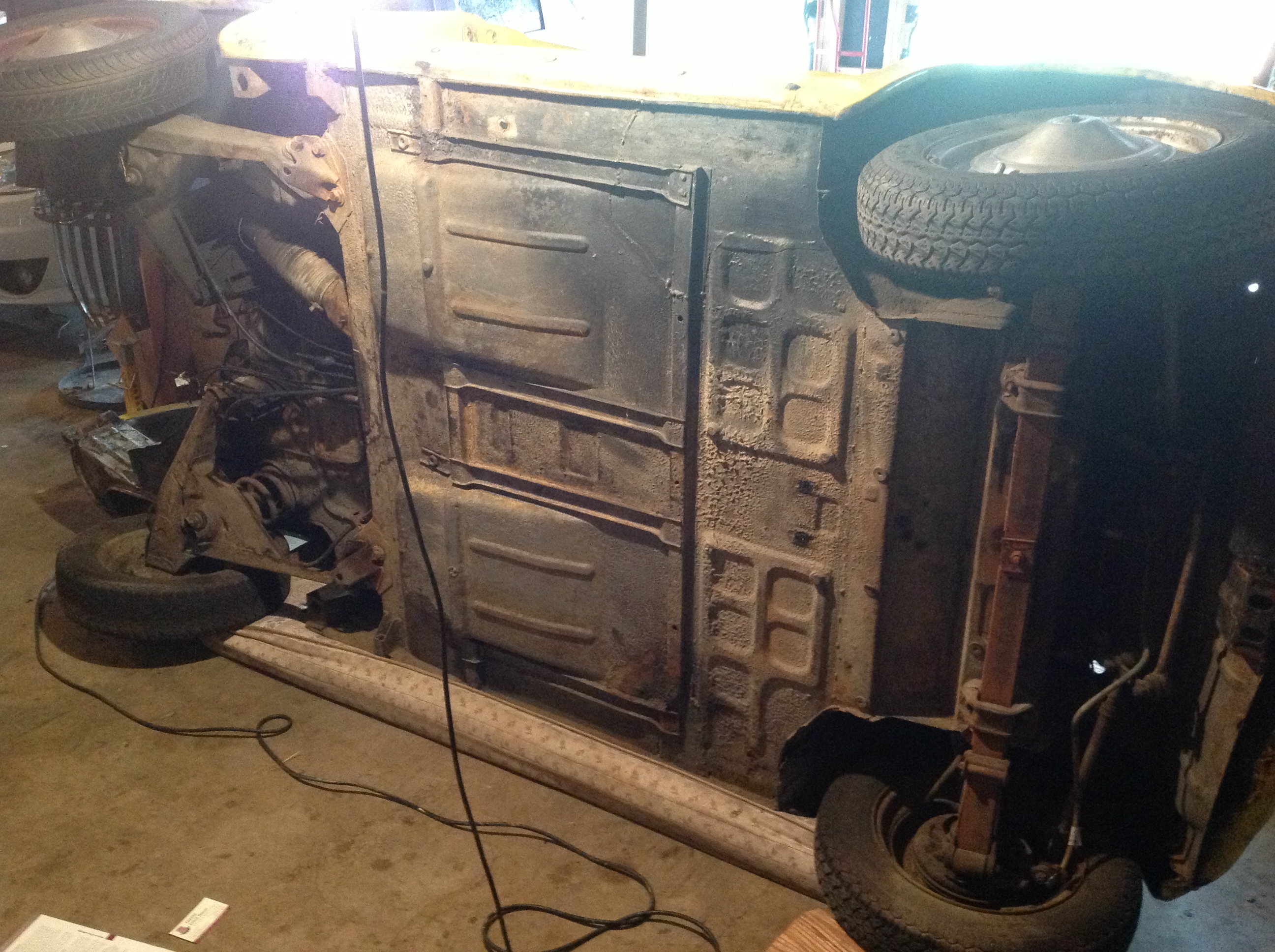

Car is now on it's side (see pics) and to be honest, I'm not quite sure what to do underneath. No serious rust problems but I need to remove surface rust etc. I'm guessing things need to be cleaned up and sprayed but could do with a little guidance.
Hi Tim,
Welcome from another (ex) NZer! good luck with the project- John Collins is a wealth of information and largely responsible for the survival of many of the remaining 500's left.
You might want to look more closely at your floor as the front box section should go the whole way across the full width of the floor and it looks like the floor itself might have been repaired on the drivers side as it is missing its reinforcing ribs.

Thanks Damon. The repair seems to be quite good and I can see there's been no attempt to re-create the ribs. But not sure what you mean about the front box section? Which area?
I think I know what you mean now. The missing ribbing is where the patch weld has been done. it's a pretty good job though.
