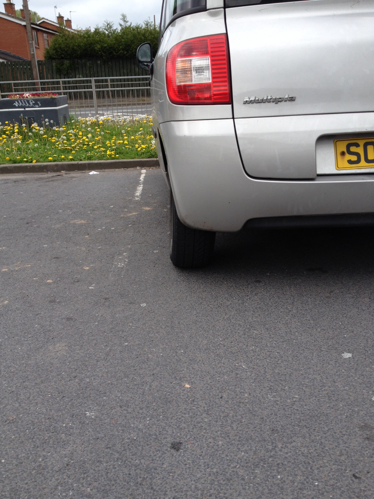

The rear suspension arm bearings if you jack the car up and grab the wheel at 12 and 6 then push on the top and pull on the bottom simultaneously you will get some play they usually give you a lot of negative camber

ImageUploadedByFIAT Forum1398952769.084738.jpgits this bad?!!
I can tell you exactly. First the tyres rub and make a sweek when going round corners with rear passengers. After a few monts you'll get a load of crunhing noises. and more skweeking under lighter loads. then youll get all insundry pointing out you've got a problem lastly it will fail it's MOT. What you will have done is wear the seating for the seal in the swinging arm so a new one won't fit.
^^^ what heatrag said.
Mine started rubbing when i went round islands. I could see a rub mark on the arch liner. I ordered the new parts from a place in Poland which where loads cheaper than the UK. The company advertises on here.
I had the same problem with my 38k miles 58 plate nosejob. I have heard that some garages opt for replacing the whole swing arms - expensive route. My garage charged me £285 to replace the bearings on both sides.

Suspension I guess also isn't ok. I think my subframe has corroded and the suspension is no longe connected properly. Knocking from the back is bad, but no rubbing from corners. I have a friend who is giving it the full once over (mechanic) so I can decide whether to scrap it or fix. It's a cat d (bent front bumper which only cost me 350 to fix) so is only worth scrap value. :-(

Interestingly, I took it to the garage and they told me that both bushes have gone. Also that my exhaust has gone (which I know about). They said once I'd got these fixed they'd MOT it to see if there's anything else that needs doing. Am hesitant as it's £350 to fix these even before anything else...
