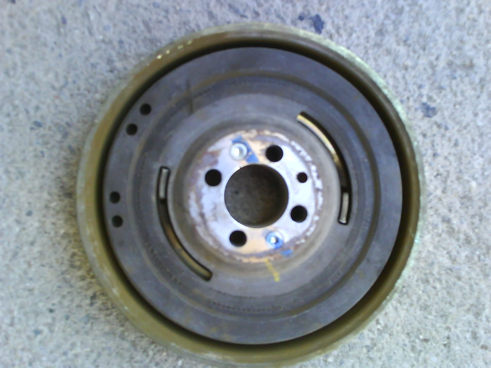

My tensioner started jumping around like anything making a sound like a bigend going. Or a hammer hitting the engine block twice a second.
Although this is not a long job, those of you changing this part, take the time to look at the other parts envolved with the belt, like the crank pulley, alternator, aircon pump, idler pulley to see if they are knackered too. Try for play and stiffness.
My problem was the crank pulley which had ripped its internal rubber sandwich torque absorber mech and needed changing. At 130 000 km I just opted out and changed the belt, tensioner, crank pulley and idler. Not cheap, but I didn't fancy doing the job twice. Also bear in mind if the aux belt runs into a problem and snaps it has been known to flail around smash through the cambelt covers, destroy the cambelt and destroy the engine.... not a cheap option...
Getting the belt on, on your own, is not always easy. Took me 9 tries this time. Call a mate for an easy time...
Below you will see the crank pulley with its ripped rubber.
The new tensioner, with the crank pulley and belt off.
The back of the crank pulley, you can see the 2 guides in the curved slots at the end of the slots. On a new working pulley they are in the middle not in the ends - the rubber internals hold them there.

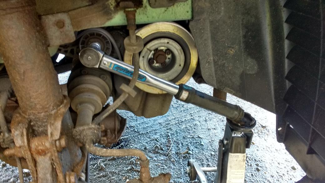

Using this setup it's an easy one man/person job:
Belt removal: To lever the aux belt tensioner back and slacken the aux belt, I used a medium length torque wrench and 15mm socket (others have used a long ring spanner instead) plus a trolley jack on the end of the wrench, to rotate the wrench and tensioner pulley in an anticlockwise direction, starting the wrench, from memory, at about 5 o'clock and rotating to about 3 o'clock until the belt is loose enough to slide off the tensioner pulley first (see photo). Then allow the tensioner pulley to return to it's resting position, remove your tools, the belt can now be taken off the other pulleys.
Belt refitting: Same set up, reverse the procedure, putting the belt on the other pulleys first, and the tensioner pulley last.
Note: I found that once enough pressure was applied to the wrench handle by the jack, the wrench stayed in position, leaving both hands free to remove/reinstall the belt off/on the tensioner pulley, and make any final adjustments to the belt on the tensioner and other pulleys.
