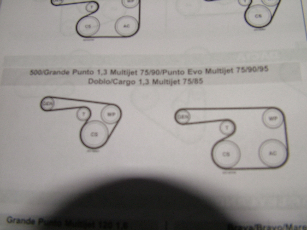

Thrown a auxiliary belt on my rebadged 2013 combo, Off to get a new one from GSF in a minute, does anyone know the routing? I've had a quick look from the top of the engine and was hoping to take the guesswork out of it. There is no air con.
Anything like this?

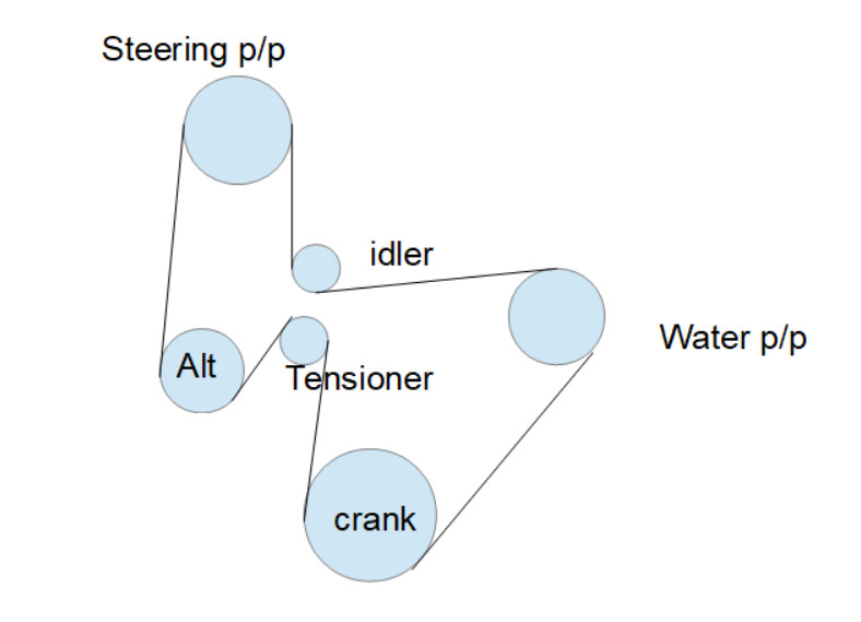

Turned out to be slightly different to the above, mine had an idling pulley as well as a tensioning pulley, sort of like this.
I was able to get a 15mm socket on the tensioner and put the belt on from above in a few minutes though, put it on the alternator last. I was expecting to take the drivers wheel off and work from beneath, so that was quite a pleasant discovery.
Glad it worked out OK for you, I have had some Ford diesels and without the book you just think they have given you too long a belt:)
