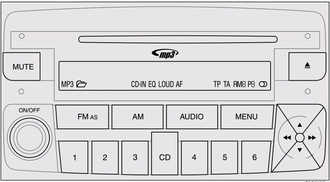

These pins are what I used; although I believe people have had success with 'modified' coathangers...! :eek:
They fit in the two pairs of corresponding holes (shown as tiny circles) on each side of the HU, as shown below:
