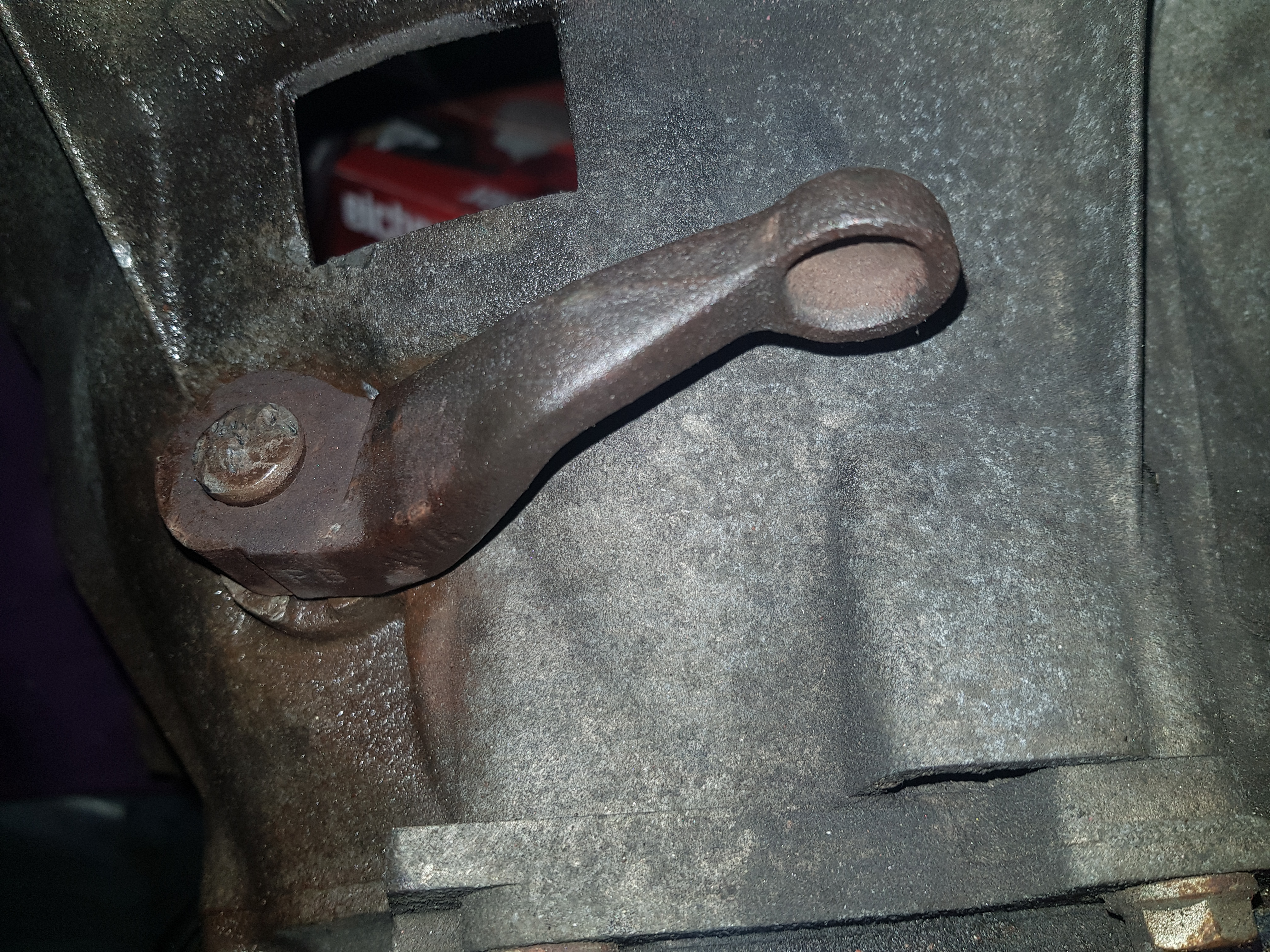

It would appear that the clutch fork is also different.
Only found out once installed the gearbox. The slave cylinder is way off for a decent angle to actuated the fork arm.
I've tried removing the one from broken gearbox but even after heating, loobing, hitting ... it's not coming off. And to try the arm on the gearbox now in the car... never going to happen.
Ive considered swapping g over the bell housing BUT double that up with not being able to get reverse at the gearstick, looks like I'll need to get a suitable manual gearbox .
