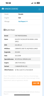

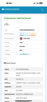

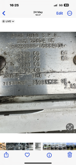

so with that info how do i find a part number etc for the flywheel found this also

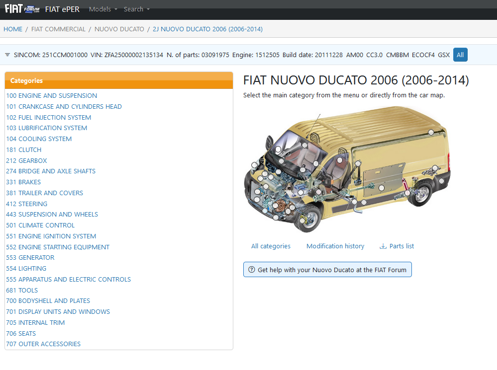

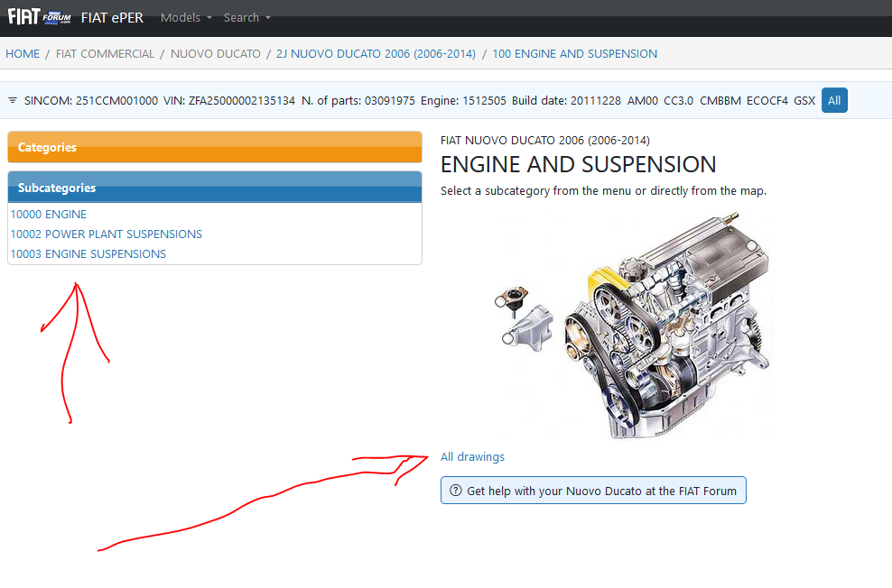

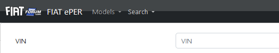

Click on the ePER button at the bottom of the forum banner:
It shall open in a new tab, then click Search:
Then put your VIN number in the appropriate field and click Enter:
You'll get such result, with the information proper to your van (those on the screenshot are the ones of my van) and click on the blue text line:
You'll get redirected to the parts catalogue relating to you van. Find the appropriate category on the left.

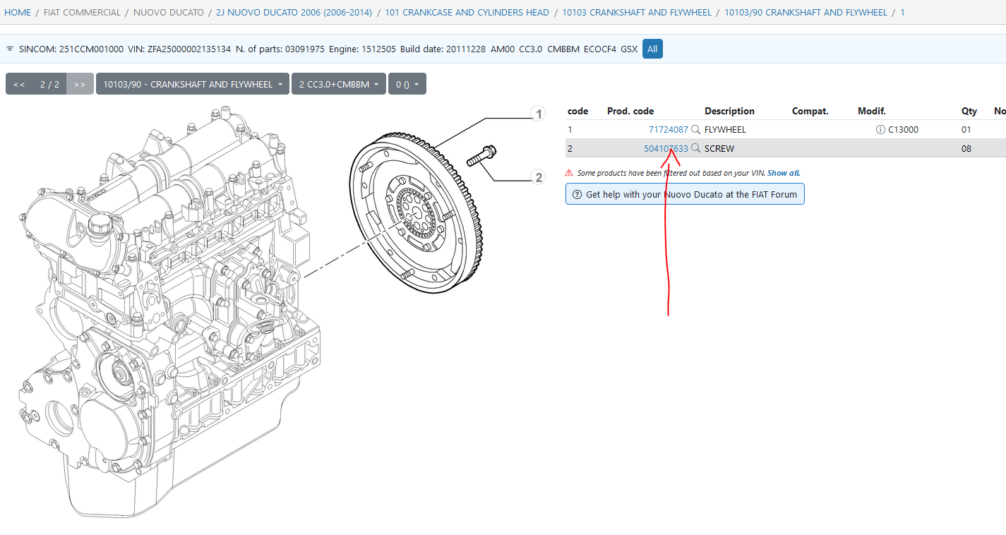

You can go through the subcategories on the left or display all category drawings at once:
When you'll find the correct one (with the flywheel), the part number is the blue number marked with another red arrow below.
BEWARE: the one on the screenshot reffers to my x250 Natural Power model!
If you click on the magnifying glass just to the right of the part number you'll be redirected to the google search in your browser with this number. Confirm with the seller the compatibility with your engine prior to the purchase as errors can occur.

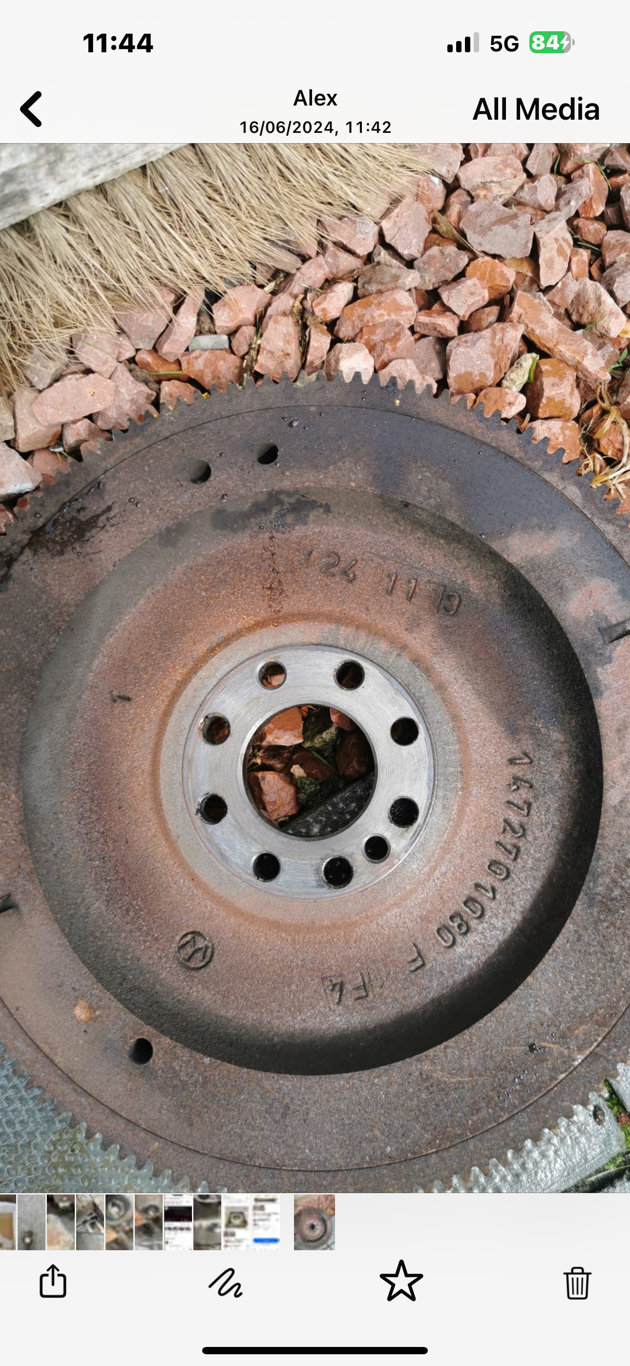

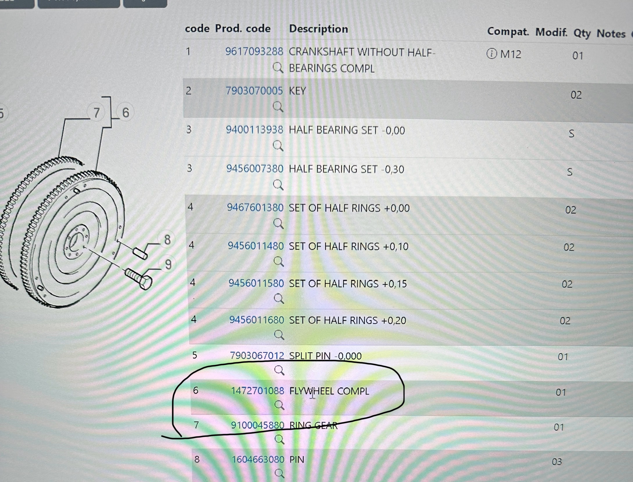

ok took it off and still cant find anything for that part number other than a few over seas that don't look the same any breakers anyone know of? part number 1472701080
