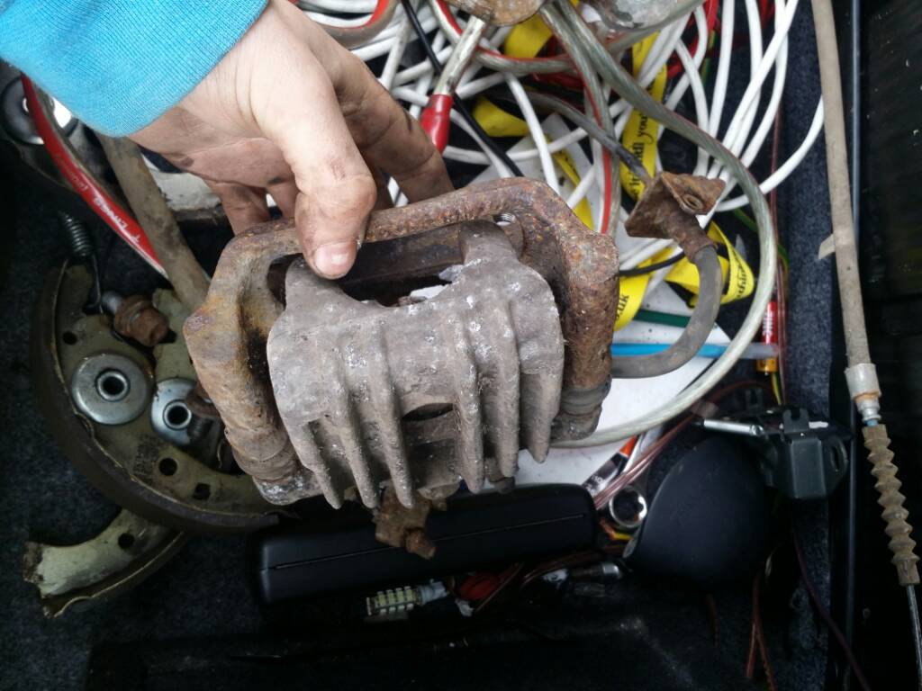

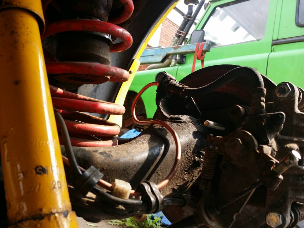

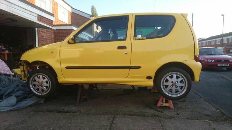

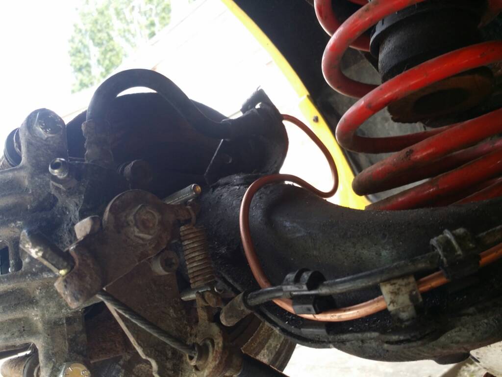

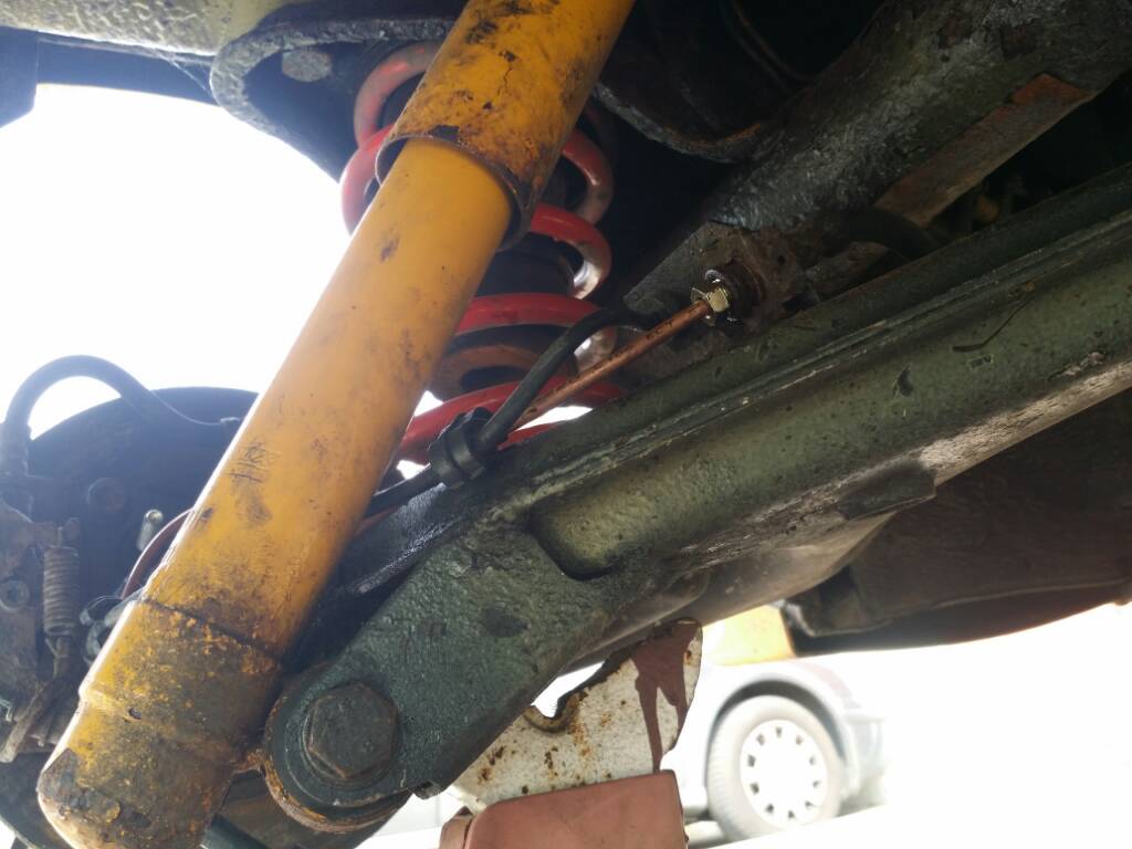

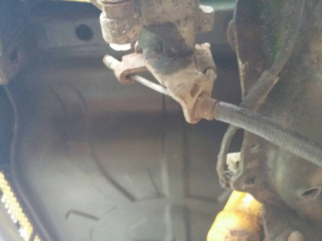

Actually got around to starting a job on the sei been getting the punto ready for brooklands so haven't had a chance to get on the sei but anyway I've managed to pretty much get the rear discs conversation all kn just gotta sort the handbrake cables and brake pipes out oh and trim the Allen key heads off the stud kit so I can do the wheel up all the way but it's nearly engine time 1460922022411.jpg1460922034204.jpg1460922045764.jpg1460922057434.jpg1460922069474.jpg
