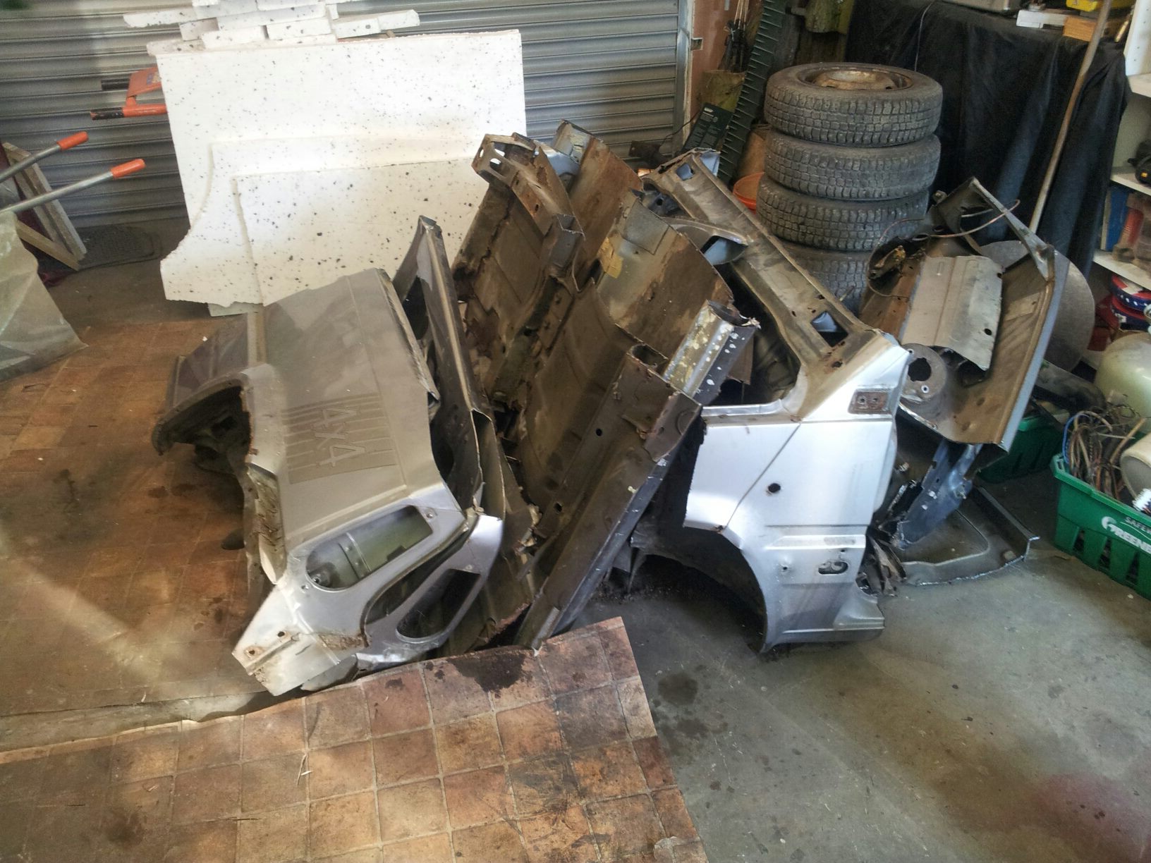

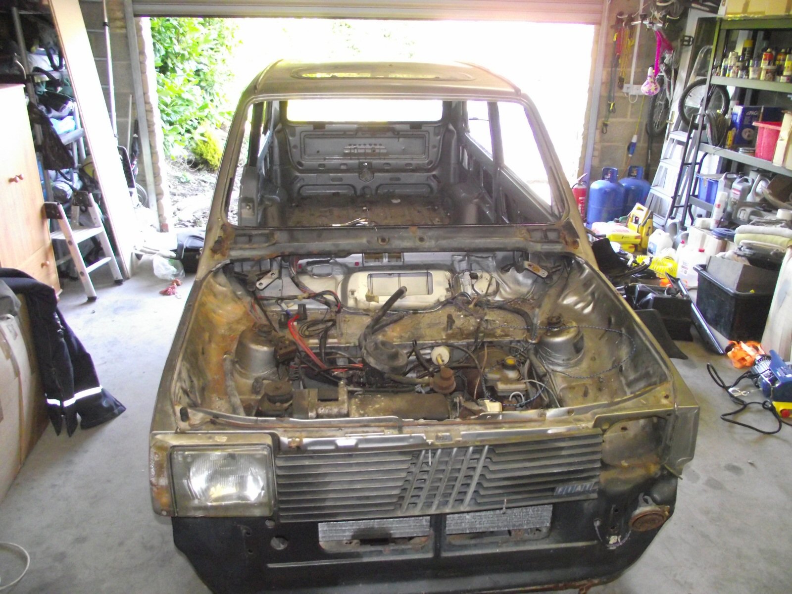

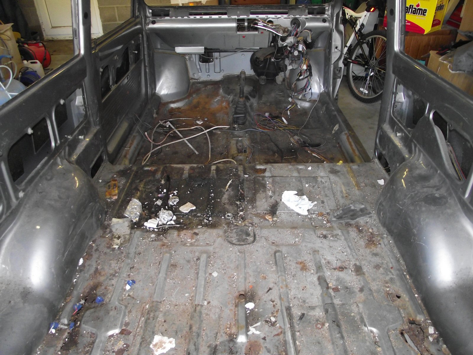

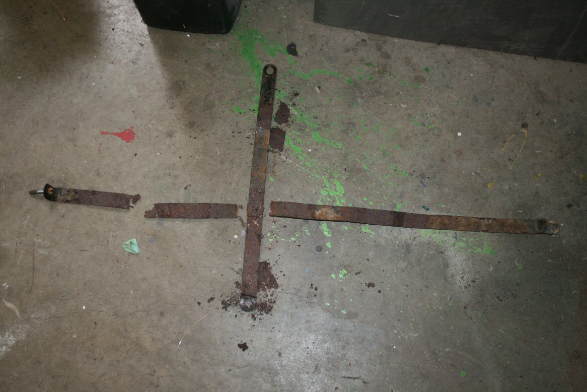

Last week I decided to have a good look at 'The Grey' and CLX I got to use for parts.
Long story short I'm not going to put this car back on the road. The rot to the structure of the rear of the car was just too much to do. It would have been fixable with a LOT of time, but not when I have the wife's Celica to paint, the Jeep to tinker with and the..... well you get the idea. I don't want the garage tied up too long with one project.
RIP 'The Grey' I've kept the bits from it like leaf springs, drive train etc. The only new stuff I bought for it that won't go on the CLX is the fuel tank so I'll just stick that back on Ebay I think.
Anyway looking at the CLX I got for it's parts it is in really rather good condition, I've only spotted a bit of welding needed on the rear floor and on the rear quarter after it's had a nock. So I'm going to put that one back on the road.
I've already stripped the rear suspension and ordered some bits like springs and rubbers. I'll kick off another thread about that one soon. For now though MK3 is now closed.
It's quit nice to know that a panda body shell can fit into a Jeep Grand Cherokee though :cool:

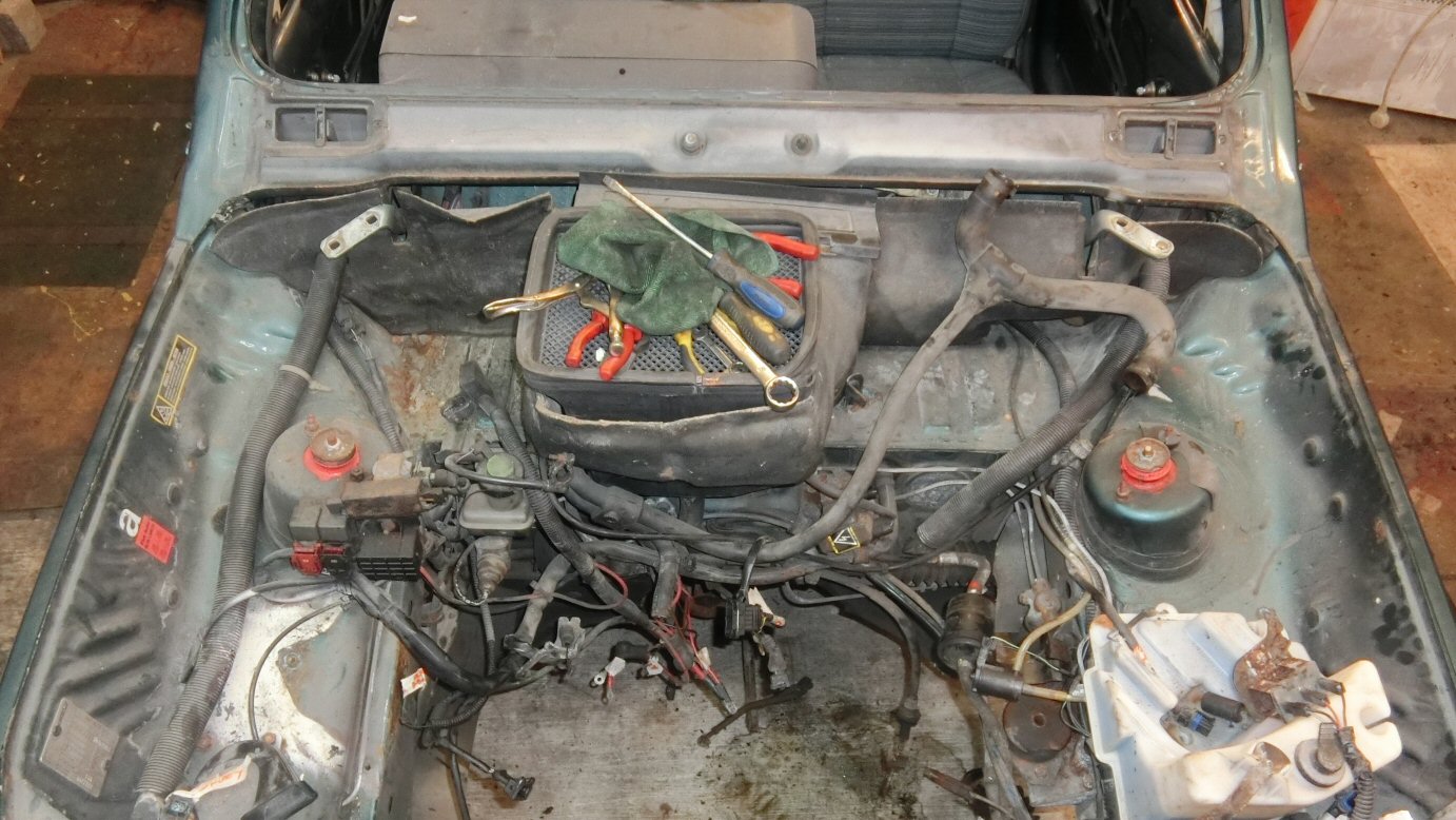

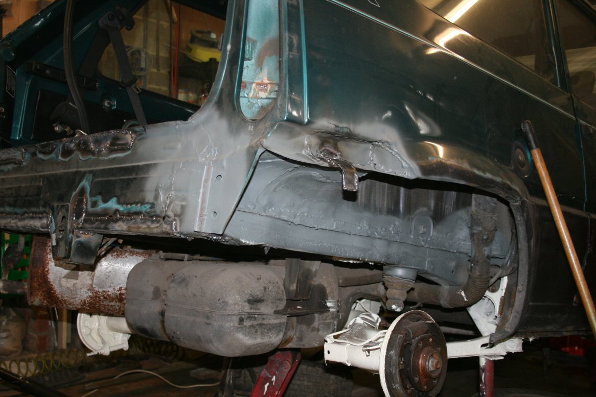

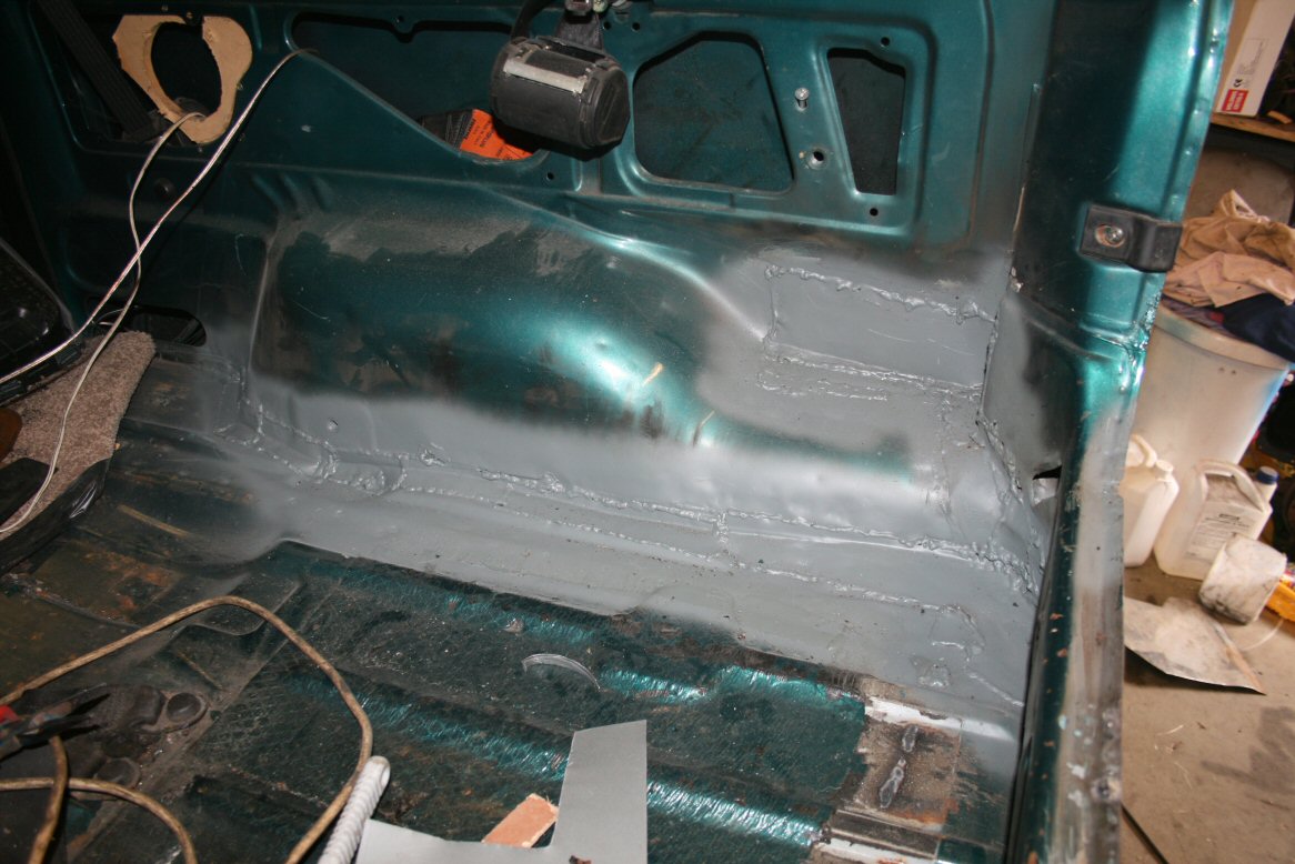

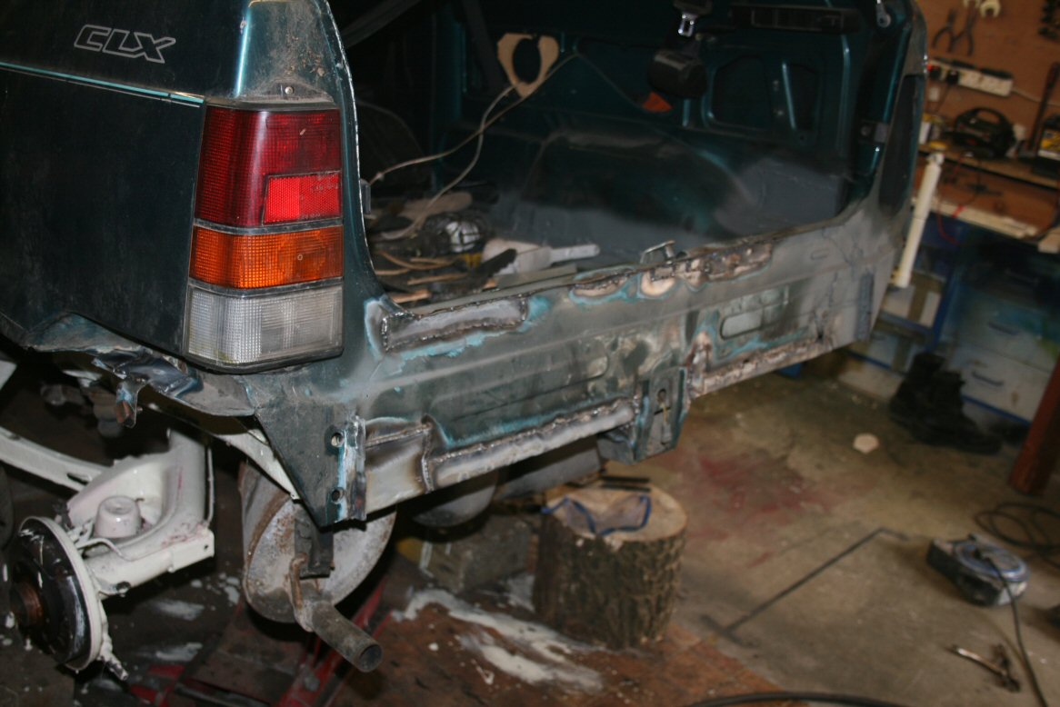

After 3 years I've finally decided to do something with the CLX.
Although I still have the box, propshaft assembly, springs and rear axel from the silver 4x4 I'm not going to use them. I'm going to keep this one a 2wd.

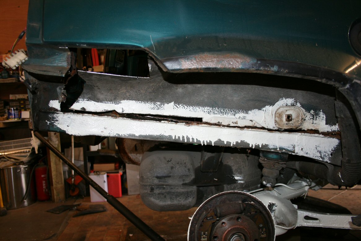

There was a bit of rust on the rear end to sort out. It looks like it has had a slight bump on the rear end of the drivers side and that has let the tin work get in.
The tailgate area was also not very well. All sorted now though.

Wouldn't be right to now pull the engine and box out and sort that out too though would it.

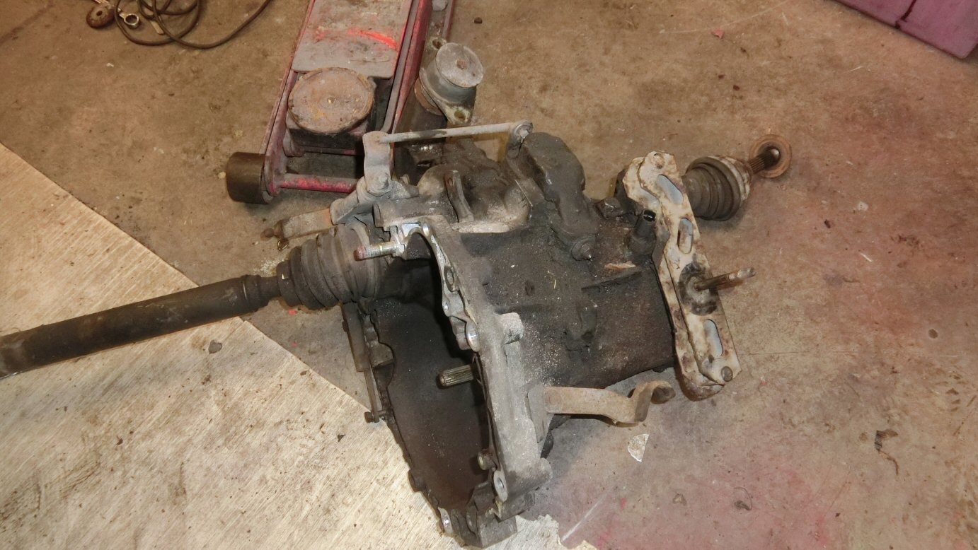

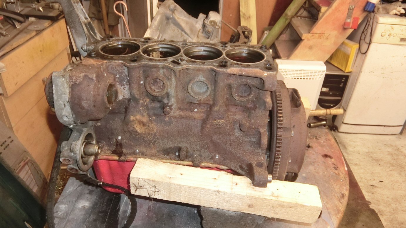

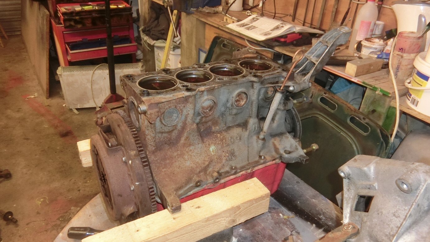

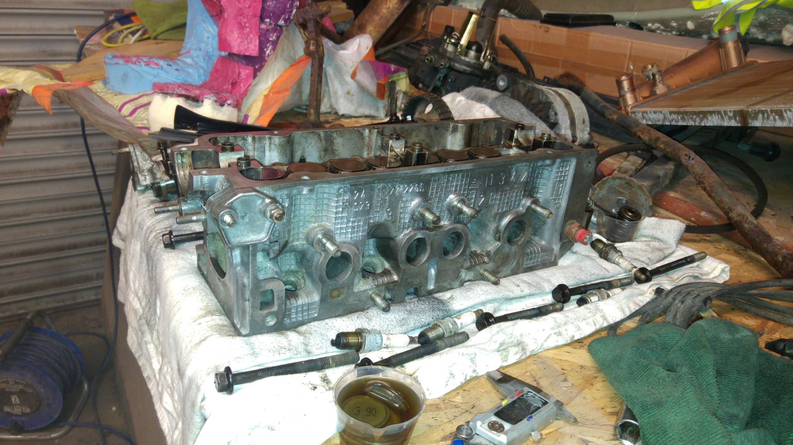

Not happy with the gearbox, syncro from second to third was shot. Luckily I found a low millage one one Ebay. It was rather dirty when it came, so I've had the steam cleaner on it.
Also cleaned the engine up and removed the head to to a leak down test on it.

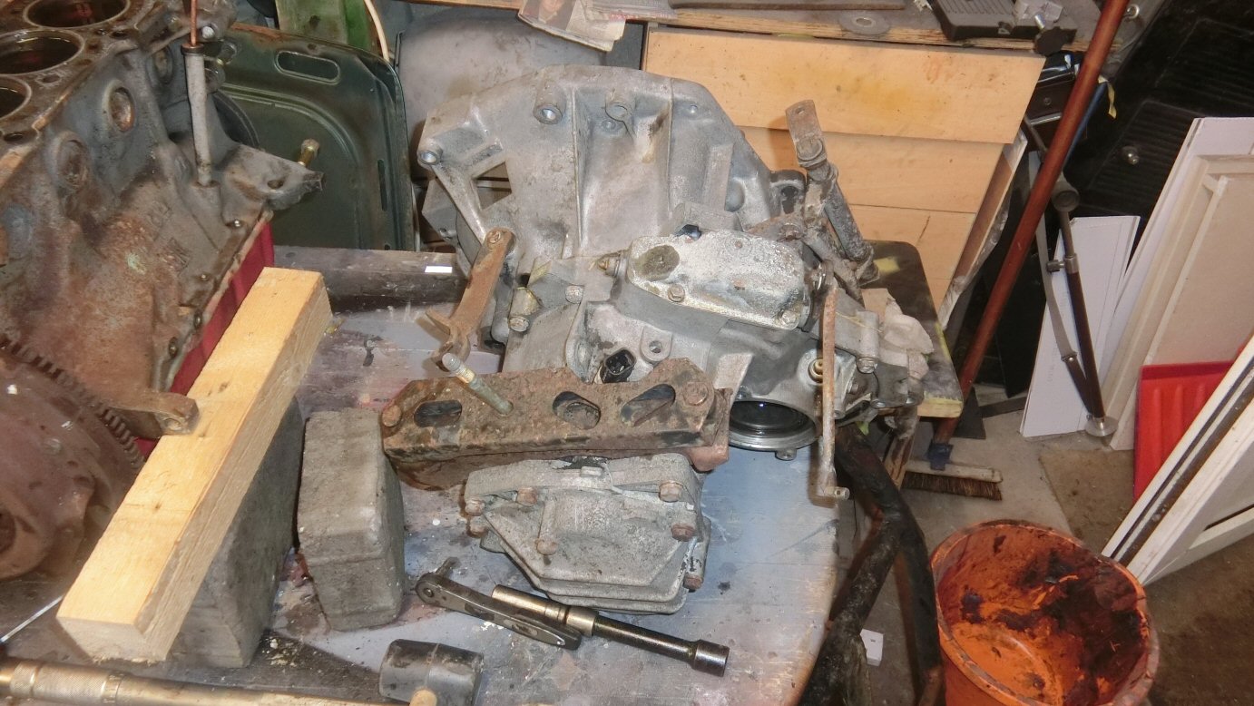

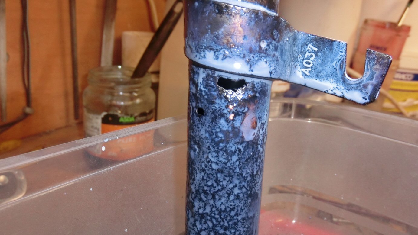

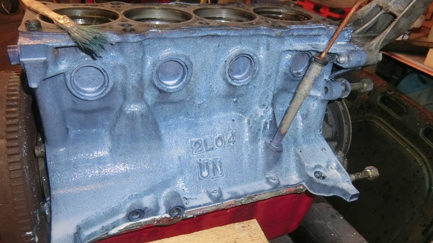

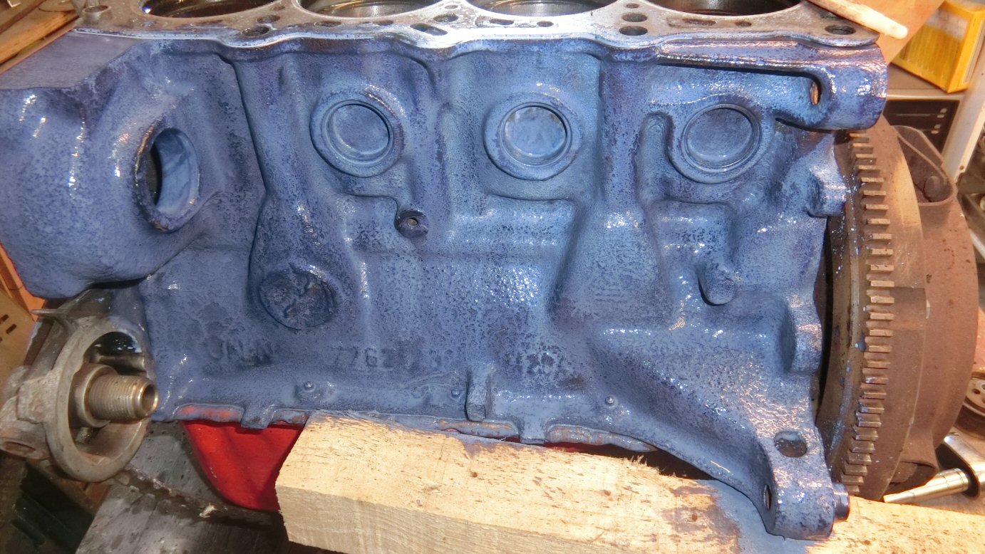

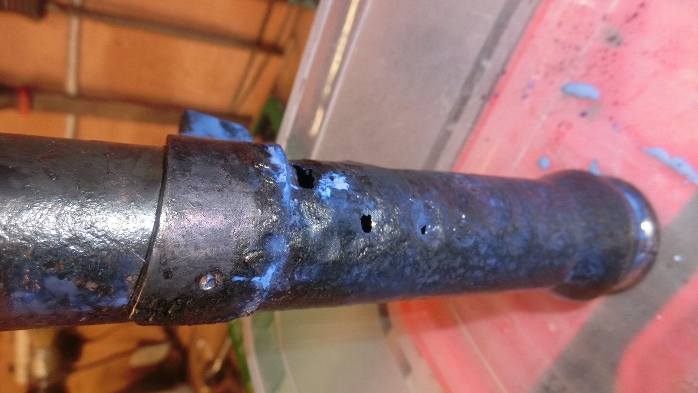

Rust converter time.
Block looking good.
Same can't be said for the water pipe :eek:
Good job I've got rust converter and resin repair paint to address that pipe!!

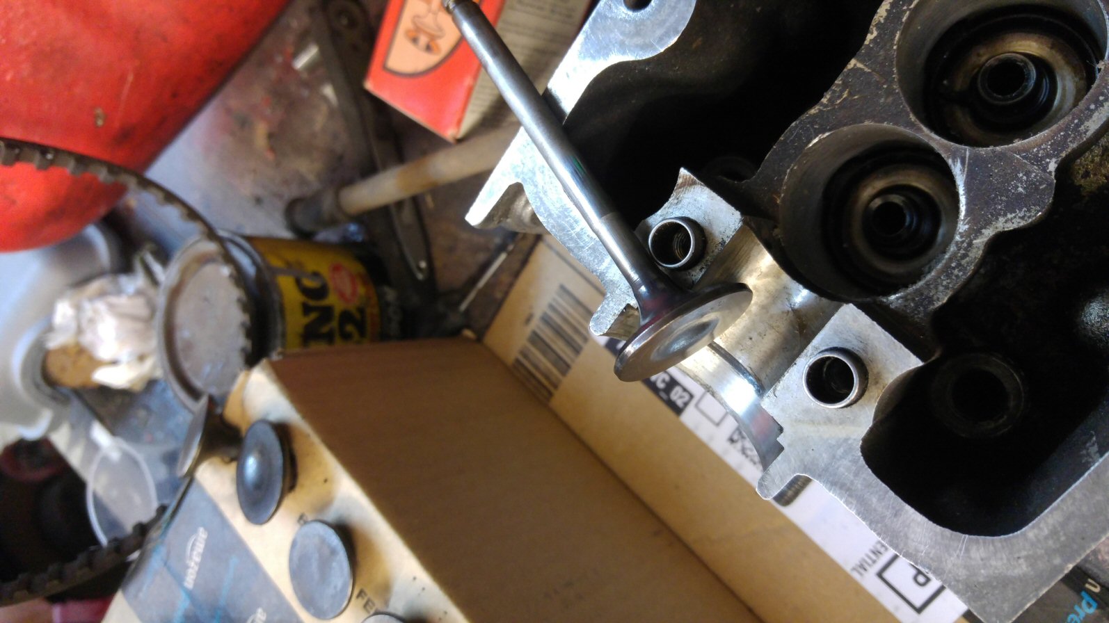

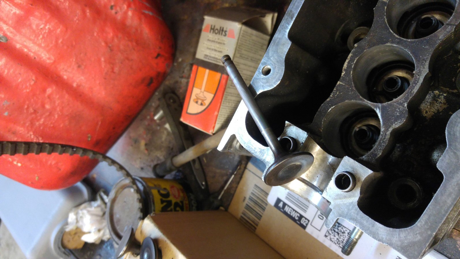

Head stripped ready for new seals and a clean up and port.
Cleaned up, valves and seat re ground and all reassembled.

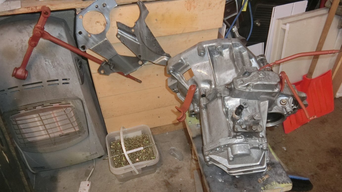

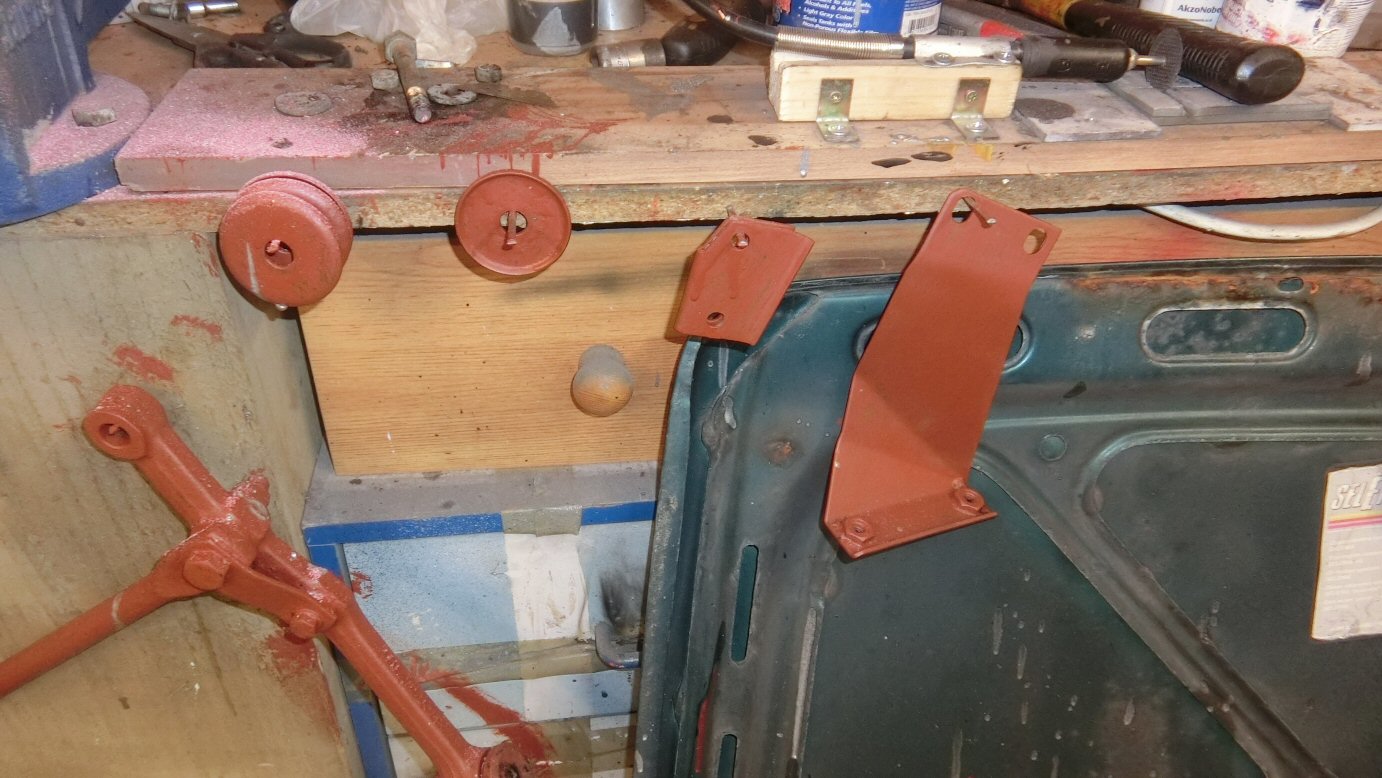

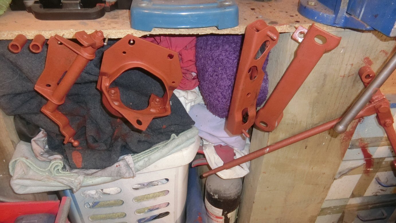

Some assorted engine, gearbox and suspension brackets cleaned, rust converted and red oxide added.
Front suspension bushes removed and new ones in. I hate that job. Over an hour for each one :eek:
Bit of polishing done on the gearbox too.
