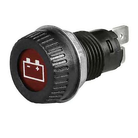

If you use a panel lamp and put it in the dash you will get a failure indication. At the moment you are looking at a BCM replacement / repair.
A direct connection is not ideal as it might damage the regulator. It won't work with the DMM on volts because it will not pass enought current. You could use a a LED with two resistors and a diode.

True about the lamp, that would be a good fix in the end. But I'm not sure we should look at the BCM yet. Since it does detect on the D+ that the alternator doesn't run and puts on the warning light, and puts out a steady 9.5V leads me to believe the pin is working like it should. Btw the DMM was put in current mode and connected the right way. I just tested it with a small battery and it doesn't conduct, my other DMM does conduct so I guess it also has a problem. But one at a time ;).
