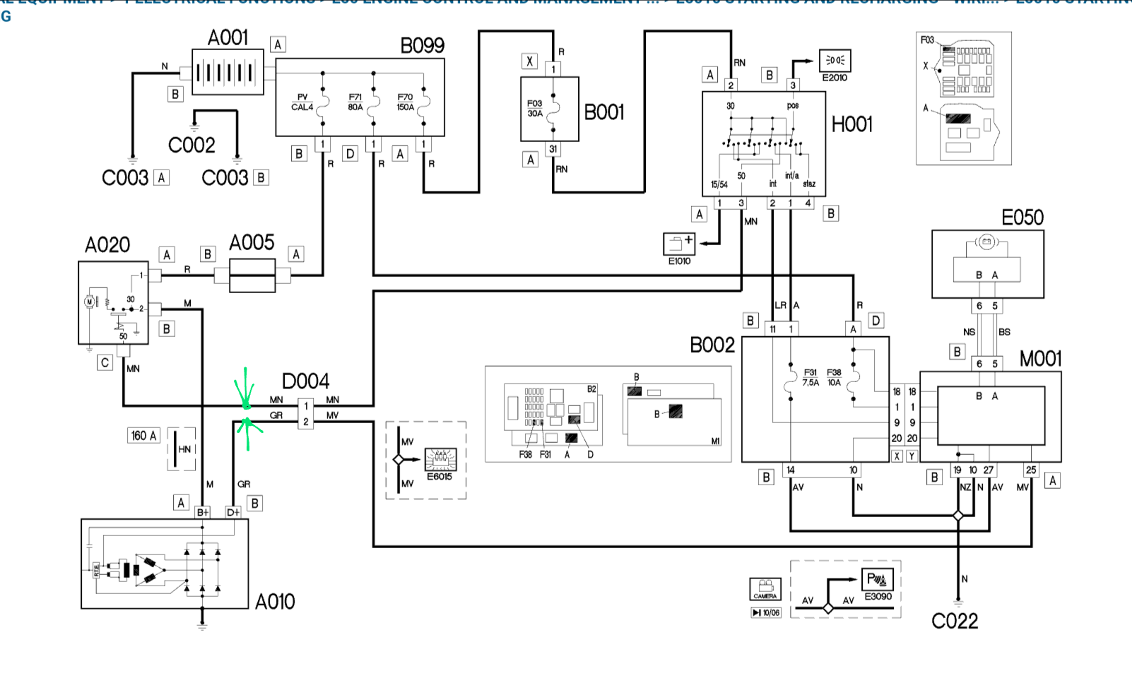

@koalar yes that's correct.
If you jumper these two wires
At ignition on D+ would still be below 4.5V
At cranking the D+ would get battery feed
At engine running D+ would be normal output
Shouldn't throw a battery light error
Not ideal
Not ideal
this is the signal to the starter motor, with D+ at 14V this would keep the starter motor engaged...
