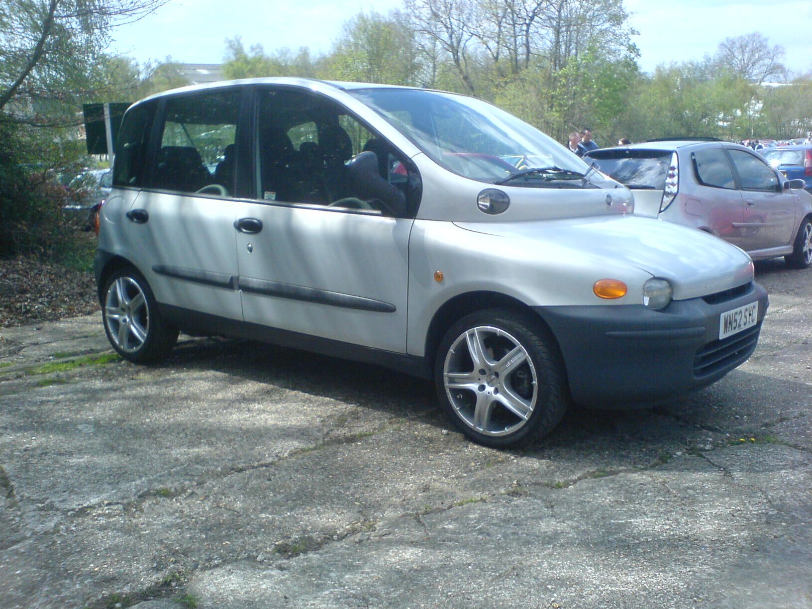

Saw this one at Brooklands, needs lowering though
