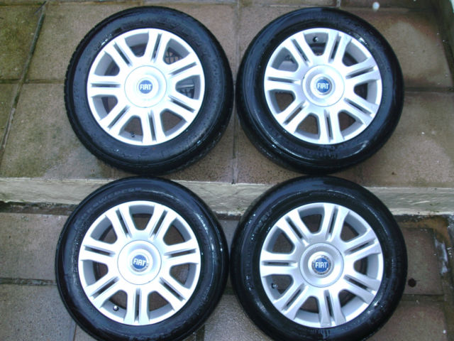

I bought some very cheap alloys off ebay this week to fit to the mk3 after winter.(y)
They came off a Doblo and are Fiat so I presume they will fit, they currently have 195/60/15 tyres on but three need replacing. I searched on here and see 50's are the best size so will seek out some reasonably priced tyres in the spring (unless I can't wait and get a set of winter tyres:D).
I presume my current wheel bolts on the steelies will need changing when I fit the alloys, what size bolts do I need please? also a set of anti theft lock nuts too same question please.
The alloys are beastly brutes but they have got to look better than the awful grey plastic trims currently on the Panda:)
Edit: Can the blue logo's be changed for red or is it a paint brush job?

Width: 6J Stud Diameter: 98
Rim Diameter: 15
:eek: I may have forgot to ask that and it's not on the listing :eek:
:bang:
http://www.wheelfitment.co.uk/
these guys say yes, panda and doblo same fitting?
i wouldnt belive that as it also says mk2 punto is 35 to 45. thats not right.
the ET should be on the wheels some where
So to recap, I am asking:
Will these alloys fit or do I need spacers?
Can I reuse my bolts off my steelies, if not what size do I need? Ditto for size of locking wheel nuts/bolts
What it the recommended tyre size [do not want low profile tyres] without fouling the arches etc for this 15" alloy?
Yeah I know I've made a rookie mistake in not checking this out first :bang:
I'm hoping if I take the alloys to my friendly garage they will test fit them and look for problems with fouling on the ramp, otherwise it's back to square one looking for some oe rims.
Did think of test fitting them myself but Panda mk2 Fizzle won't give up her spot on the level concrete drive until I treat her to a new battery.
Was also looking forward to fitting a new stereo head unit but seeing as ebay seller didn't include DIN cage... :mad:
2 x Panda = double the fun squared by frustration :eek:
Yes, Fiat :p
As far as the bolts go you want M12x1.25. To work out the length measure how much exposed thread is on the back when you put a bolt in your steelie, then do the same with the same bolt in your new alloy - add the difference +5mm (to accommodate the spacer). Easy peasy :)
