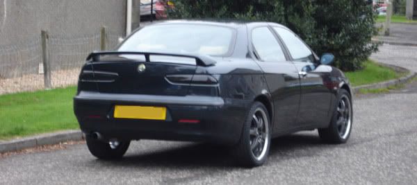

Here's an arse shot of mine, can't find any recent shots of the front lol
