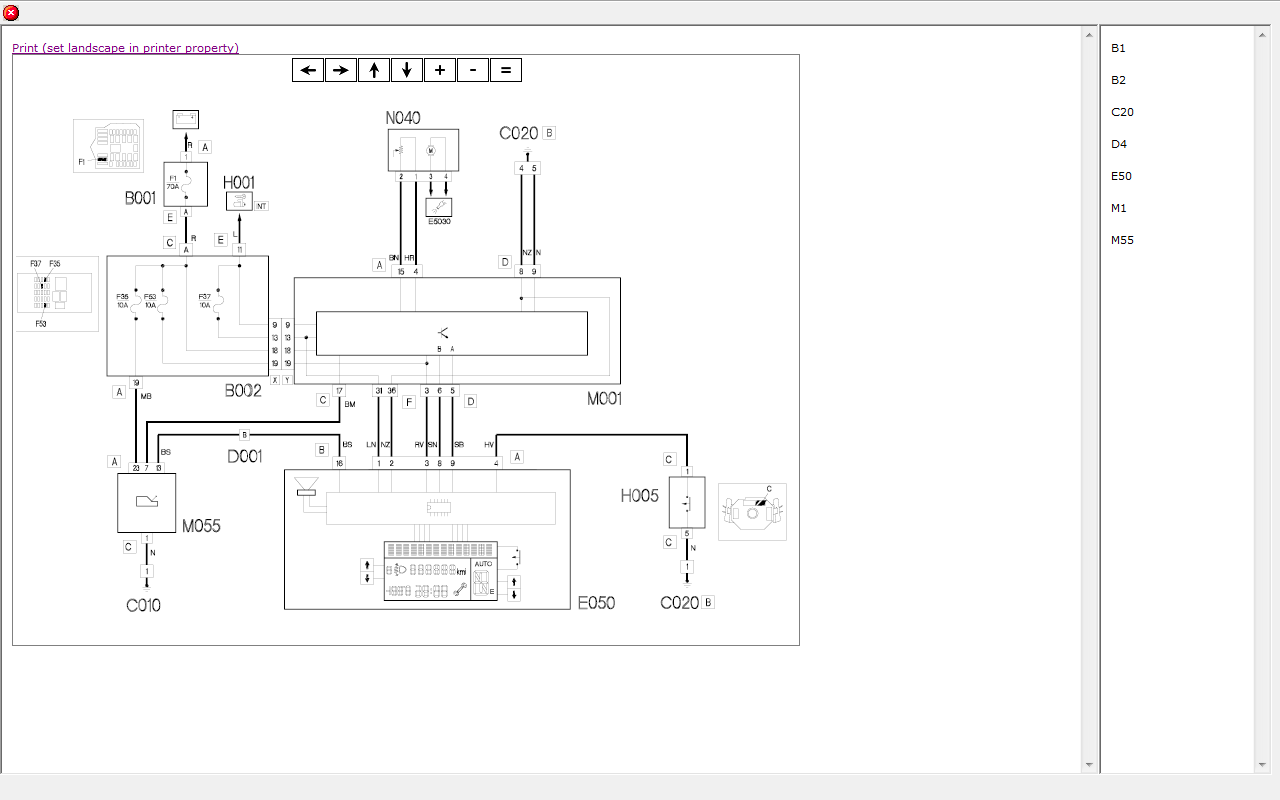

If you have eLearn for 147 search for trip computer wiring diagram and post here to compare. Here the Punto trip button is shown to connect connector C pin 1 to ground via pin 5. It will be interesting to compare.
It's identical. Also, where did you find eLearn for Punto 2b?
These diagrams show the button should work, both Punto stalk button and 147 button connect Connector C Pin 1 to Pin 5. The connector seems to have moved position on the stalk unit. The connector is 6 pins, maybe they are reversed order? Did everything else work OK? At least now you can check the stalk unit with a multimeter to see if the button is faulty. maybe just needs some cleaner sprayed in.

If the rear wiper worked OK and washer pump activated OK it is a good assumption the pins are connected in the right order, see below: Connector C Pins 2,3,4,&5 accounted for on rear windscreen wash/wipe. Just seen your reply. good luck and update if you fix it.
