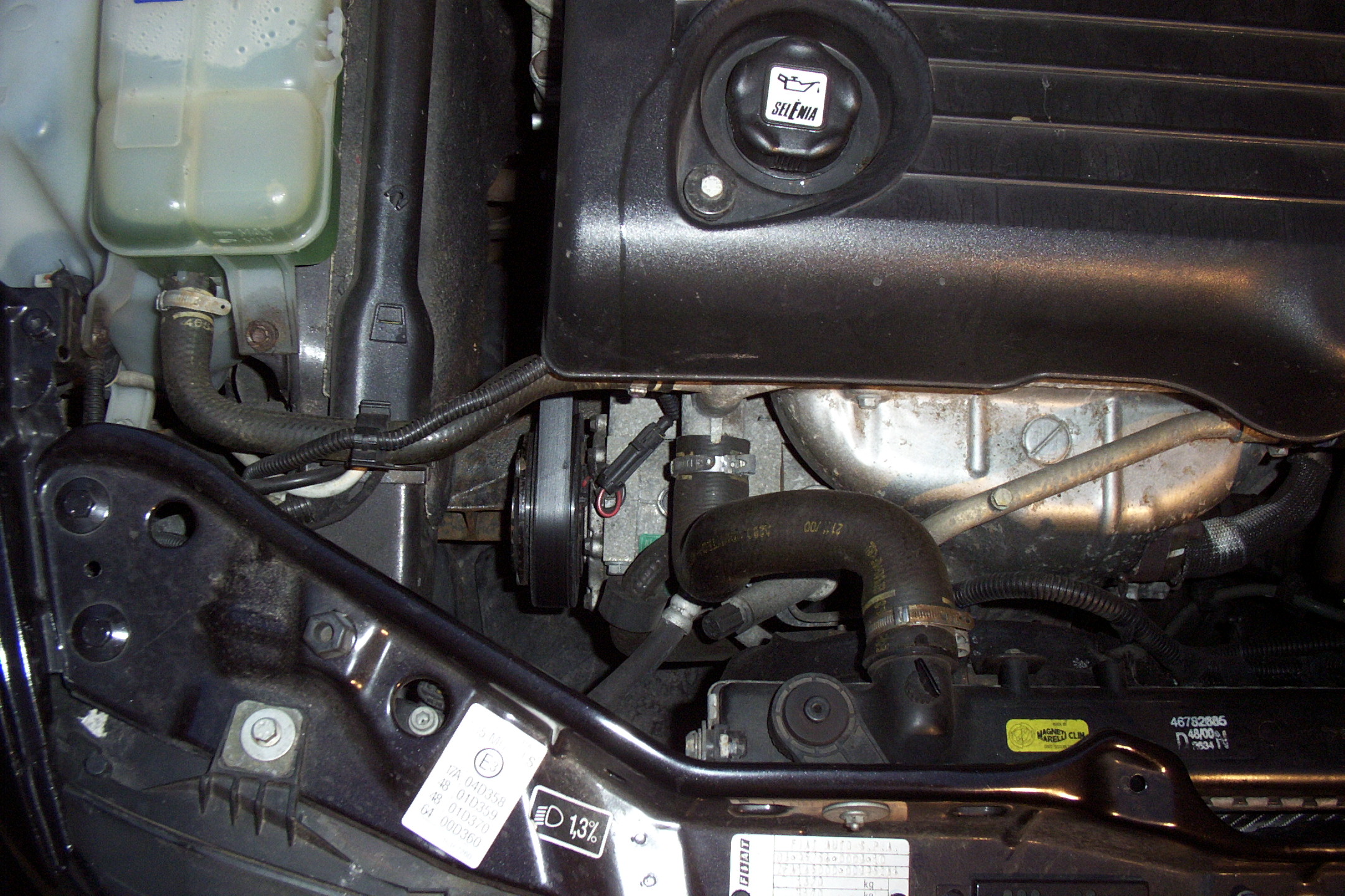

Hi all,
ive been searching through the forum and found alot of threads about problems with the aircon, but i just couldnt resist and post my own problem too.
I bought my Marea second hand last year, and had the airco cleaned out and refilled then. Used it last summer, and a bit in the winter, but now (its bloody hot) its just not working anymore.
When i press the snowflake button, the light comes on but I:
1) dont notice a significant drop in revs
2) dont get the nice cool air i used to have
The things if tried / checked and didnt do:
- i read you should use your aircon once a week, even in the winter. I didnt do that :bang:
- Since its refilled last year, i reckon it cant have drained, can it?
- i checked the fuses, they are all good
- the compressor belt is running, but im not sure if the 'inner' part of the compressor runs when i turn on the A/C
- one thing ive noticed is that my engine coolant blower isnt running when the car is in stationary (you know, the two big blower in front) Im not really sure if they run in stationary or only when your driving?
- i tried using the error code check, but since my marea doesnt have the climate control (just the Aircon) this doesnt work.
I'm in the proces of going to the local garage but just wanted to be sure im not going to make a complete tool of myself there :devil:
