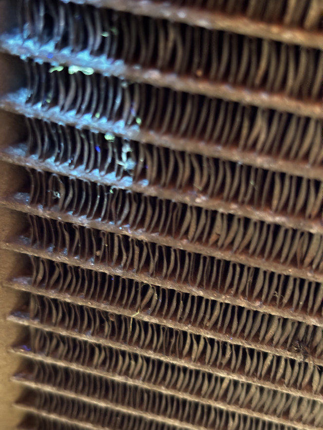

In the meantime I obtained a uv light but I could not find a leak in what I can see of the system - So as I had not seen any UV dye, just to check the uv light was suitable I checked the Low Pressure (LP) port where the dye had been inserted.
Bear in mind that at this point when selecting the AC, the compressor was still clicking in.
When I unscrewed the LP cap it felt tight and there was a small escape of gas - I suspect the schrader valve is tired/faulty. However there was only a small trace of yellow uv dye. The AC pump now no longer clicks in, so we are back to a too low pressure.
For note the HP port did not expel anything when removing the cap.
However, I wish to belts and braces my diagnosis by checking the evaporator for leaks, which goes without saying, is buried deep deep in the dash.
I’ve got a portable endoscope and the UV light.
My question to those in the know is , whereabouts is there in the dash with minimal dismantling that would allow access to shine the uv light upon the evaporator whilst viewing it with the endoscope…..
To answer my own question - it’s an impossibility to see the full evaporator without dismantling, so I plumped for a condenser change as it was crusty and there was one section that had threads of UV dye seeping - it was a good call as I now have working AC.
