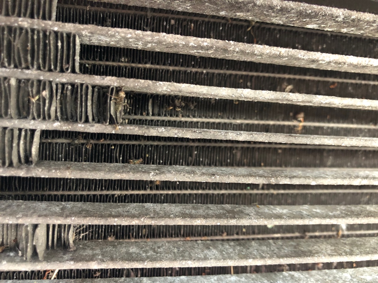

Our recently acquired 2010 100hp has a climate control system that needs a bit of attention. The interior cooling fan is doing a lot of work in warm weather and the air con is not cooling the air. A quick look at the condenser surprised me. Looking through the front grille I can see a lot more of the radiator cooling fins than I expected. The foil baffles between the horizontal fins of the condenser have mostly disappeared. They look like they are made from thinner foil than the stuff we use for cooking.
A mobile air con specialist has visited and has confirmed the compressor and other parts of the system are functional. The system was not filled with gas as he has advised we need to replace the condenser which has leak. Various after market options are listed at various prices. Does anyone have any experience of differing quality between them? The dimensions listed online seem to vary slightly from one brand to another. Is this just different makers taking their measurements from different points or are there lots of different size units available?

A radiator / condensor etc is made using two principles - one, using flattened pipe and bent back and forth in a concertina pattern OR a single pipe with pieces of metal with holes welded onto it. In yours, you have flatened pipe with thinner metal between them to increase their surface area - which are missing.
The theory is to increase the surface area of the metal so that more air can be effected by the temp of the radiator. Look at the radiators in your home, and compare the ones that have the extra metal bits in the middle to the ones that do not, and you will find that the ones with extra metal bits (called vented) have a higher heat output.
If these pieces of metal, normally very thin flat steel, have broken off / are missing, there is a high chance that there is leakage at where they broke off.
In your case, this happens to be part of aircon system, and since working on same is highly regulated, the only people that will be able to know the difference between brands are the same people that really don't care - as they are more interested in brands that fail / weep so that they get more work.
Metal fatigues over time / use, and an aircon system rad will endure cycles of compression expansion which limit its life. I suggest that, as a marker, that you use something other than aircon products that a company makes to compare its quality - i.e. most aircon radiator makers will also make turbo radiators and main radiators.
BTW, as you state that your aircon is empty, why not remove the condensor and drop it into a recon place to get it redone / sealed etc., there are a few of them in the UK (according to Mike Brewer) - after all, it is just a vented radiatior so most rad specialists should be able to recondition it.
Really common problem with fiat condensers, replacements are cheap and plentiful. Not worth reconditioning it, that thing is f**ked, badly corroded and likely has the gas tightness of Swiss cheese
This is extremely common with Panda/500 condensers; I've seen cars less than three years old with most of these foil baffles missing. Take a look through the front grille of most of these cars, and you'll likely see something similar.
I have owned other cars of greater age and have not seen a condenser as "transparent" as this one
The baffles seem completely unable to cope with the UK climate. Given the state of most OEM condensers I've seen, I'd buy just about any other brand; they could hardly be of any worse quality.
Interestingly they don't usually leak gas; they often remain functional, gastight and perfectly capable of doing their job for many years after most of the baffles have disappeared.
My own Panda is 13 years old, and had lost most of these baffles by the end of its third year; the A/C is still functional and gastight.
That said, the one pictured does look like it's had it. Given the low cost of these condensers, it would seem sensible to replace before doing a regas if it looks well past its best, even if it's not actually leaking.

The mobile air con specialist returned for a second visit last week. He supplied and fitted a new condenser and serviced and re-gassed the system, just in time for a heatwave weekend.
The price he charged to do the whole job was not much more than for us to purchase a condenser and pay for the cost of a re-gas. He is experienced and equipped to check the whole system and if there are any problems in the future we have his support. On this occasion we decided it was not worth doing a DIY project.
The climate control is now working.

I'm currently working on my newly bought 2008 500. A side observation in removing the bumper and drilling out 4 bolts, is an almost complete lack of fins in the condenser. The AC still "works".
