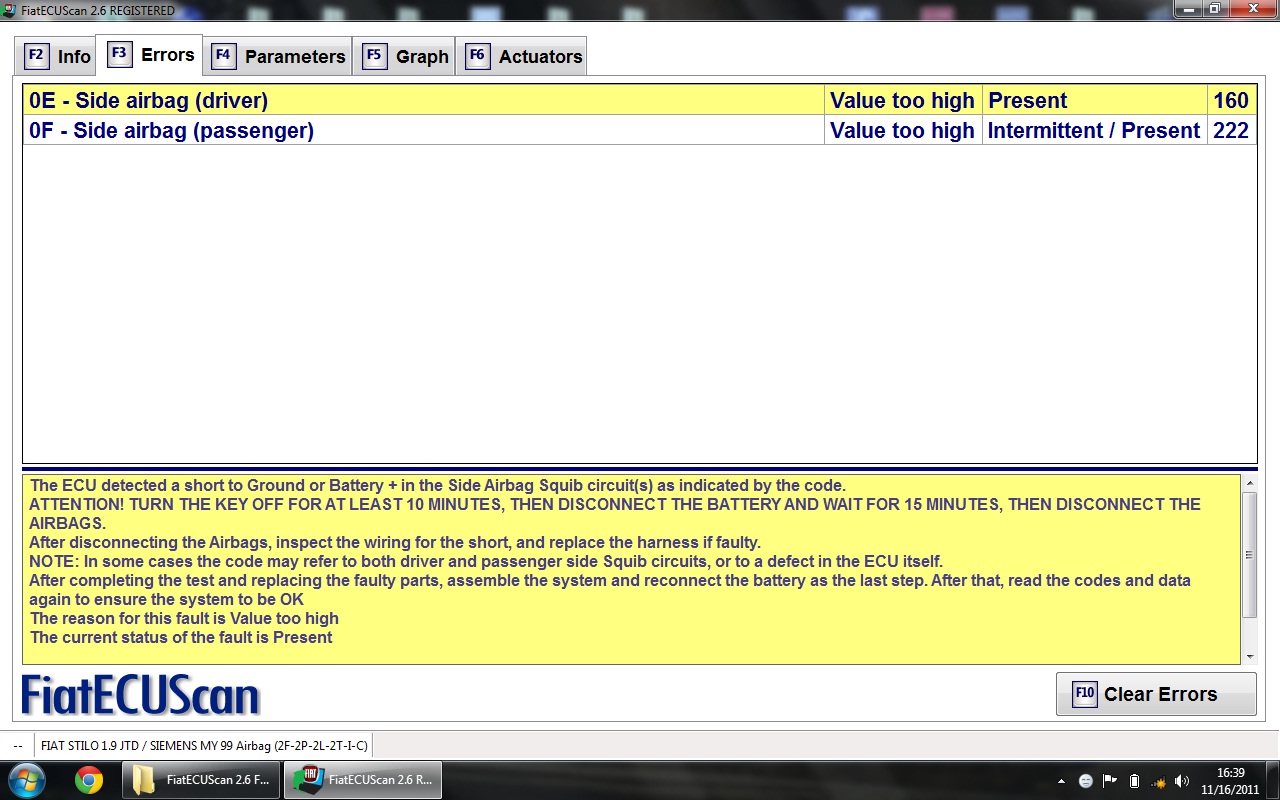

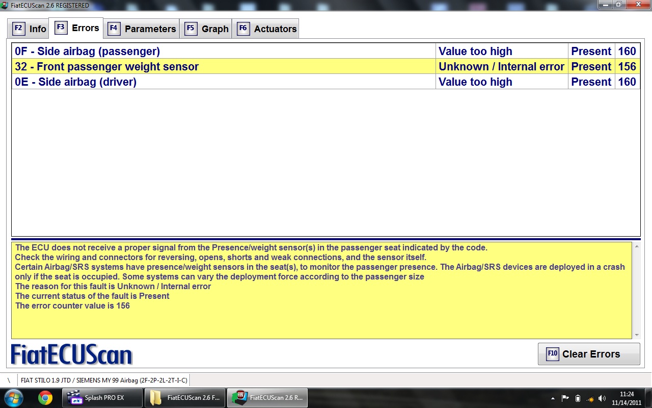

I have a problem with the Airbag system on my Stilo JTD
I`ve scaned the Airbag ECU with FES and I have 5 errors. Can you please help me figured out ?
The only one I know is the OCS problem. I`ve solded the wires on 4 orange connectors (under the driver and passenger seat and in the boot)
Thanks!

If i remember right value too high = too much resistance on the circuit, I could be completely wrong though, and as you have said the other fault is the OCS mat in the passenger seat

After cleaning the connector in the glove box I`ve left with only 3 errors:
- OCS
- Side Airbag (passenger)
- Side Airbag (driver)

After replacing the OCS still remains 2 errors: Side Airbag, driver and passenger
