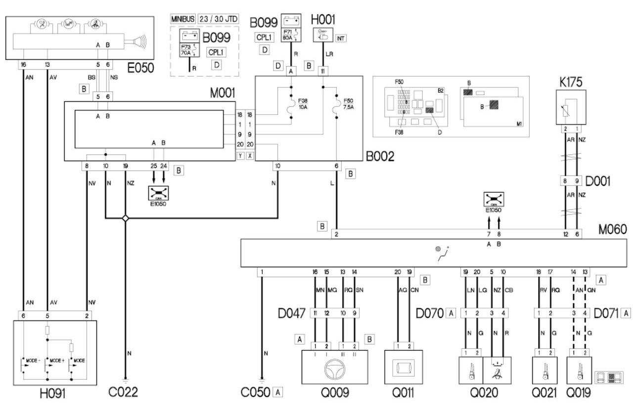

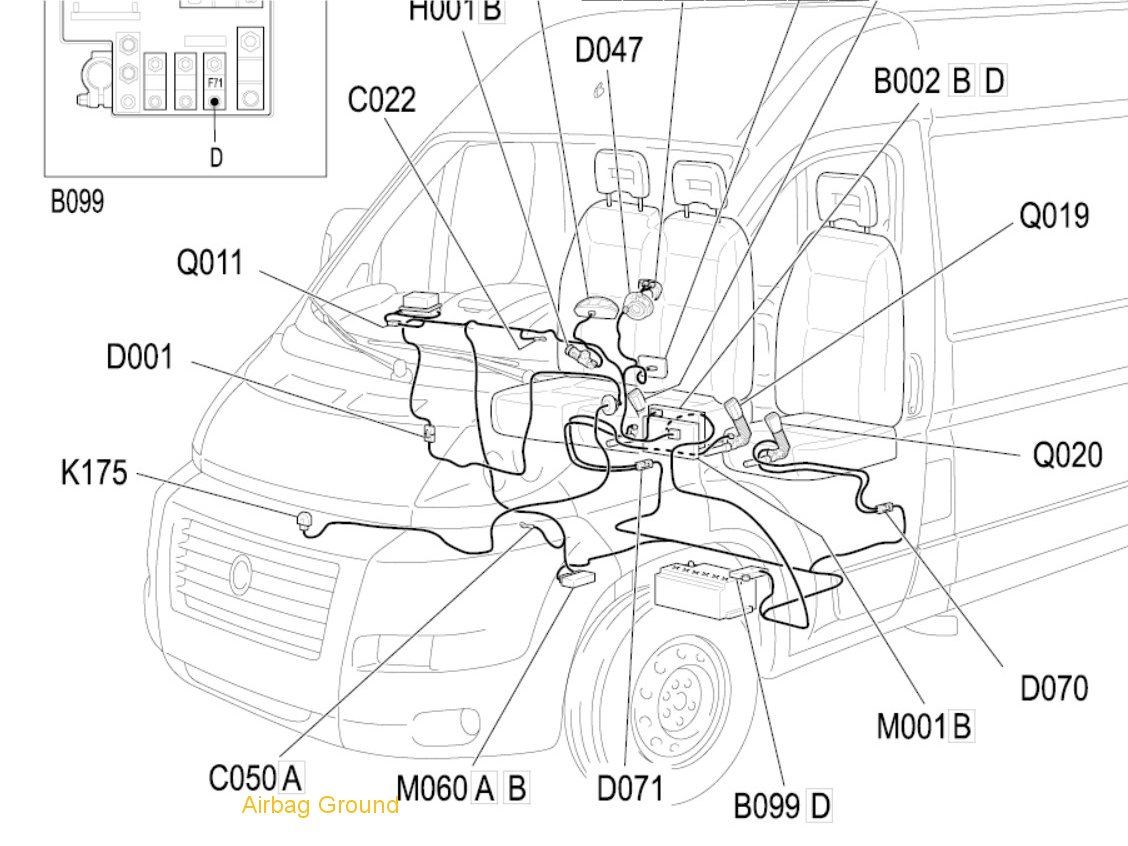

This error code indicates a fault in the connection between the metal case of the Air Bag Controller and the Vehicle Ground. I suggest you remove the 3 (?) nuts, clean the contact areas and reassemble. Maybe the position under the floor makes it vulnerable to water from snowy Swedish Boots :) ?
There is another ground connection via a wire from the Air Bag Controller M060 to the Ground Point C050 nearby. I suggest you check this out too (See pictures).

This is perfect. I forget to write that I have mounted an external cable from the nut/ECU metal case directly to ground on the battery. It didn´t help.
But I will check the M060 also now!

I tried with a external cable from the metal case of the airbag controller to battery ground and another external cable from the C050 (nut attached to chassi) and to ground of the battery. Clear the faulty code and started.
The airbag lamp is still on :(. Maybe it is time to go to the Fiat dealer for investigate ... 👨‍🔧🤑

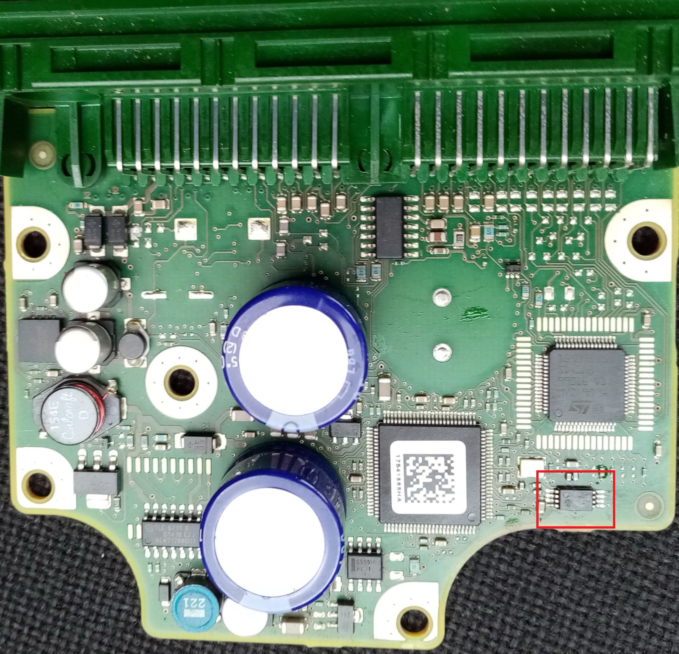

I've fixed B0102-00 myself, it has usually not much to do about the ground issue, fault is permanent.
It requires hot air station, CH341 programmer (can be cheaply bought from Aliexpress).
Eeprom needs to be desoldered and memory reprogrammed - memory area between CE0 and DE0 needs to be cleared (FFs) and Eeprom needs to be soldered back.
I am happy to help out.
There is also a guy in Poland which can do it for around 100-125EUR to save you some hassle.

Hi Tomson, i am from Czech Republic and i have this problem too. Is any contact to you. I need little consultation please. Thank You,
I am just a hobbyist and speak broken Czech, feel free to post a message here. I will try to help you out so everyone can benefit from a public post.
OK, do you have some photos of inside airbag ECU? I dont know where is eeprom and if is hard to remove it.
