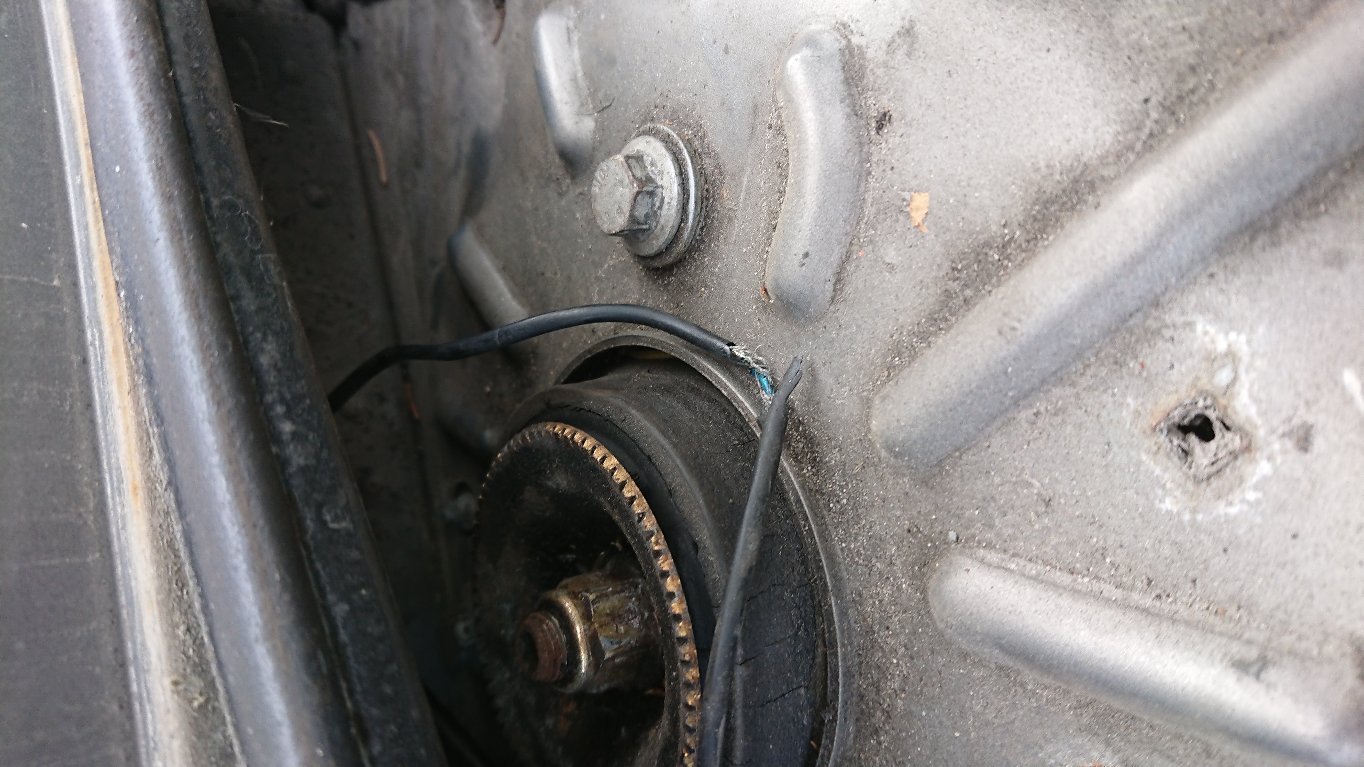

Have had an airbag light warning for some time.
Multiecuscan came up with a error 31 on the driver seat (Side Airbag Squib circuit).
I tried to work the connections under both the seats and gave the connections lubrication.
No luck.
Then in the boot I noticed a wire that was stuck in the top of the shock mounts.
Got it out and saw it was damaged, got it together and the warning light went off.
Hi again, sorry for placing the incident in the boot, it is of course in the car engine room just in front of the driver.
I would suggest everyone to check for loose wires that can get trapped between the mounting plate and the rubber part in the top of the suspension.
