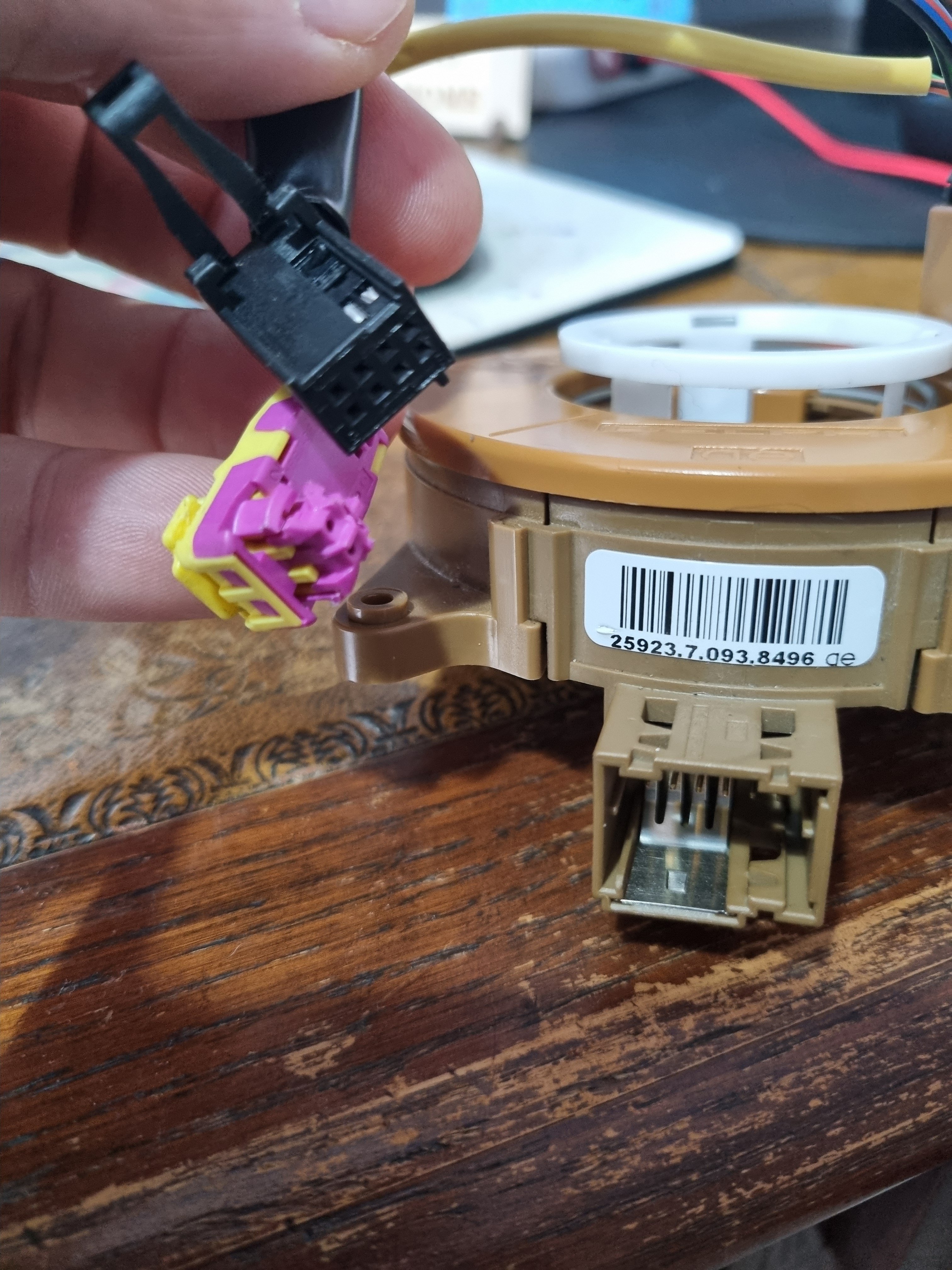

I had bought a new clock spring for my 2017 Doblo cargo, and once I had taken the old one off, I noticed one of the two connectors was different 😳.
The one on my van has a far larger connector, typical scenario, van now useless and I just can find a new clock spring to match the old one.
There is a bar code on the old one with 25923.7.093.8496, but I can't find references to this anywhere.
Any help to find the correct part would be very much appreciated 👏
That code is from part manufacturer, not Fiat code, seems it's Delphi part. You must check Fiat part from workshop or Delphi using VIN. Example 735606795 or 59001158.
Thanks everyone, your help has been very much appreciated, I have made some progress but I am still hitting the same issue. The issue is my black second lead has 8 wires running into it, the replacement is white and only carries 2.
Replacement part numbers are 46776828 and some success with POM59001157
I will keep trying :)
Ring coastal motor homes
Have vin ready
Thanks for all the help, I took a punt and got a 2nd hand unit that was actually for a 500L, fitted perfectly and my airbag light has gone out 😃
