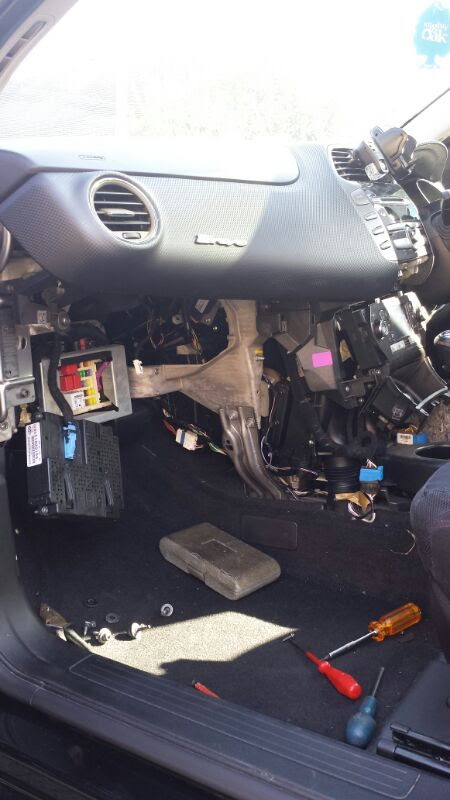

With kidney stone's guidance i'm doing mine as we speak. I'm at the stage where i have just stripped everything out at the mo.
Here are a couple of photo's of the passenger side stripped down. Its quite easy to get to this stage if you take your time and go carefully
Yes it looks as if we have had the same culprit. The plastic cogs on mine turn freely and if i move them by hand i can get air to the screen. My issue is i am unable to get air hot or cold to any of the positions.
Next step is to take the motor off which is driving and hopefully it's the same part as your.
Your guide has been invaluable thanks for taking the time to list it.
Don't forget that there are three on that side. I would advise you to change them all if it is the same problem as mine, that way you won't have to strip it all down again when the next one breaks, like I had to.
Run the reset procedure when you have finished.
