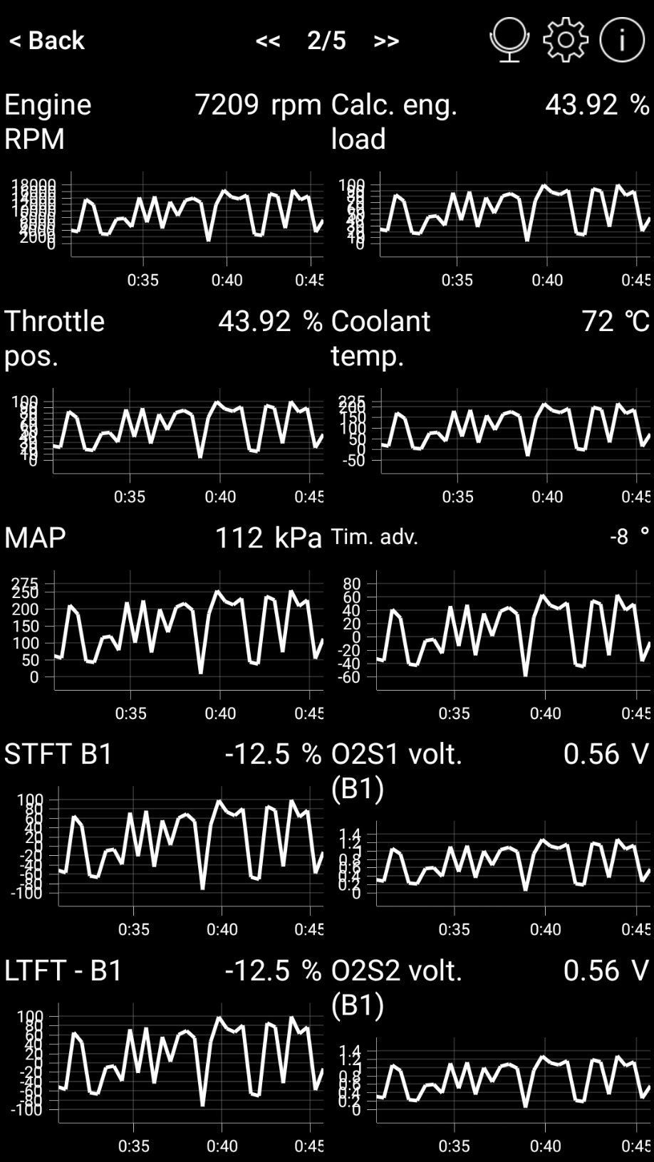

Long story (+2years) short, my punto has a kind of fine hesitation and power loss all the way of rev.
My readings: no error codes, but total Fuel Trim at idle = around - (minus) 110%, which confirm the symptoms.

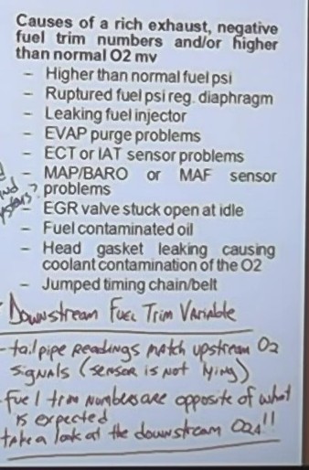

My actions: all the list attached for rich conditions already done (parts changed or tested), except a specialized test for the TDC (top dead center of timing). Which I intend to do next week.
Others: cleaned or replaced all the earth points, tested another virginised ECU. And....nothing.
So, I'm interested for any causes for extremely rich conditions, without error codes.

I tried Ralf S analog test at 1800rpm while driving and see what happened. She jerks at 1800rpm and if you keep her there she keeps on jerking. Always a jerk around 1800rpm. He said thats where the lambda heater turns off approx and with a jerk around that rpm indicates o2 sensor is lazy to switching between voltages
I don't have a code for upstream sensor ie the sensor that has the most to do with performance. However a lazy or bias sensor won't always show up as a fault and trick ecu that everything is fine.
I also hit -100% at idle and when pasking the car inside(start and idle her into her parking)I always pick up a strong fuel smell hence -100% fuel trim.

1. TPS shows about 5% at idle. Not sure if normal, I was pretty sure it should be 0%.
How can affect the fuel trim? TPS is indirect part of the entry data for the predefined fueling map. The other is RPM.
More about: http://www.formula1-dictionary.net/map_fuel.html
My suggestion :
a) a good cleaning to throttle body with carburator cleaner. Be generous. Then need to re-learn the TB to ECU.
b) testing it with the multimeter. 30 min on youtube and you'll be able.
2. Hope that 'white staff' is not a sign of contamination of the oil with the coolant or vice-verse. It's mandatory to check, since that means a head gasket to change, with all the menu...
3. Identify and Check the ECU earth, both ends of the cable; for my punto it was very tricky.
Short solution: make a direct serious cable to the battery negative from one bolt of your ECU.
4. We have a confirmation: the smell in indoor parking confirmed a rich condition. Chances are the O2S1 to be good. Do not change it without testing. You need again a multimeter and about 30 min dedicated on youtube.
5. We can make a speculation: Because a reach condition enough time could contaminate the O2 sensor AND clogging the CAT, maybe this is the reason the last owner made a decat + tried to give more air to the engine with a sport filter.
(My cat was melted in the middle of the ceramic, been there also...)
6. Since we talk about sensors, it will be useful to list any single electric malfunction in the car. Then check if any fuse for that function is placed in the fuse box from engine bay, which is usually dedicated to injection. Tips: AC, interior fan, anything...

I'm going through each step. Next is to get a multimeter and backprobe my o2 sensor to see what happens to her voltages. Ie a test seperate from the obd.
I'll remove air pipe to allow more oxygen and see what happens to o2 sensor and how quik she reacts. They say it should be almost instantly.
