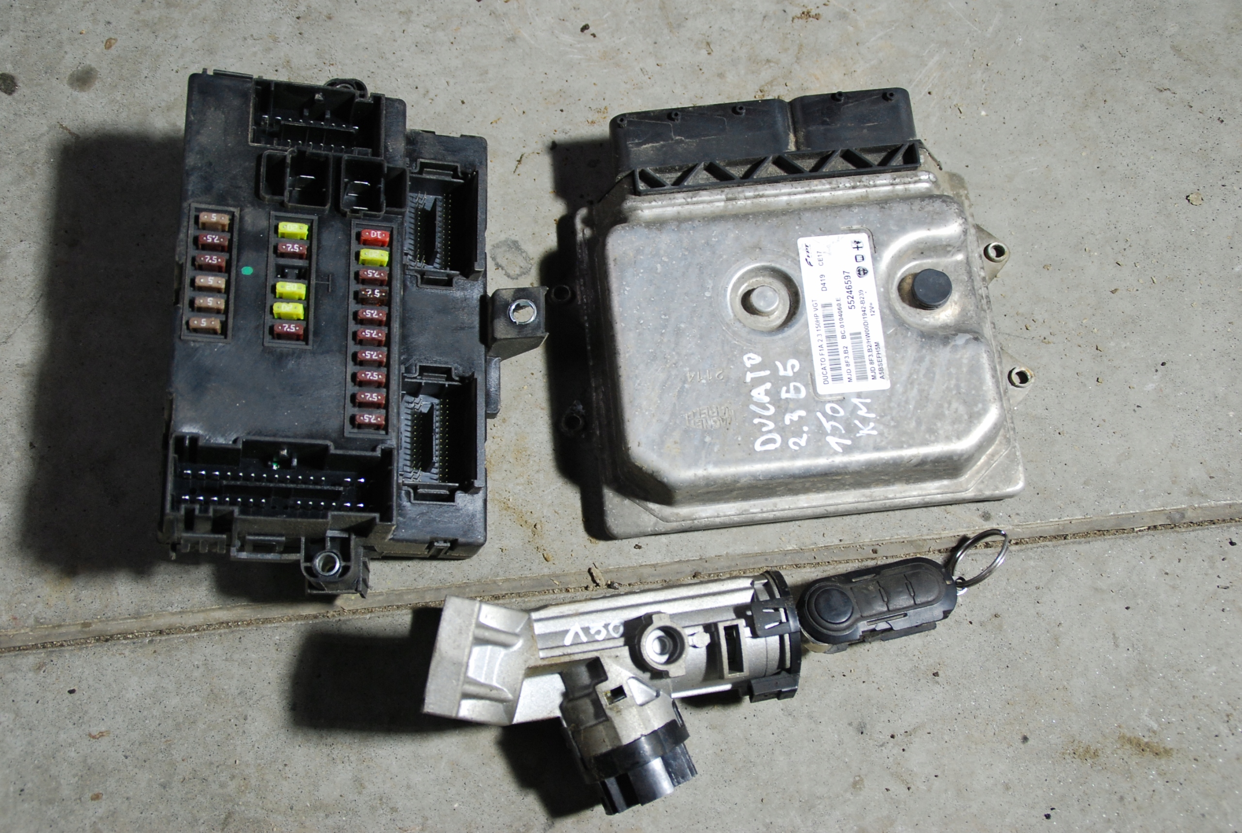

Hello everyone,
My name is Netanel and I'm from Israel.
I bought Fiat Ducato (X250 chassis) and build a motorhome on that chassis. Everything went fine, until one day I wanted to install second inverter for my 12v car battery (I also have leisure 24v 250amp battery). I connected it by mistake to a red wire on the fuse box and everything shut down. By saying everything I mean every electric instrument. No electric windows, no lights, no parking light and signals, no mirror adjustment.
I thought its the BCM so I bought the all starter kit (BCM, ECU, Starter, and the donor keys) Last night I try to connect it, and the good news is that I have some kind of lights. The Headlights are working constantly even if the light switch is off - I also hear a "ticking sound" from the red wires that goes into the fuse box. If I disconnect the red plug (2 red wires with a plug) there is no more "ticking sound".
I'm pretty much hopeless and hoped that I will get some help or direction what to look for? (maybe there is a shortage on the red wire plug?)
Any help will be much appreciated!!

Thank you bugsymike!
I didn't mention it, but I built the van a year ago and the 24v inverter and the 24v batteries works fine (I didn't connect anything to the car and the 24v is separated). A couple of weeks ago I bought a 220v Inverter to 12v Battery - at first I connect it directly to the 12v car battery - and by mistake (as I want the 12v inverter to turn on when I switch on the car so I will get charging from the alternator) I connect it to the red big wire in the fuse box (see blue cirrecle on the picture attached - where these 2 big red wires going to? maybe I should track them to find any shortage). As I said I replace the BCM, ECU and starter so I don't think I need to do cloning or at least not now - as still all my car instrument won't working yet.

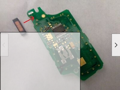

I did a test (as I am the only one of our four to have a working x250): with the immo aerial in place, I put the working key in the starter. I turned it into the 'engaged' position. The immo light was off, it turned on after +/- a second for +/- 2 seconds and then turned off. Then I turned the key to 'starter' position and started the engine. The key returned to 'engaged' position.
Then I took off the immo aerial from its place, took it away as far as I could to the left, and the immo light appeared after the same +/- one second but never turned off. The engine didn't wanted to start, which is obvious.
@nlousky I understand that you changed the ECU and BCM because you thought they were burnt when you connected the inverter to the fuse box in the dashboard. Do they have burn signs? If not, I'd really try to put back the ones you had on your van originally, as you know how the engine reacted and was working and try to start the engine (of course with the original key, including the electronics). I also assume that you haven't seen the ones you bought on a working van before the purchase. I know from the Polish forum that the ECUs/BCMs vary, and it can be very problematic to find a set that will work with the engine (it depends not only on the displacement, model year, EURO norm but also engine type). Also, check all the terminals you disconnected and connected to be sure there's good contact everywhere.

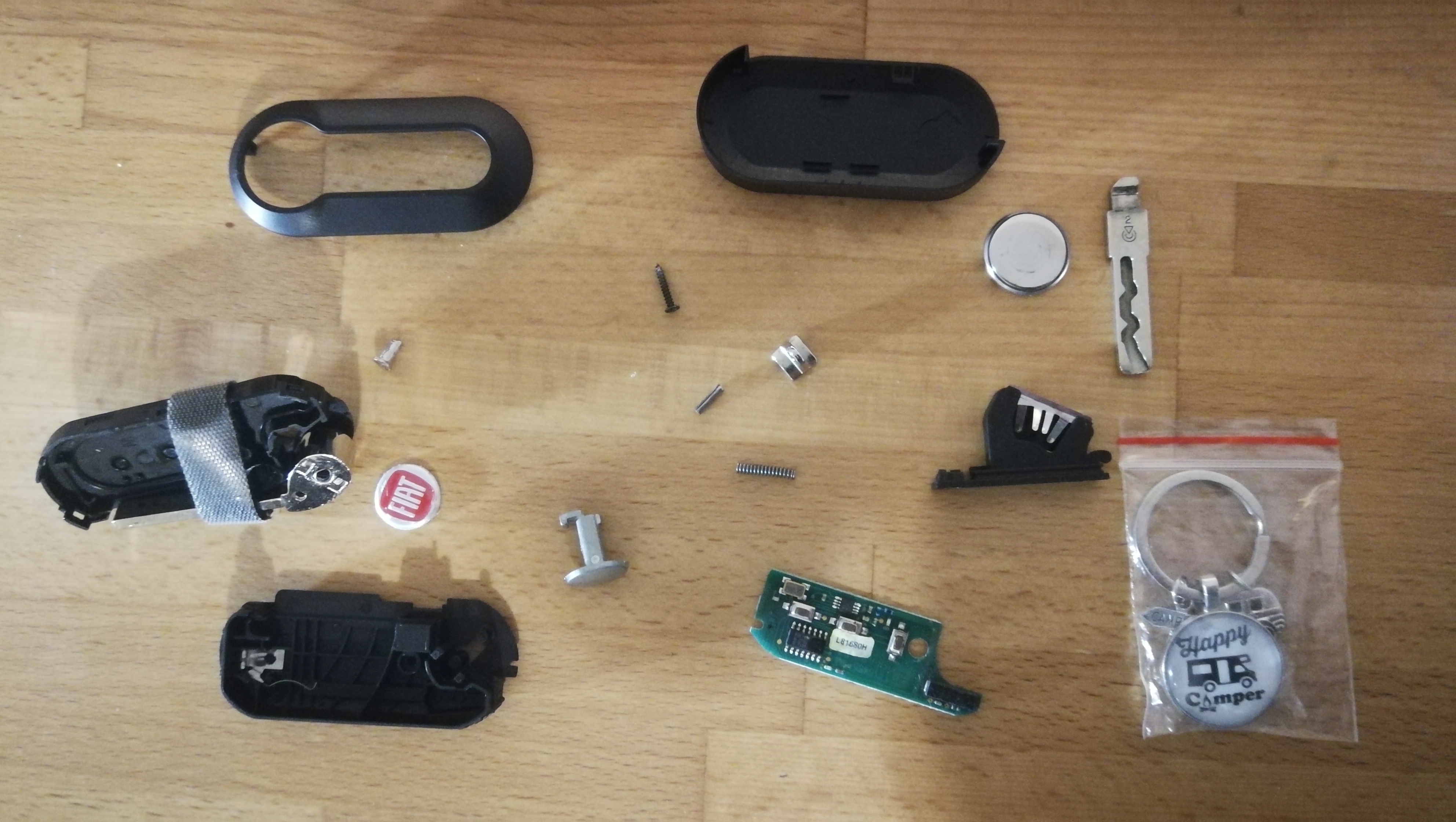

To confirm there's no extra chip in my key I dismantled it again. As you can see on the second photo, there is a place that something could be put in. But just above it, on the PCB board there's this chip soldered to the board. So I assume it's one or the other.
I think that nlousky should confirm how the interior of his keyfob looks like. Is it the same as this on my photos, or different? Perhaps Sevel was putting different types depending on the EURO norm and engine type, model year etc...
When I was buying the extra electronics I had no special problems - I only chose the model year. Another thing - the keyfob body is probably a chinese copy. The one I got the van with was also a copy, I have no idea if there was this special place on the original one. On the second photo, from left to right: the keyfob body I'm using, the electronic PCB board I'm using now, the new one, also genuine Magneti Marelli I bought to program to have a spare.

I won't argue with the fact that the ring is an aerial only. But if the aerial is connected to the BCM, there's no need to change on the steering column. Plus of course the BCM on the van side. The new key electronics in the old keyfob should work with the new BCM and ECU. Under the condition that those were working before.
But I won't agree that there's an extra chip in the keyfob. There's nothing more in it. At least in mine. I've changed the plastic keyfob body (or how do you call it in English) because the one I got with the car was totally broken and it worked with no problem after the replacement (you have all the pieces on the photo below) including the new and the old keyfob bodies.
Yellow question -
in my car (right now) the IMMO light won't turn off. I did not replace the black ring as you both suggested is antenna for the IMMO. I did change, as I said, the ECU, BCM, and the chip from the donor key to my old key.
Blue question - No I change both of them because I know that replacing only the BCM is not enough and you need to reprogram it all the data you have in the ECU include the pin code. So I bought the "complete set" In order to avoid that and play safe. I can't return the old BCM and ECU because my BCM is 100% won't working. The old ECU is fine but I don't see how he can help me here.
Red question - Yes it's look exactly like that.
