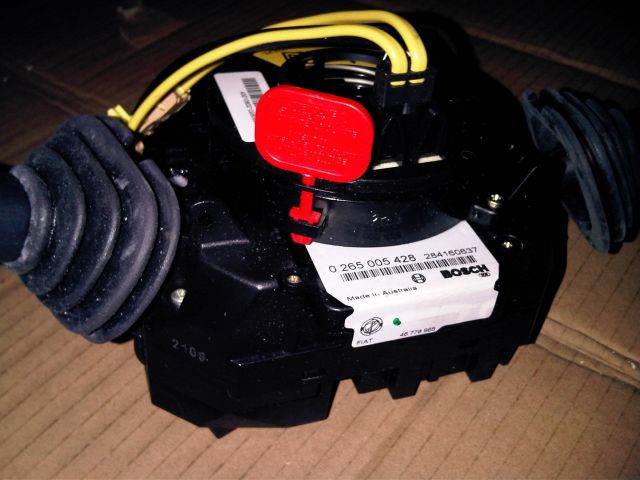

No.. the clockspring is not affected by the airbag going off.
The important thing with a clockspring is that the two halves of it have not turned in relation to each other. When supplied new, the two halves are locked together with a red, break-off locking tab.
If you take a clockspring from a damaged car, turn the steering wheel to the straight ahead position before removing the steering wheel, then don't allow the two halves of the clockspring to turn while removing, or fitting it to your car.

If the clockspring has already been turned, (or you suspect it has been) you will need to centralise the two halves.
Without the locking clip fitted, you will find that the top half can be turned about 90º each way before it stops, but if you hold the central black ring (1st picture) down, it can be turned further.
While holding the black ring down, turn the top half of the clockspring to the left until you feel a resistance (don't force it past the resistance). Then count the number of 360º turns it takes to turn it until you feel the resistance in the opposite direction (will probably be about 5 turns).
Turn it back to the left, half the number of turns it took from full left to full right (about 2½). The coiled ribbon cable inside the clockspring will now be centralised, but the top and bottom halves may not be exactly aligned.
To align the two halves, turn the top half the shortest distance (either left or right), until the two square locking clip holes (2nd picture) are aligned with each other, then put a cable tie through the two square holes to stop them turning.
Remember to cut the cable tie off once the clockspring has been fitted.
