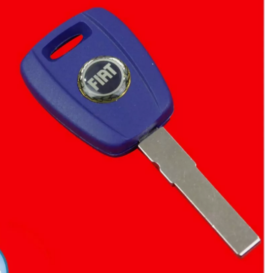

You will probably need the PIN code, might be on a sticker on the original key

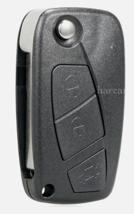

Now you can add new fobs:
1, enter the PIN number as above:
2, Turn the ignition back on and press button 1 on the new fob - this links it to your alarm;
3, Turn the ignition off and leave it off for at least 25 seconds so that it exits PIN mode.
