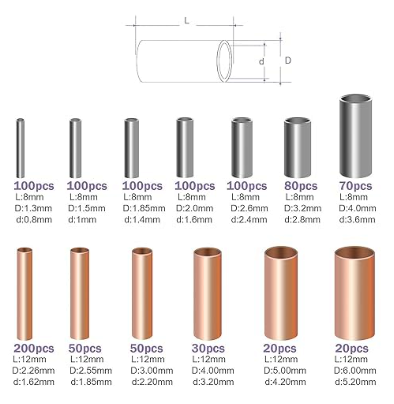

2. Use a connecting tube connector:
First one from amazon. You can use standard pliers to crush the tube with both wires inside.

For all of the above solutions at the end secure the connection with insulating tape (you can eventually use heatshrink tube, will do the same). However the method with the insulating tape will be easiest to remove by the electrician.
