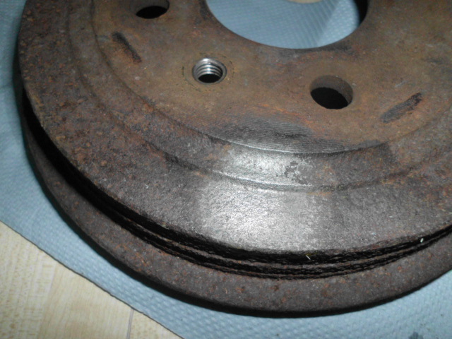

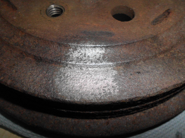

For the record this is how I remove rust and so I have set up a little demonstration using the old brake disc from the Fiat Tipo I am re building.
1 . Get a bottle of Bilt Hamber Deox Gel rust disolver, its very thick so can be used on vertical surfaces.
2. Paint some on nice and thick as you see on the brake drum and leave it 4 0r 5 hours, then scrub it off using a stiff brush or wire brush is much better with water, after drying put some more on and leave another 4-5 hours, after every wash you will see more clean bare metal appearing, finally inspect with a jeweler eye glass and make sure all the pits in the metal are rust free, paint immediately with zinc galvanizing under coat , then top coat, .
3. Job done, this is a very slow process but it turns the rusty metal back into clean bare metal, if you want to make a perfect job this is the way to do it.I also use this rust dissolver on rusted up nuts and bolts because as metal rusts it expands so rather than shear a nut off trying to un do it get all the rust off first and then it will undo easy.
