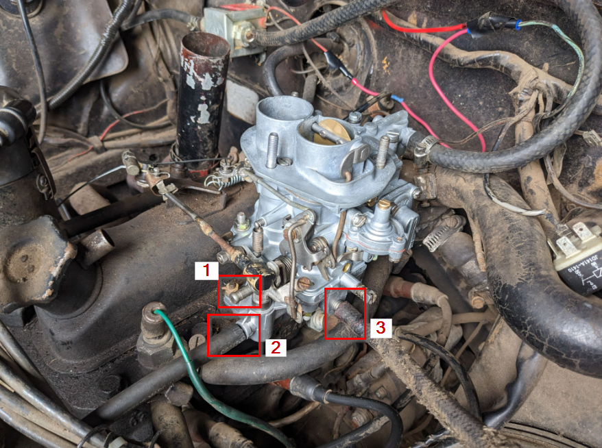

Next to the carb - the small carb filter was full of rust.
Annoyingly, I dropped this into the engine bay, never to be seen again
Luckily I have an old carb for spare parts and I have one in that... I doubt you can buy them anymore.
I'm going to fit an extra in-line filter just ahead of the carb to help catch the left over muck before it gets to the carb. However, before I fire her up again I need to check the float chamber for muck and clear the jets.
