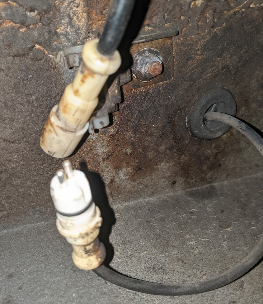

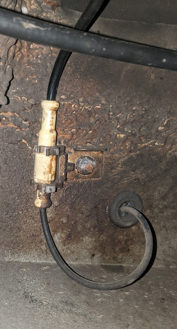

You can disconnect them from underneath. Below is a picture taken after I'd disconnected them when I dropped my rear axle last winter:

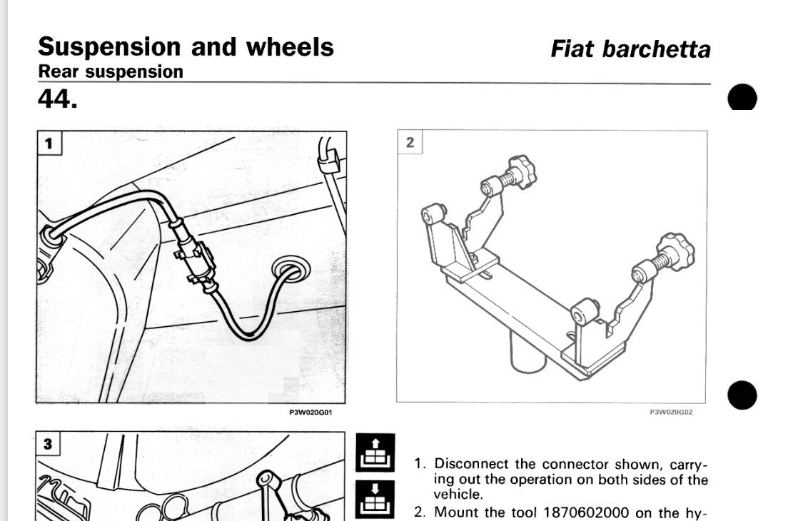

It's also covered in the service manual:

So here's my ABS connector just before the cable goes through the wall, photographed from underneath the car just forward of the rear wheel:

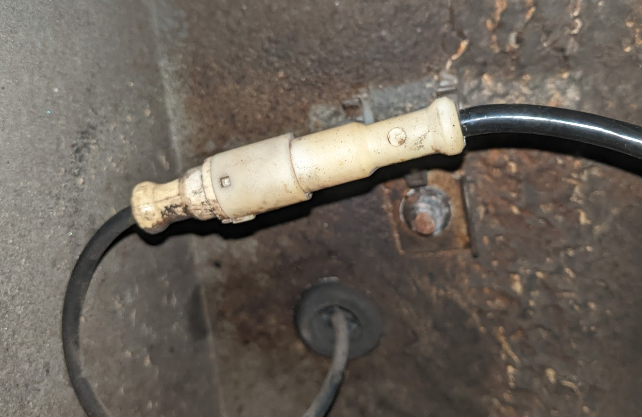

Unclipped:
and disconnected:
Are these parts not present on your vehicles at all? If you got replacement ABS sensors did they come without a connector on the end that looks like the one in the photo?
I'm wondering if this is a difference due to changes in the system over time. My car is a late 1998 model so I'd be interested in when your cars are from.

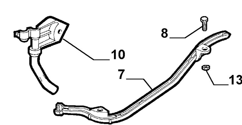

Looks like this. Number 7
OK and on that same diagram I have part 9 - clip which was discontinued in May 1999. This clip is the one in the pictures above that holds the connector in place on the car. So, I guess on your car the ABS cable just goes straight from the trailing arm through the hole and into the car.

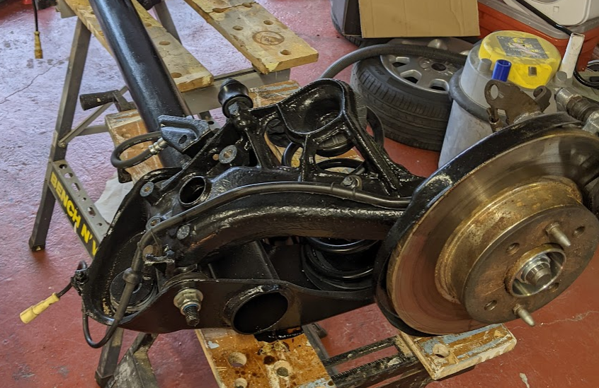

This is what my trailing arm looks like before going back in the car,
