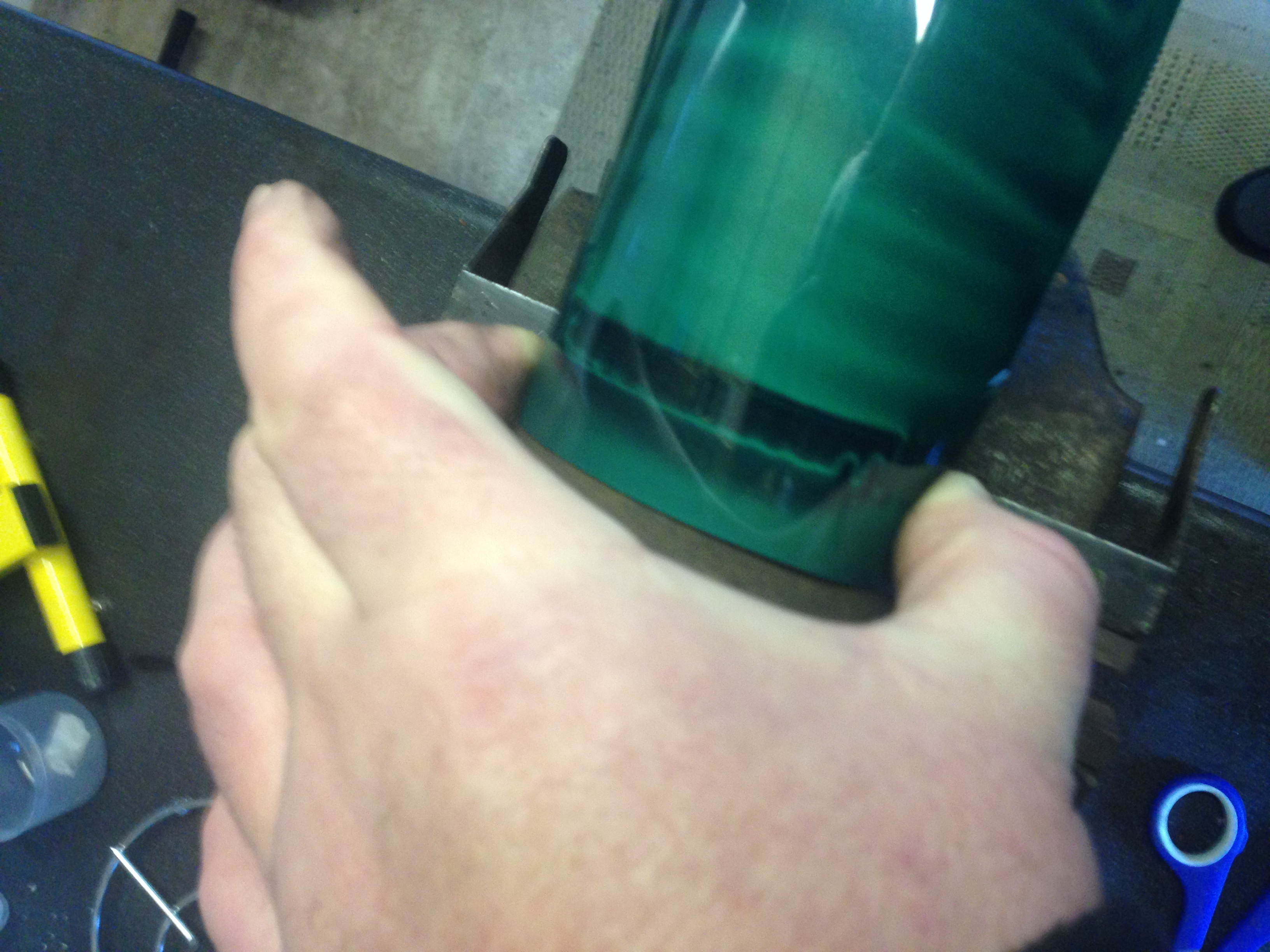

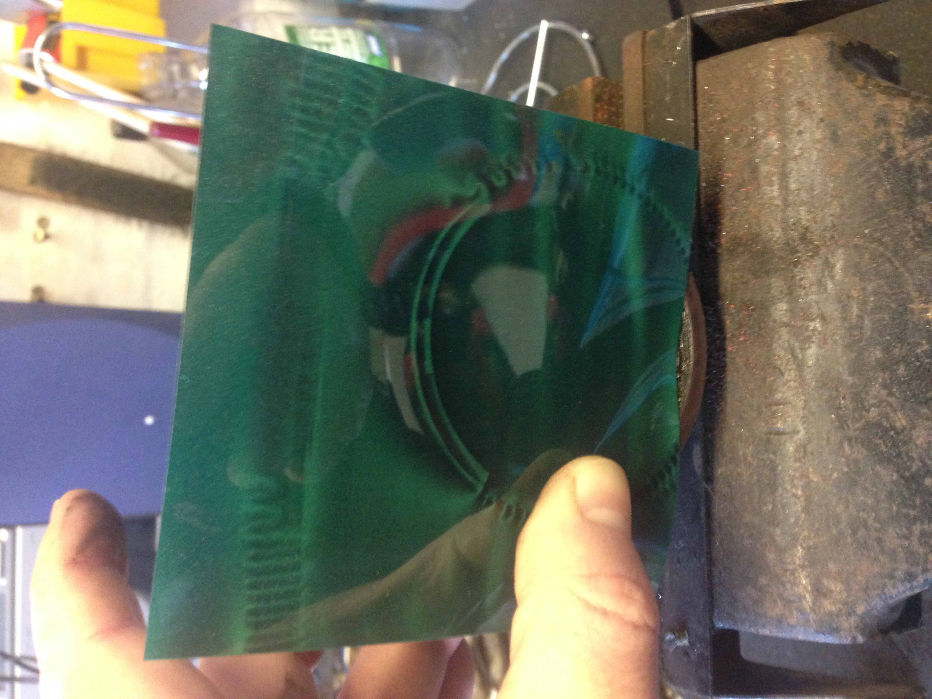

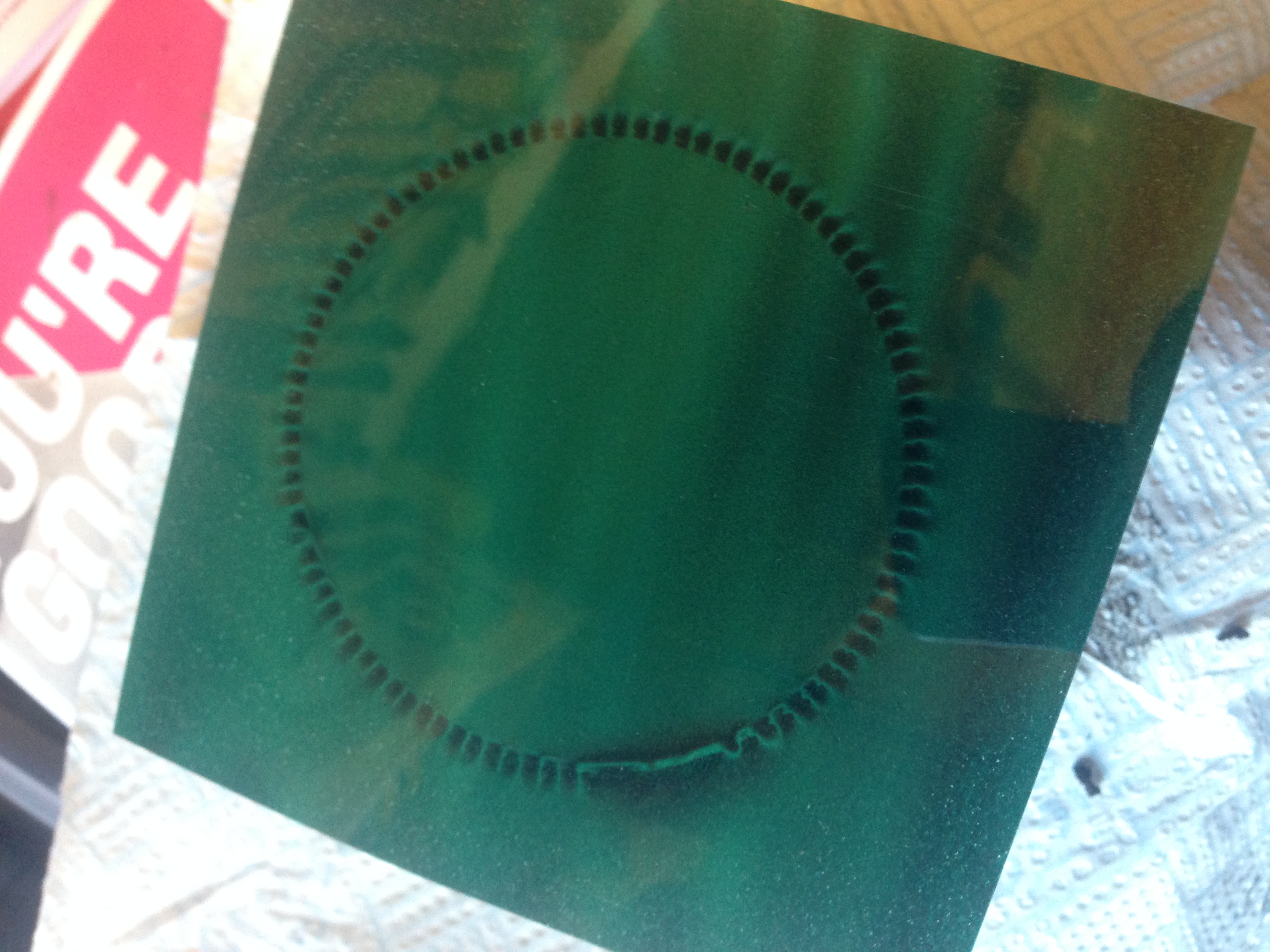

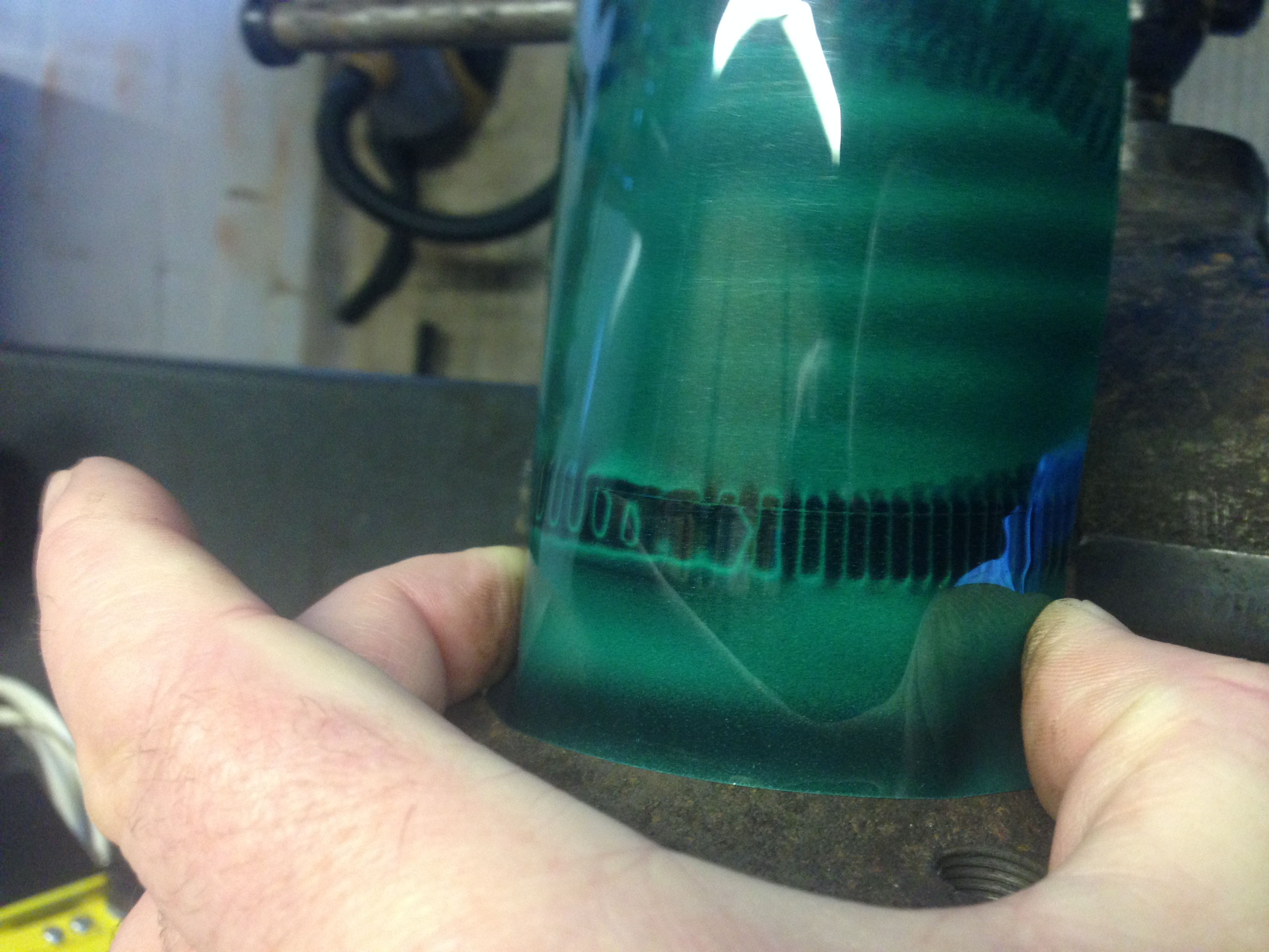

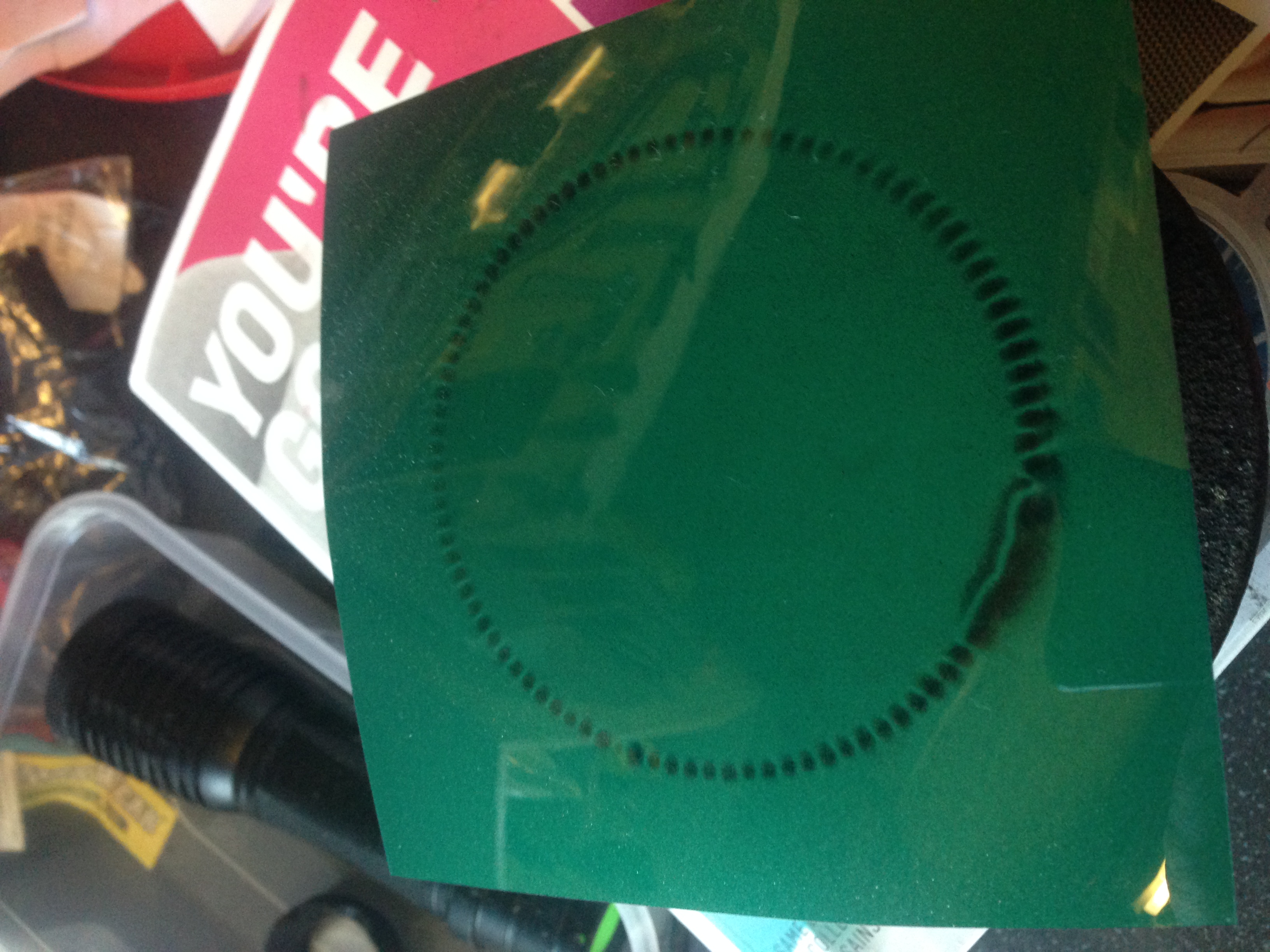

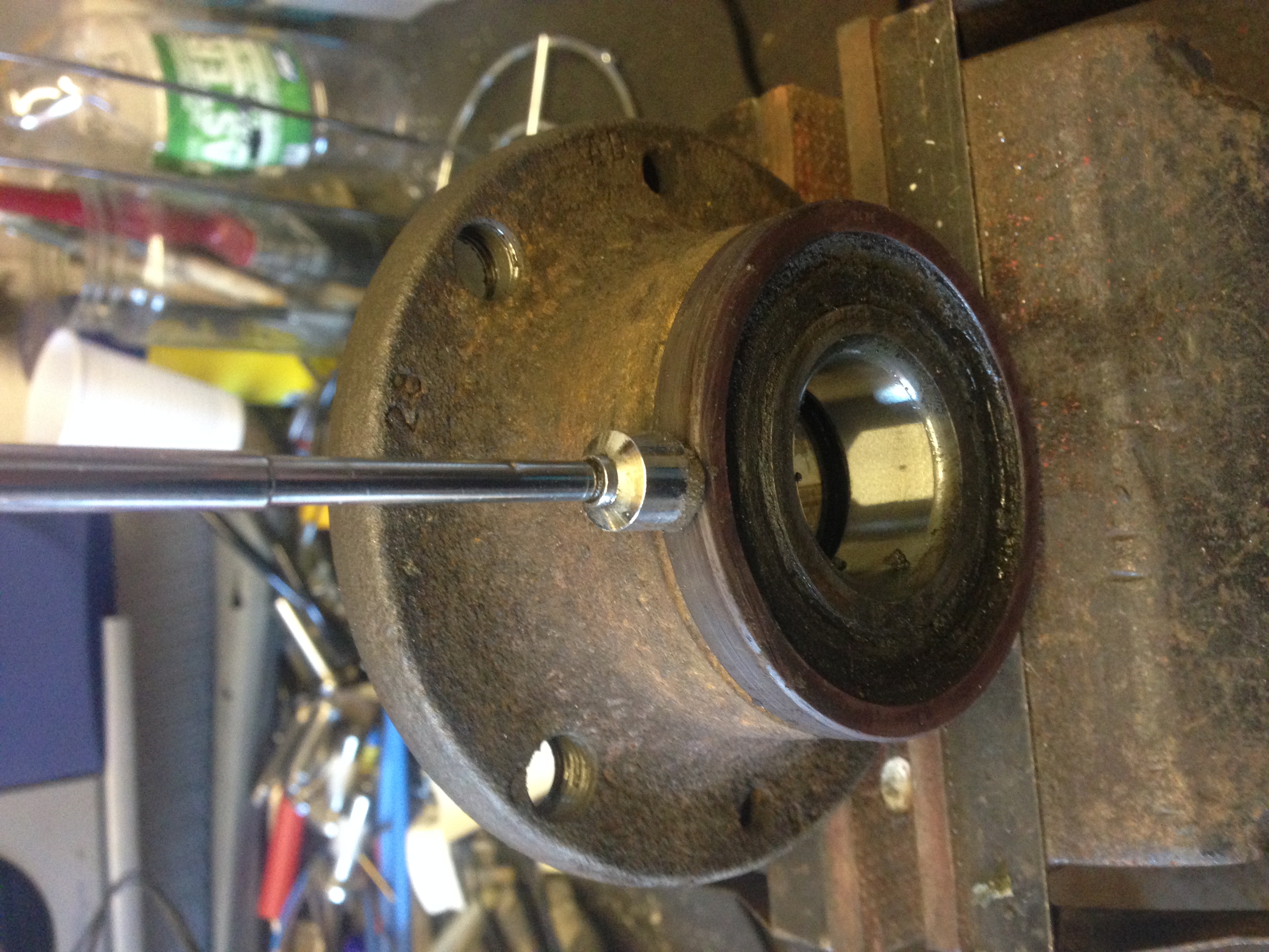

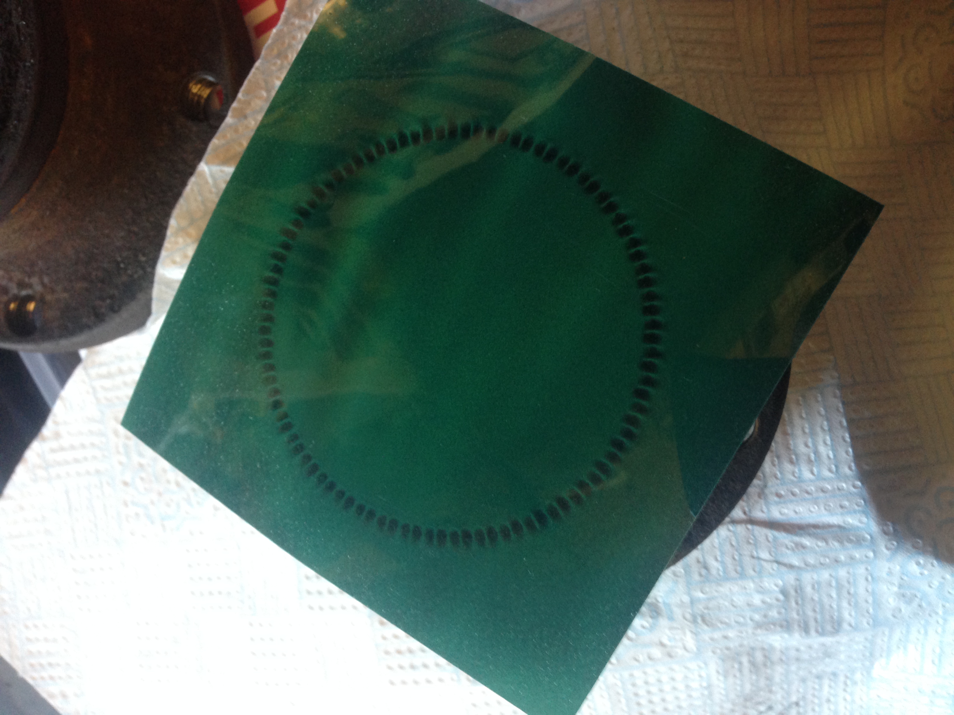

i stupidly broke my old rule of if it aint broke dont fix it , but there looked to be a build up of crud on the wheel speed sensor ring so gave it a gentle scrape with screwdriver to clean crap off(no scratching).
all rebuilt and on test drive abs failure popped up , luckily have fes and green plug so cleared fault and for referance my stilo jtd 16v 150hp is bosch abs 8.
read code as rear right wheel speed ok stripped again and this time with a brush and a spray bettle cleared all round the ring and the sensor, good enough to see it looks like greyish magnetic ring.
rebuilt and tested again and abs popped up again but now nothing showing in fes but only tested on drive for sensors working.
all wheel speeds are reading and look close enough to me see a very small drop in right rear hoping a few days of driving will settle and clear.
there appears to be no relearn for these sensors ?
