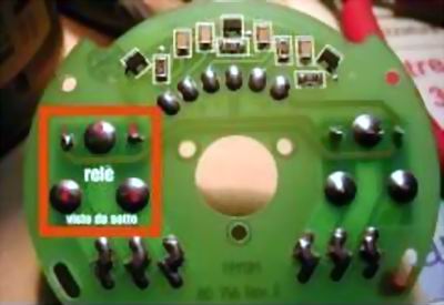

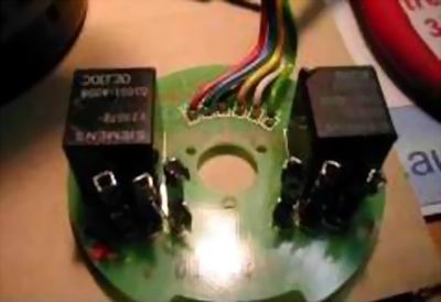

Can someone confirm or deny with 100% surenes that this c* isnt the whole problem? You need to redo the contacts with high temperature stick stuff, dunno the word in english... :D

i couldnt make out the pic but if the connections are "broken" solder it and see if youv cracked it and you will be a super star :p
you will be to late to save me 100 quid for a steering columb but a super star all the same :D
one thing though a pcb is normaly like a sandwich with different circuits if there broken were gubbed:(
Acctually, I found this pic on another forum, so just wanted to ask...
Seems "plausable" :D but maybe it's just an urban myth :D
The ones on the pic seem OK, like they dont need soldering...
It was on a local forum in Serbia, so I think you wont understand anything :D
