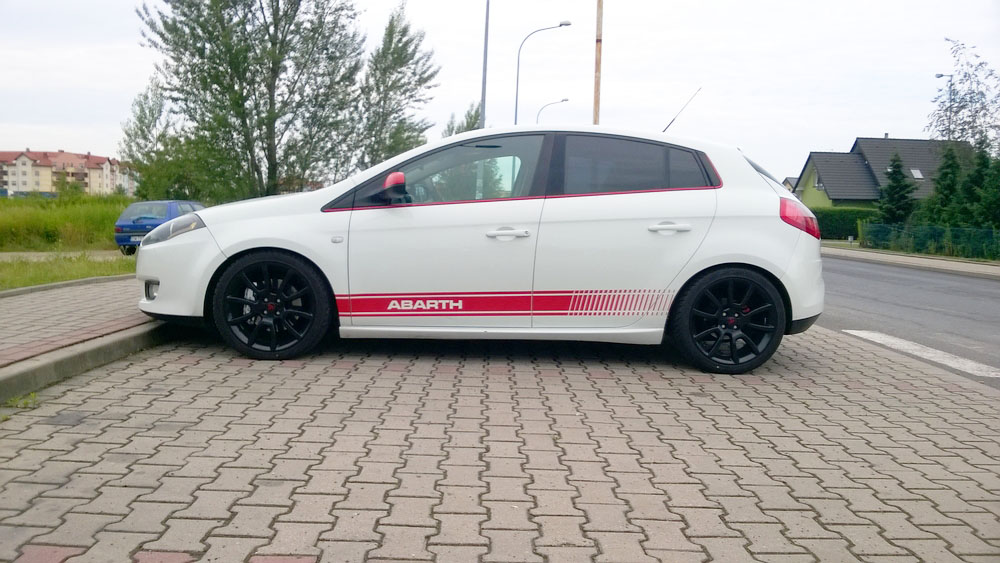

Bravo  Abarth
Hi I'm Polish and I would like to present your car
Engine: 1,4 T-Jet 120 Dynamic NAV + sport package 2009r.

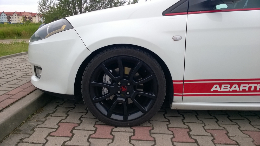

Painting the brake calipers in red
establishment of daytime running lights
window tinting
Establishment of parking sensors

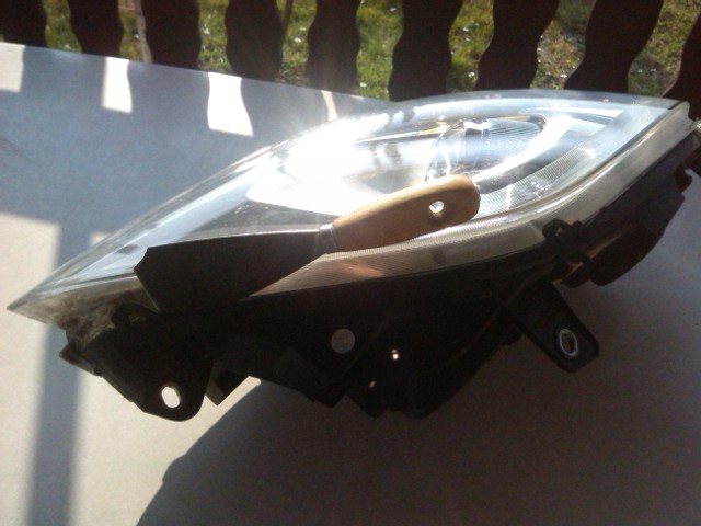

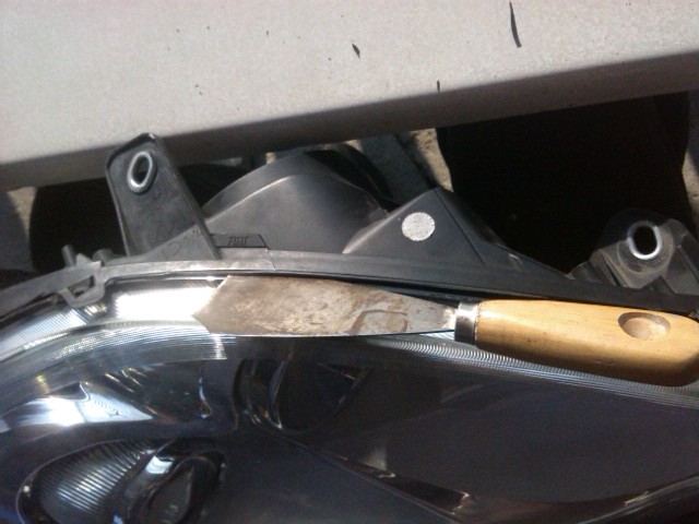

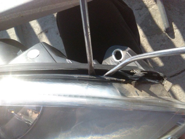

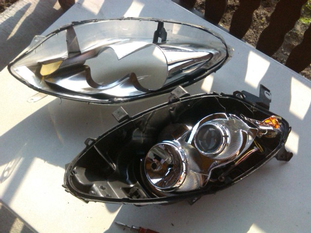

This is how i did it, i seems to be very effective procedure:
First i passed all edges with spatula, and then started to separate plexy from this side:

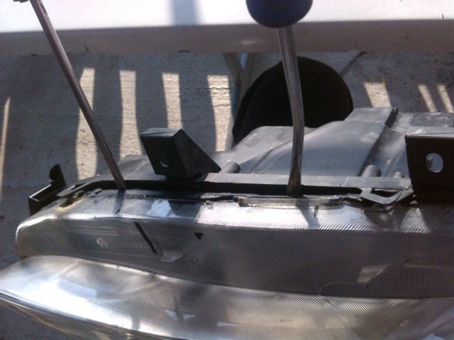

Carefully separate inch by inch using two flat screwdrivers, wider is better

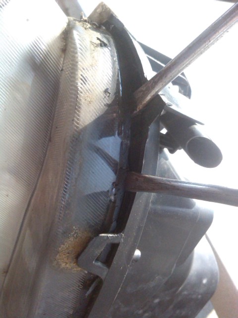

And after 20 min, voila:
Important is that you dont use force, it goes slowly, as you slowly move inch by inch, silicone release, otherwise you will break plastic edge of plexy and headlight housing

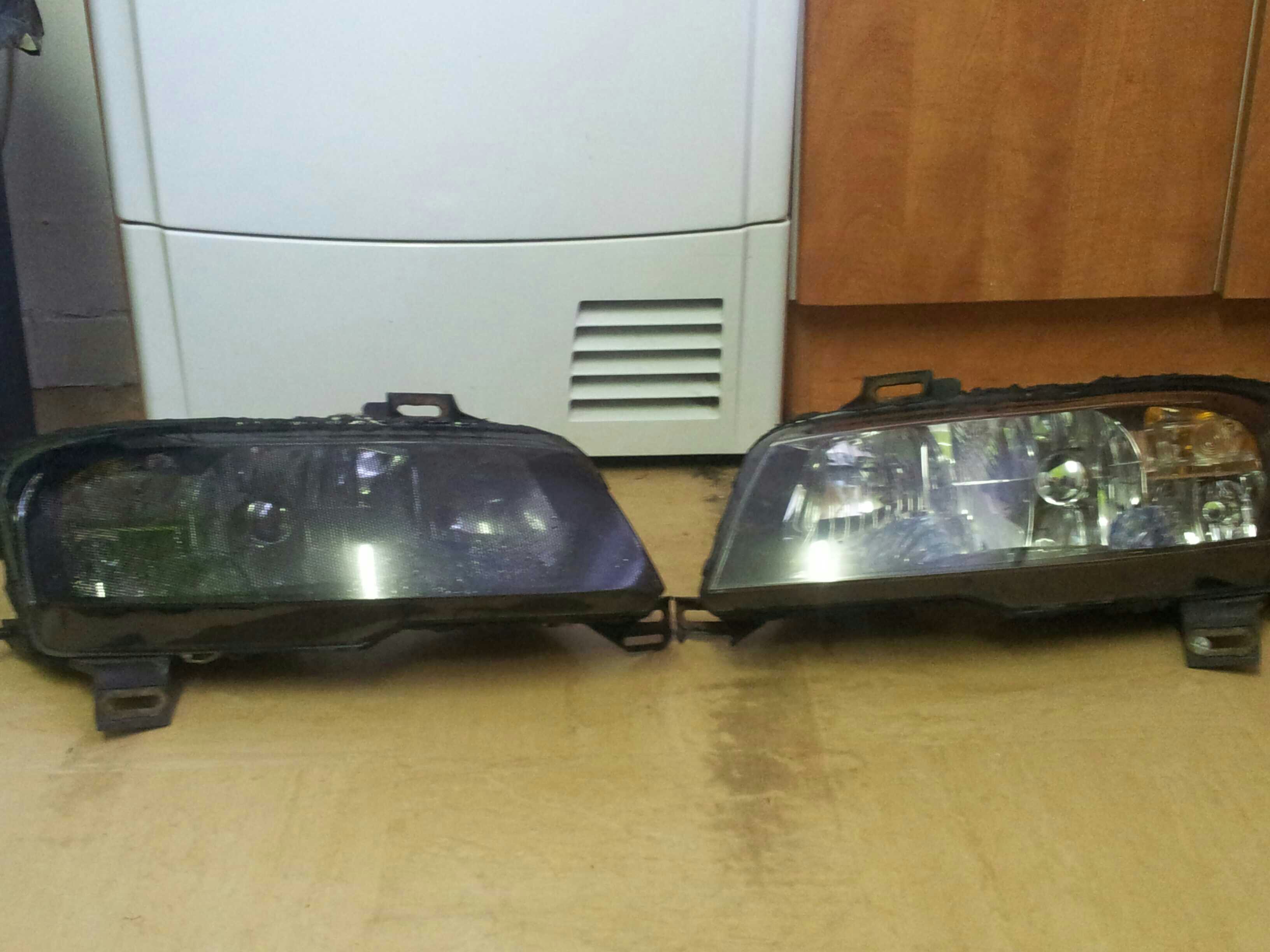

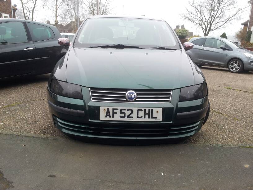

StevieKop heres a pic of my stilo fly eyed and depo and the bottom pic is them side be side to compare the difference

Mines black mate looks dark but ive had no problems with my standard halogen bulbs but a hid kit will be alot better if your not happy with the beam you get
Sweet. I have a set of xenon gas bulbs ready to go in the car. Hoping they will look a lot better than standard halogen but not sure.
Great instructions man! im thinking of painting my bravo headlights as well. What did u use to paint them? just a regular black spray?
When i did my stilo i used black gloss standard spray paint from poundland :lol:
Yeah plastidip would be great for this since its not exposed to the outside.
