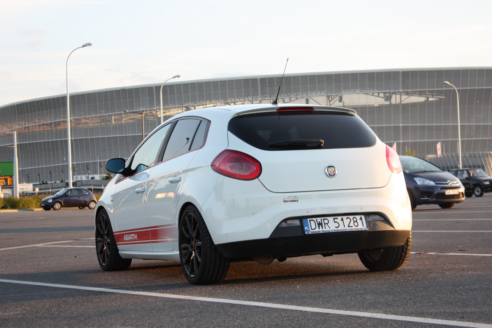

Bravo  Abarth

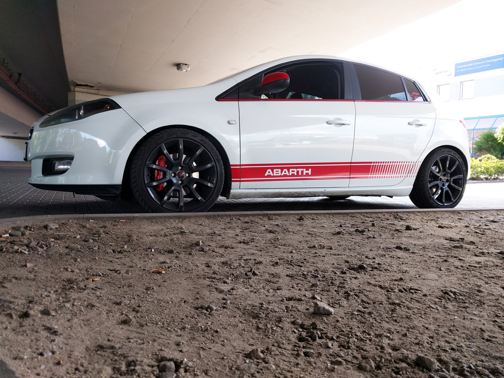

Hi I'm Polish and I would like to present your car
Engine: 1,4 T-Jet 120 Dynamic NAV + sport package 2009r.

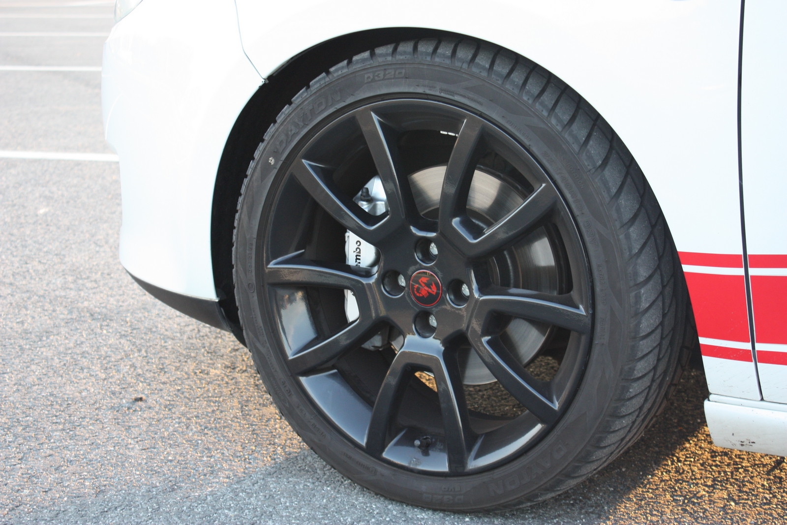

Painting the brake calipers in red
establishment of daytime running lights
window tinting
Establishment of parking sensors
The difference in braking is a huge series that was honest too weak for the engine power when braking from high speed factory brakes do not give advice, now the car brakes really hard and you have to be careful that no one at the rear drove in the ass because the braking is very sharp how hard the pedal is pressed. I bought a set dedicated to the Fiat Bravo with adapters everything fits Plug & Play
rafsteve- but you can earn some extra money corresponding terminal adapters to fit bravo know that the same brakes are the Alfa Mito QB fit P & P
Fergie- Yes I know that red would be insane but it just was not that color are red, silver and yellow, the price you have to give a set or 2 terminals complete, 2 discs and brake pads set of 4 is about 2500 zł or about 440 pounds all new from the factory
For a big brakes upgrade just total some mito 155/170 and steal the brakes.
Direct swap.
From QV you will get a red calipers as a bonus.:devil:

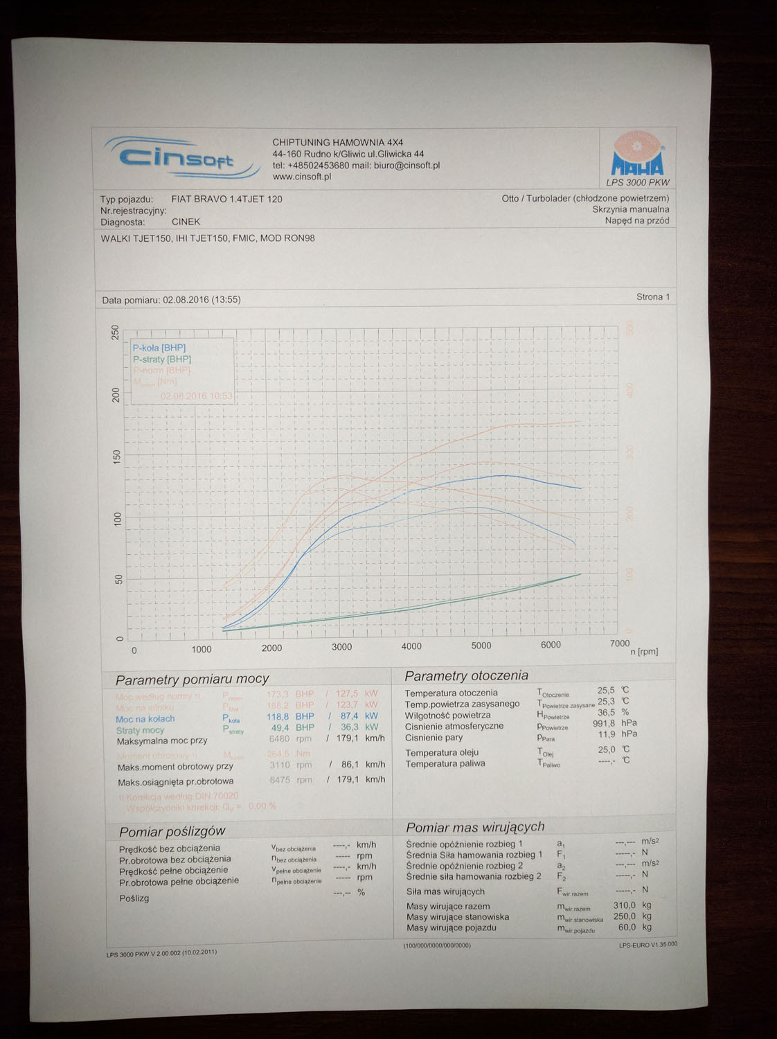

Last engine has undergone minor modification in altering the camshaft and the turbo version of the 150bhp car after alignment achieved a nice result 173PS and 265Nm

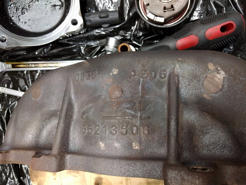

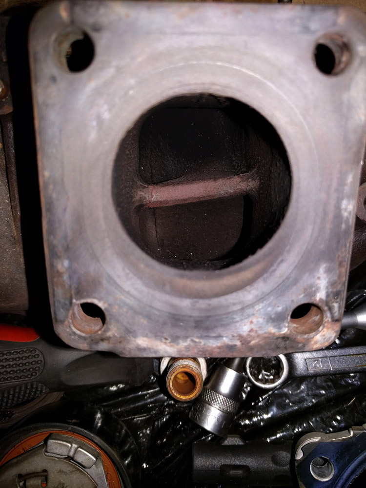

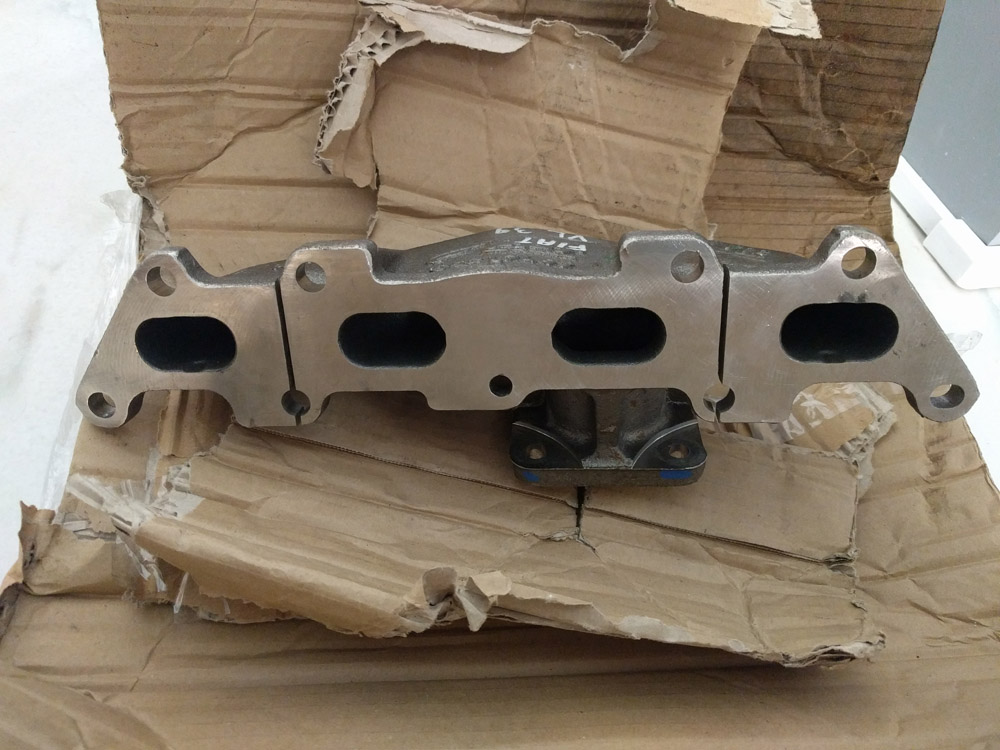

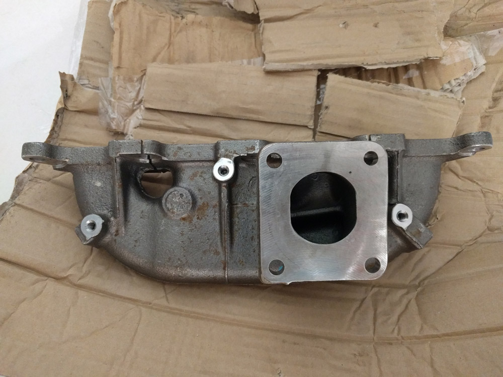

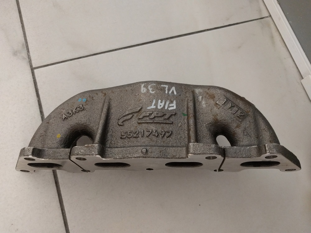

When replacing it turned out that I had cracked manifold
so I bought a new collector

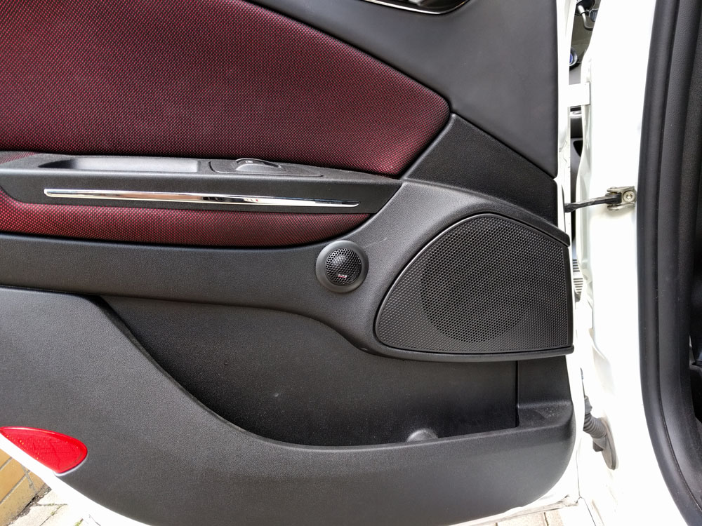

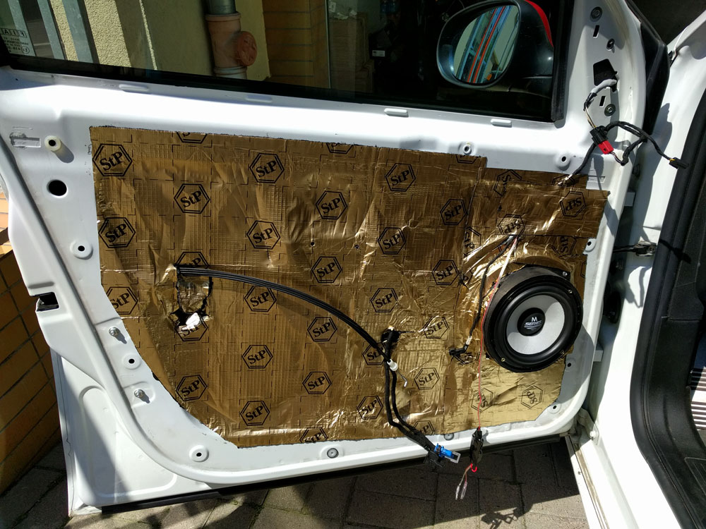

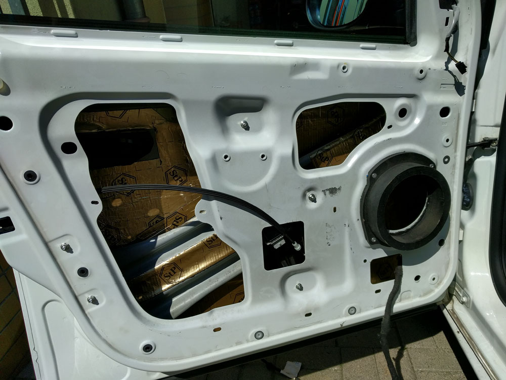

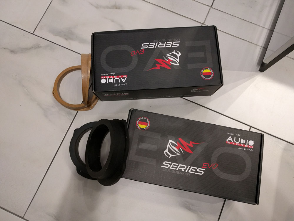

I installed a rear power windows and replaced the speakers with suppressed door

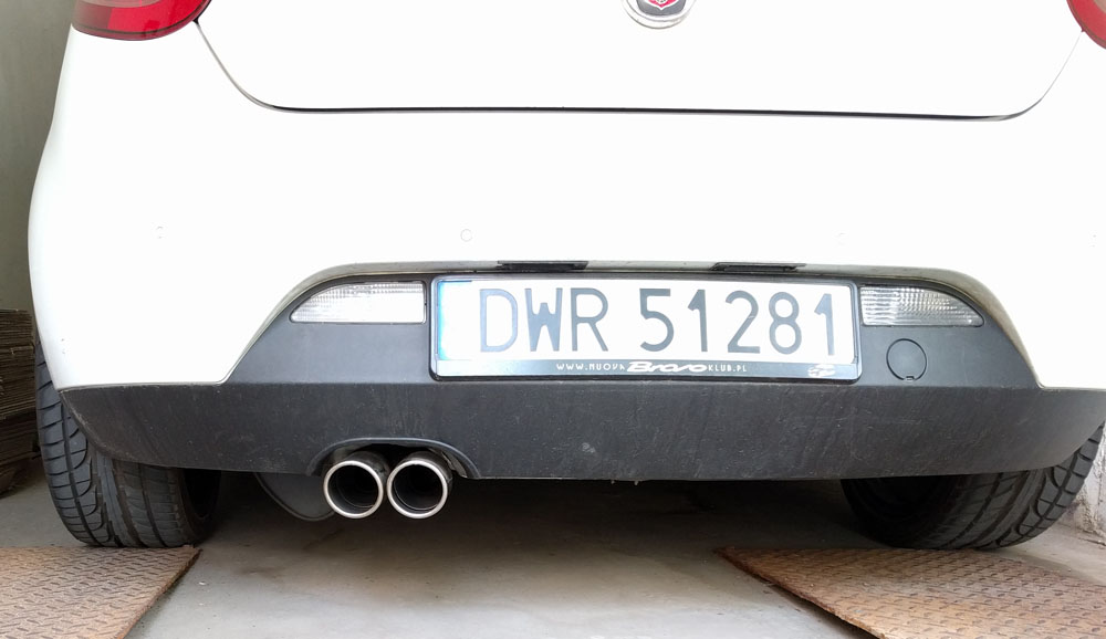

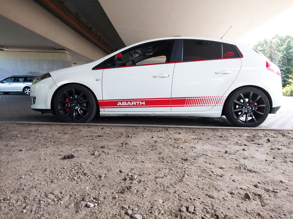

Finally, the car has a sports looking back with Twin-Tube
And the brakes in a matching color
