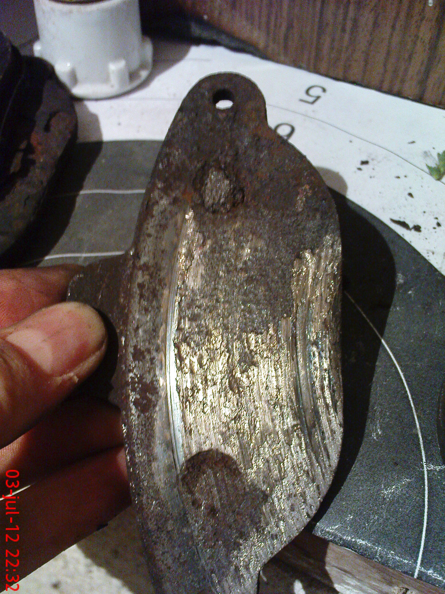

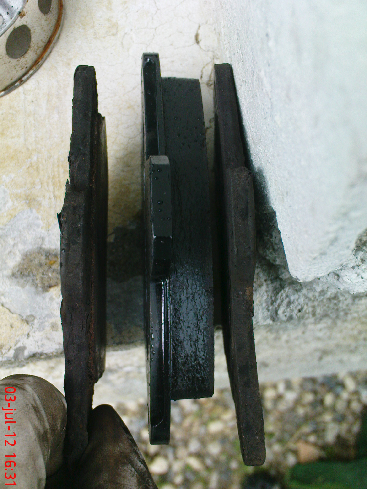

This weekend was reserved for front-brakes.
A first glance, they didnt look that bad (well, old factory calipers always look ****).
But take a look at the brake pads.
The old and the new.
The old clearly below it's technical and legal limit (how could this car get a MOT with brakes like that ?)
Brakes are easy work, when pistons and rubbers are fine.

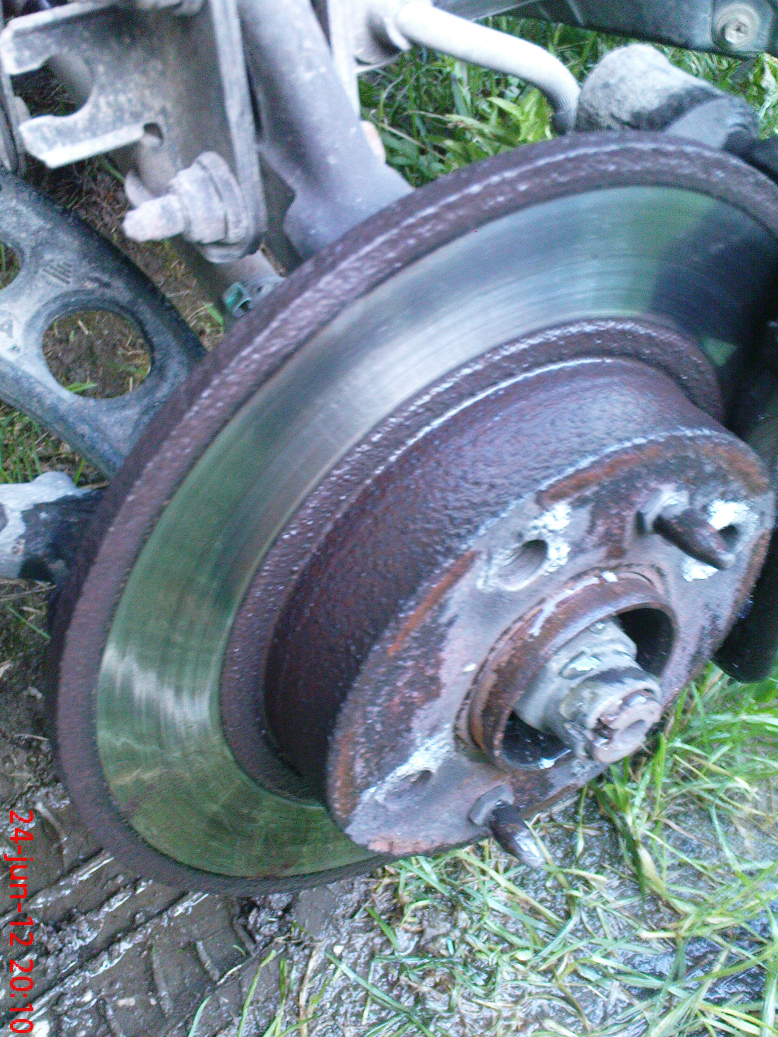

In no time, I had the new disk on and new pads in the calibers.
The old disks were actually quite fine and well above minimum thickness and without wobling.
Disks newer than the pads ?
Personally I would NEVER put on a new disk and keep the old pads.
But one disk can easily live through two pairs af pads...

your pads look good compared to what i had years ago, was making scraping noise when braking cuz all material from pads was gone and ofcourse sticky caliper
attachment.php
attachment.php
Scarypads :)
I'm pretty "anal" with my brakes, so never have them worn to that extent, or with deeply grooved disks.
My experience is, that it also is bad for the brake piston, that likes to stick a little, when pads are that worn.
It means that I do this every second year - 50000km - witch is a bit sooner than most people.
I just like having good and working brakes :)
When I got my old Prelude 2.0i, it had pads close flisko's.
They actually "fell off" when I was braking, and got wedged between the caliper and the disk.
Cant find a picture, but've got one of the nicest looking pads that was on the car.

tbh both of those disks look nasty
I suspect they both are ribbed?
But pictures can decieve, hence why i'd be having a DTI or good feel with the proding finger
ziggy
Yes the old disk's had some grooving, but it could have been maschined and still have enough thikness.
Put on new disk's, since its easy'er and cheap, and I like all new brake components :)

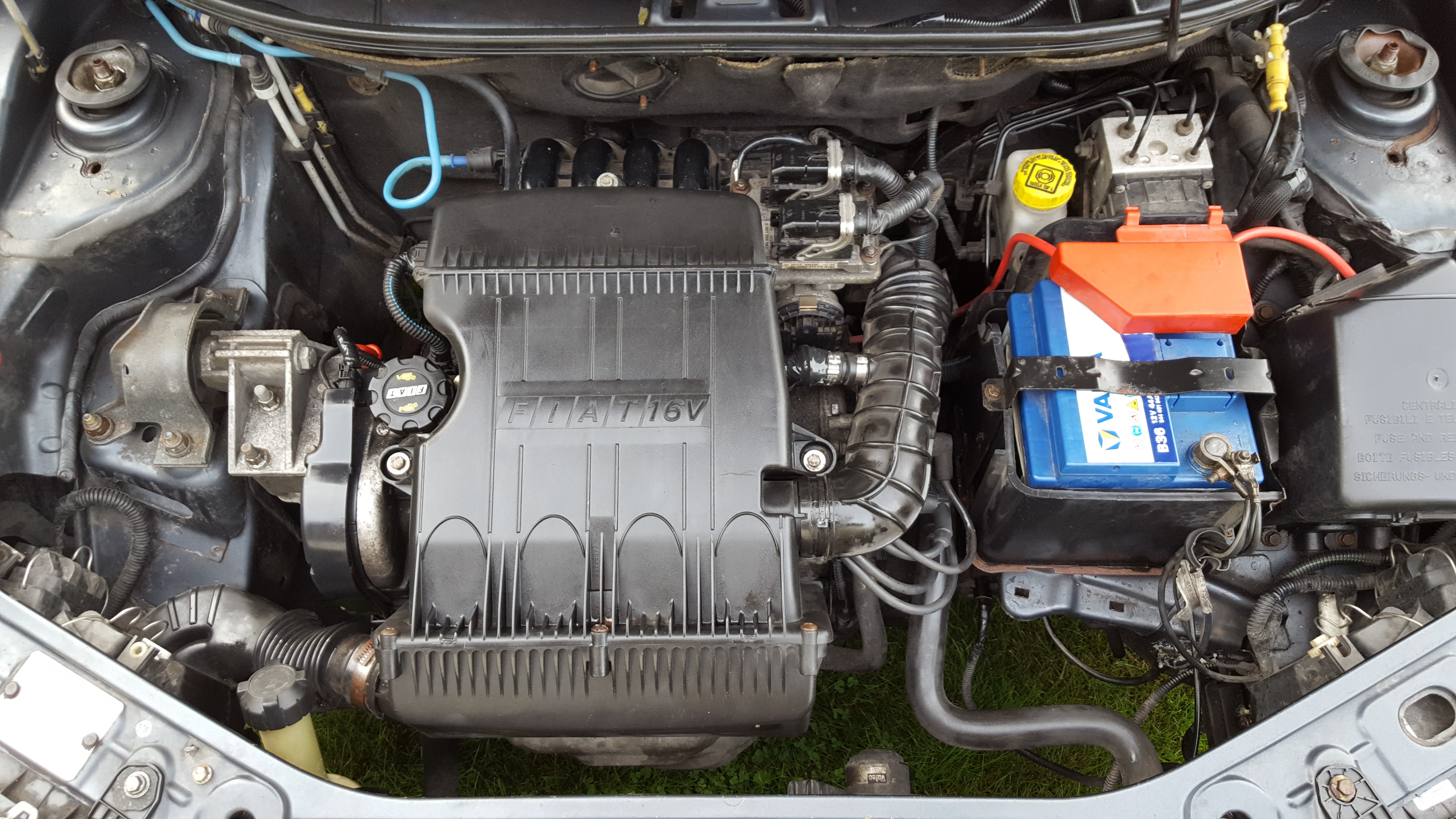

Time for an important update !!!
The pretty worn Punto is close to being dead.
Stil just badly wounded.
Headgasket failure.
Now it sit a few km's from home and is waiting to go to the scrapyard...
Well I knew it was a ****ty car, but it did its job okay.
So went out and got another mk2, but in better condition, with aceptable rust, acceptable km's, and looked after and new MOT.
It had small issues that I used to get it a bit cheaper, knowing I could fix them.
New thermostat was one of them, and the broken release-cable for the bonnet.

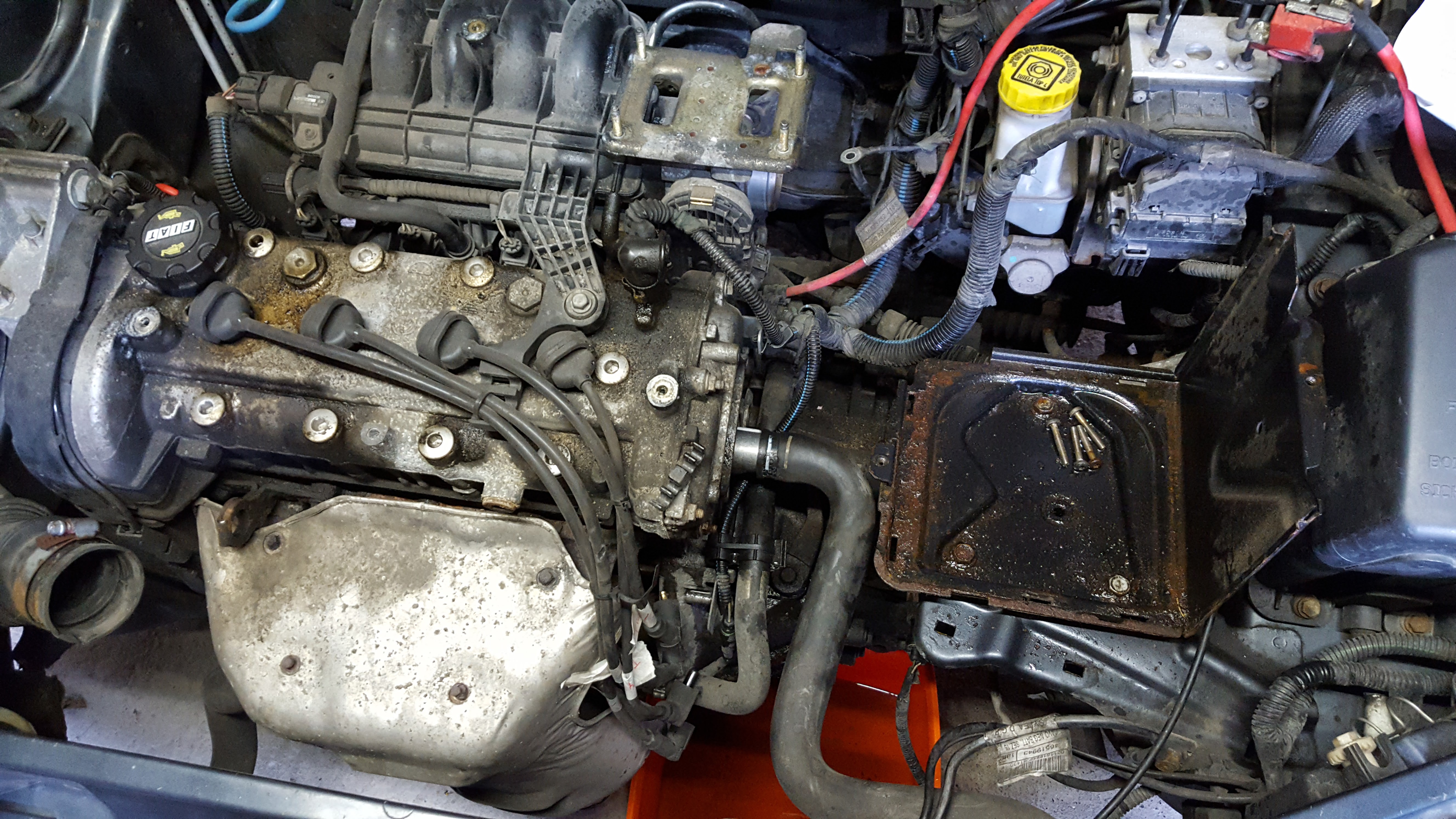

The thermostat was burried deep down:
After changing, refilling coolant and removing air from the system, I fixed the engine bay a little, to make it winterready and better looking.

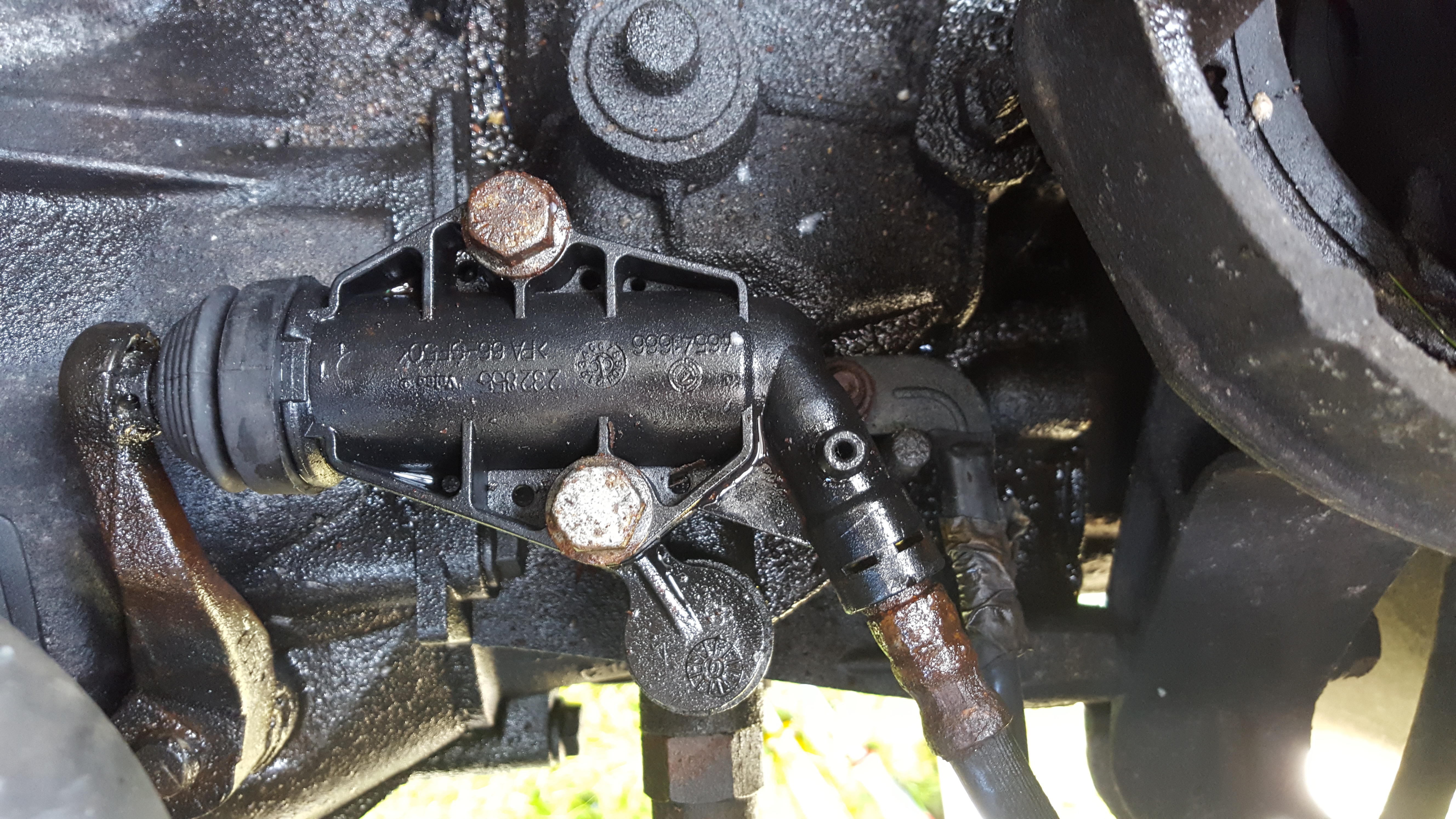

Next weekend is Clutch Weekend with the other Punto.
Never done a clutch before, so gonna be exiting :devil:
Spreading oil on the different parts of all of the clutch mecanism, the clutch started behaving better.
So continued with that and bled the clutch system.
Dont know if it did any difference :eek:

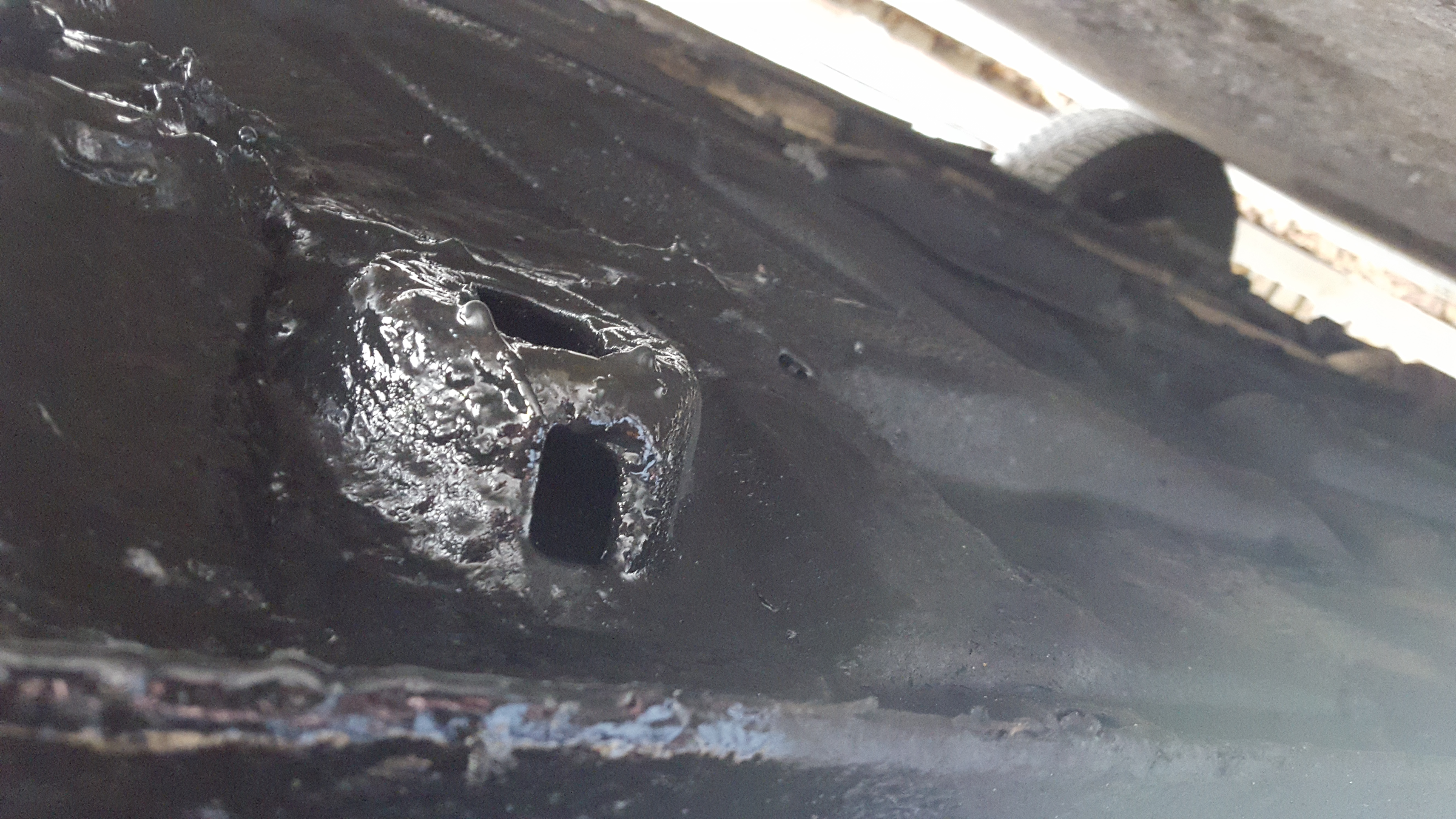

So did some ekstra rustproofing.
Found a big hole in the floorpan, for a missing plug.
Looking for something that fits ???
Dont wanna go through winter with that hole and get it filled with salt.
