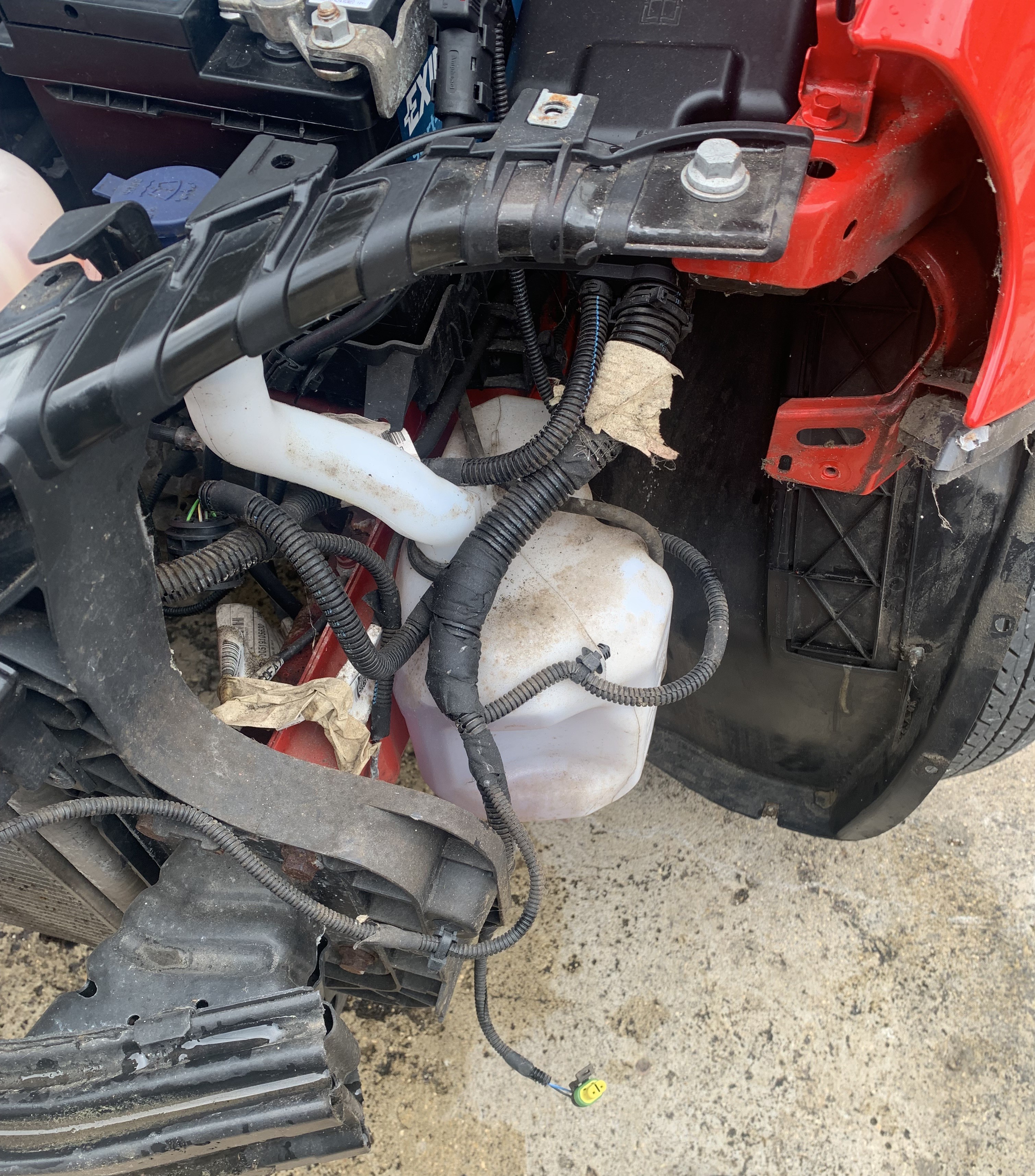

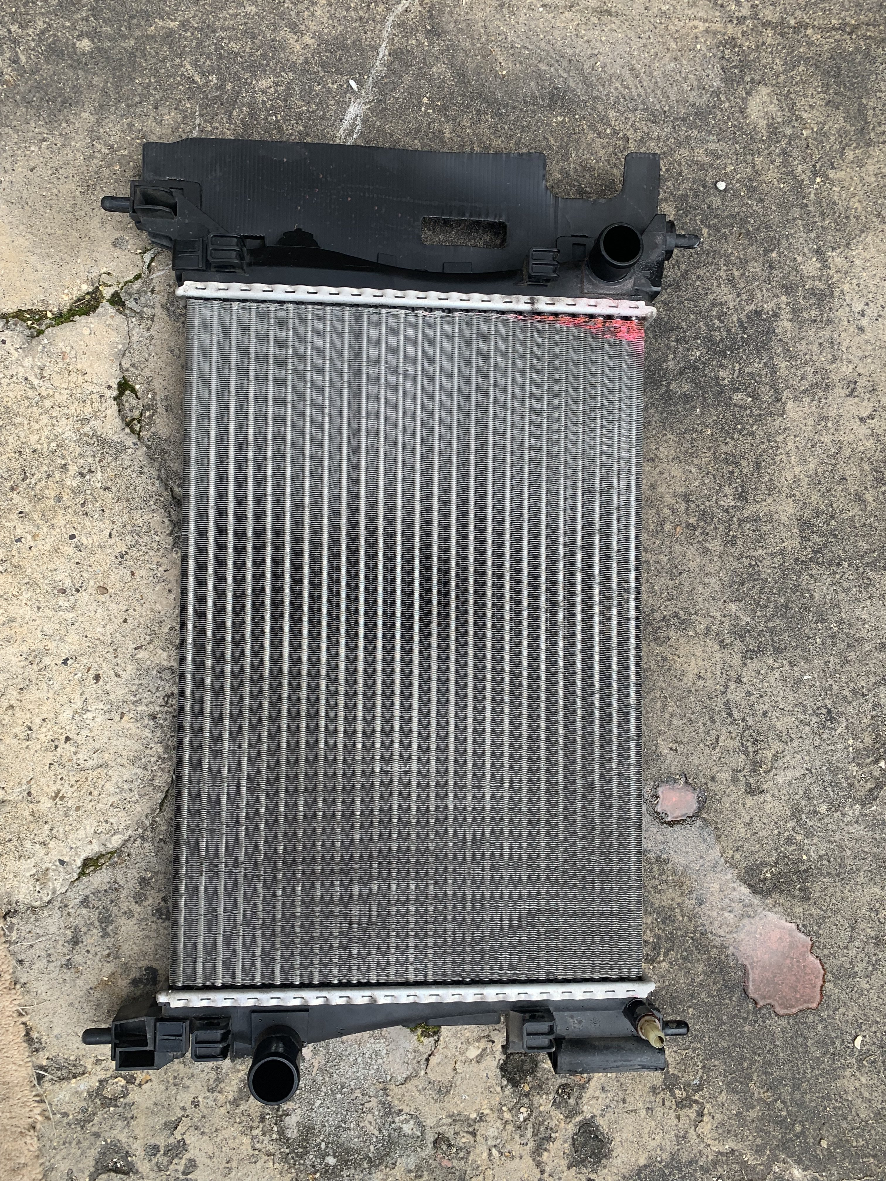

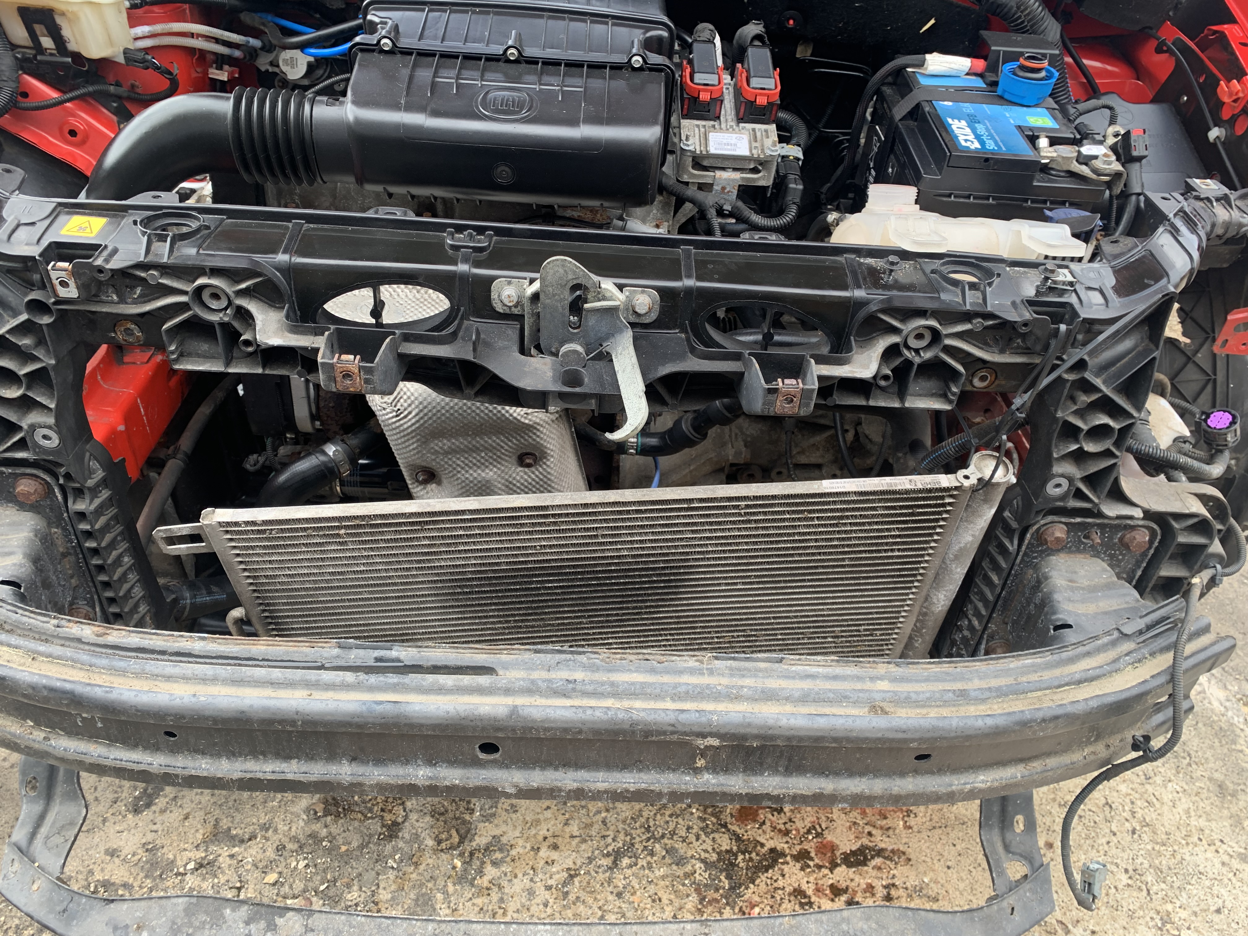

So, soon after the above jobs were done I noticed the coolant level kept dropping. Fearing it was the sealing of the new waterpump I had a good look around. Thankfully it wasn't but it turned out to be the radiator. The car has only done 23k and is 12 years old but hey ho.

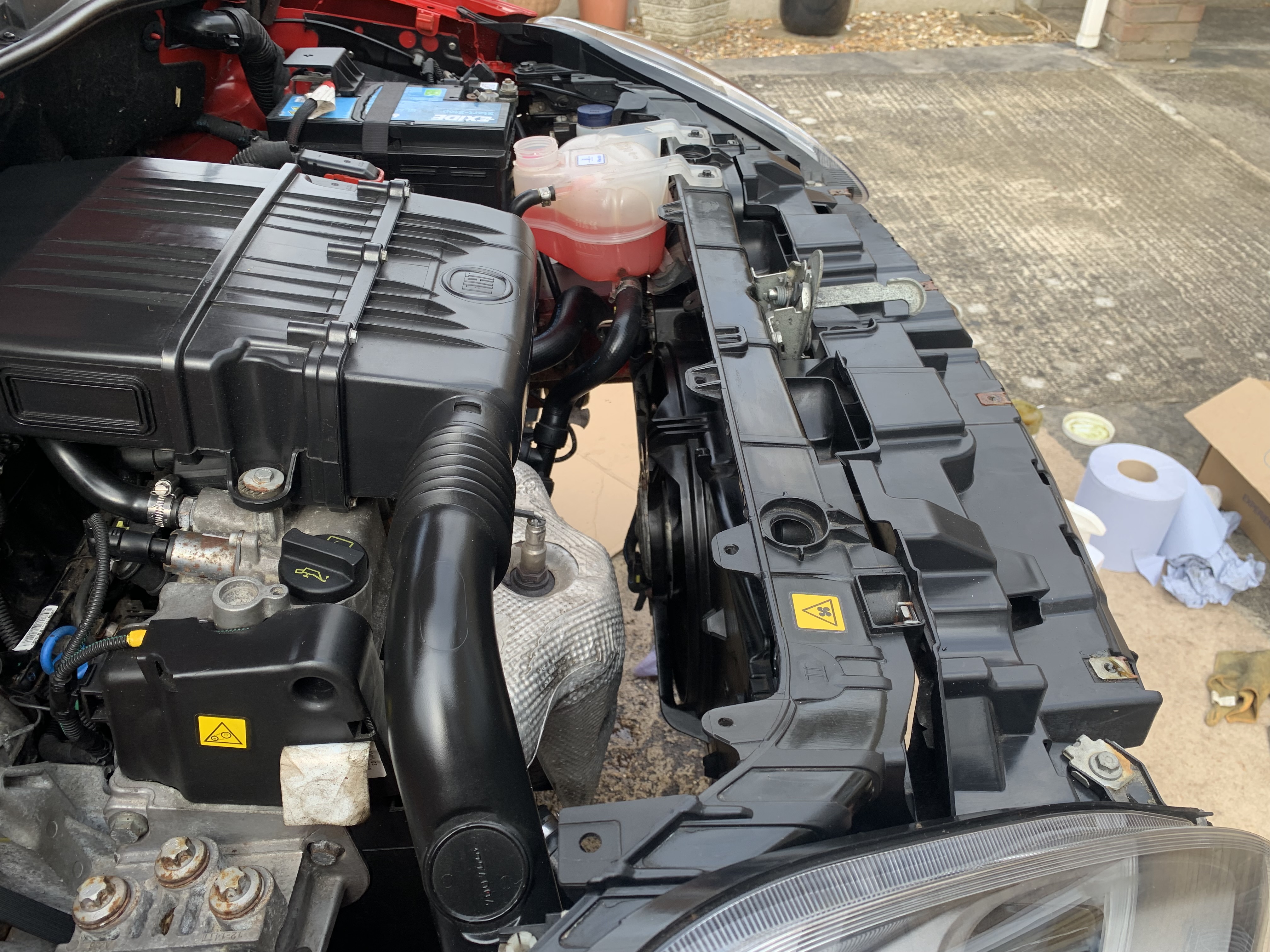

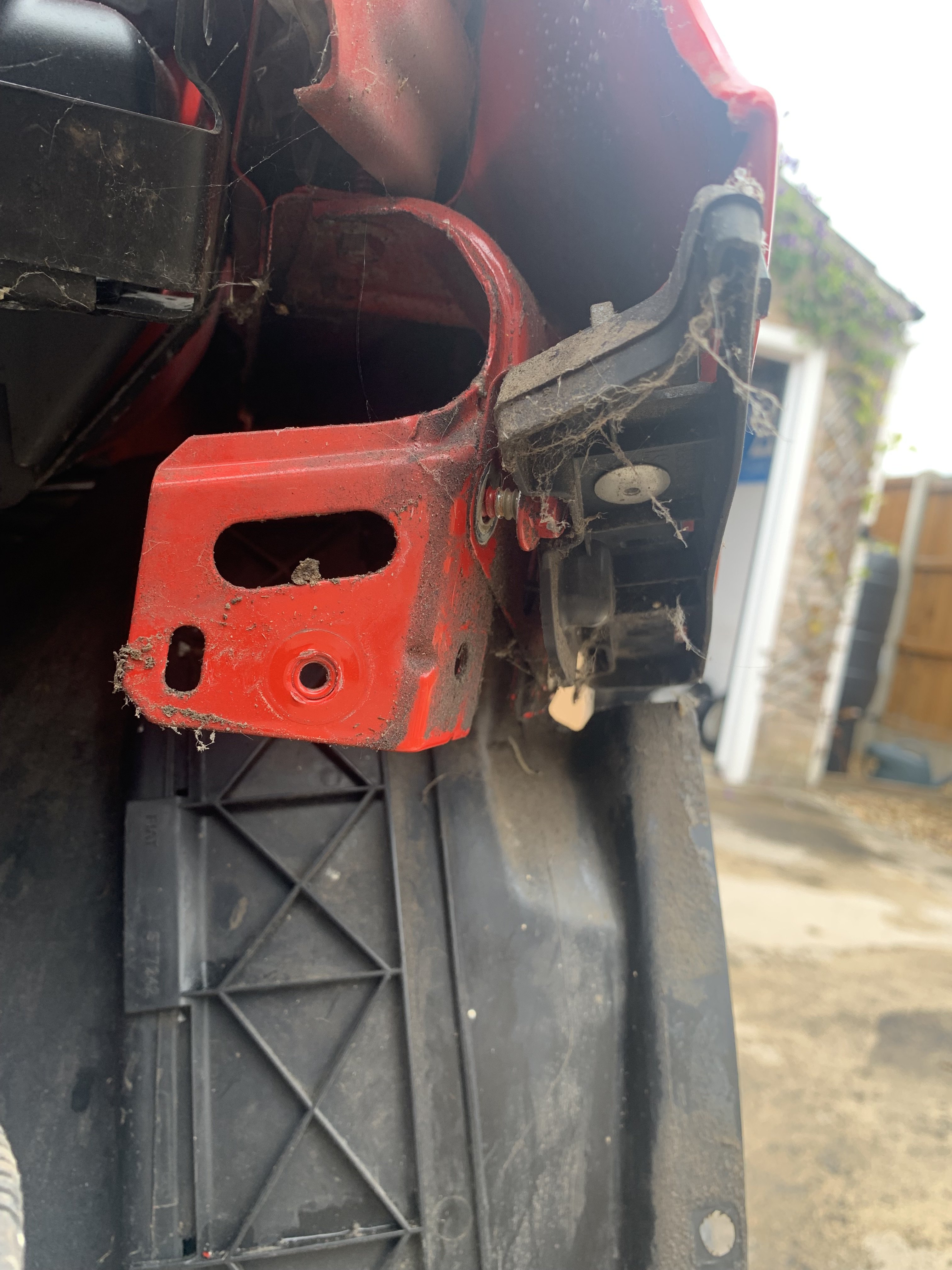

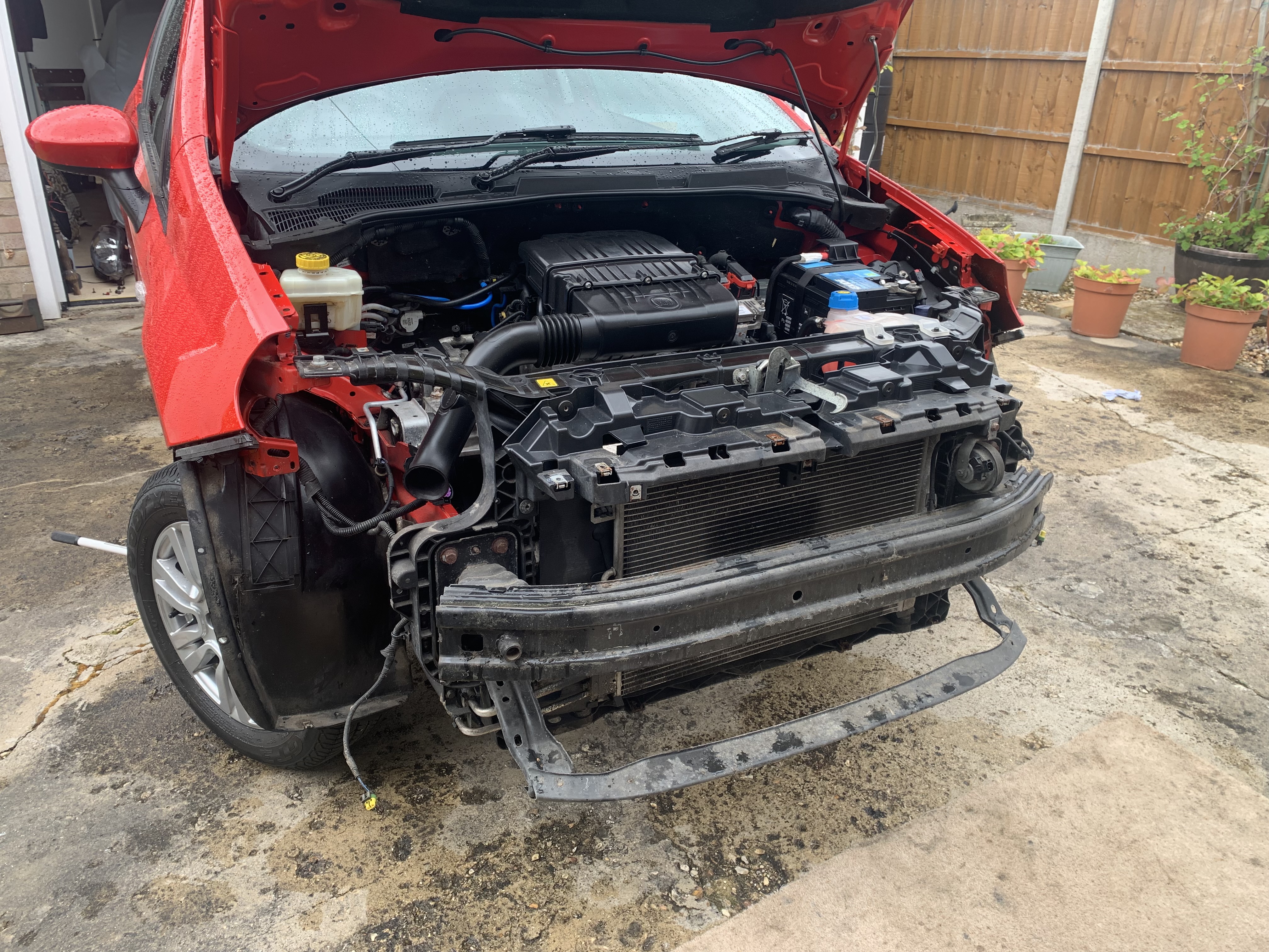

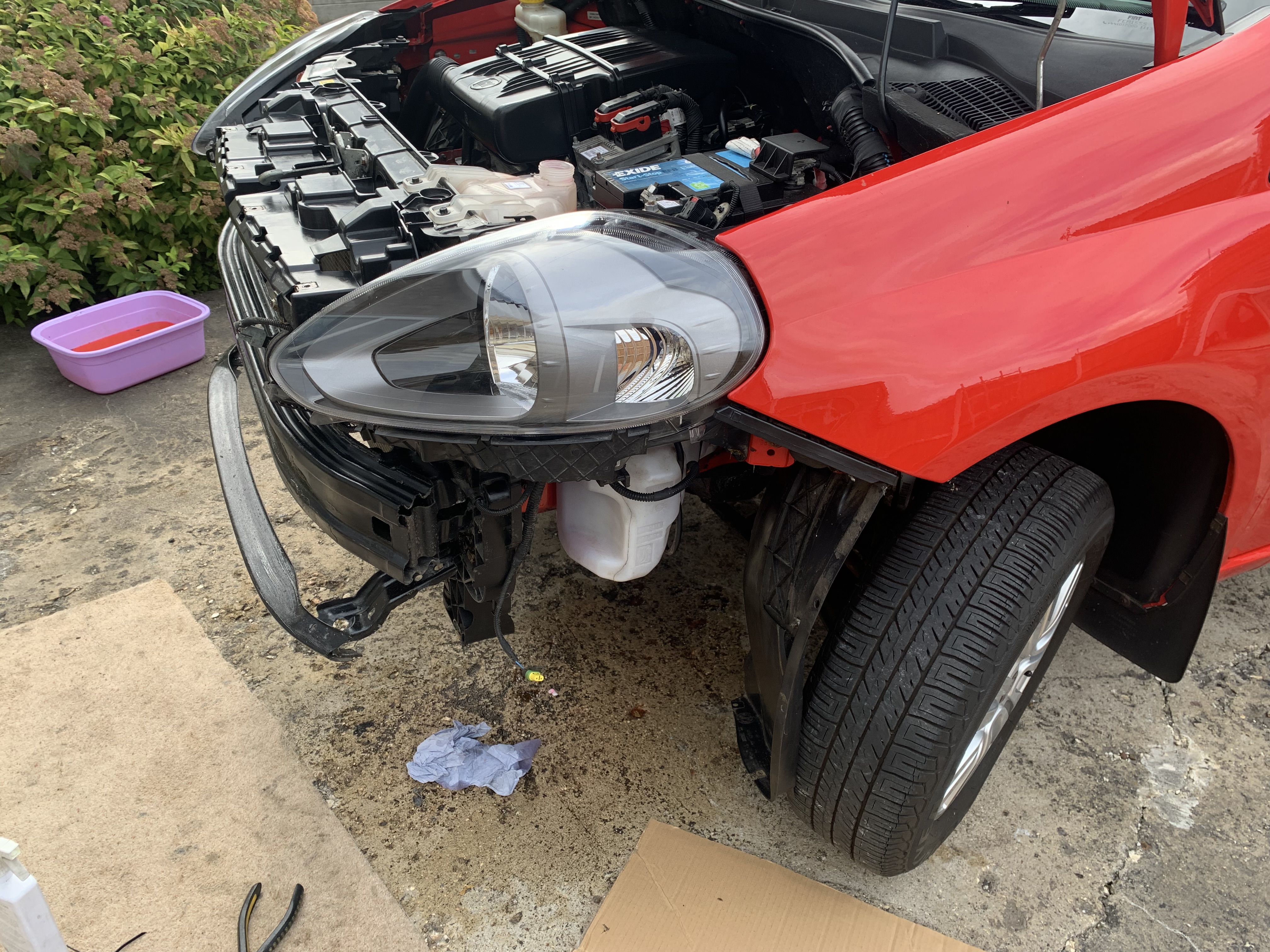

Can I say that it was a ballache to get to the rad. The Fiat CD manual I have suggested two bolts each side holing the bumper on the outer edges to the wings. WRONG. There was just one each side going virtually vertical. Thankfully the wrongly detached bolts were easier to put back with the bumper off.
With the bumper off and the headlights out I could remove the cross members and finally the AC radiator from the back of the coolant radiator. The rad then came out and as you can see from the picture, there was the culprit for all to see.
I took the ooportunity to clean up everything and to coat the metal cross members in lanoguard. All fixings were coated in grease before reassembly.
The only issue I had was one of the speed nuts on the bottom of the bumper was rusted through but thankfully came out, without too much drama. I'll be ordering some new ones from Fiat next week.
