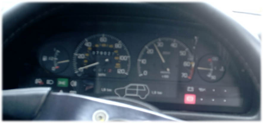

:confused: Might you know where my standard MK2 Uno 999 IE FIRE red lines? I recently fitted SX clocks with tachometer. My manual suggested the proper rev counter for the 999 has a lower yellow and red line.

The carb version does not have a limiter (max airflow at 6500-7200rpm depending on condition cam etc), i really don't know about the spi version because i never tested one yet. The factory rev counter is usually off a bit, and the 1l usually doesn't have one anyways.

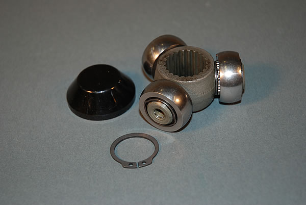

does anyone know where i could get a driveshaft tripod joint for my fiat uno. I can only find whole driveshafts.:confused:
but i just want the small section that slots on the end of the driveshaft (tripod)
can anyone help?:D
